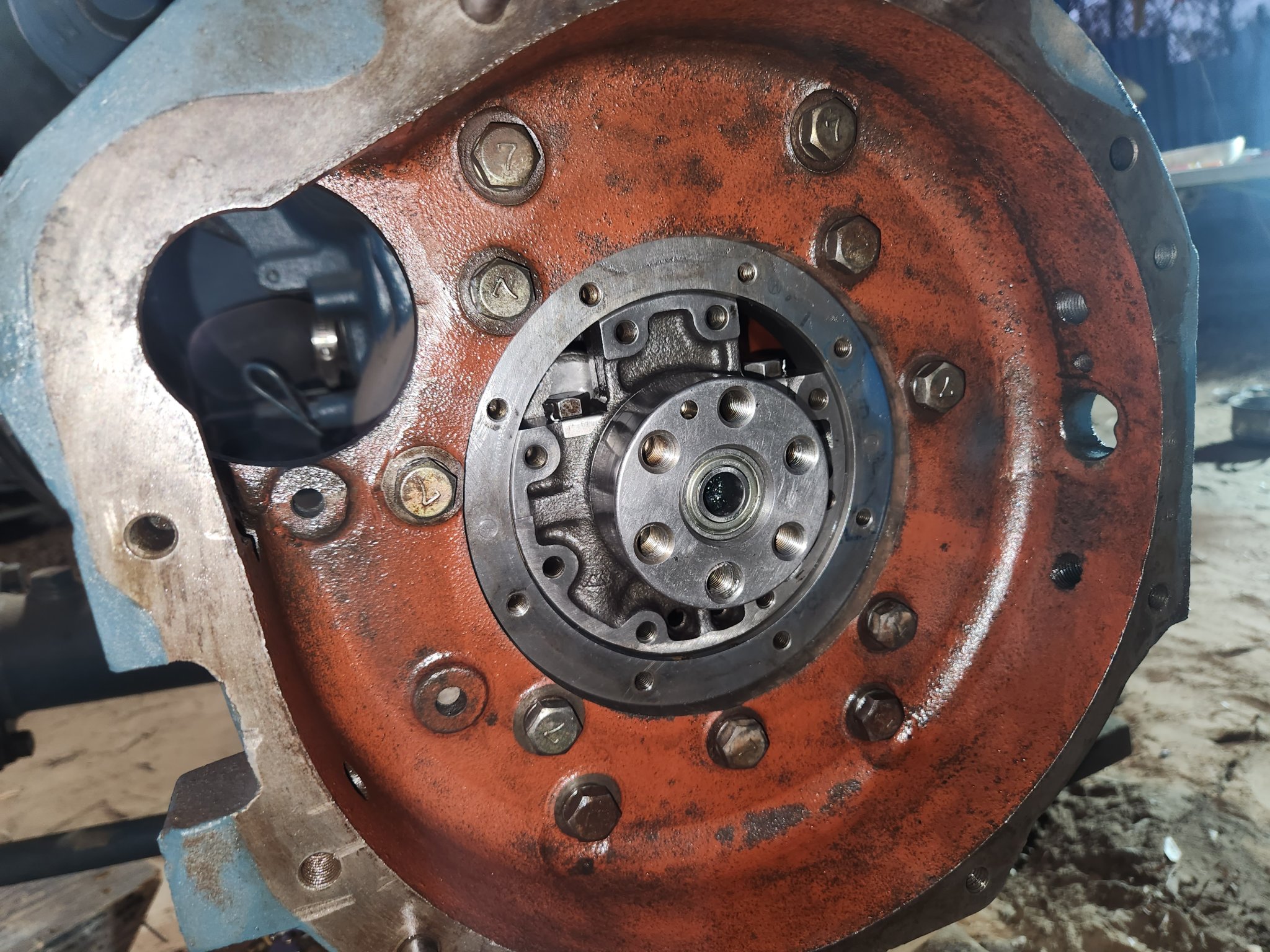

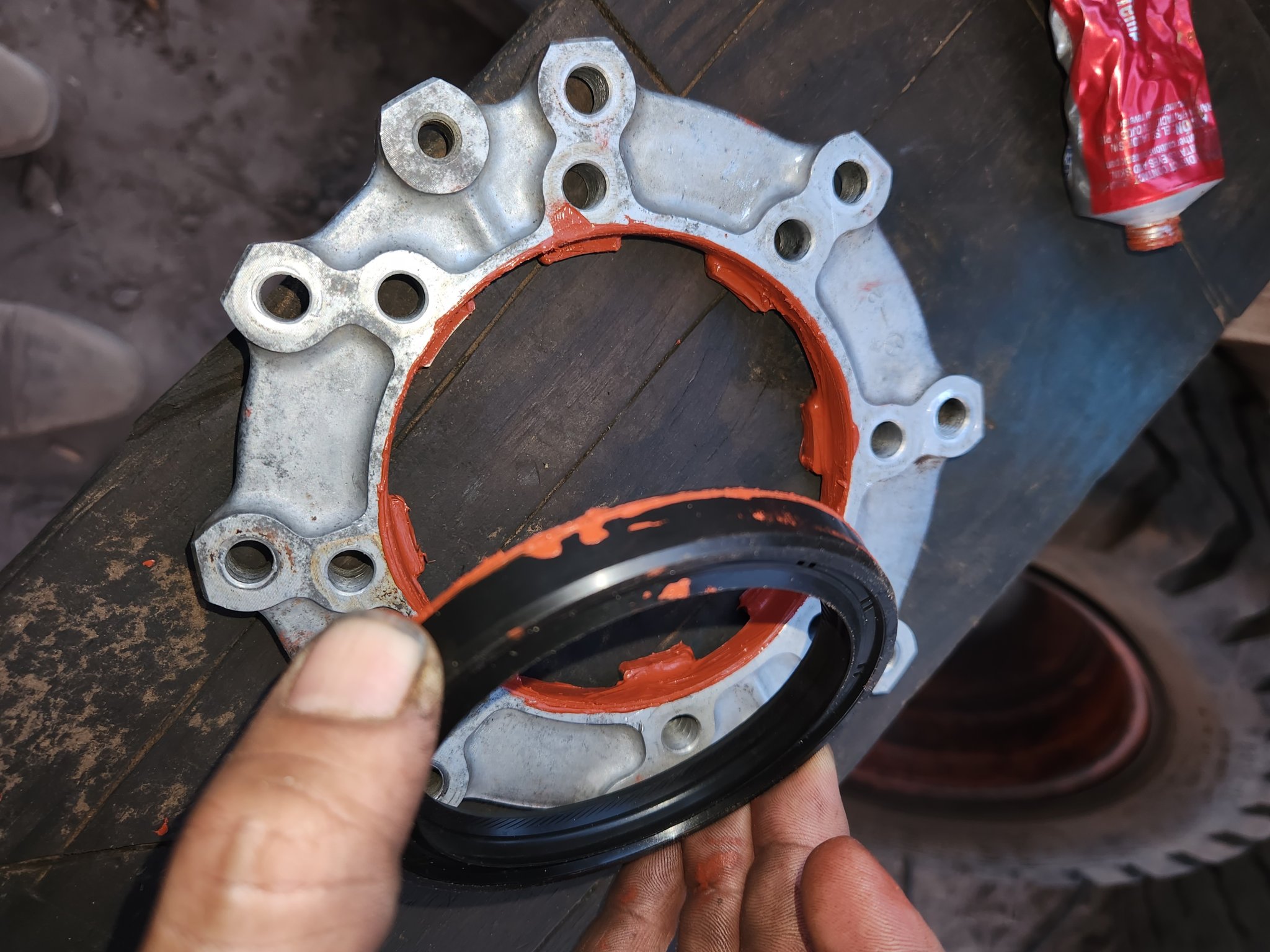

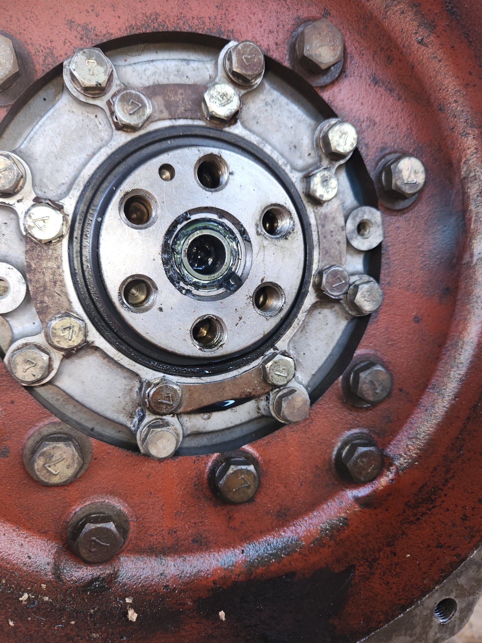

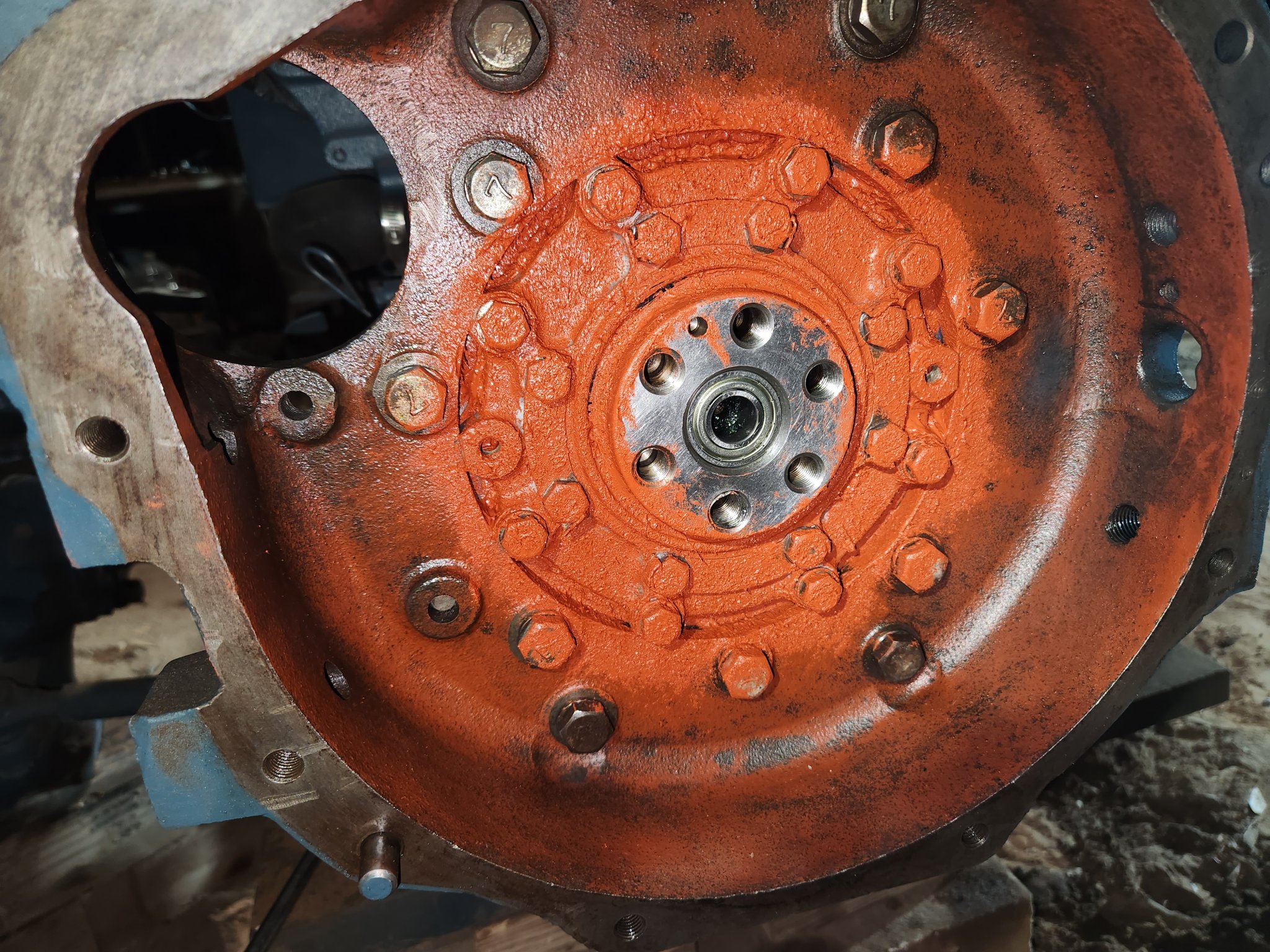

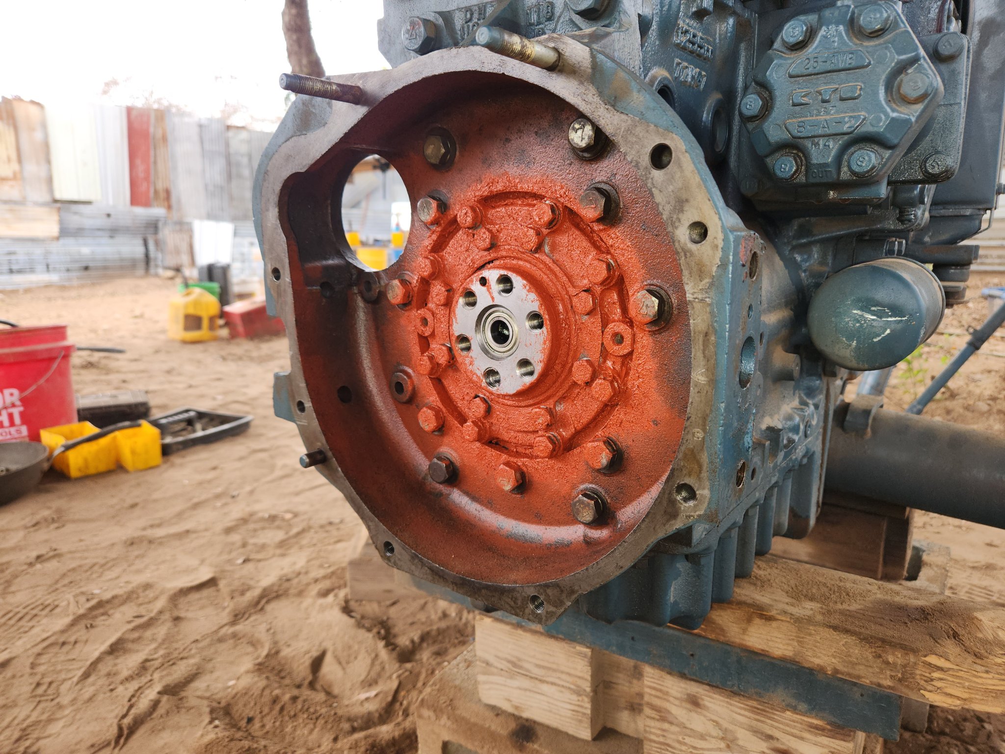

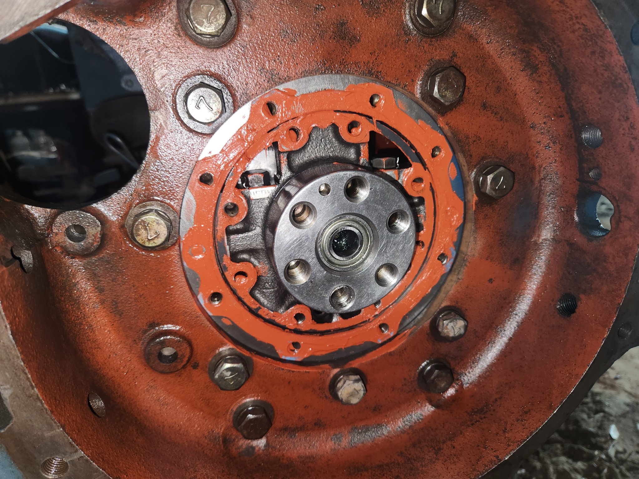

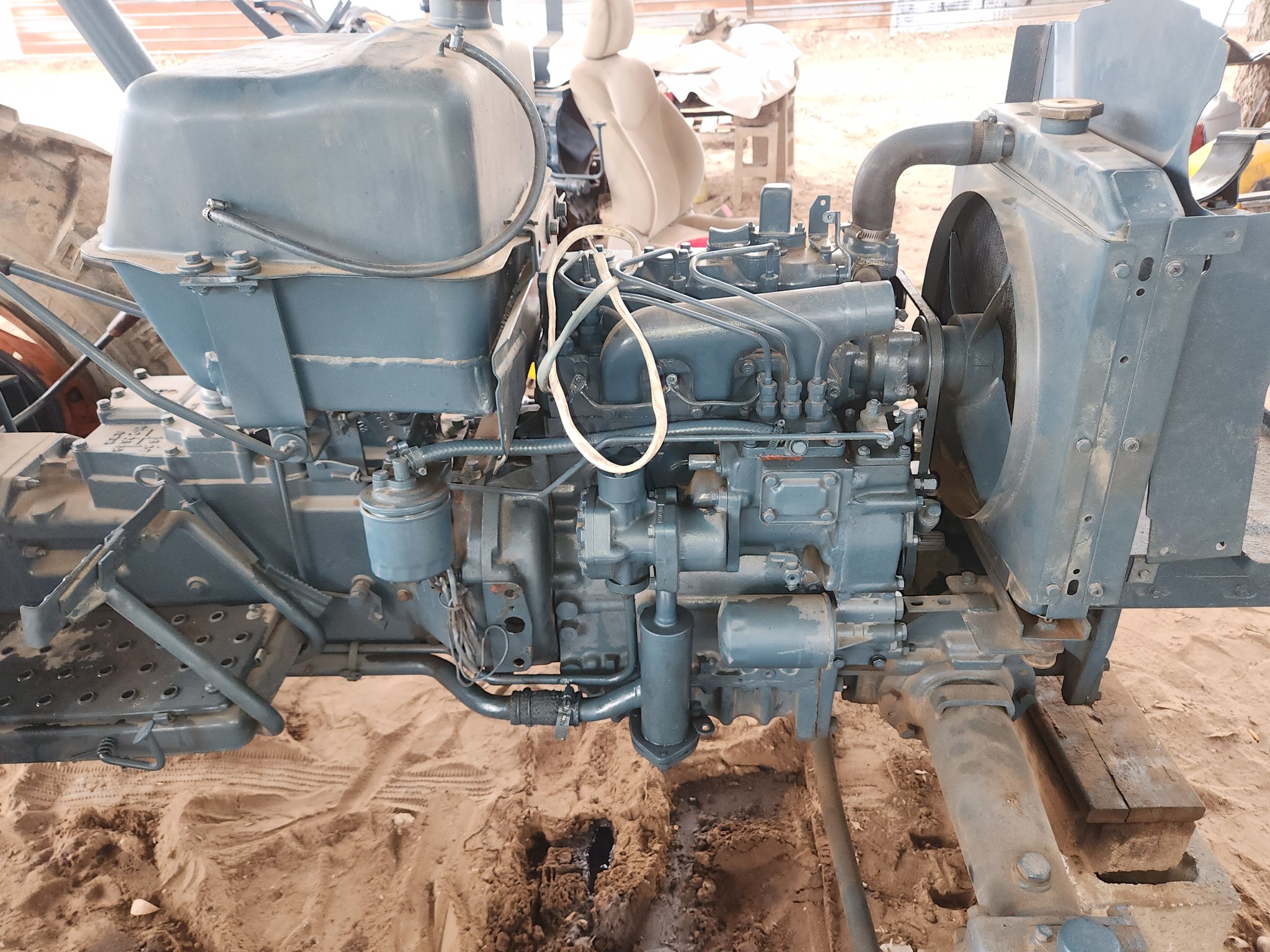

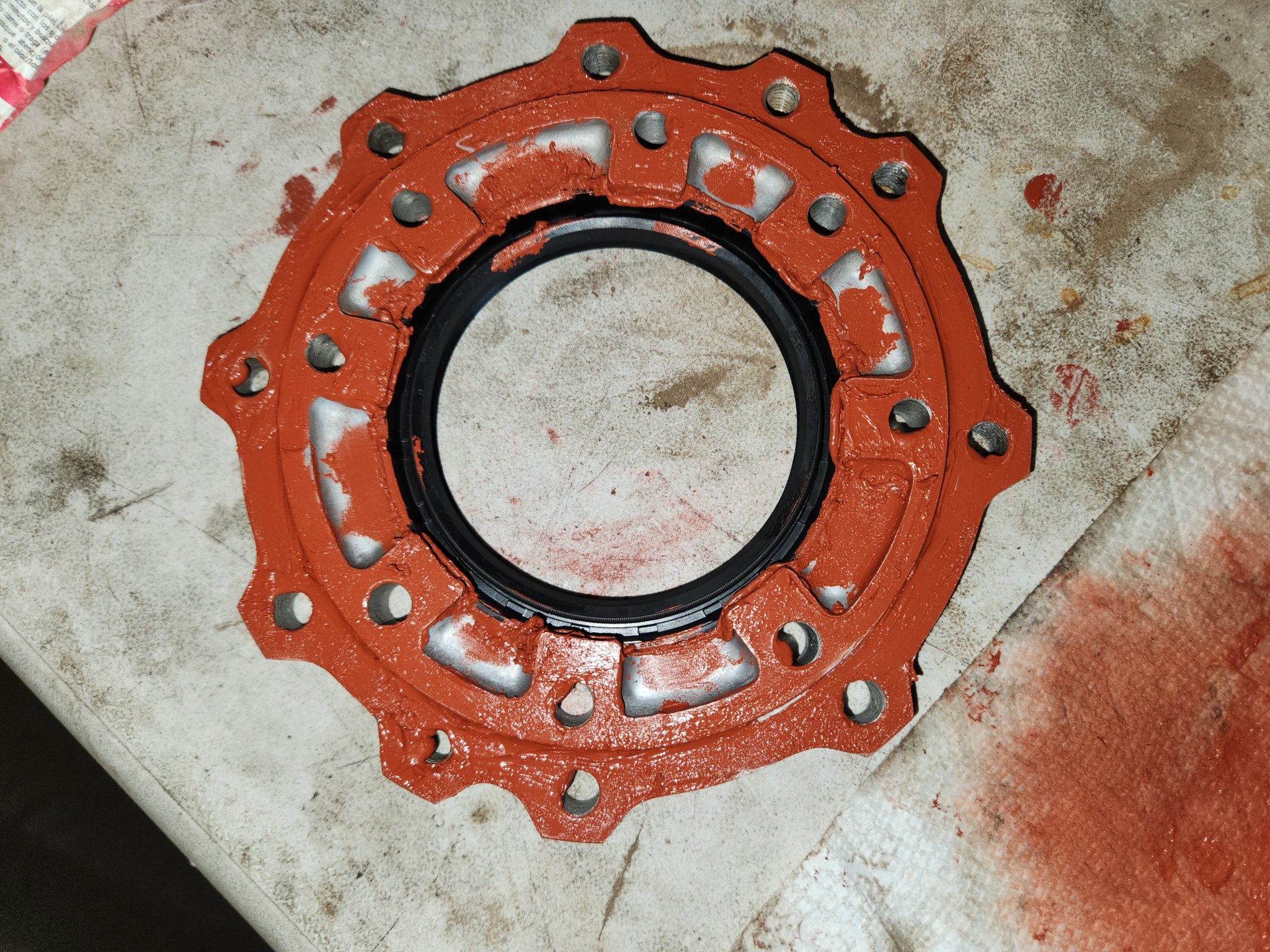

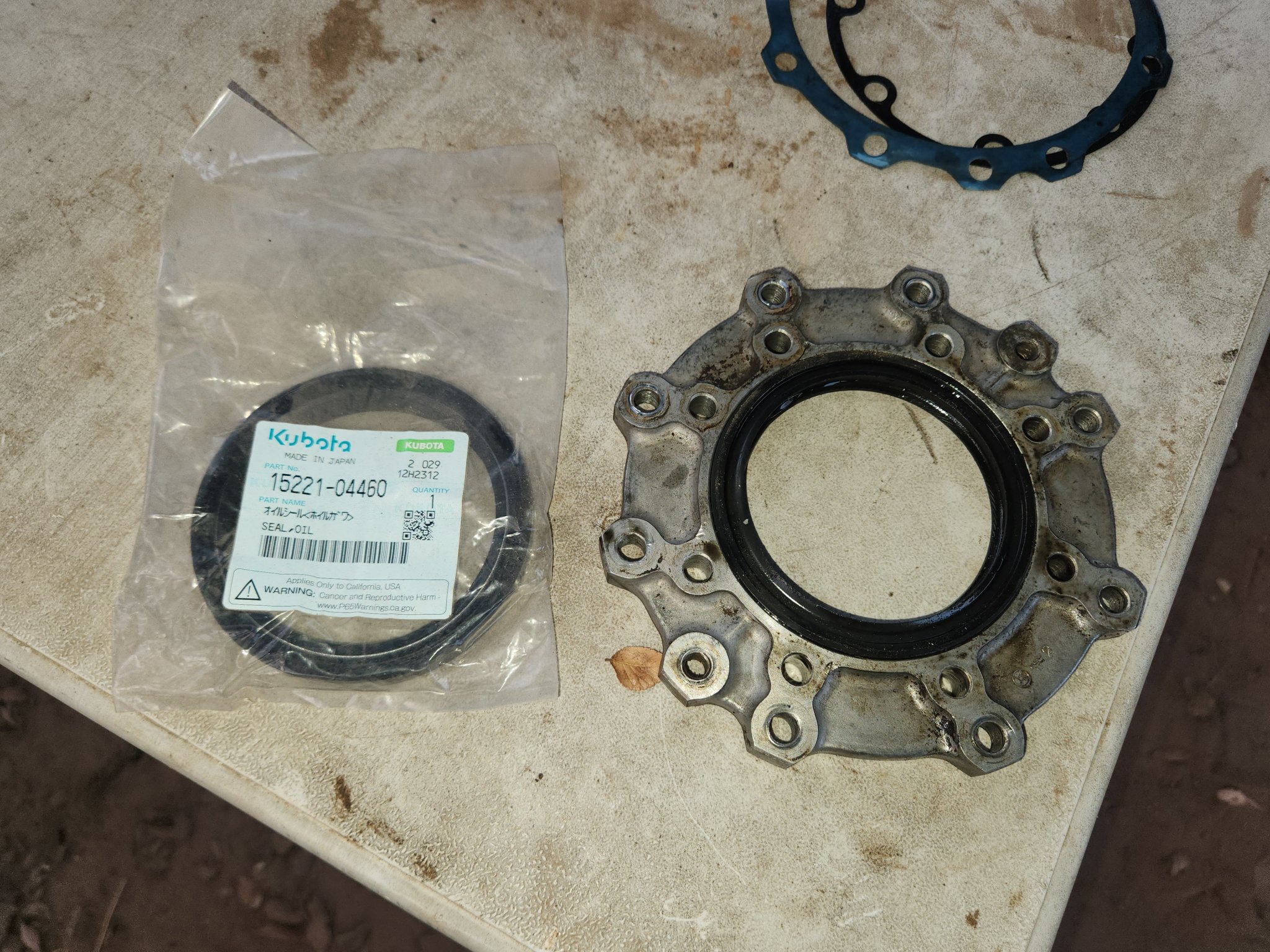

Yes, rear main leak, going into bell housing, plan to fix:
talk to dinosaur about splitting tractor, rig up those "pull away" ratcheting, "tag a long" apparatus
come up with low cost setup that would split tractor safely using maybe some kind of cart that each heavy component,
fall onto the cart, and I have pullers pulling it in one direction, then get in there and do the surgery, no touch of front of engine (radiator, head, everything pretty much)
The problem is I have jobs waiting and need the machine, run it for few months, zero chance i can afford to fix that leak now..

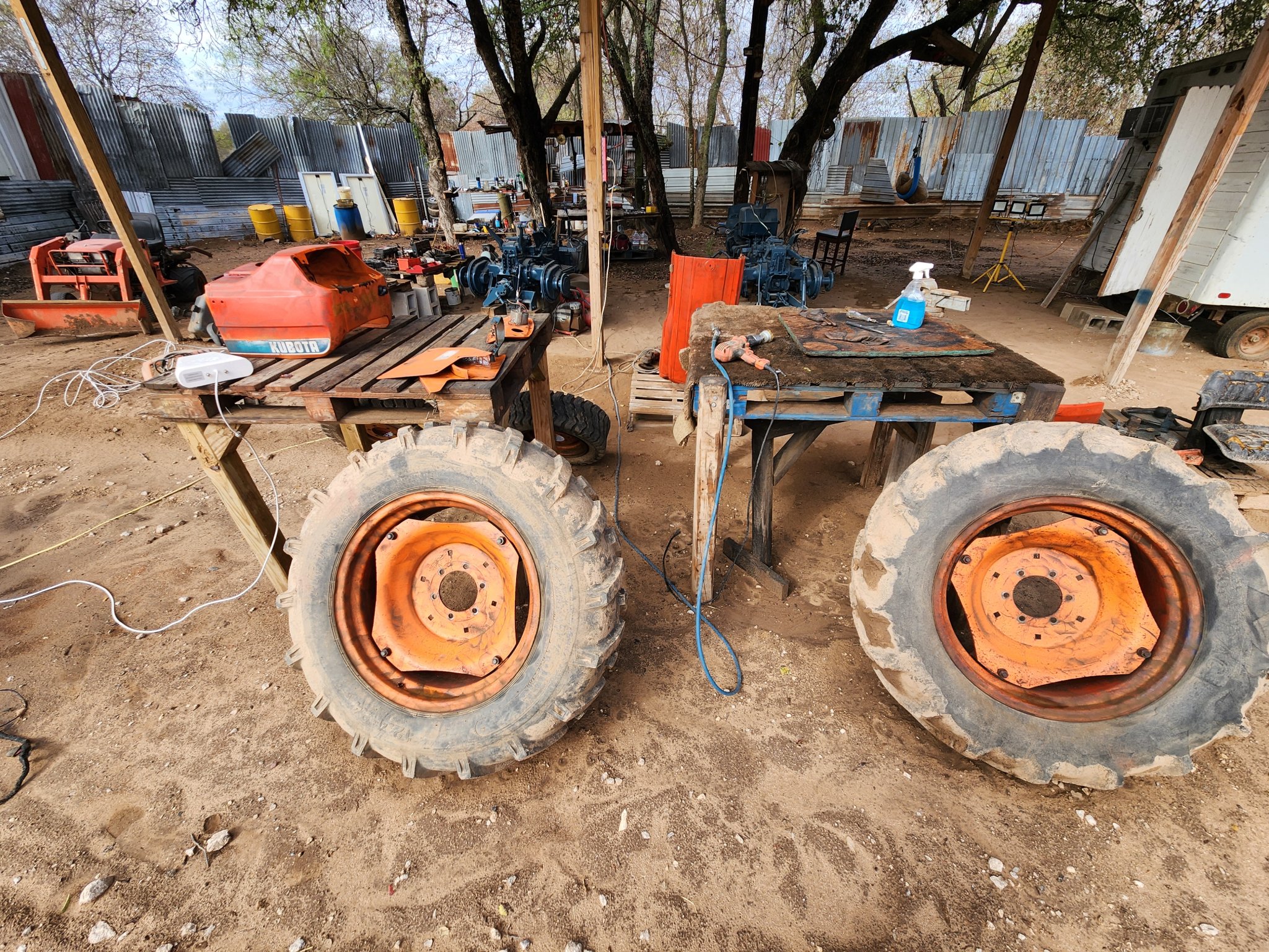

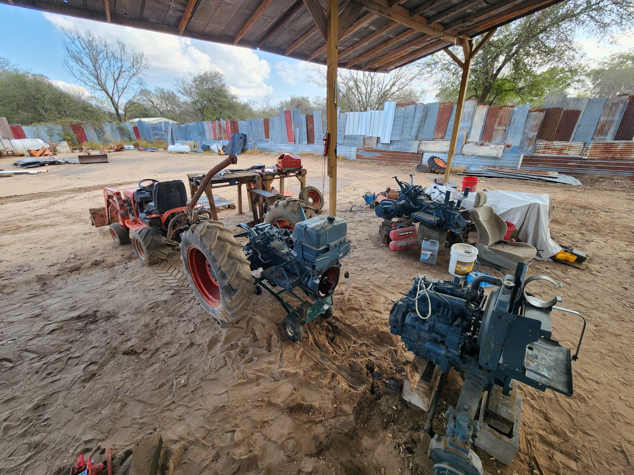

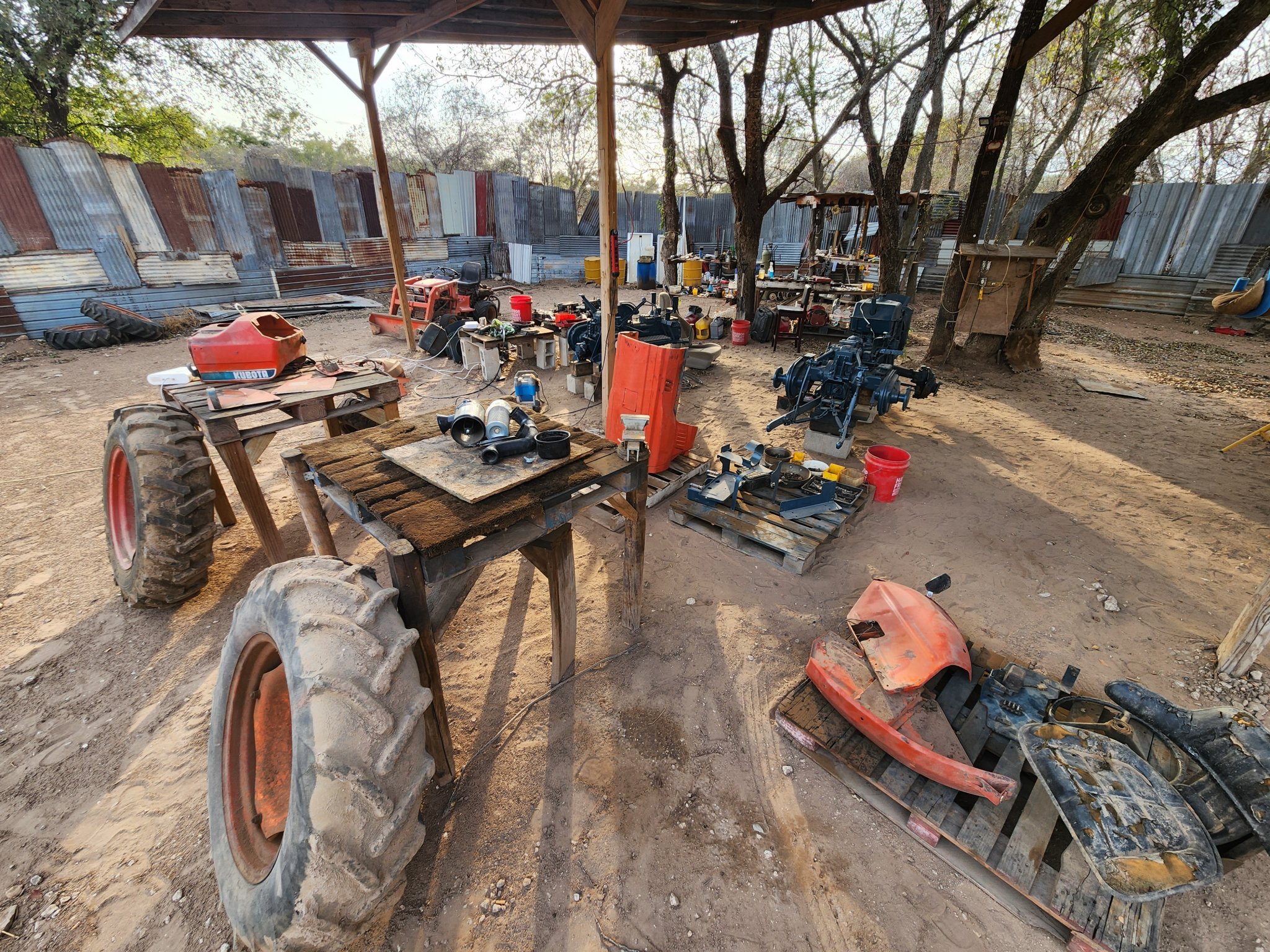

yes, here is shop layout now, plan:
move everything away not being used, bring 3 pallet for the area of body/wire wheel/clean/paint

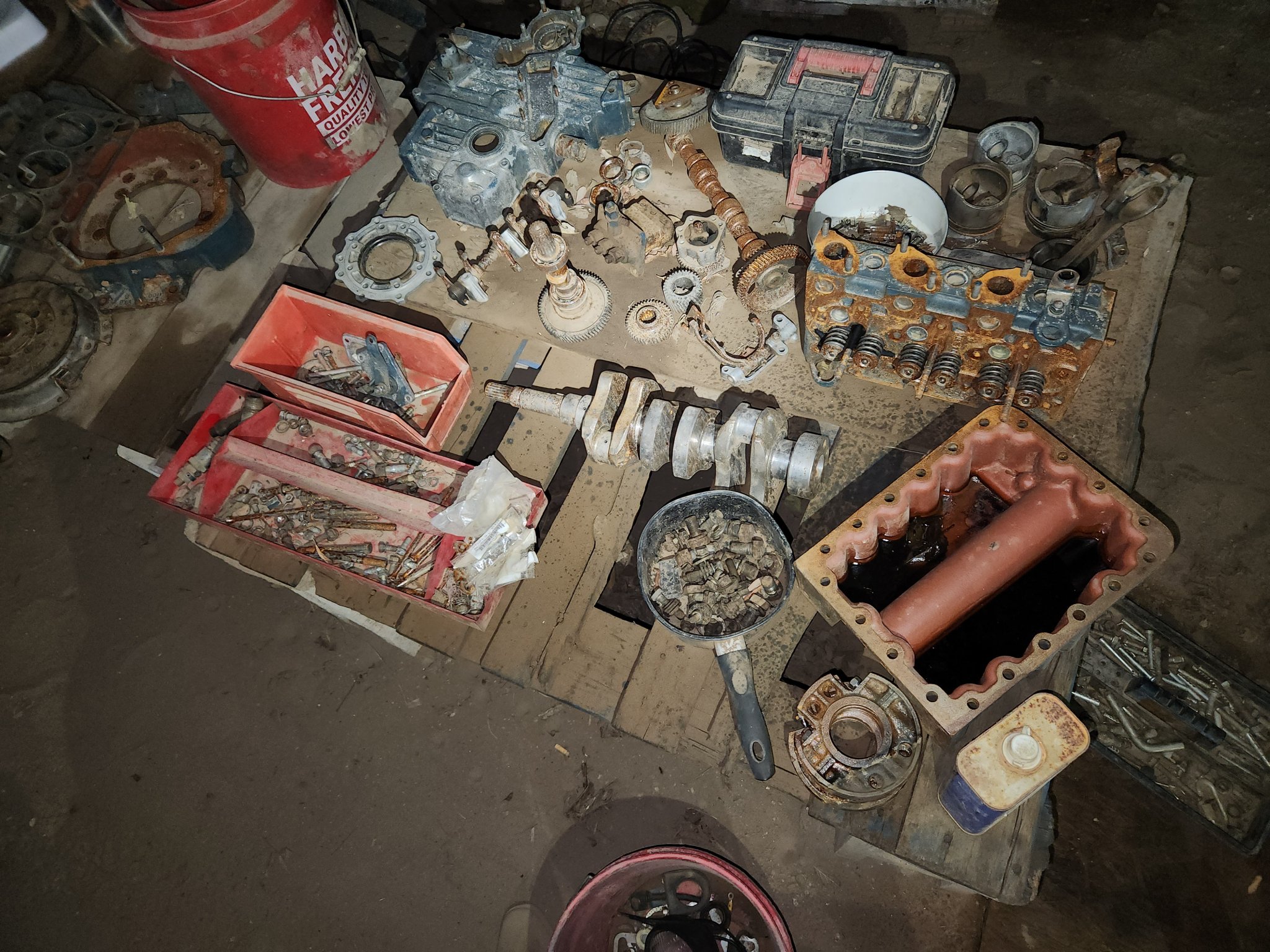

I try to capture all the parts that go back onto the tractor, all of them need:
gather them and bring them to the pallet setup, instantly hit them air/diesel/absrasive
simply: clean shop floor, bring pallets, bring all body parts, do body work while thinking about the start/glowplug control, and rig up big wire and big battery, and see if alternator can charge

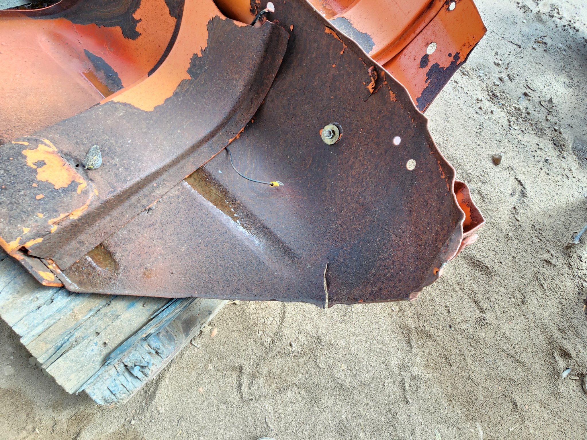

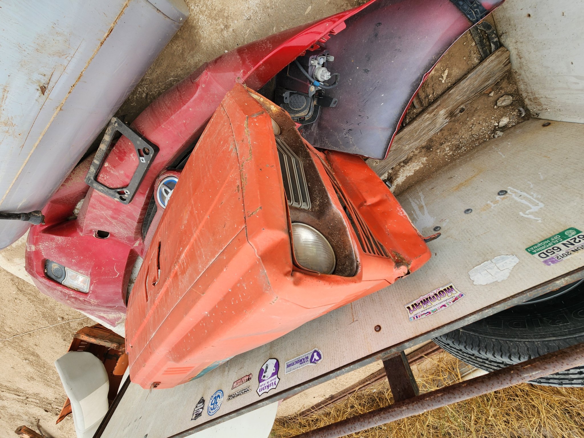

damage to factory hood: ripped out front bracket metal, both side

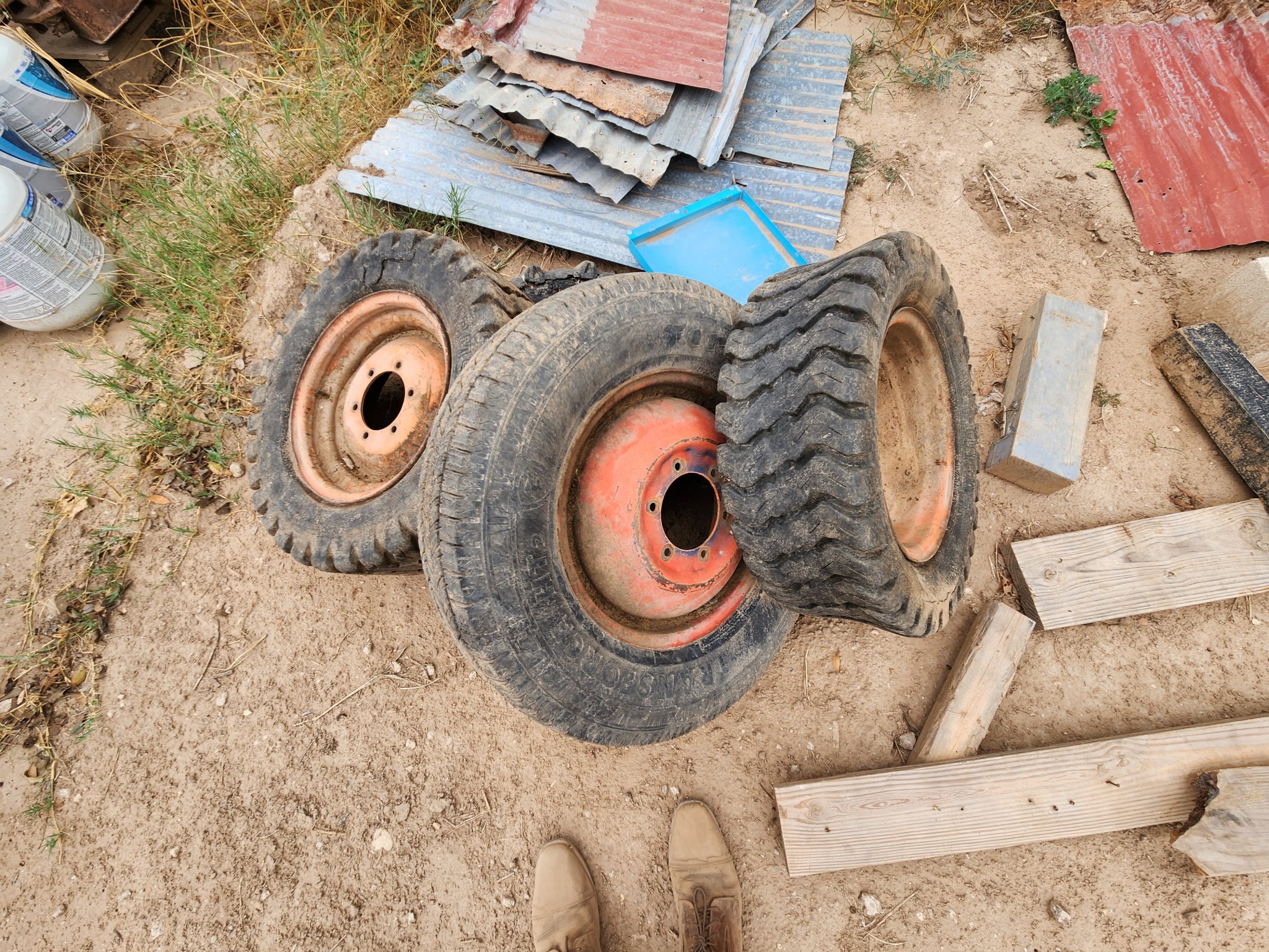

tires are better on tractor with more hour, gonna use those, more parts ready for clean/hammer/paint

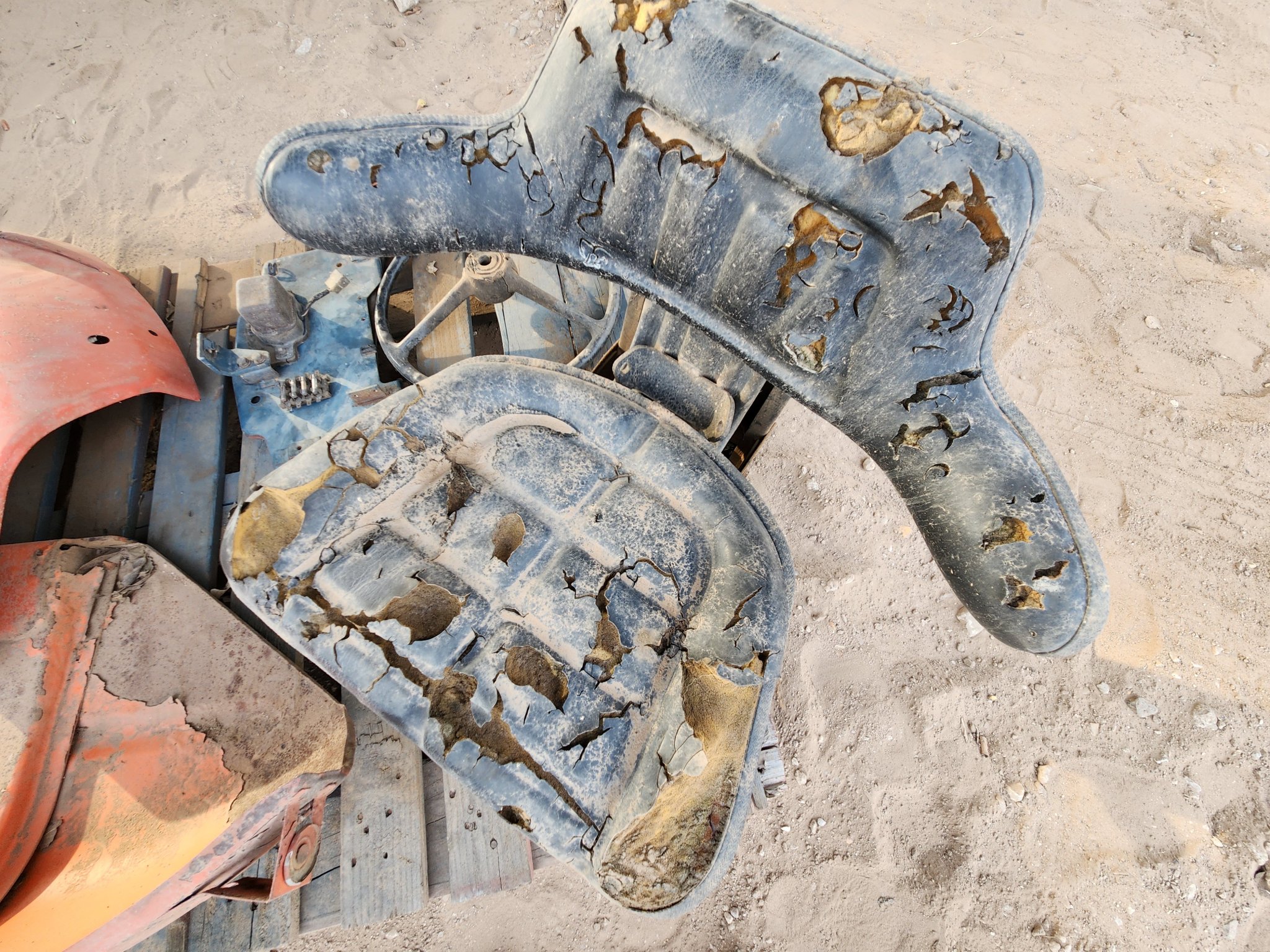

The seat: its not that bad, i would like to salvage and save $, the only problem is it cut skin from the sharp plastic
maybe someone know how to how cover it with something, fasten it with washers with self tap in...

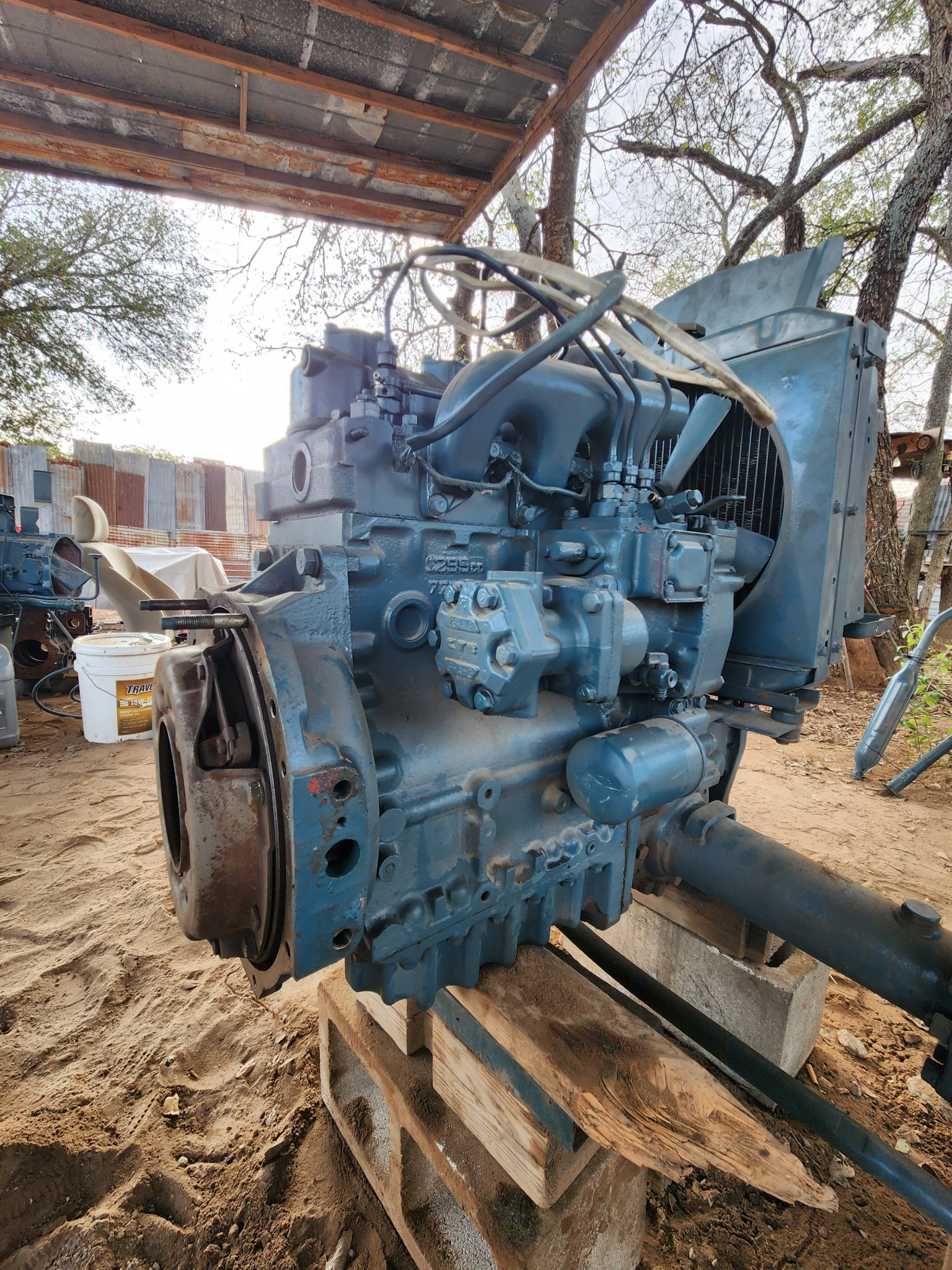

while waiting paint to arrive, maybe it is not THAT much work to split tractor, and fix rear main leak
I'm thinking: put wheels on rear of tractor, put blocks under engine and front axle assembly, and put cart/dolley of some kind under the front transmission, then
disconnect the two entities, drop the transmission onto the dolley, roll back the entire rear of tractor away from engine
then get in there and seal properly
So far from break in period, oil level showing half on the dip stick, its definitely enough to bug me...
if that leak get fix, there would zero major leak, only tiny leak on gearcase where i tried the jb weld
It would much more work to fix later with everything in the way, arguably now would be the best time to fix it
After I install hood, all wiring, loader, etc
it would way much work to split tractor

the exact things that connect engine to tractor: throttle, diesel line, tranmisssion line, steering link,
if I disconnect those 4 things, then i can take the bolts off bell housing and entire engine and front axle come out...

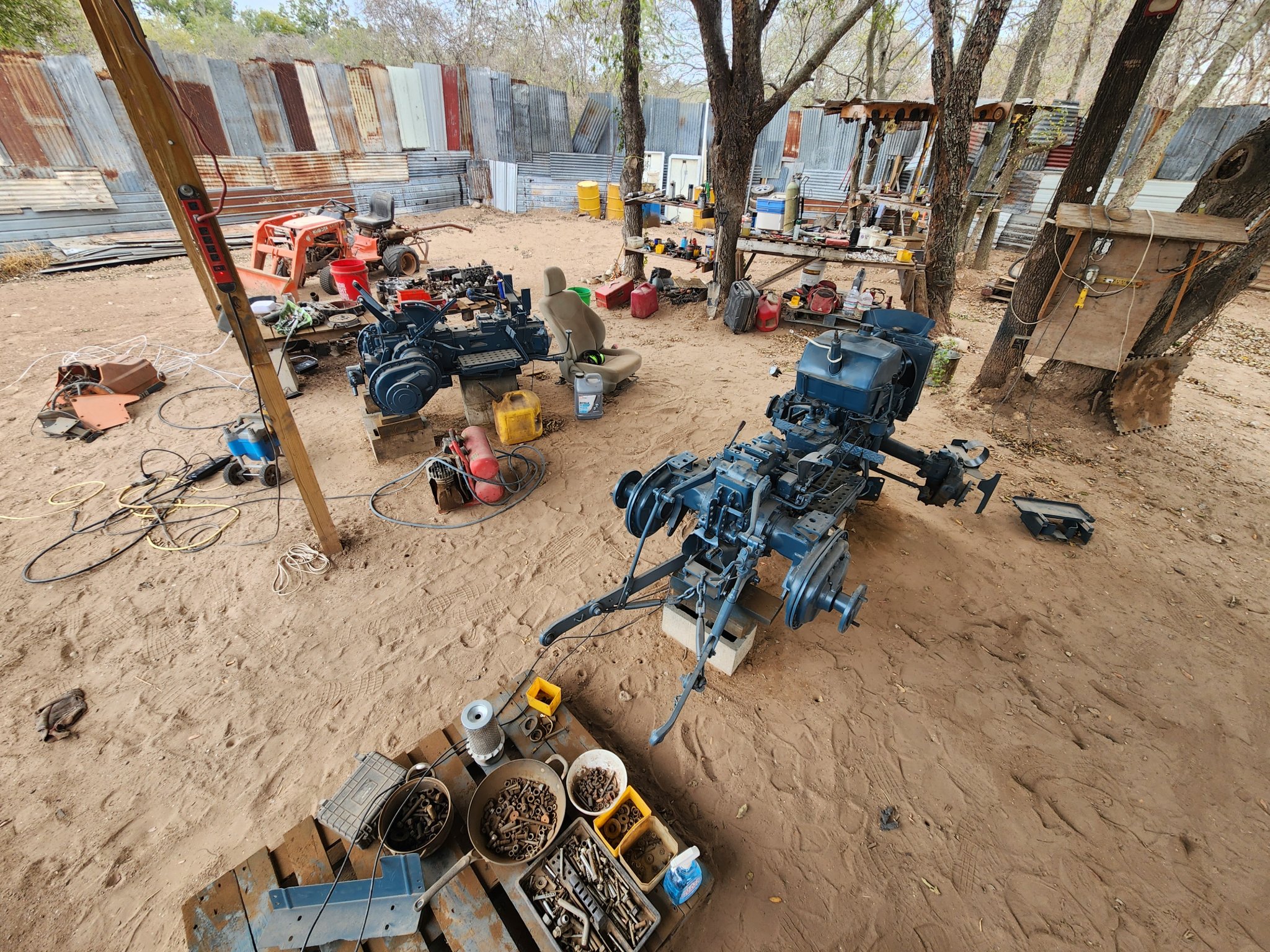

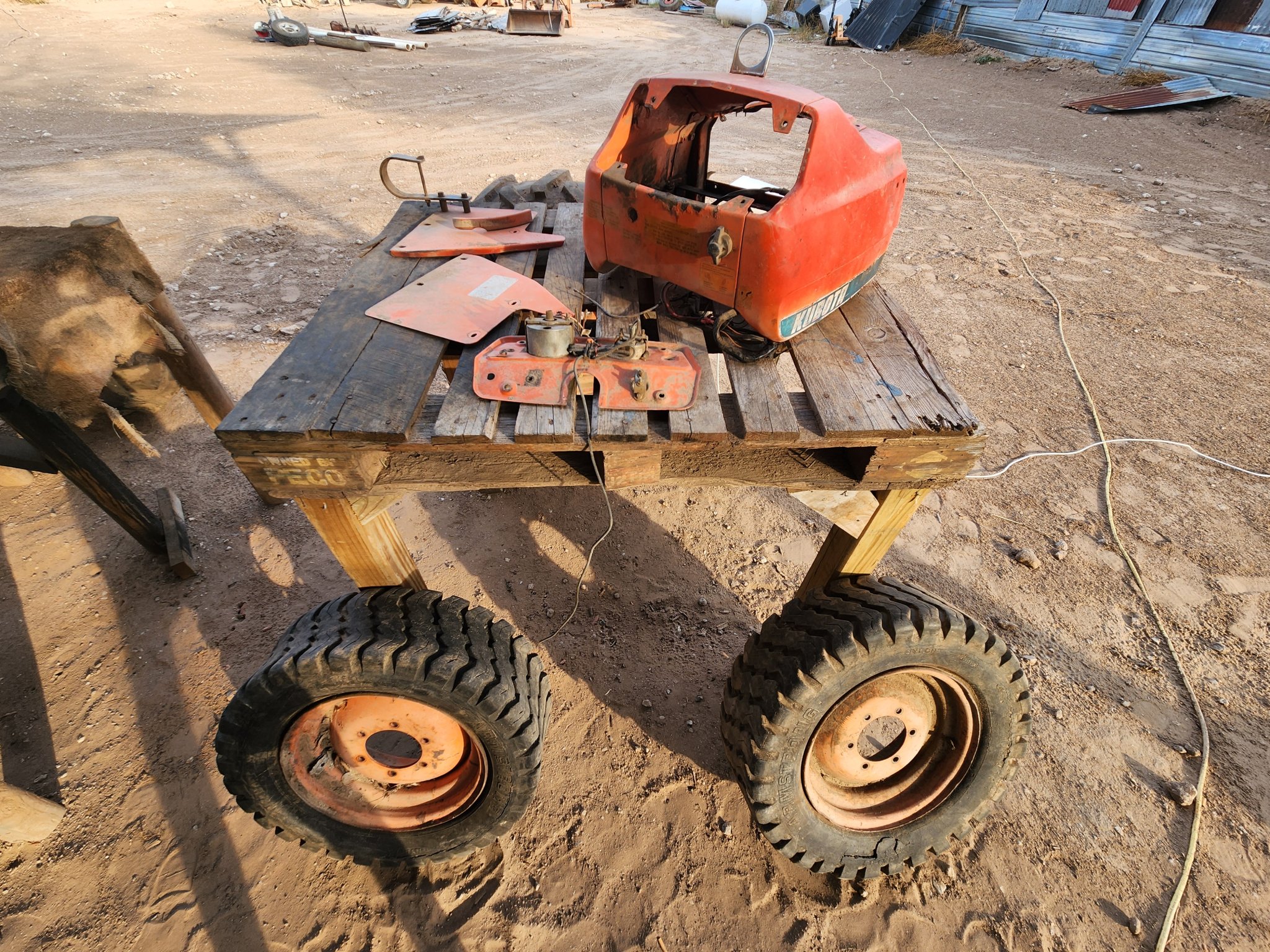

now: while narrative marinate in our mind, clear out everything off the ground until only what work on is visible to you (me)
clear out everything but all panels needing orange paint, continue to work on those panels and get them ready for perfect paint,
and imagine the splitting of tractor using the tag along pulley on a cart/other end on block idea
yes, another huge helpful talent would be:
I disconnect the engine and leave front axle and radiator and everything connected, I do the surgery on the big leak, then
somehow get the engine running disconnected from the tractor, get it up to temperature, and make sure that leak no longer an issue
possible problem: hydrualic line would not be connected, maybe that doest matter?
yes, let the narrative marinate while doing actual task that need to be done

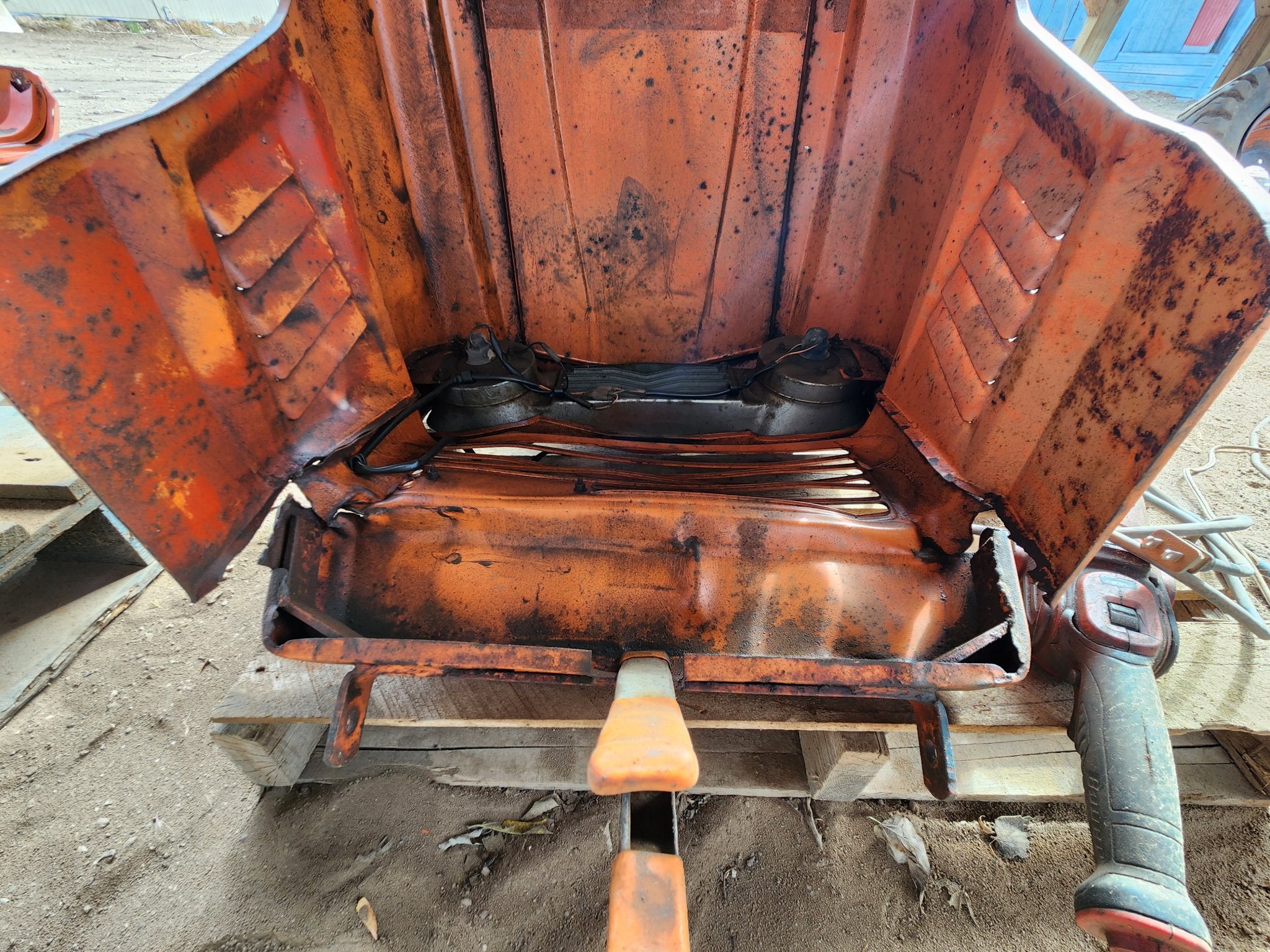

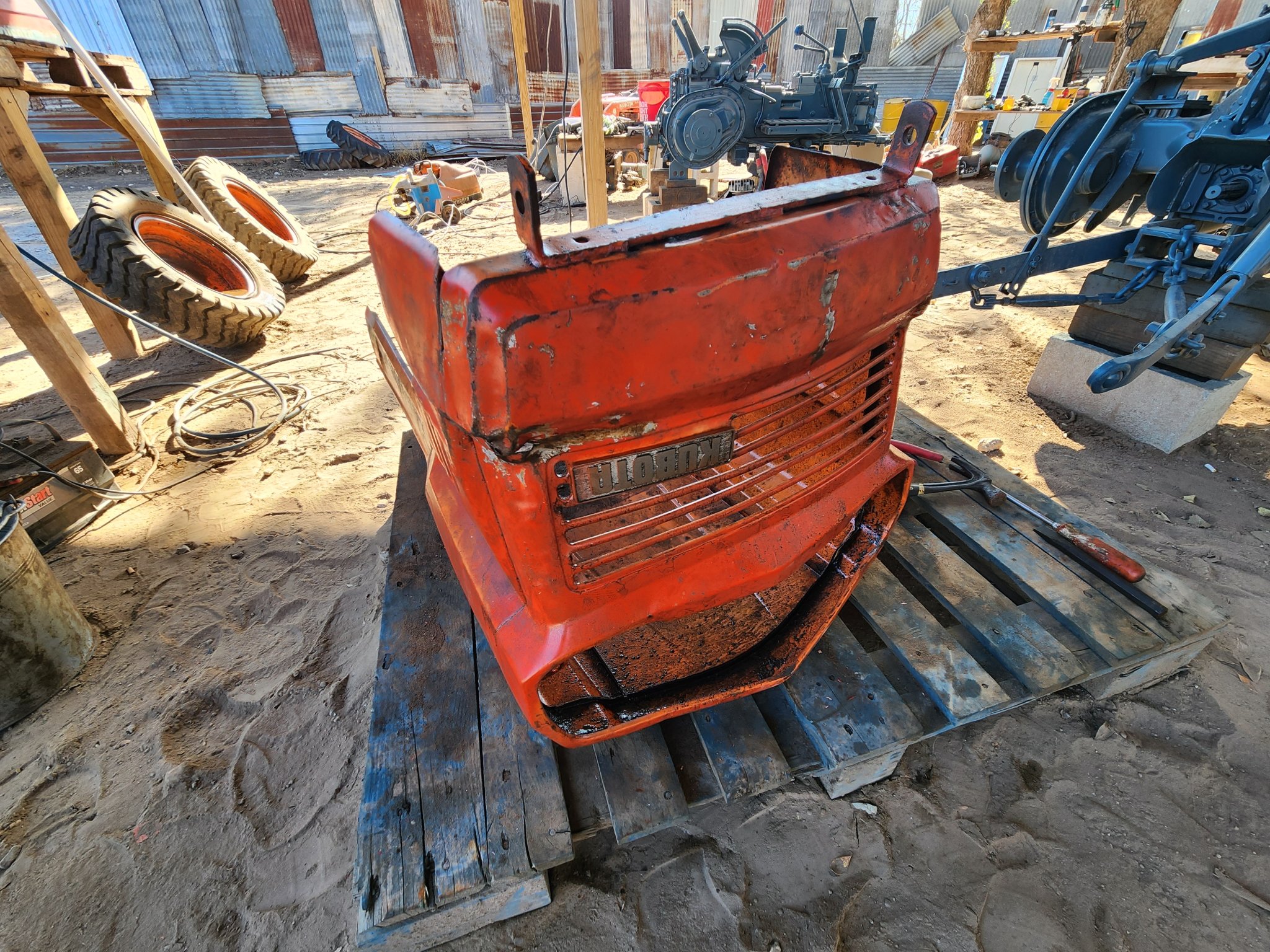

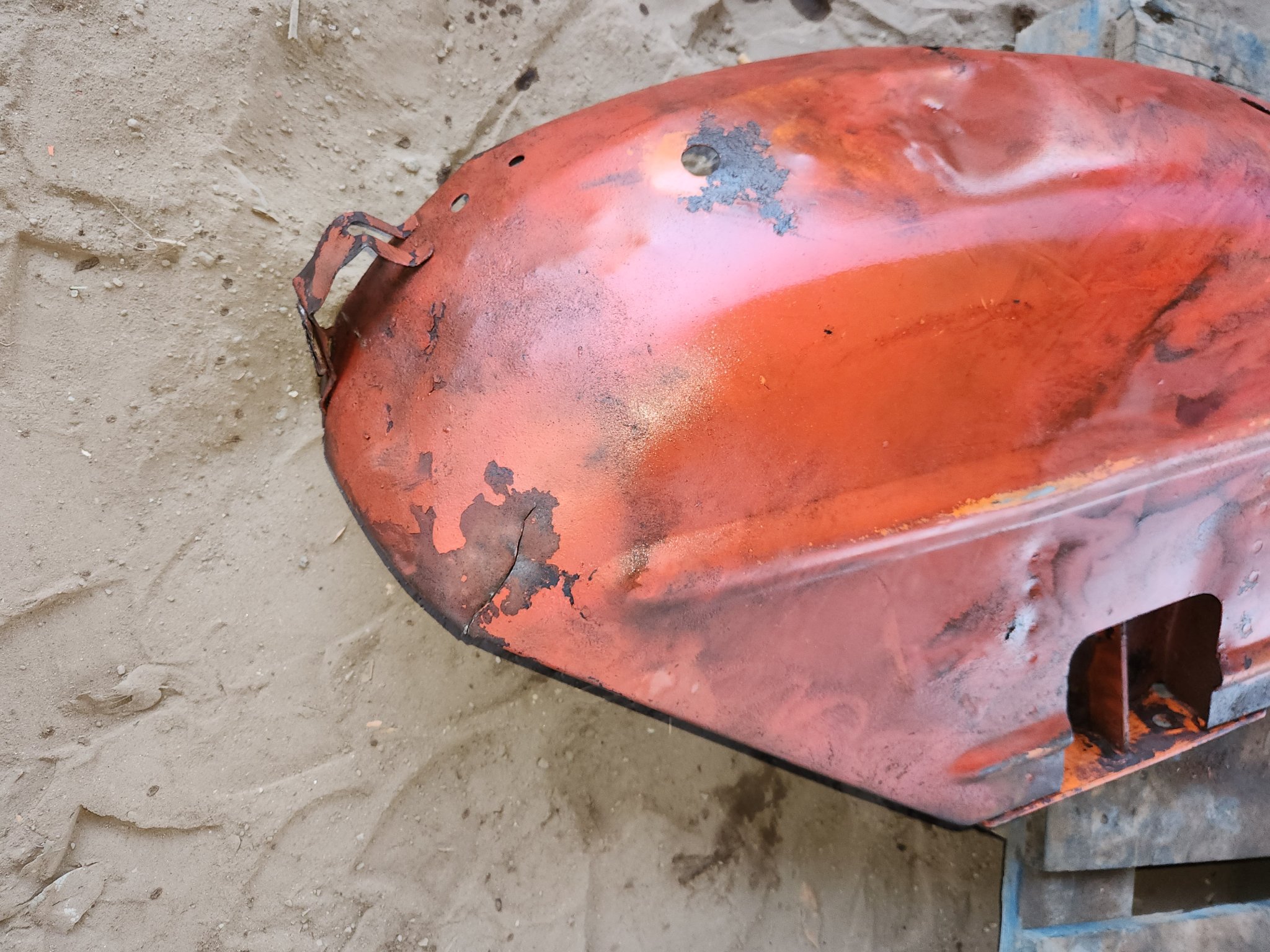

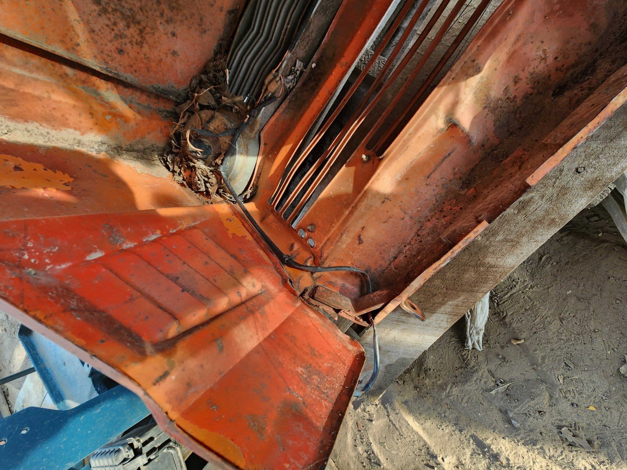

tears in the hood: hammer it back into place using 2x4s, set it up for weld
fender damage, not much, but hammer fender back into proper shape
shop layout: clear everything not dealing with current task, get blocks ready to put under engine and front axle, having trouble reassembling front bracket/air holder, look at diagram

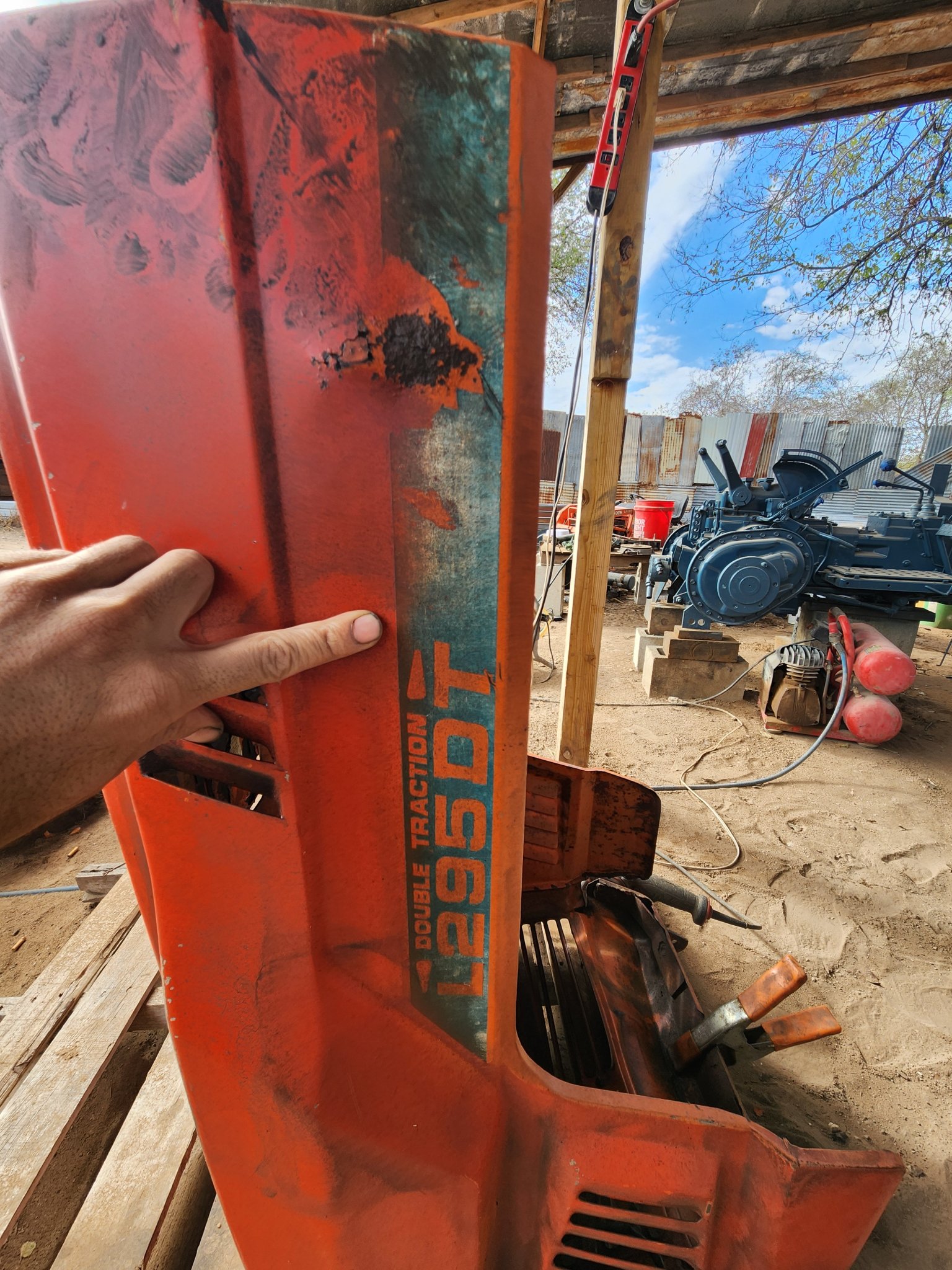

icing on the cake: somehow I would like to emulate the factory decals:
blue strip on hood both side double traction l295dt
blue kubota strip on cover of diesel tank, white font blue background
somehow: use paint and maybe some decal to make that look factory

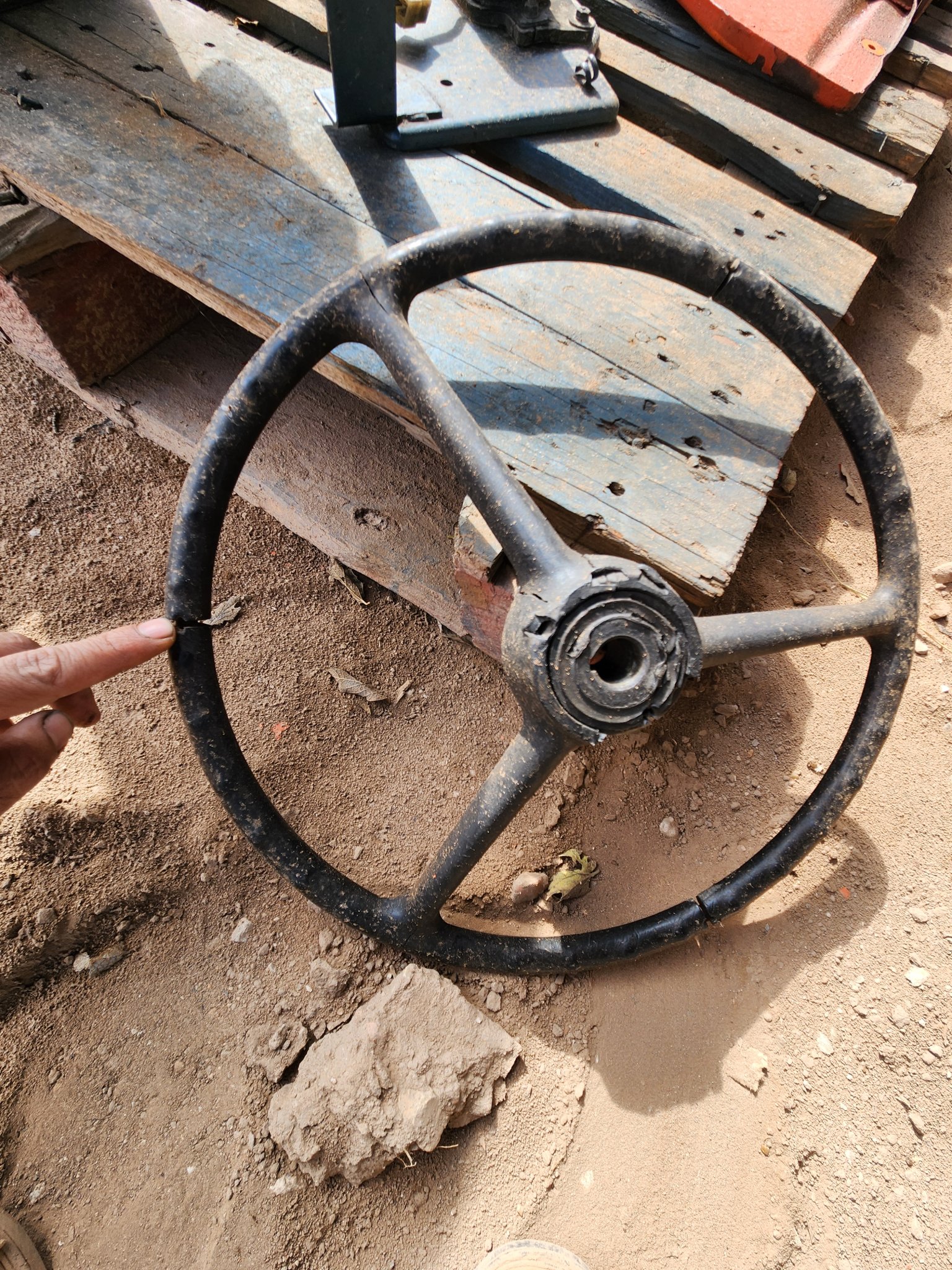

steering wheel restore: i point to gaps in steering wheel,
plan: mix jb weld and fill in all gaps using brush, let them cure somewhat, come in with grinder and sandpaper to smooth them out
both steering wheel and seat need restore

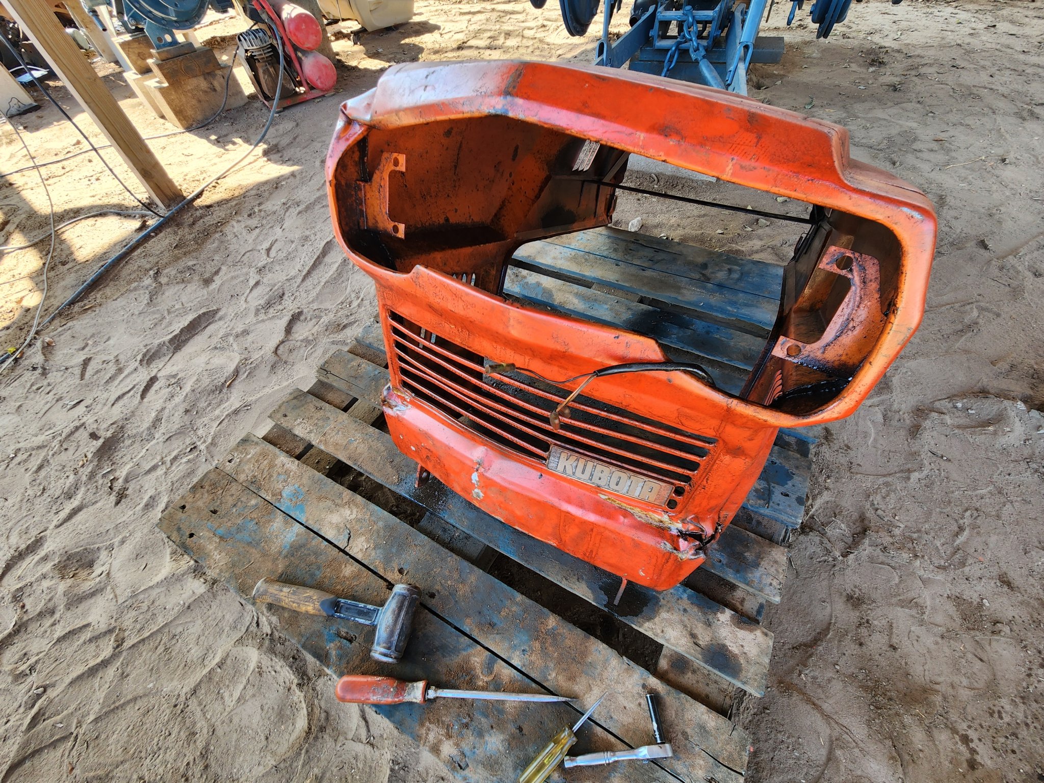

wiring wheeling inside of hood, prop it up get it ready to hammer on dents, get them into somewhat proper shape, maybe take off grill/headlight assembly, then
do the weld using what you have on both side of ripped hood bracket
Take off grill assembly, hammer areas all over back into place
hammer hood back into shape, get to areas to meet where you will weld
clean areas that rip, put weld on each one

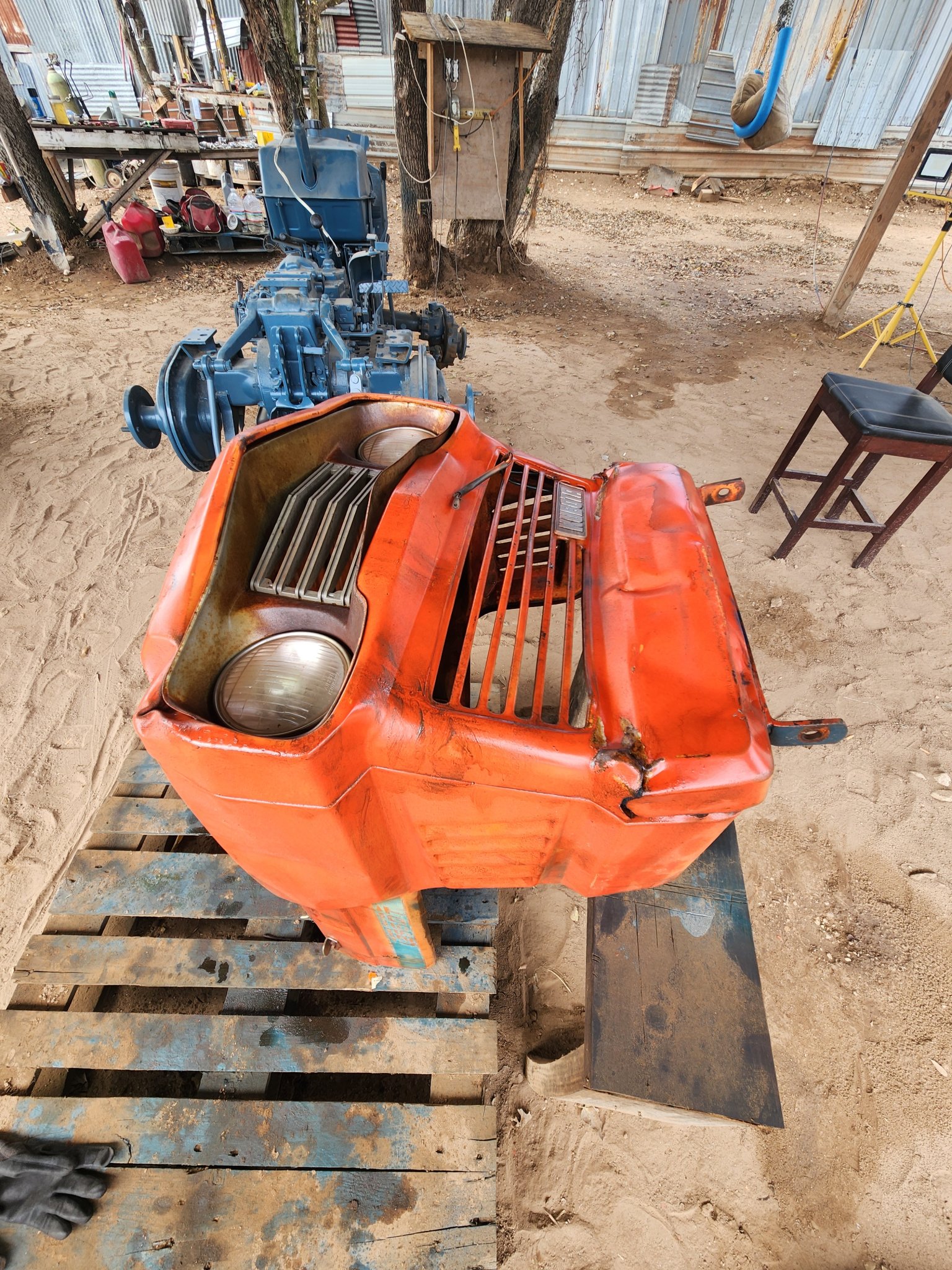

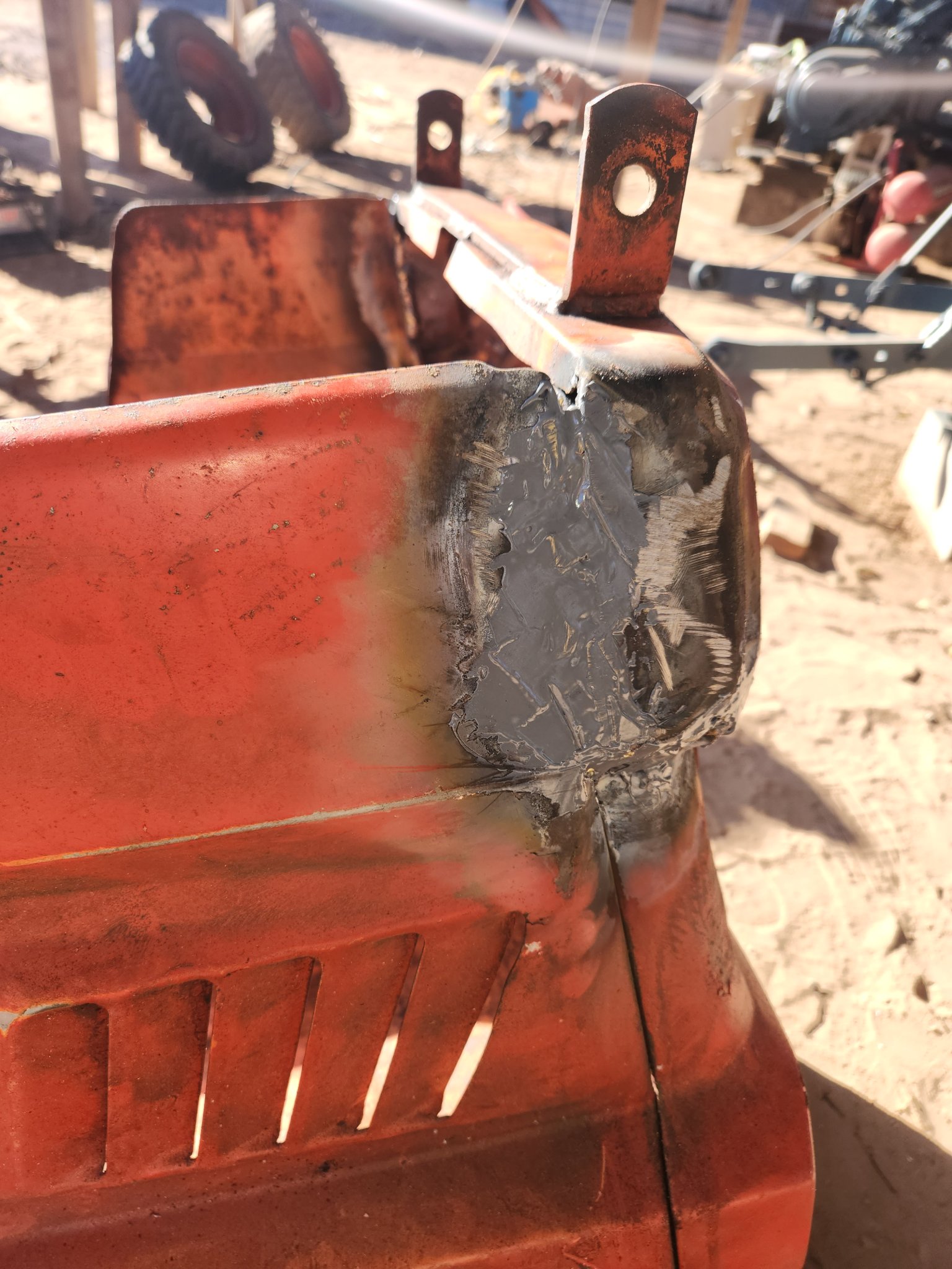

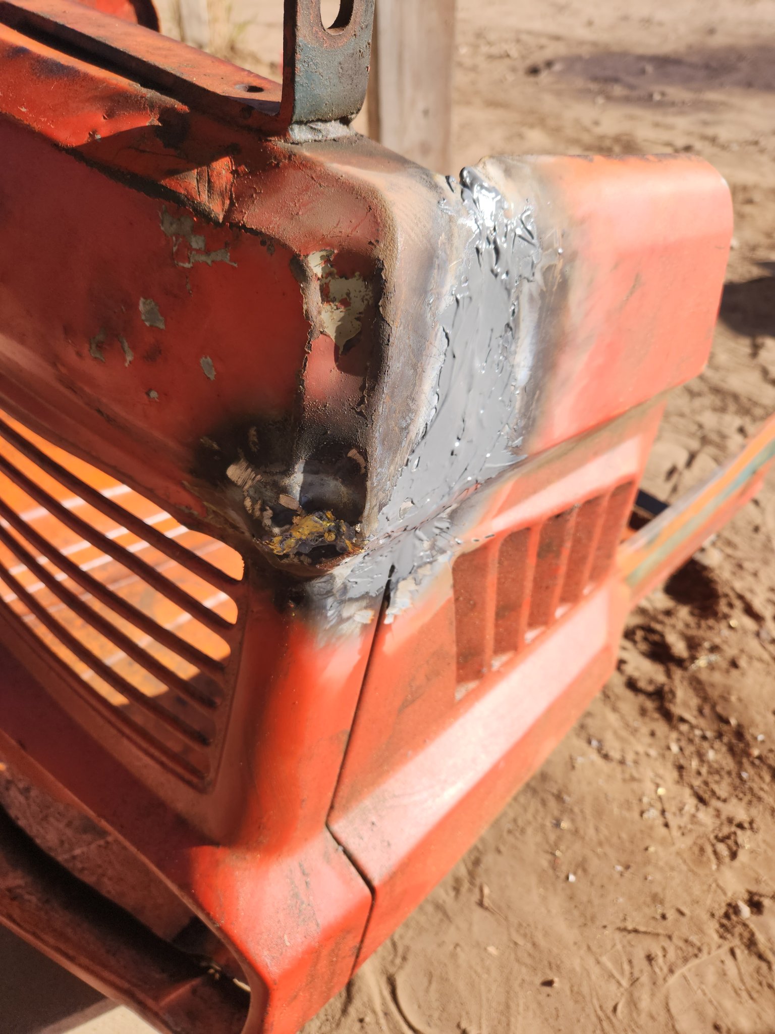

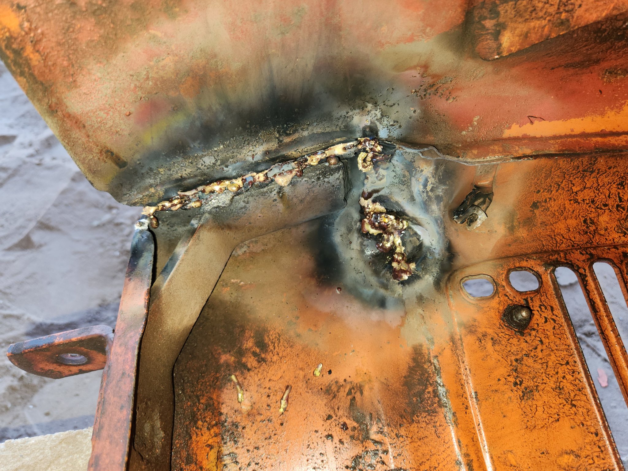

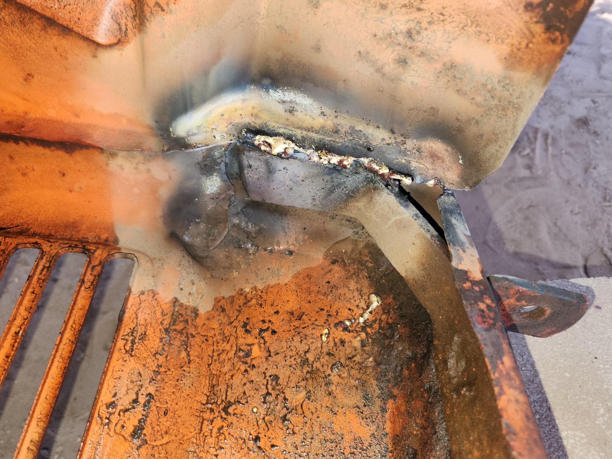

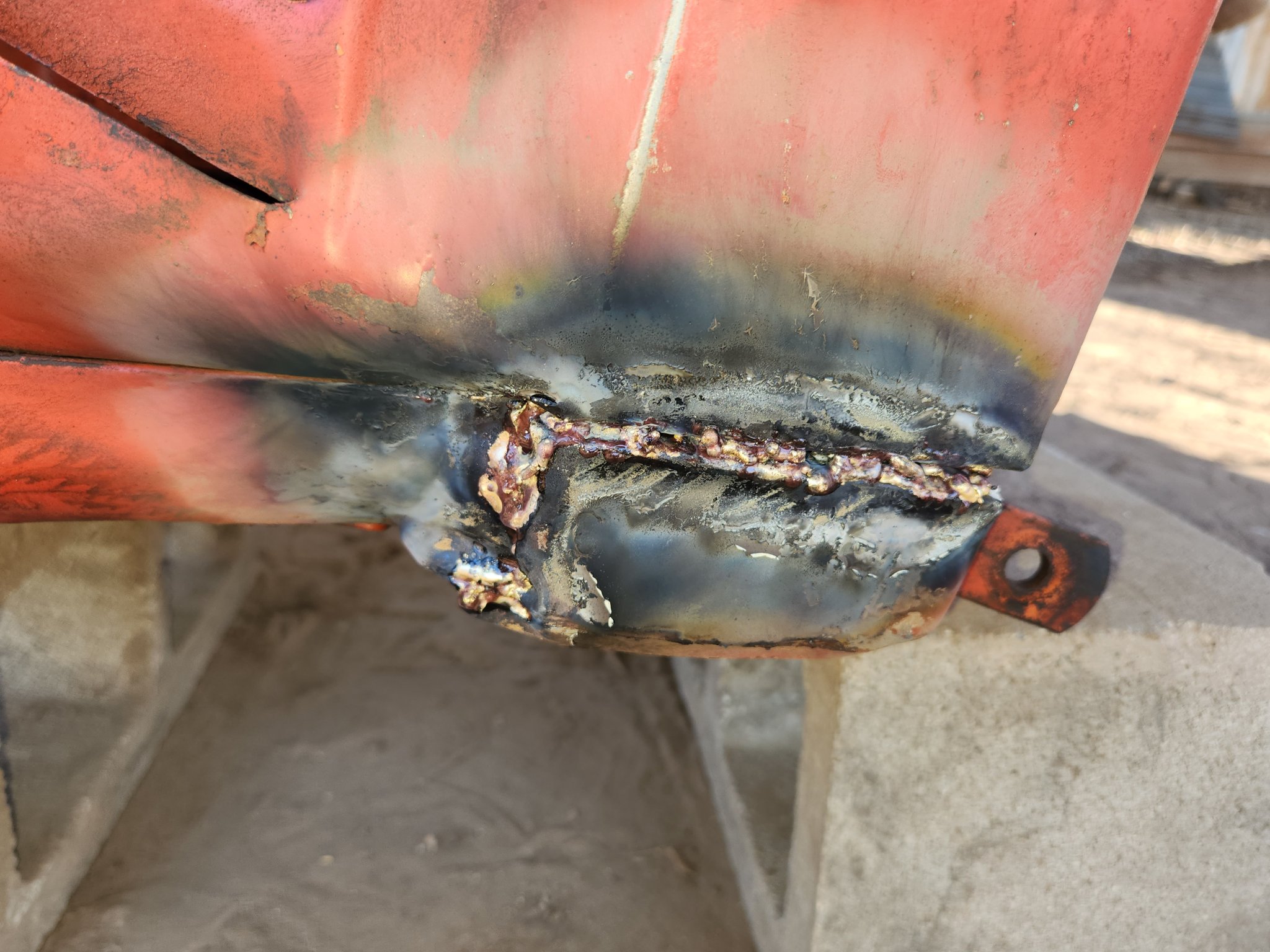

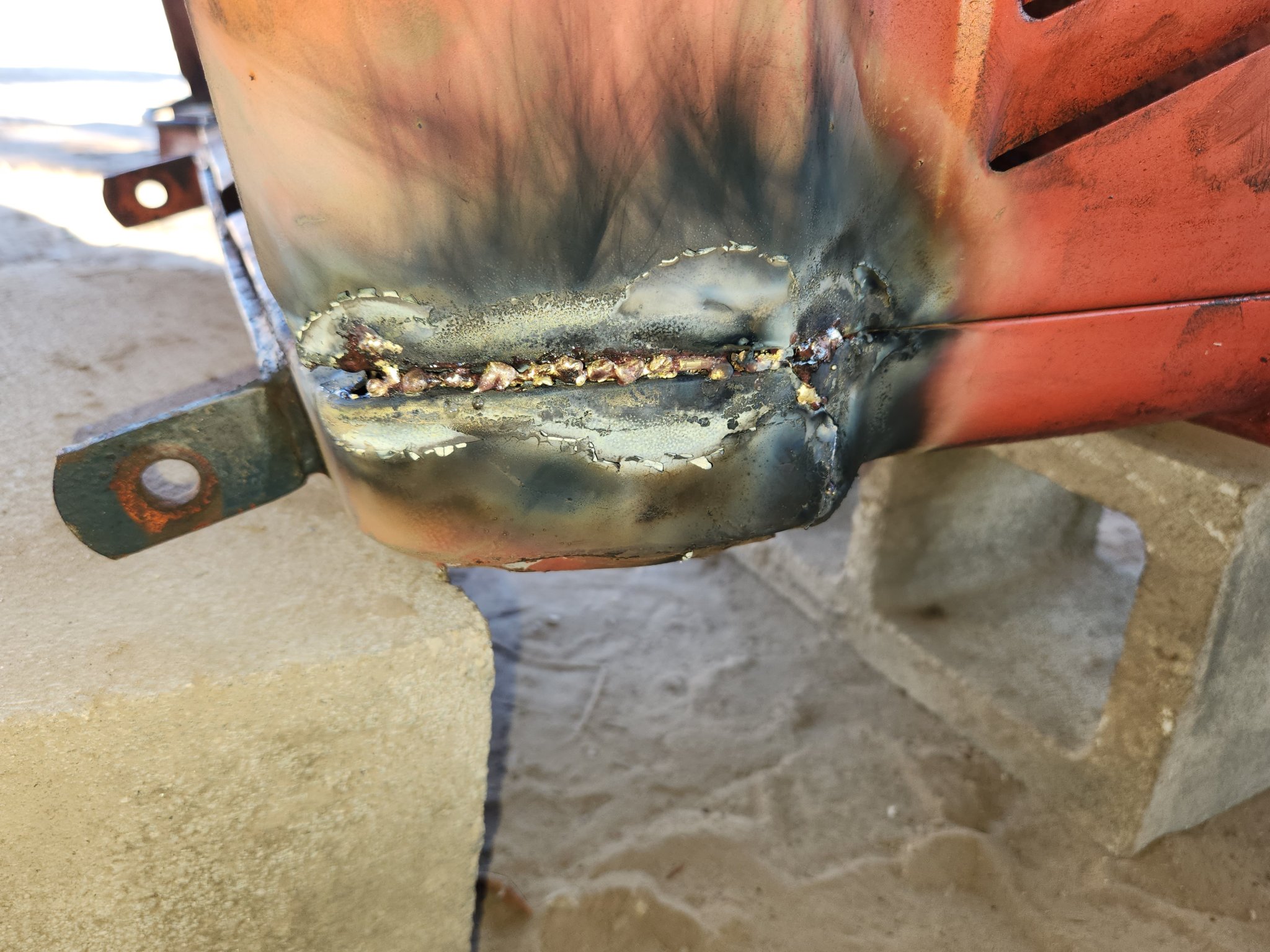

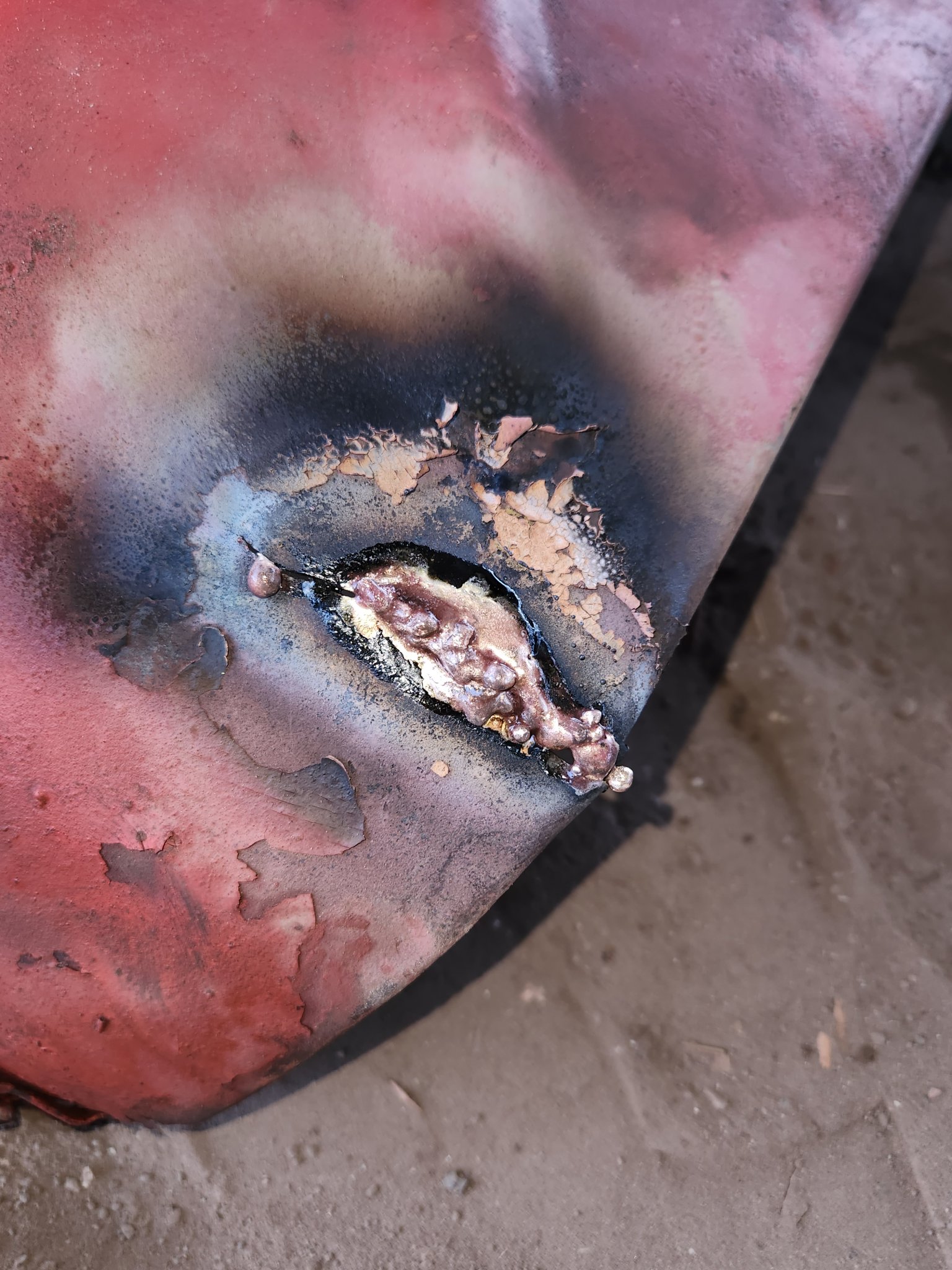

Weld hood, continue get body ready for paint, prepare to split tractor
weld areas clean, bring torch, flux coated bronze, igniter, dark glasses, open acetylene then oxygen
now: put pressure on areas to come together, successfully bind the 2 areas
got bucket of water close by, used what i learn from the iron skillet, tried to mate the two metal
went through 2 and half flux coated bronze rod
let it cool, see if it hold, hit it again if needed
also, hammer on fenders and do the same weld on torn metal
flip hood on its side, use gravity to form puddle inside crevice, right hand pointing flame down, left hand pushing bronze into intended areas
hammer on fender, shape back to original structure, do same weld on the tear
hammer all over fender, get back to shape, brush solvent area getting weld, hit with compress air, use gravity to make puddle on the tear
got puddle inside crevice, big heat and rod pointing sideway, aim at rod melt it into the crevice
now: grind down all the weld, make sure they hold good enough

Weld holding tight, split tractor in depth
used 4 rod bronze, grind down, then slap jb weld to fill gap
all the welds holding tight

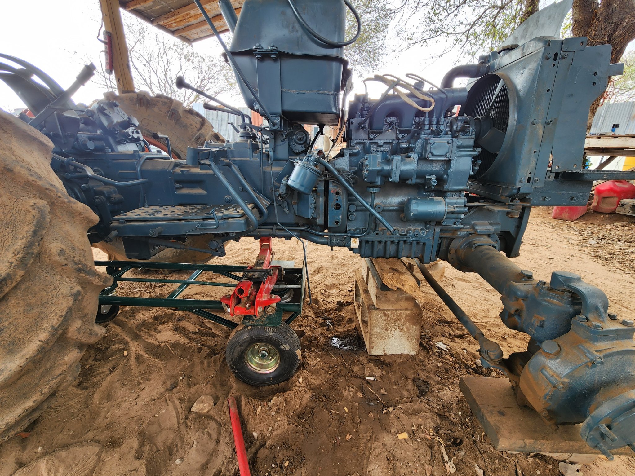

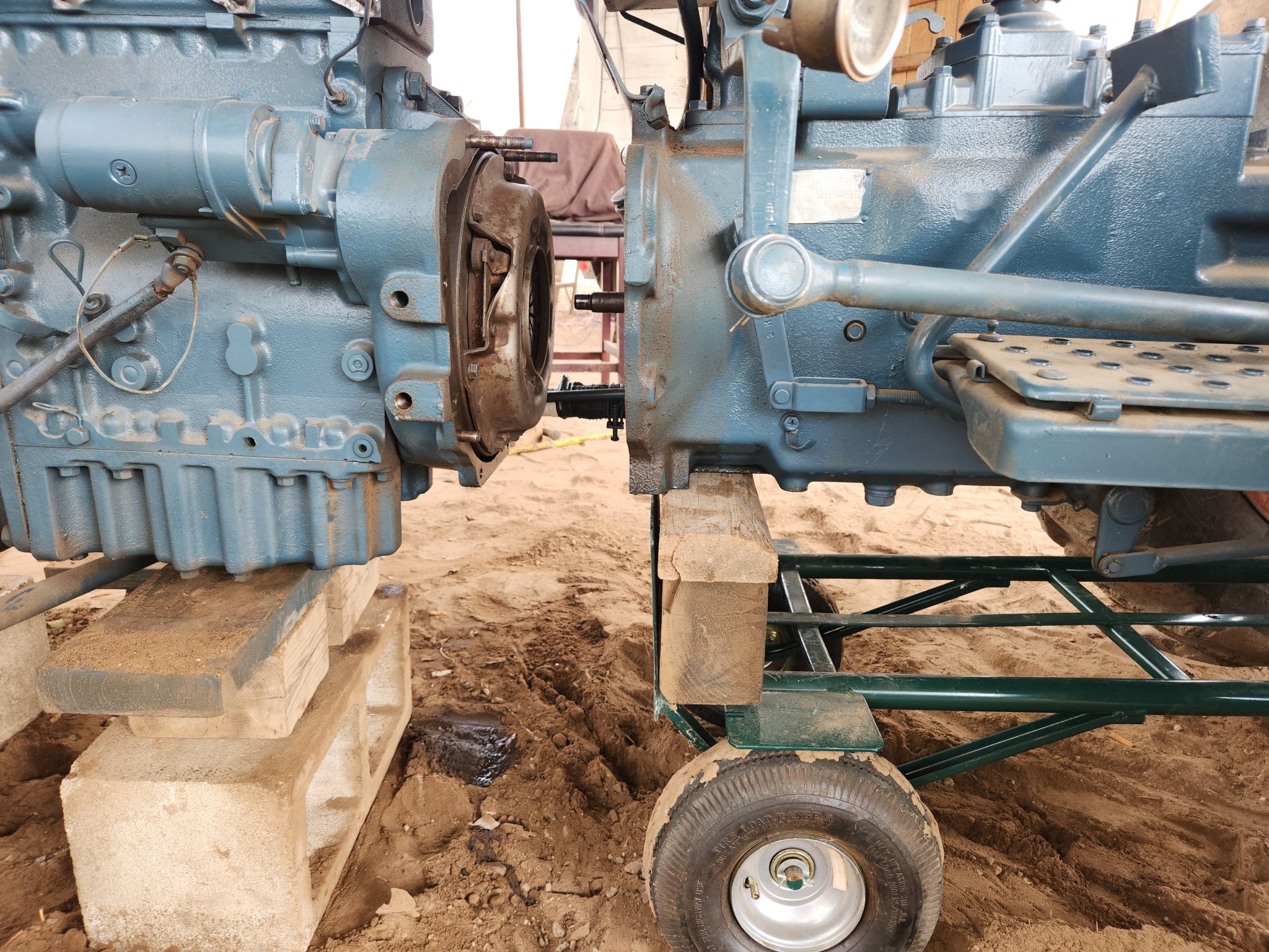

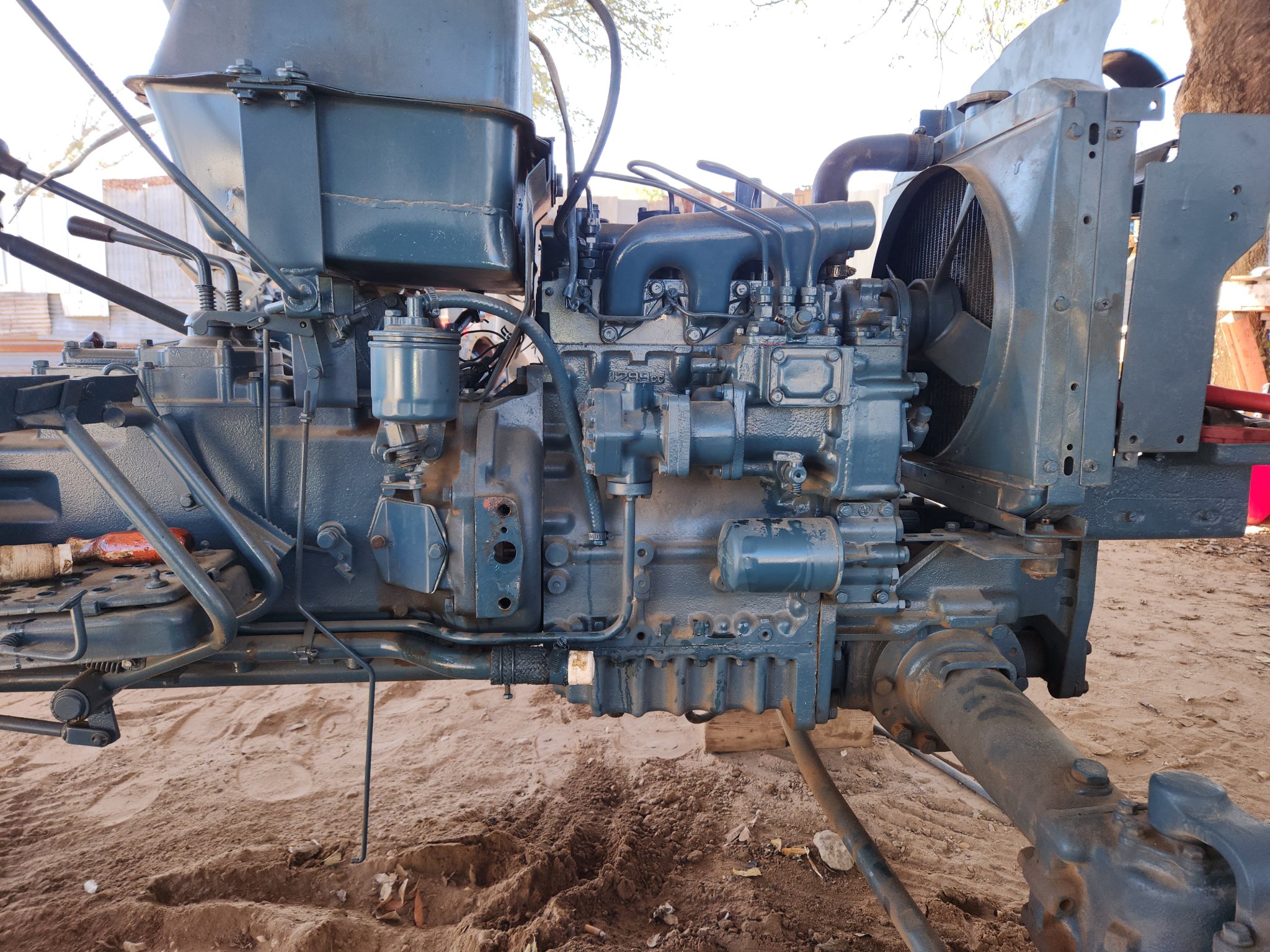

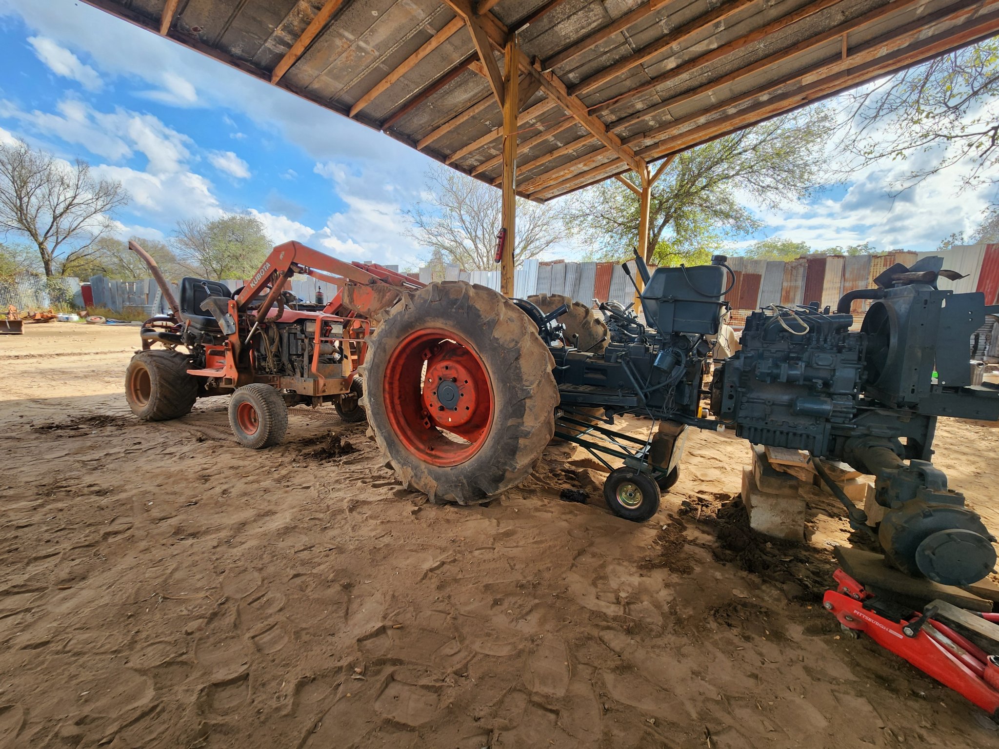

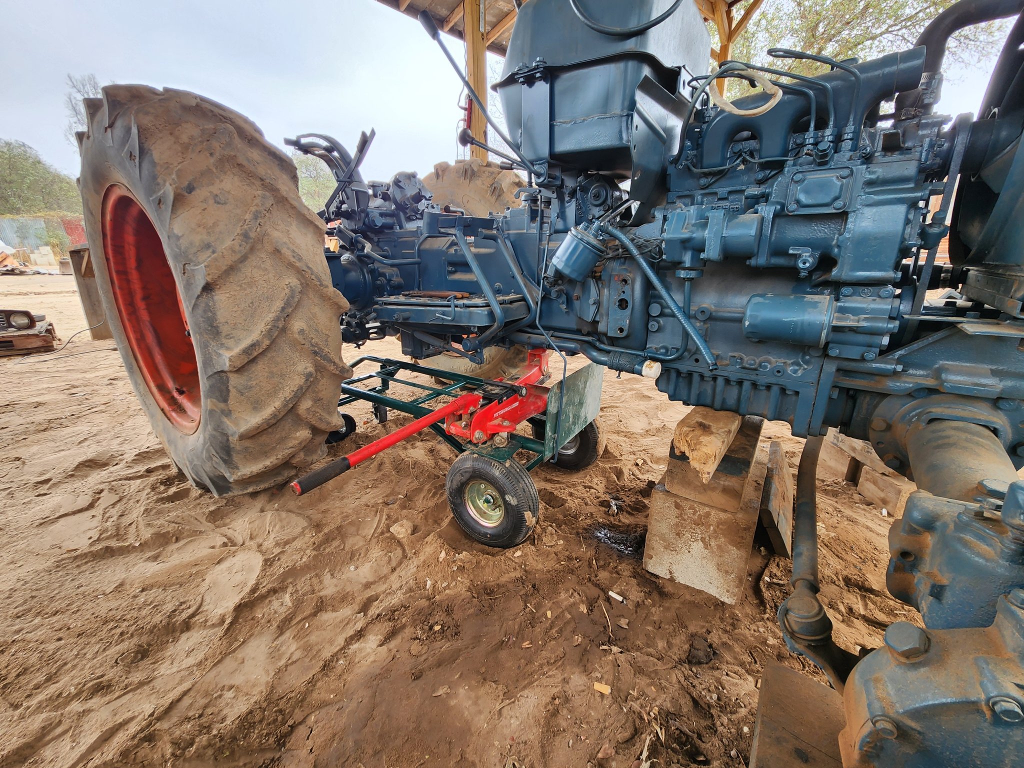

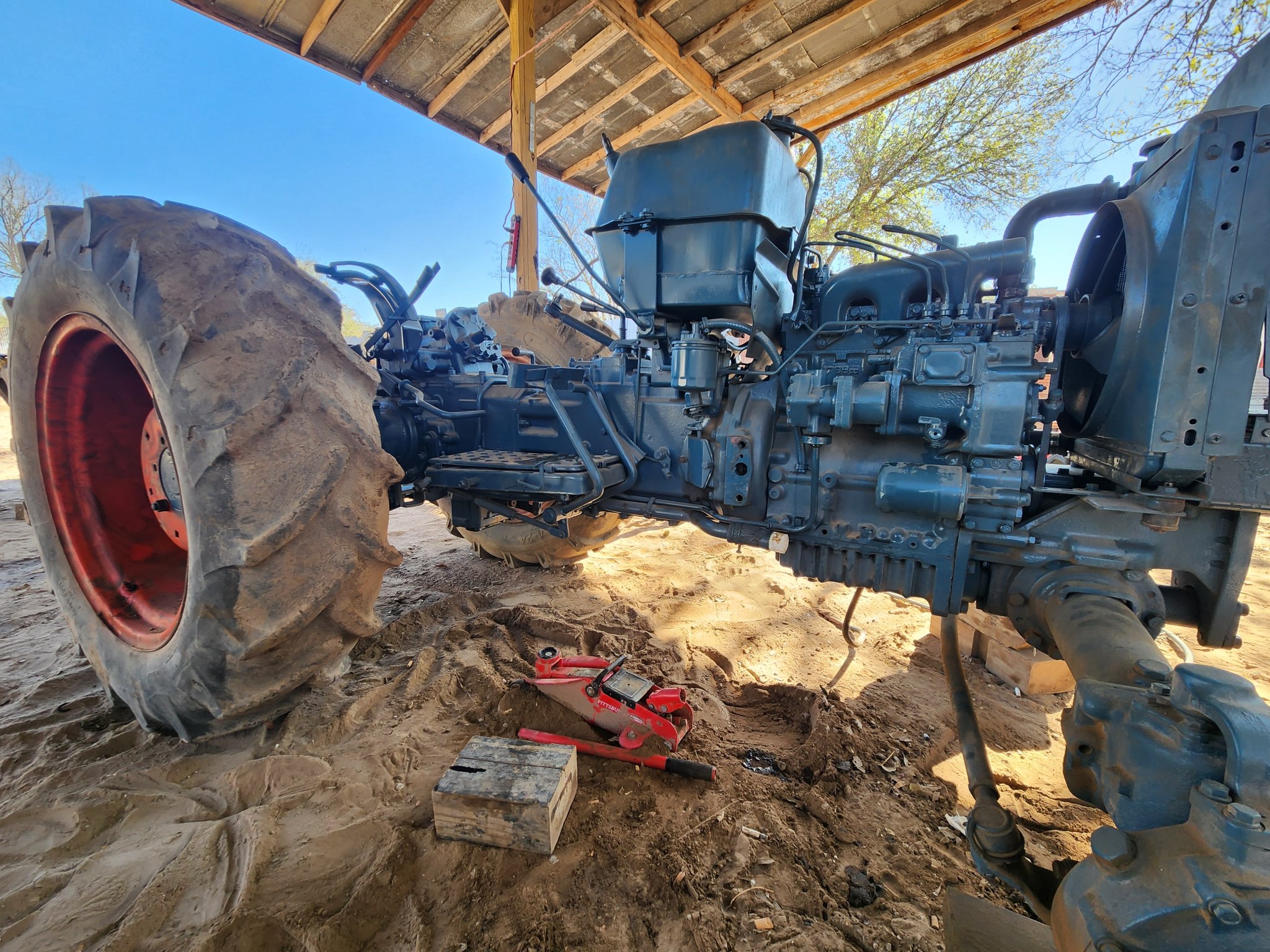

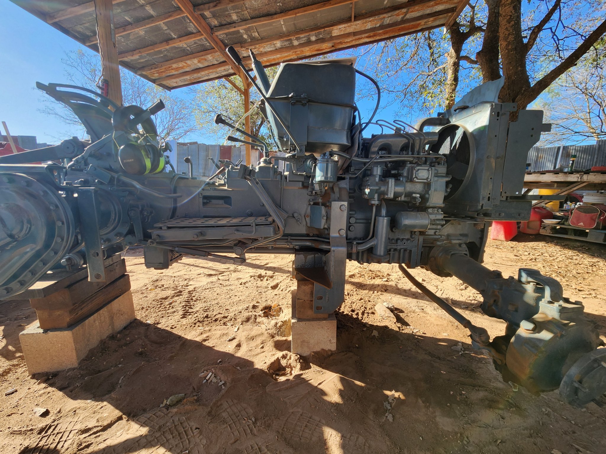

splitting tractor plan:
secure under front axle and engine, do not block the propeller shaft
disconnect: throttle, diesel, 2 transmission line, exhaust, steering, front propeller/axle shaft, then
place the cart (I imagine it is on four wheel) under the front of transmission, unbolt the bell housing (8 bolts), then
the front of transmission drop on the cart, engine and front axle stay in their position since blocks are holding them
put rear wheels on tractor, then roll back the transmission half of tractor away from the engine/front axle half of the tractor
please give tips if you can, and let me know what that cart is called or how tog get one cheap
someone in this thread has mentioned that "tag a long", manual winch tool that I been meaning to get
then I can put pickup truck behind tractor, and attach that tag a long, ratchet them pulling tractor away from engine, then
when I want to push tractor and engine back together: run the manual winch the opposite direction, hook it up the trees in front of shop,
then tighten it and it would push tractor forward into the engine and they would mate
easier than with using bx1500 bucket

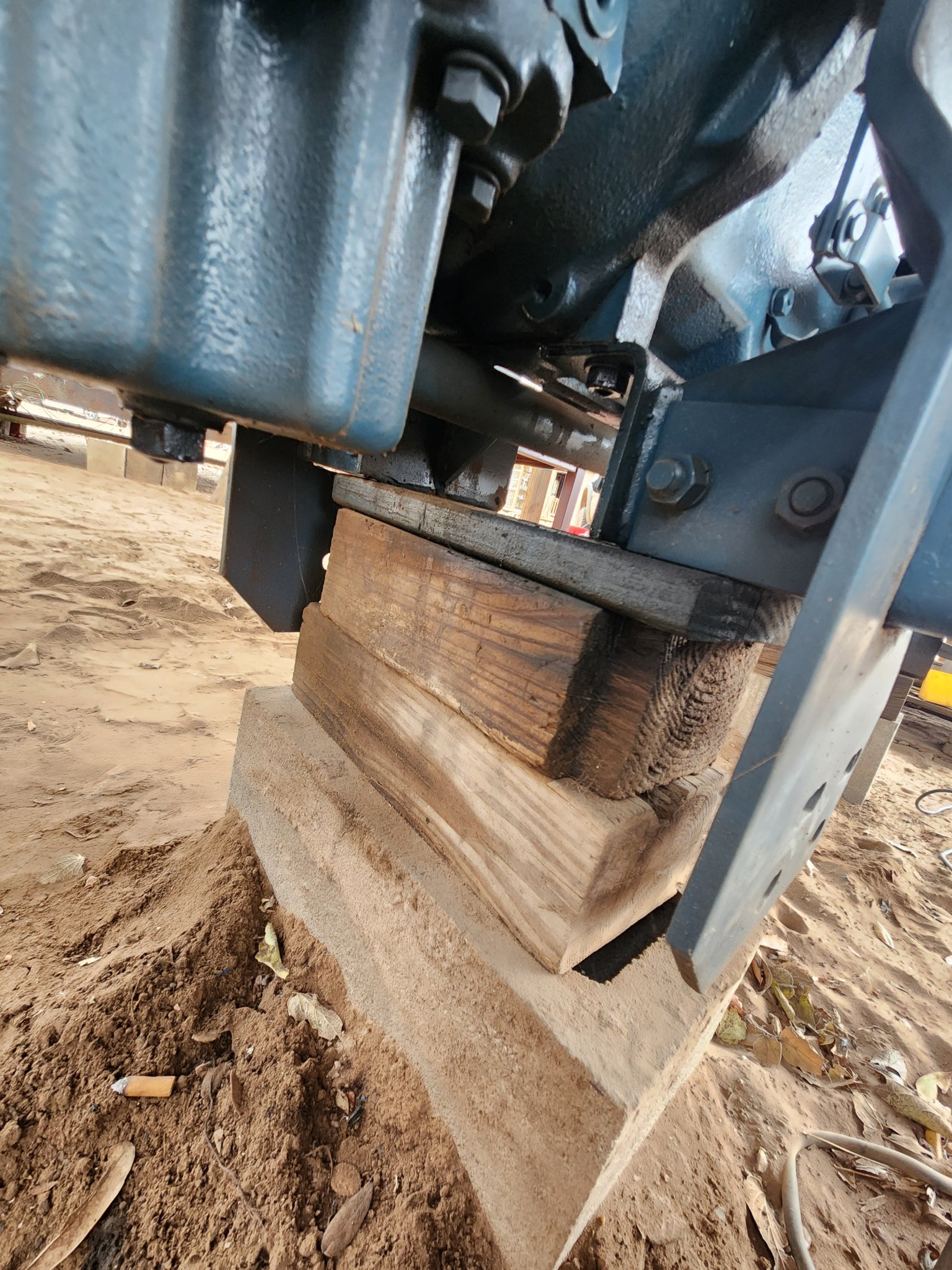

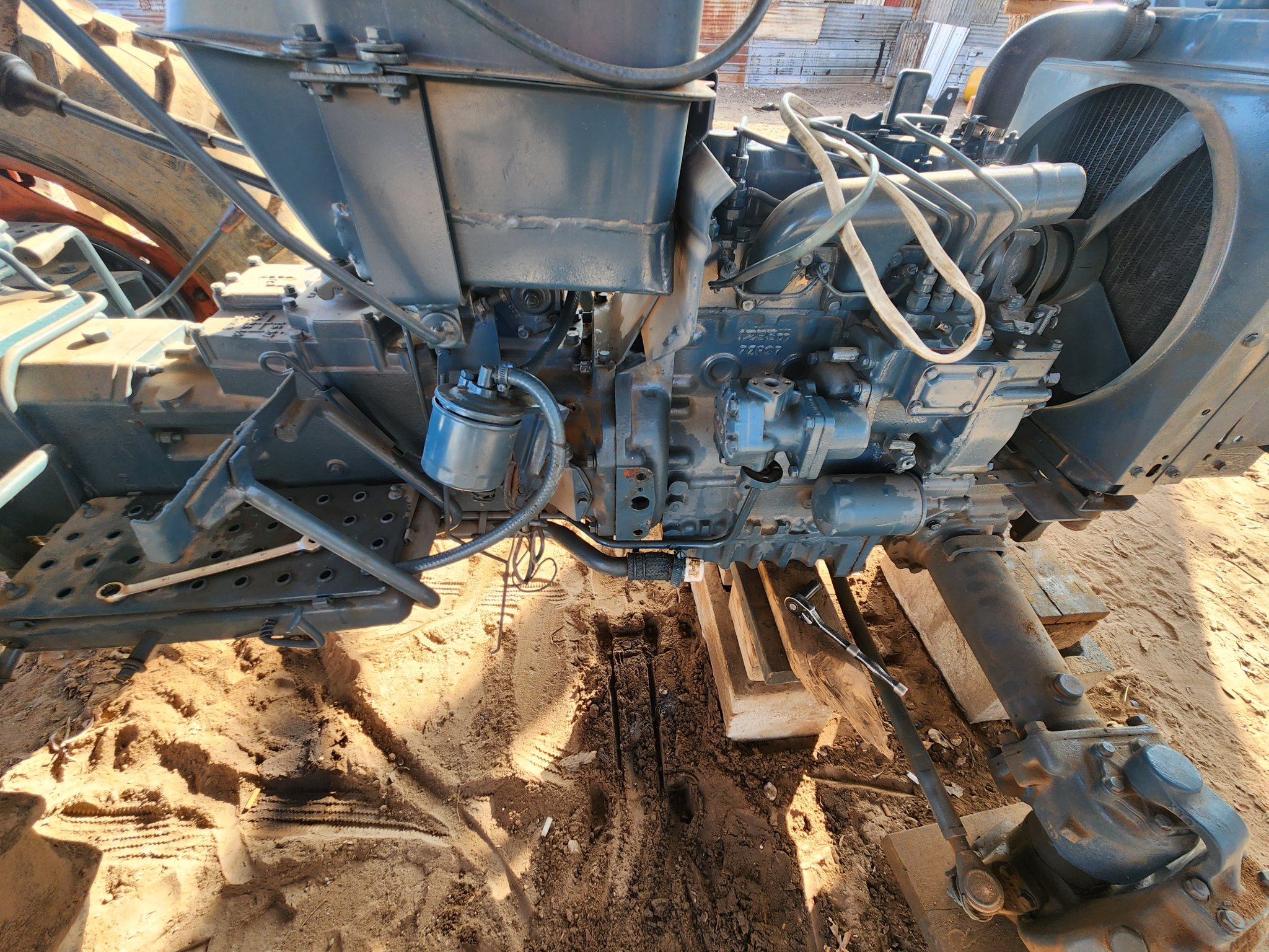

task to do now: get blocks under front axle and engine, disconnect all of those connections between engine and tractor, then later
figure out the cart/tag a long purchase
my mind eye say: this talent is one of the most useful, where you can be a sniper and get to problems without too much dissassembly,
you quickly can separate machine get to the solution safely and low cost, and add big value to your usefulness

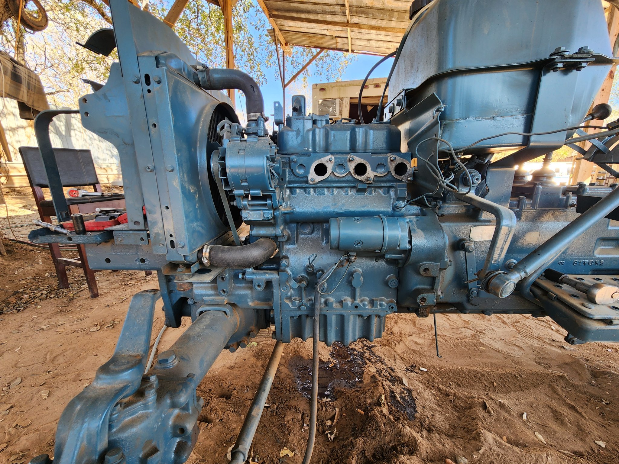

Lift front of tractor, place block under front wheel hub
remove: loader brackets both side, diesel, throttle, hydraulic filter, hydraulic line, entire exhaust, steering link,
plug transmission line, next:
only thing left to remove is propeller/front axle shaft, then:
put blocks under engine, then at that point:
take off all bolts but the two stud holding engine, then maybe:
put rear wheels on, then it would need that cart/tag a long winch apparatus

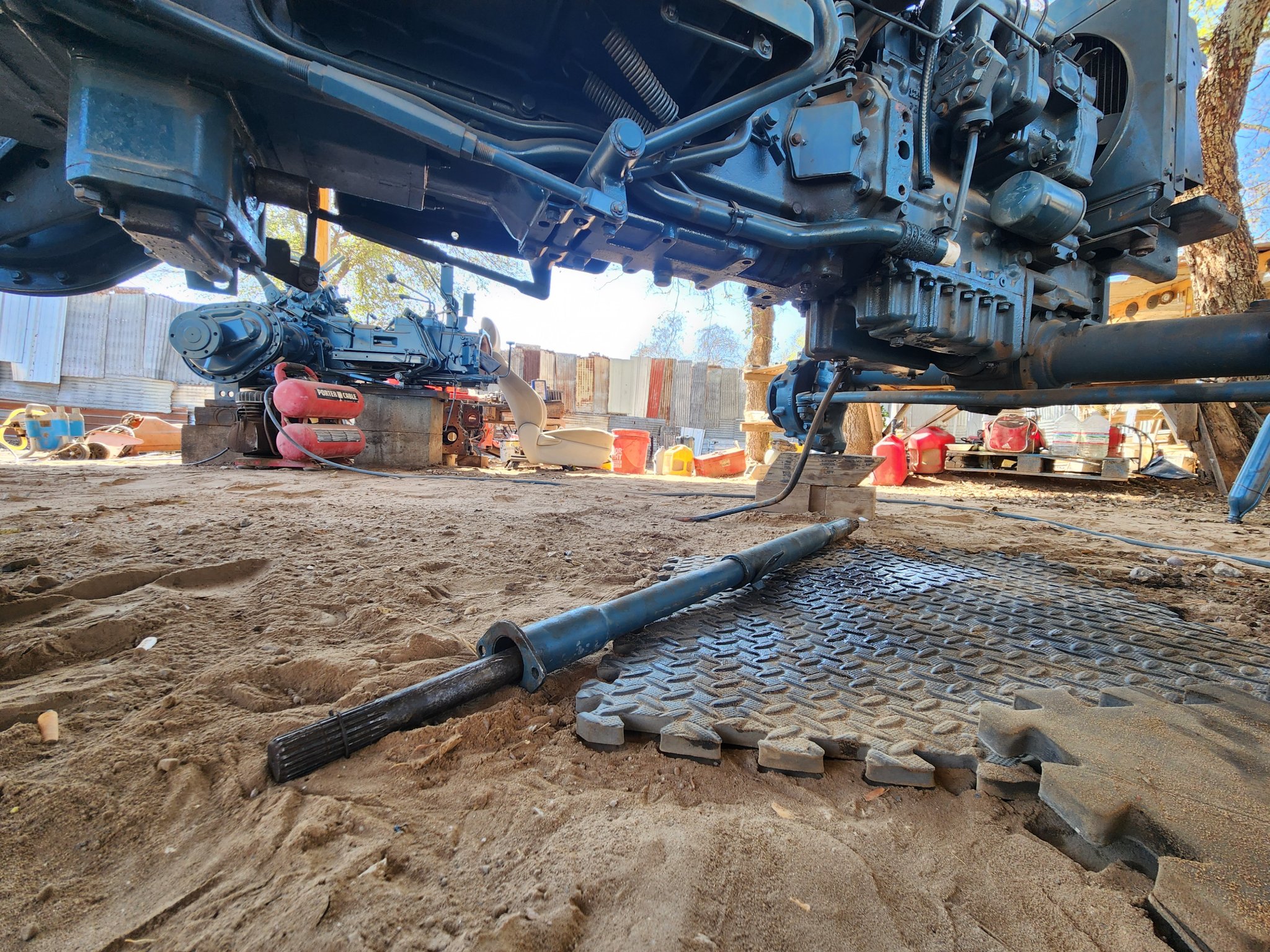

now: take off propeller, but blocks under engine

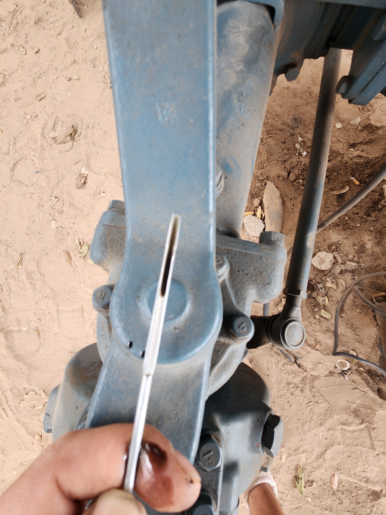

cant take off propeller shaft, I remember being able to take it off before at this point, plan:
slide the cover all the way down, get really good grip on the axle shaft, hit hard with sledgehammer
remove propeller and shaft, had to hit front part with torch and apply diesel with brush multiple time
ton of grip on shaft, slam hard with sledgehammer
was a bit nervous thinking, "did I have to take off entire front axle to take off shaft?" nope, now:

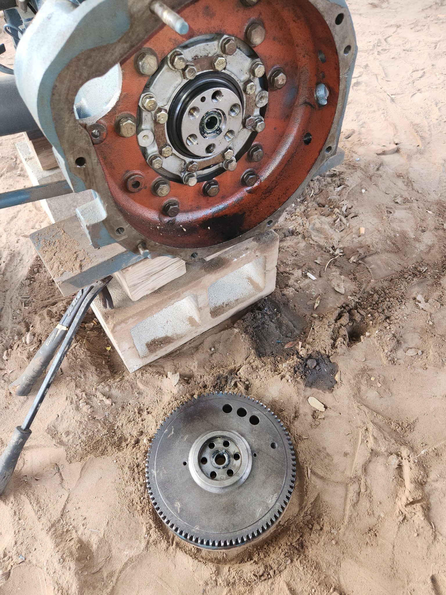

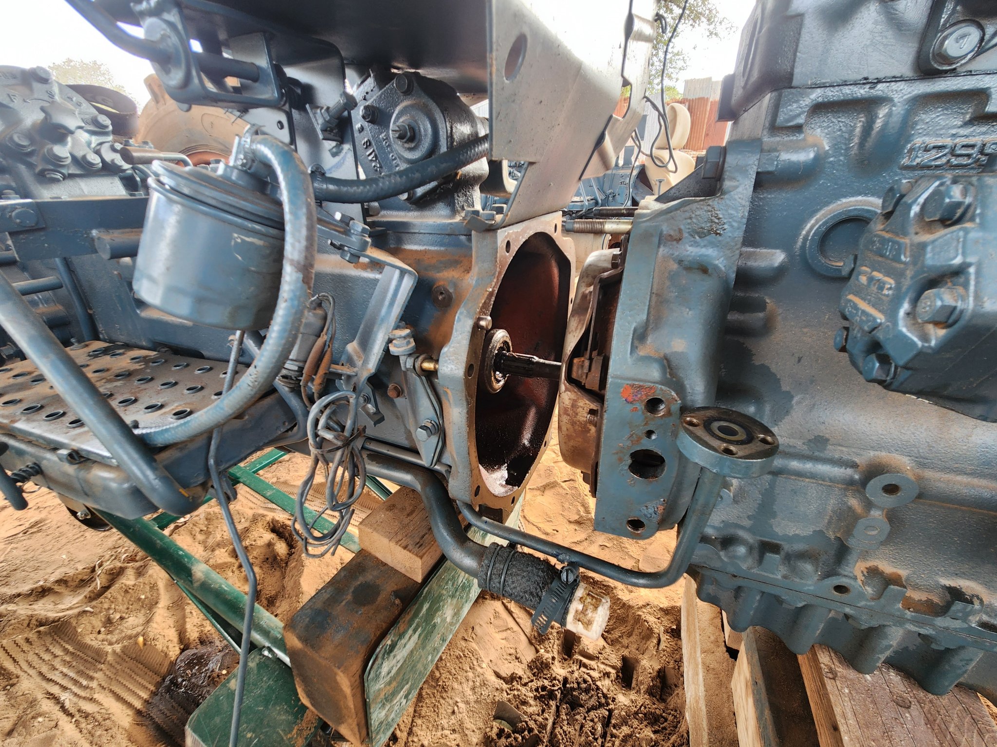

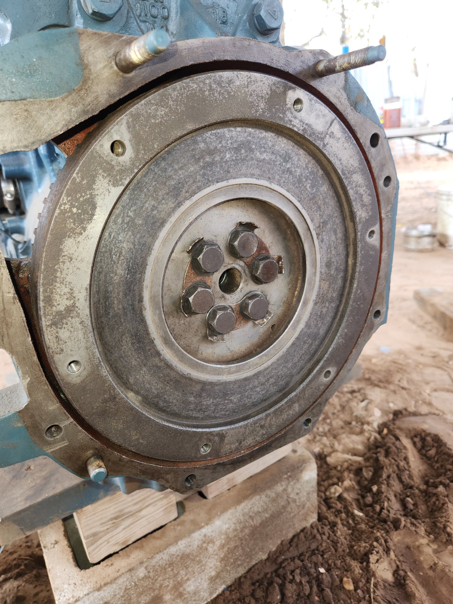

fully ready to separate, ready to:
put block structure under oil pan, put rear wheels on, do something like @D2Cat suggest:
have jack with wheels supporting front of transmission on a flat surface, separate engine and tractor, roll back rear part of tractor away from engine...

Since you have no tires/wheels to support the tractor you need cribbing under the rear housing (you could install the tires for this) , then more of the same under the front of the transmission. This will support the rear of the tractor when you unbolt the engine.
Then place some plywood under the front of the tractor and install the front tires. Put floor jack under back of engine (on the plywood). Separate the engine/transmission and pull the floor jack forward to separate. Repair seal.

Get the metal hotter before you apply the filler rod so the filler will flow in rather that lump up on the surface.
Or there's contaminants aplenty.

split tractor setup
got moving dolly with 4 wheel, can roll on dirt, then place cheap jack onto it and push up on transmission, all bolts removed, pull on tractor, engine should fall on block structure
this is the tool i reference, its called winch puller, i see others use it to do this nature work
move stuff out of way, bring bx1500, connect winch puller to bx, ratchet tool, pull tractor away from engine
Almost separated, but a bit nervous that engine might want to flop forward, might put more support under front axle
separate 2 entity
Video showing you the split moment
attach rope from bx to the dolley, took off trailer winch off of tractor
pull on dolley, rolls easy and stable, and straight
the engine: now get inside and do the surgery, while I do that -
Can we run engine exactly the way it is shown in this picture? maybe:
put a strap on it hold it tight, rig up diesel to it, run it for hours and hours until all leak fix, then recouple entire tractor assembly
My instinct say it is not dangerous, but I listen to yalls input
yes, take off starter, lightly tap flywheel, opposite side put crowbar, slowly work flywheel until it fall on the dirt
The culprit area: from what I can tell, the leak can be fix from at this point, no need for more dissassembly
There is a new kubota seal somewhere, I'll find it,
Take out the seal: clean area, apply gasket maker, install new seal, back into position, then gasket maker on top all in one shot so it form one piece, let it cure a day
edit: although no other leak visible outside of the seal, you are in it this deep, you might as well:
continue dis assembly, seal up entire area, i try to take out the center area and leave the bell housing attach to engine, seal up anything that can leak...
14,205
6,356
There will be resistance when the tractor is at the point of separation, be prepared for it. If you plan on dragging the rear backwards the front need to be anchored to something solid so it does not fall off the blocks.
Dragging that dolly with a jack on it may be a problem in sand because the tires are not on something solid and their difference in elevation will cause the parts to not release from each other.
If this configuration allows you to separate the engine/rear, how will you reverse the process?

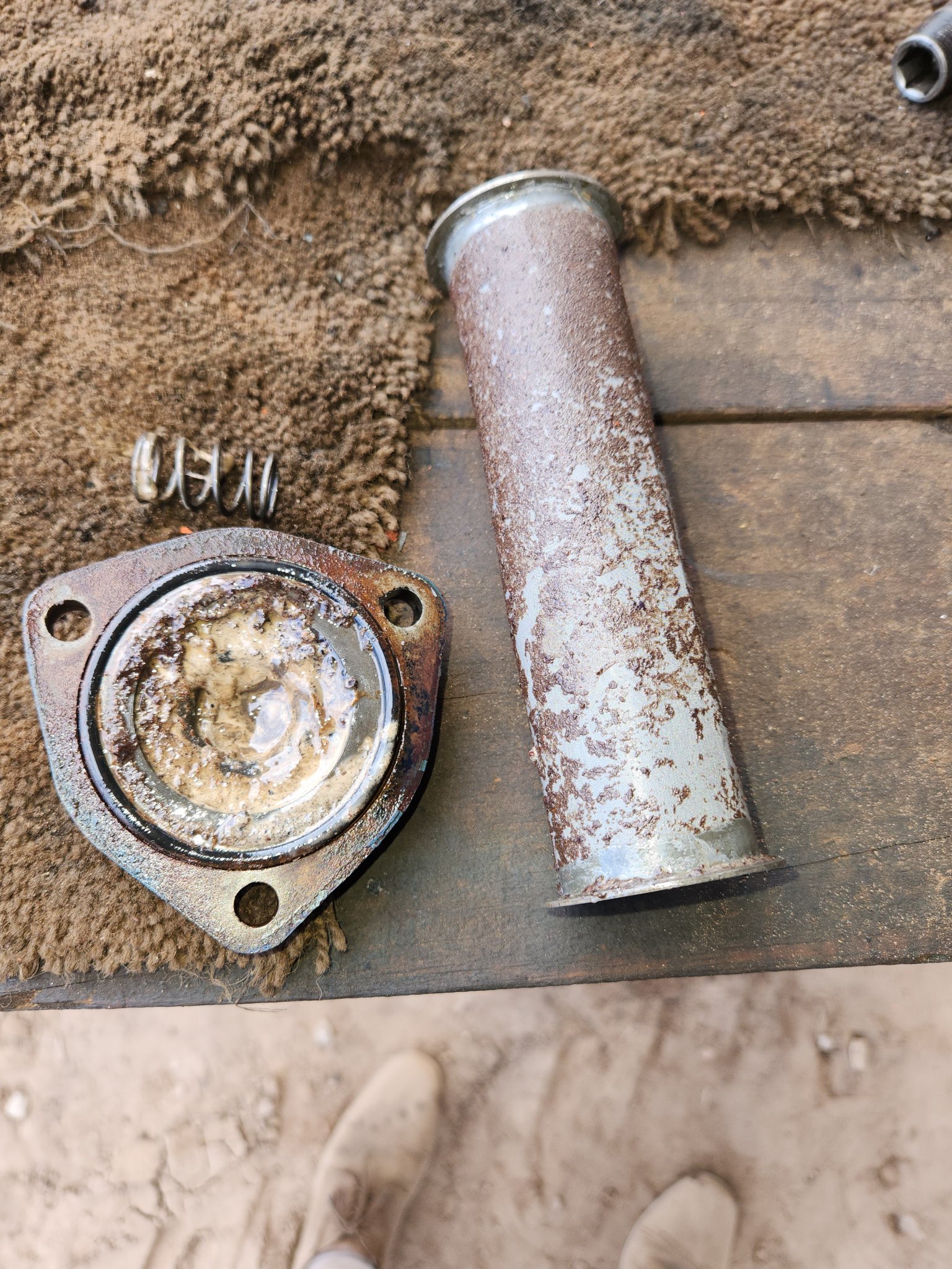

Expose leak
on the cover are two bolts that you screw in and it pushes it out, take off ccover
do comprehensive operation you surgically seal, with real intent
hammer out the seal cover, clean it perfectly, put bead of gasket maker on cover, hammer in new japanese seal, then
clean engine and get it ready for sealing: use brush to apply nice gasket maker on all potential leak area, then put cover on, imagining
that your work is not in vain, that it will seal properly
found genuine seal, heat up old seal, use clamp like last time to push out
surgical main seal operation: fully clean surface, gasket maker, push it in snug
Fully clean surface ready to seal

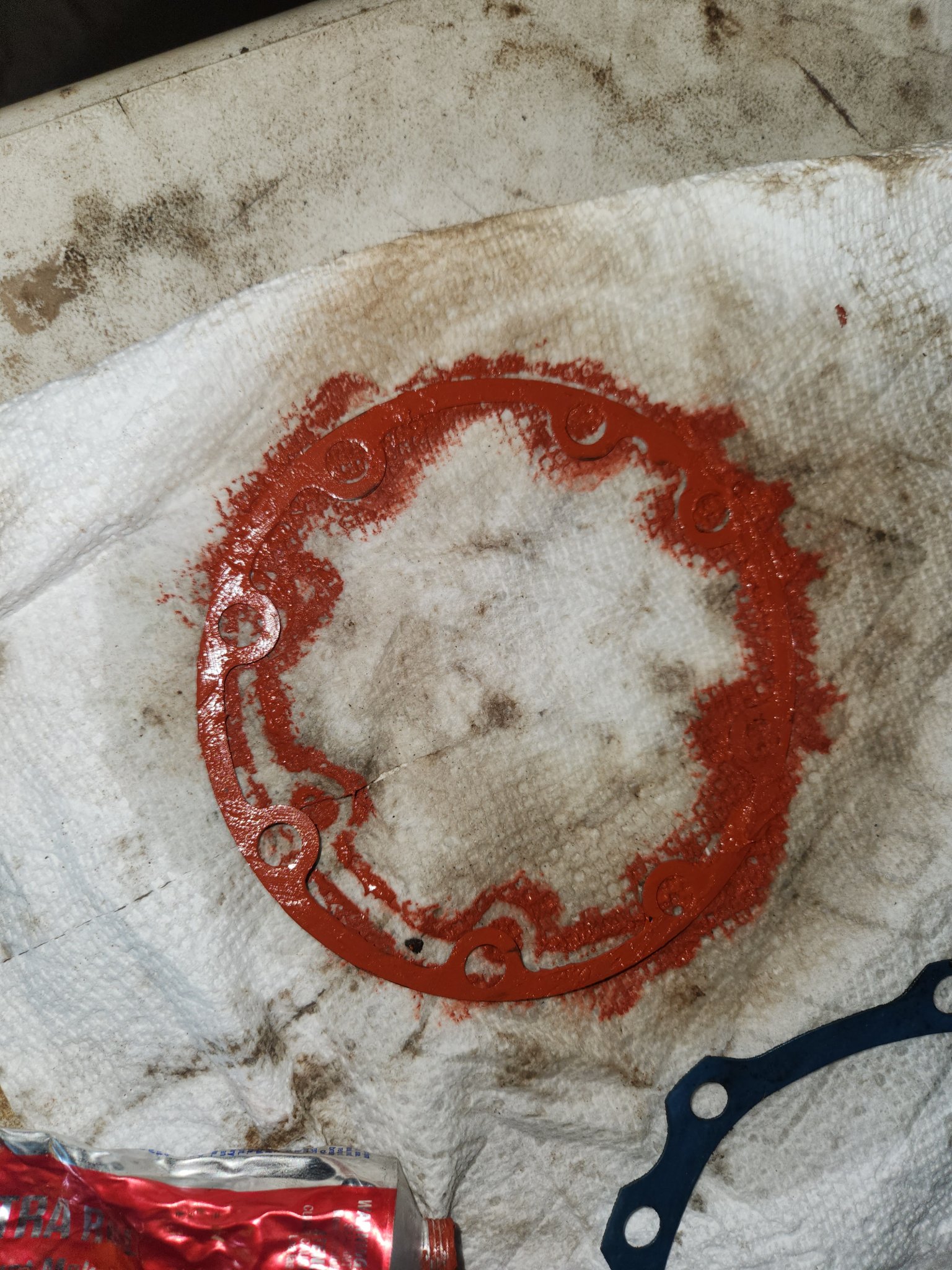

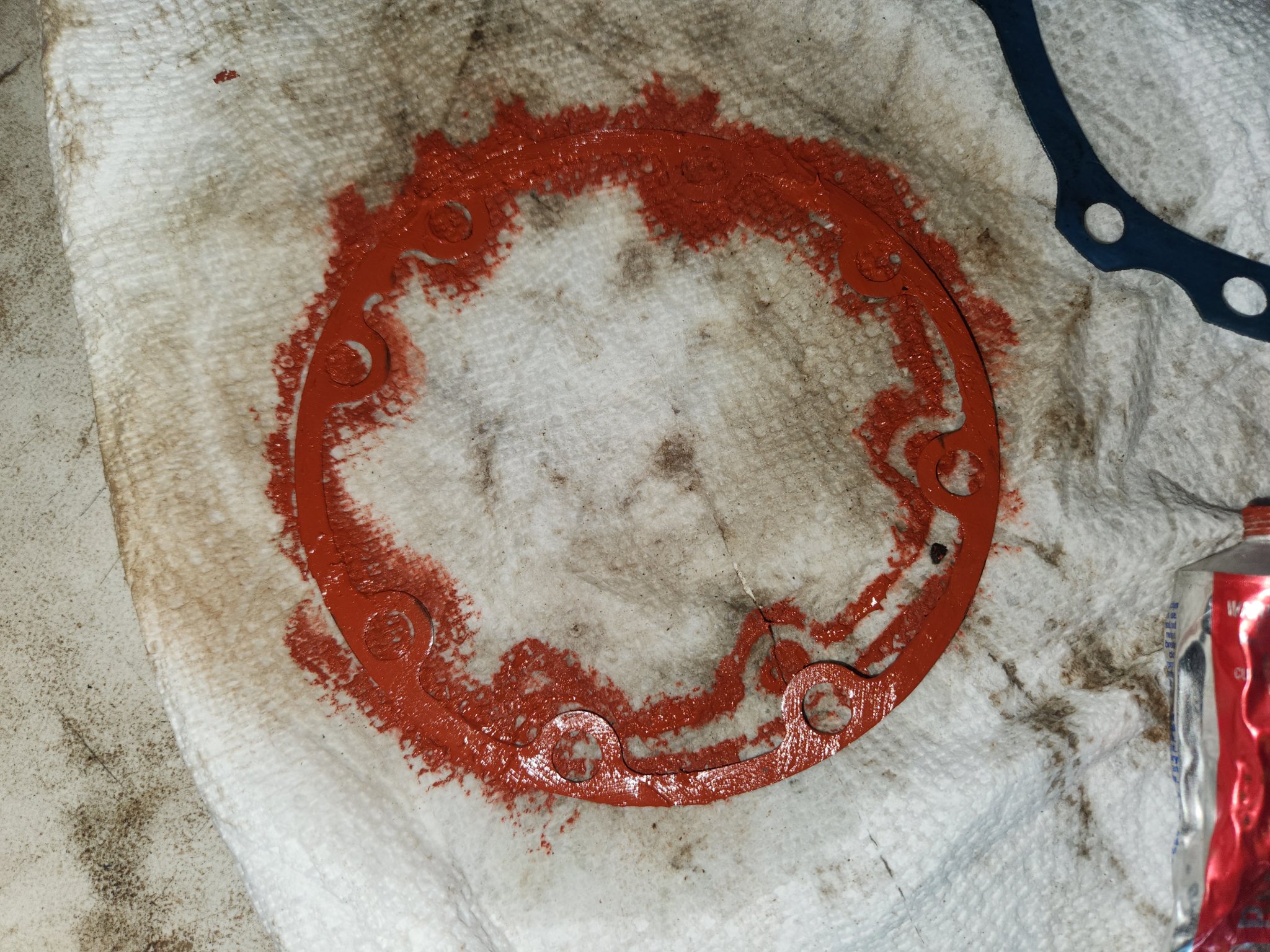

clean outer gasket, use index finger to put on perfectly
inner gasket, same
put both gasket on, line up with bolt hole
the cover: glob on using finger generously
put cover on, tighten all bolt, bend in bolt keeper, then
use brush, finger, and direct application, stab area with firm brush push into all crevice, muttering to yourself,
"no way it is gonna leak, crazy to think that other method had any chance of not leaking"
put generous amount testing theory: just put a bunch on it and eliminate all possibility of leak
imagining it sealing perfectly, and it purring hot hot with no leak
surgical, comprehensive, sealing of main seal leak, could be the one that seal the engine enough to move forward
only mistake: that inner gasket, was to be put onto the cover, not the main bearing case
realized this after i tighten all bolts, who cares, since:
plan is to run it not on tractor until confirm there is no leak, let it cure and see what happen after curing
now: somehow conjure up some energy to run all parts from other engine into diesel, since:
they have been rained on and covered in dirt, and that assembly might not take place for long time, maybe few months
for now: run them through some diesel, cover them from element, cover them with sheet
@Russell King
yes i listen, i notice that now, the cinderblock is sideways, quick fix: lift up on front of bell housing, fix the block
boards in the direction of the travel of the tractor: yes, i still need to work on that setup,
put boards on longways, let transmission sit on them, then yank on the dolly, not the tractor,
it did this today even with my flawed setup once i yank on dolly with bx1500, rolls so nice
today that narrative hit me right in the forehead saying:
"woah, you really can just separate machine easily, fix the problem, put them back together, with not THAT much effort..."
definitely a milestone in this thread...
narrative fully reveal to you, today you saw the receipt, that:
with a dolly and that winch puller, you can separate machine and do surgery, on any side of the engine,

lay out few task that need done: get all parts from other d1301 engine cover in diesel, then put them away from element for few month, I can assemble front of radiator: air box/battery/battery holder/rig it all up properly, paint should arrive day or 2, we go on paint detour, fill up on solvent, fill up on diesel in shop area, some trouble figuring out air box holder fastening, look at the diagram for that area,

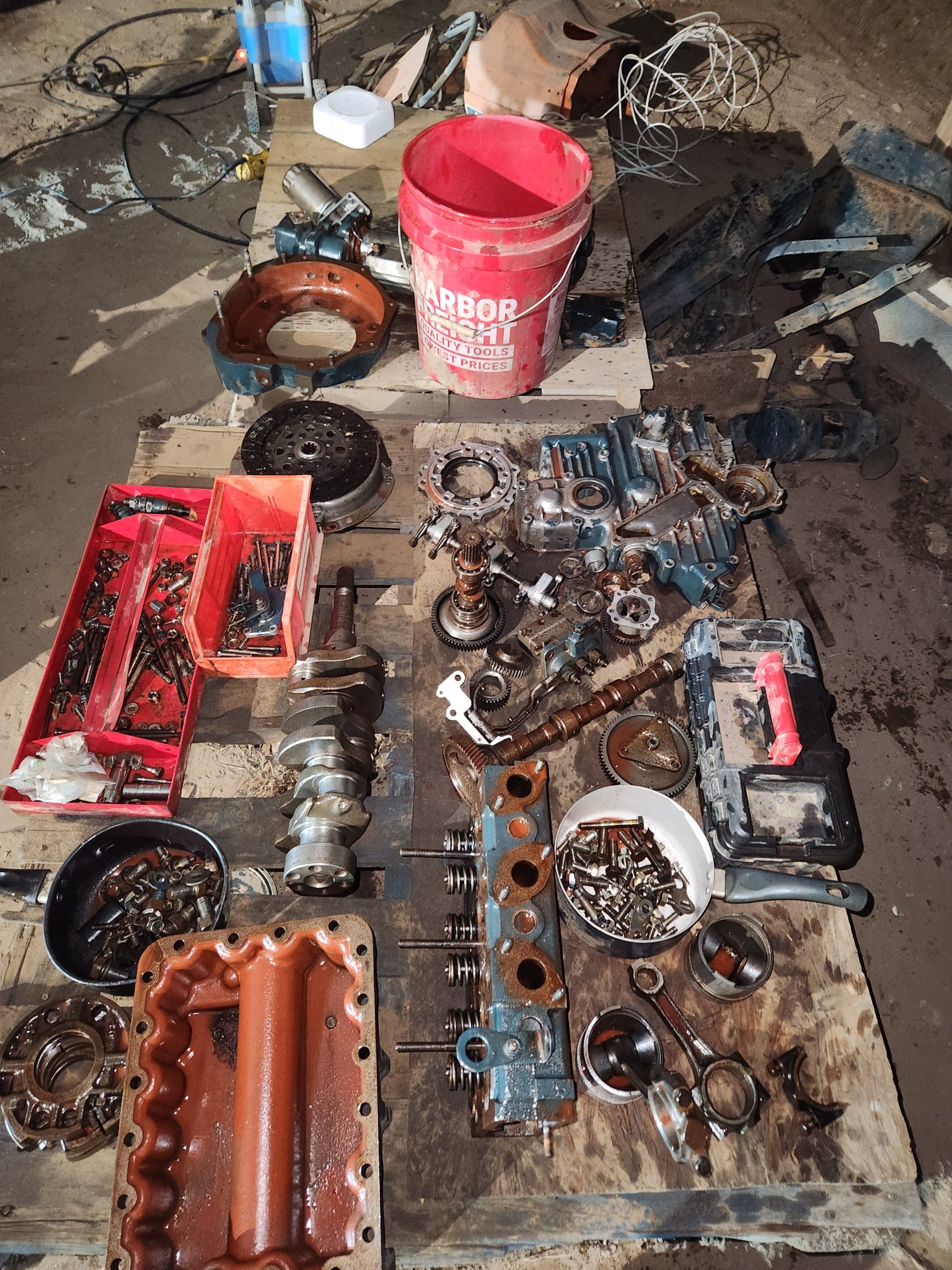

more reflection of today lessons
all the part for other d1301 engine, sitting out in element, rain, dirt,
clean them up, get diesel on everything. If i had energy/time:
I did get that expensive bolt to start that rebuild, I can get all the way up to putting piston in, meaning
all the parts are available to get engine on tractor, all the gears, the gearcase, everything but top of engine,
only things missing: all connecting rods, pistons, rings
i go do few tasks that are available, and let the plans marinate

How was the crankshaft surface? And grooves where the seal rides? I’ve had to speedi sleeve automotive crankshafts before.

I am warning you about your cribbing material and techniques.
This is how you currently have the front half of the tractor supported (copied from above post #849
First the materials are not correct for supporting loads. The concrete masonry unit (CMU, Concrete block, cider block, whatever name you use) is a brittle material and can collapse easily if the load shifts slightly. Many people use them but solid wood is much safer.
Your application of wood above the CMU does help separate the hard cast engine from the brittle concrete material so reduces the risk somewhat. But you would be much safer if all the concrete block was replaced with wood.
Second the way you have one block (top of picture) is a much stronger way to use CMU blocks than the orientation of the block in the bottom of the picture. Notice that the top block has much more webbing in the vertical (load bearing path) and is therefore stronger in supporting a vertical load. It also will resist a buckling (collapse, pancaking) event if any side loads are applied. The block at the bottom only has three vertical sections and there is nothing that cross braces that block. Imagine if you started pushing on the side of the engine (along the line of the front axle and pointed wood). The top of the block would start to move, the vertical webs become somewhat slanted and the vertical load will now exert a force that wants to lay those three sections down horizontally. The block would rapidly collapse and crush anything under the weight of the engine. It might not kill you but you could become trapped and that would not be good at all.
I don’t think I would try to do much about it now other than add more wooden cribbing under areas that you can get it under. I would just be very careful when you start trying to mate the two halves back together and NOT bang or jostle the front half much.
The use of the wheeler is clever but the wood blocking would have been better if you put it with the longer dimension on the horizontal plane. It would make it less likely to fall over. But only a little safer.
I do know there are some “freeze plugs” in the rear of the engine behind the bell housing that tend to leak. There is no evidence (rust) of that on the inside of the bell housing so it appears to be fine. But you may want to look at it since you have the tractor split already.

Arghhh, Joe,
you should not have spread the gunk over everything. It does not help on the outside and near the shaft seal I am not sure, it may be counter productive. Thinly on the fixed gasket and outside the seal ring, yes, but not anywhere else.
Kind regards,
Hugo
p.s.: use grey stuff next time, looks better if it not obvious. The orange stuff, particularly applied on the outside, always reminds.me of botch jobs.

recouple entities, let it run hot, see if it leak
all the part for other engine, ran through diesel and big paint brush
cover them with drop clothes
decided: the build for this engine will be done in different order, I start with front axle
Why its better: the last day working on this split tractor, it is very nice to be able to walk 360 degrees around the area you are building
yes, it is cured enough, couple tractor assembly and do test run
decided not to run it off the tractor because: worried about hydraulic line running empty,
also the labor it take to rig it up off the tractor is the same as if you just put it back together properly,
plan: install start flywheel clutch, push everything back together, install not all the bolts, everything not too tight, get her running
@Hugo Habicht
yes it does give that low quality repair look, i rig it up and see if she leak, no worry, if she does, not hard to fix it

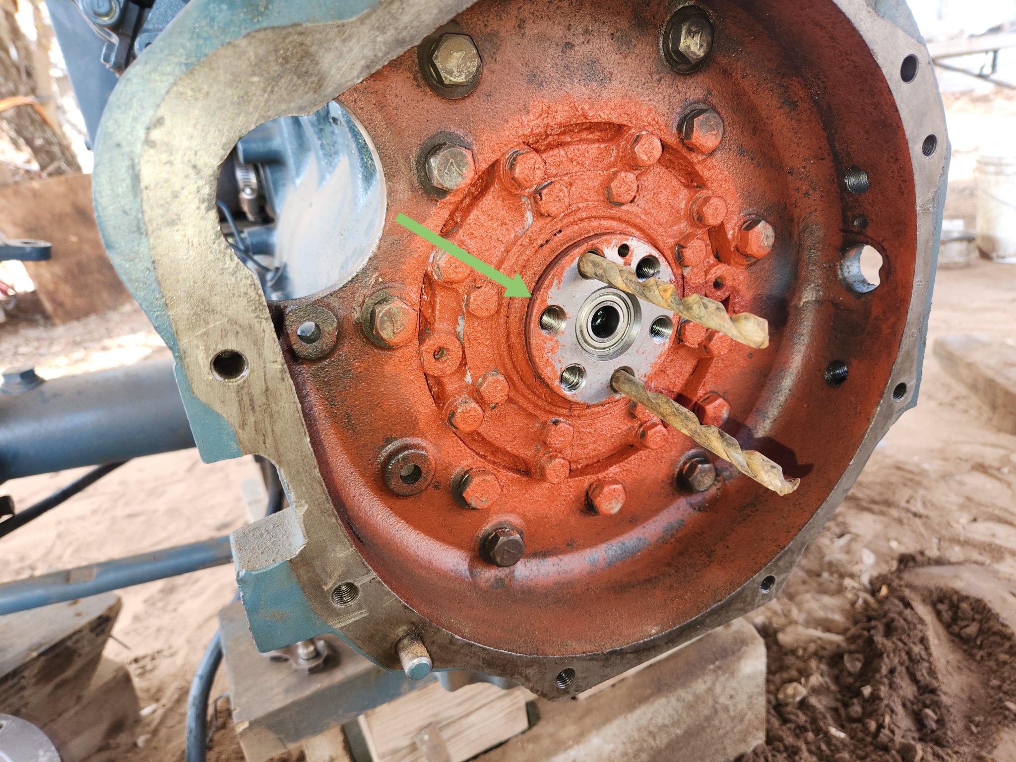

always have trouble putting on flywheel and the bolts match
I have done damage to one of the thread from misalignment
solution: get a stud that screw into it, then it should line perfect, now i try these drill bits before sacrifing bolts
solved: top of crankshaft has a small hole that make mark on the flywheel, line those two up and all bolt go in

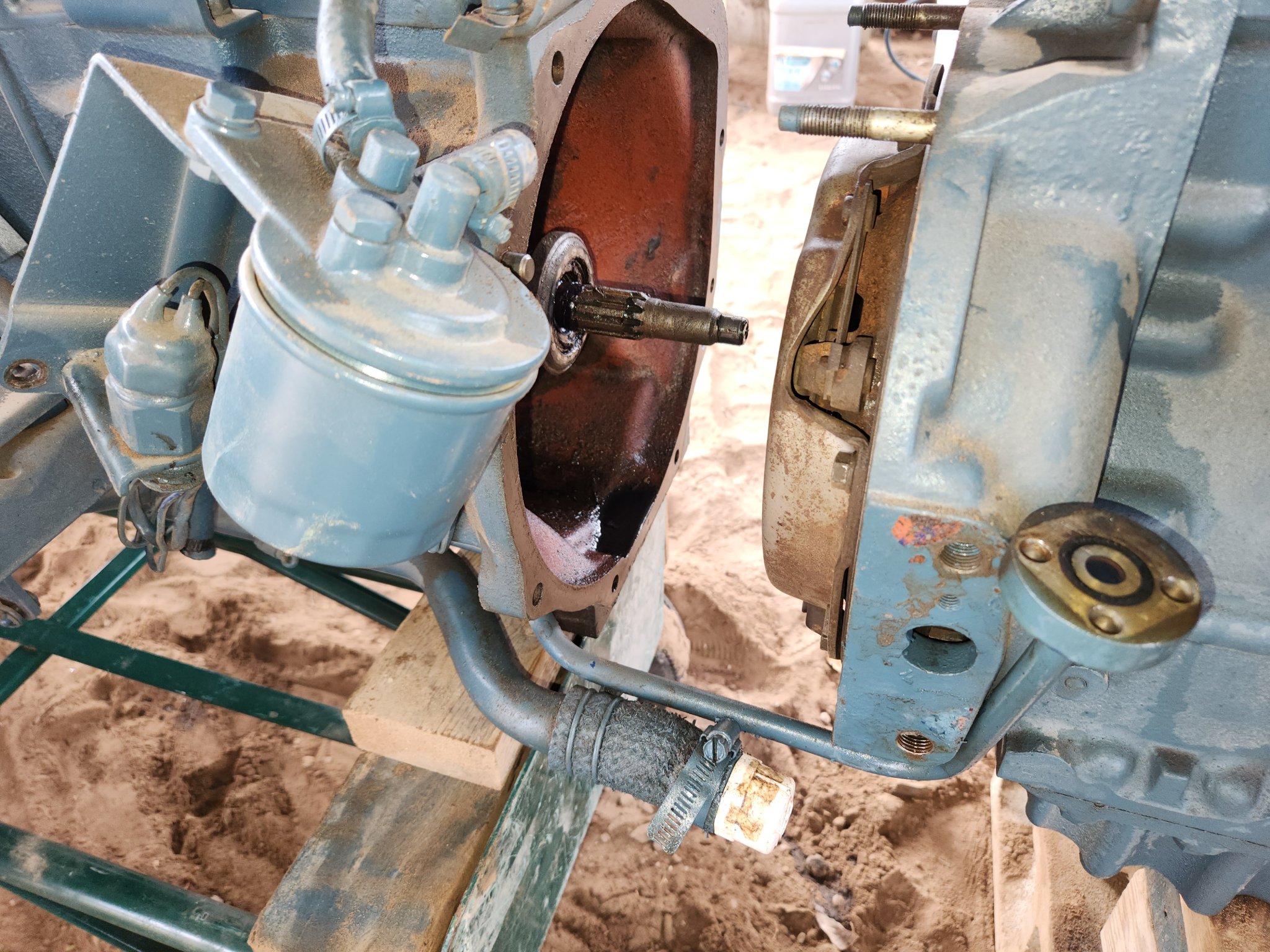

put in starter, push tractor onto engine, use cheap jack to line up studs on bell housing that go into transmission
idea to push tractor: bx1500 bucket lift rear wheels up, i try to get video
install starter and flywheel
I notice bolts are not all the same, good to always have the diagram close by, 2 of the bolts are smaller, did some thread damage from guessing where they go
bx1500 using loader to lift up on rear wheel of split tractor sitting on dolly,
look at your stud, move apparatus trying to make the stud go in the hole
almost stud in the hole, push split tractor closer, use jack to lift transmission up a bit to line the hole, push it rest of way with bx1500
video: moving rear wheel tractor lining up the stud holes
lines were a bit off, i sit down and think, i move the tires using the loader, then next i went up and somehow it was in place, meaning
sometime, nature figure itself out without your effort,
got bell housing bolts in hand tight, remove all block/jack/dolley/everything from underneath
get rid of rest of block under engine, fill it with oil, rig it up to run: 2 hydraulic line, throttle, diesel line, oil pressure,
good time to finally clean hydraulic filter, keep forgetting
dont install steering/front axle/exhaust until sure leak fully fix

Hi Joe,
the surface where the flywheel is mounted is a precision surface and fit. You cannot have any sealer on it, the flywheel may work itself loose. So PLEASE take the flywheel off again and remove the sealer.
