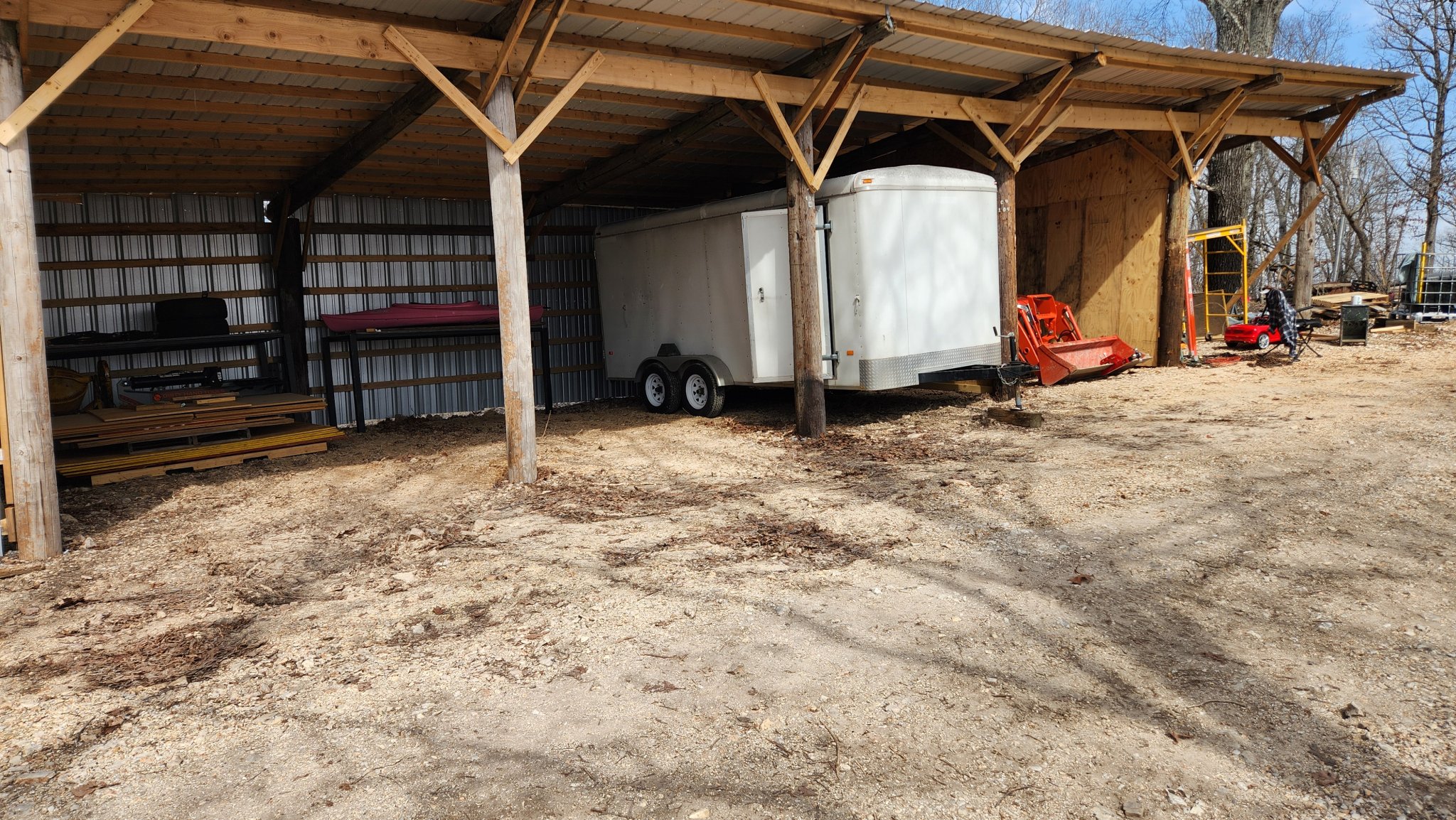

For those of you concerned about my build. I will be driving ground anchors down 3' and cables at each post. To drill a post hole here you have to use a core saw to cut the rock. The power co. has used the same holes drilled 40 years ago because of the rock and cost.
There is a building code in the towns here but I am 25 miles from town.
Most of the barns and storage sheds in this area are built on 4' center for roof rafters mine are 2'.
I have not been working on it much because of the very cold weather and at 70, I don't take the cold like I use to.
I will be working on it some tomorrow and Saturday.
I may get my oldest son to help me use the jack hammer to start driving the anchors Saturday as the cable should be here Monday.

Its been a while since I up dated this story. Between the cold, 2 weeks of the flue and travel to Pa. and forgetting to take pictures. Well I am almost finished with the build.
I have one more wall to add on the far right that will be an outside wall.
The tractor will have a mostly enclosed area. There is a plywood wall on both sides of it now.
I will start moving tools and other items in, in the next few days. I'm not in a rush to finish the last wall as I need to start spring work on the food plots. I will post more later this week.
FYI for those concerned about the building moving or falling in high winds we had 60 mile an hr. all day yesterday with gust to 75 blowing right at the open side. Nothing moved.

That is an unusual roof framing design. I don't know where you are located, but if you are in an area that receives much snow, those 2x4s spanning 10 ft on 2 ft centers will be subject to failure. Your roof pitch is so low that snow will likely not slide off and could build up a significant snow load. If you used 2x6s instead of 2x4s your roof would be 2.5 times stronger.
I'm not trying to be critical, just giving you a safety warning. If you are in an area that gets little or no snow you should be fine.

I am in southern Missouri. we get maby 6" of snow at a time and it's melted in several days.
The pitch is deceiving in the pictures. There is a 3' drop in 20 feet from pole to pole.

As long as snow does not build up a lot it should be fine. It would not survive at my location in NH. That 3ft rise in 20ft is a 1.8/12 pitch. A roof pitch of at least 5/12 (that would be over 8ft rise for your 20ft length) is needed for snow to slide off a metal roof.

1.8/12 pitch is probably too low for 6" of heavy wet snow.

As far as the snow sliding off the roof, most of it slid off the next day. I have lived in Pa. where we had 3' of snow, so I do understand snow load. Around this part of the USA the main concern is tornados and high winds. 90% of the joist have hurricane straps on them. We had 2 days with 60+ mph winds out of the South all day and nothing moved. I was in the shed cleaning up cutoff lumber from the plywood wall build at the time, but when I went out to walk to the house I could barely stand because the wind was that strong.
In this area most of the custom built poll shed's are built 4' center with 2x4 joist and very few hurricane straps other than sill plate and center point.
I'm not building in your area so it is not built to your building coeds.
For those of you complaining about how I built MY BUILDING by my self I might add, lets see your build by your self.
