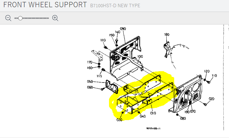

Okay, I’m not touching the EZ out for now. I tried pulling on the plug with vice grips while turning it and no luck. When turning it cycles between easy and hard. I assume it’s hard when the threads are crossing.
What’s my next move?
How difficult is it to remove the oil pan? It looks like I would need to remove the pin to drop the front axel and then remove the 10 bolts on either side of the pan.
Yea you might as well just jump right in and pull the oil pan and either fix it or replace it.
But you will find out really quickly you can not remove the pin, you will need to drop the whole front frame and radiator to get the axle out of the way to get the pan off.
