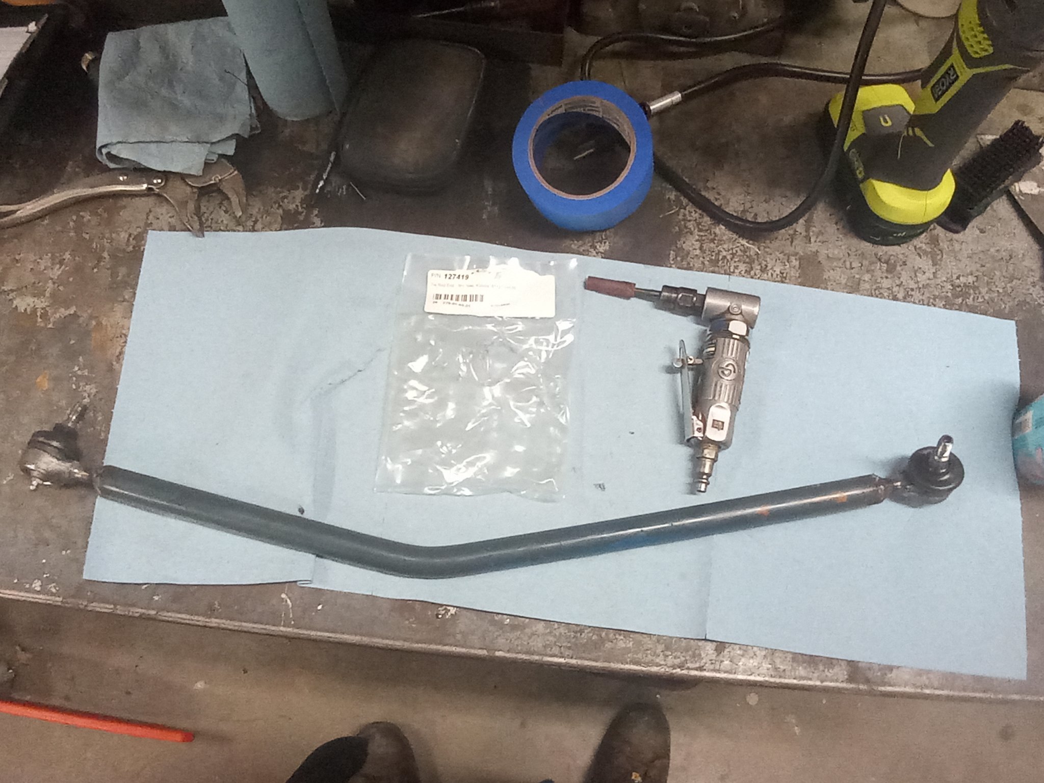

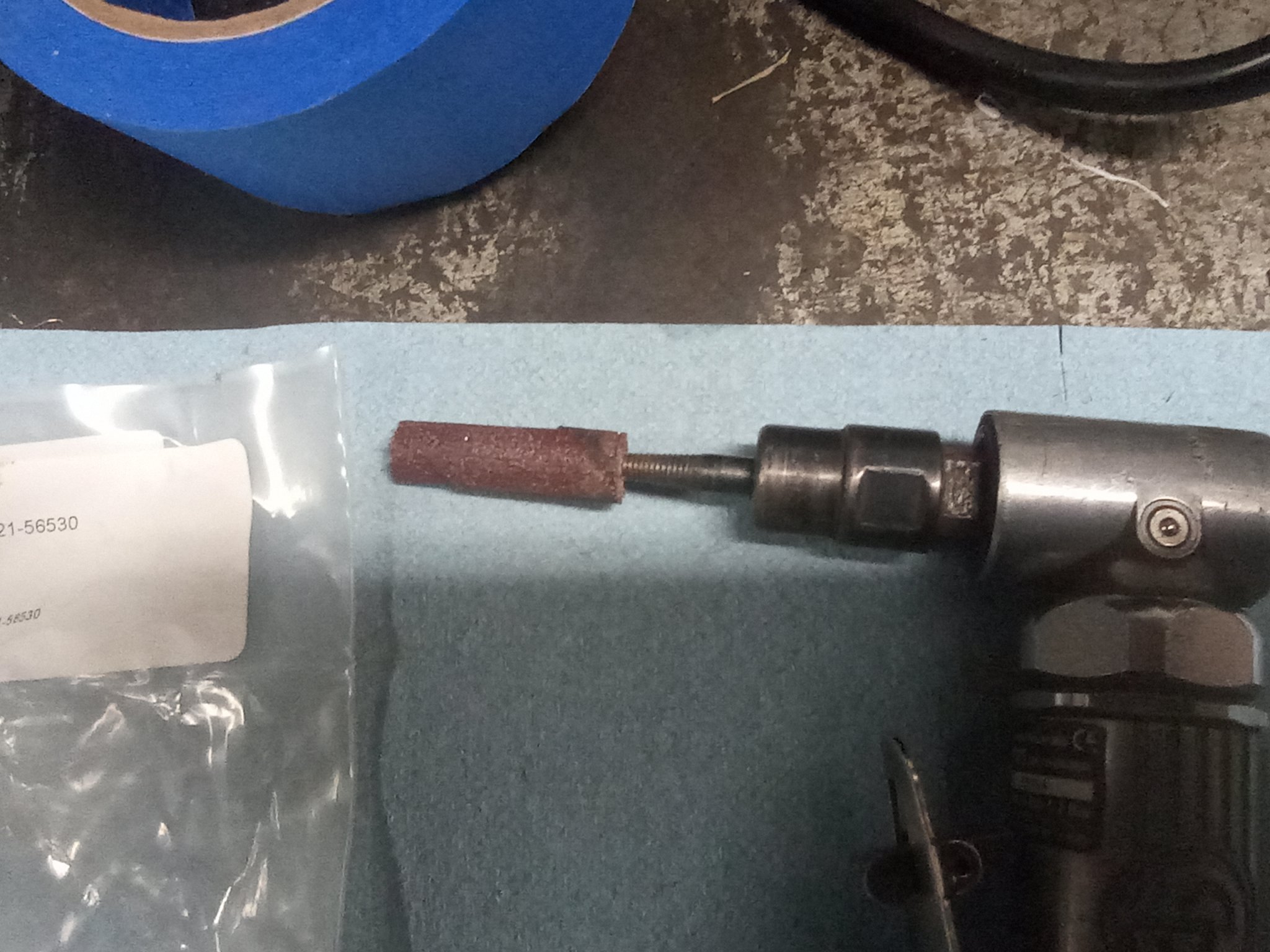

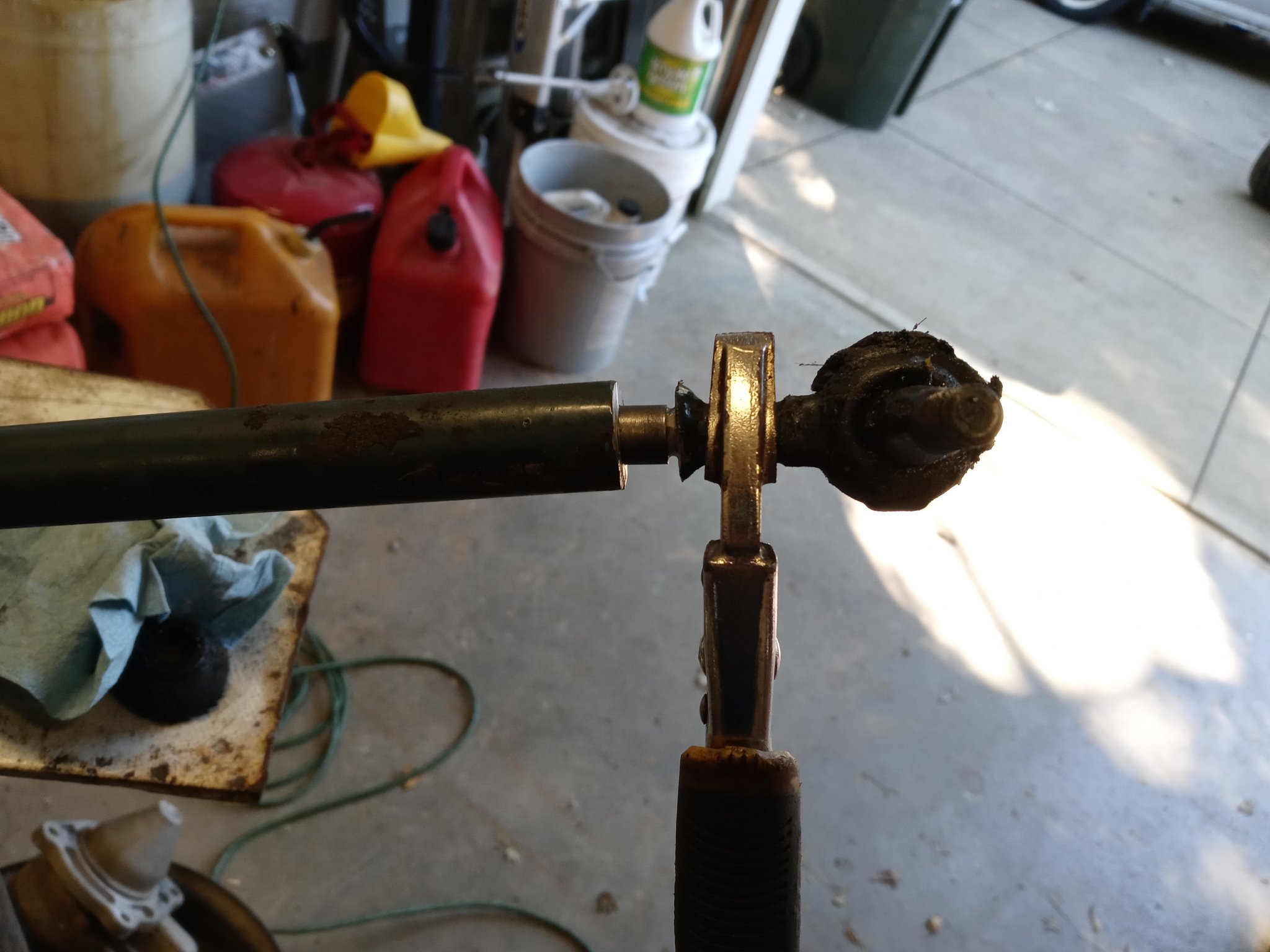

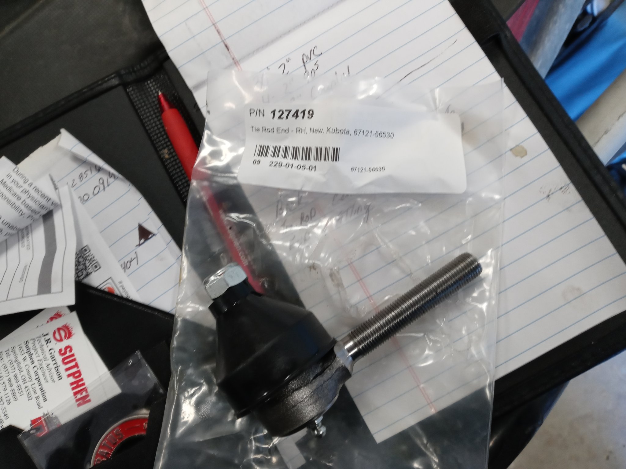

Recently bought an old b7100. Drag link was wasted. Priced one and it was $600. No way!!! Measured stud going in to drag link. 12mm. Ordered 2 tie rod ends. Cut welds on drag link and removed old tie rods. Remember to mark their orientation!!!! New tie rod threaded end fits almost perfectly in the drag link. Measure distance from end of tube to the middle of old tie rod and write it down. Cut new tie rod to measurement of old tie rod end and weld in. You will have to adjust the taper in pitman arm and steering arm ever so slightly with a sander cone in the pics. I have included pics with part numbers. Hope this helps.

Just to clarify: is the existing drag link shaft hollow? And the threaded ends slide in unmodified?
No the drag link on these are solid.
He's cut and ground off the threaded end and welded it onto the end of the drag link.
Like the original was done.

That's what I thought at first too. But looking at his 4th picture and the comment " New tie rod threaded end fits almost perfectly in the drag link" (emphasis added) makes me wonder...
28,864
5,223
My apologies, you could very well be right, as the 4th picture is the old joint being pulled out.
I just did a quick look at it the first time and thought it was the new one being welded on.
There must be a drilled indent in the end of the drag link.
That would make it much stronger!
Yes that is how the drag link is built from the factory. Solid bar with a hole drilled in the end. I cut one apart when I added power assist steering to my B7100 last fall.
