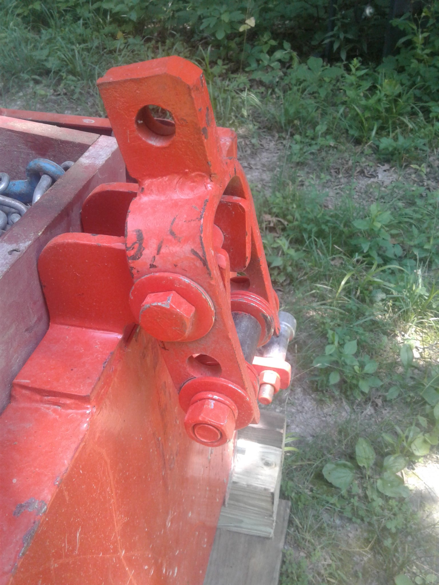

Most annoying issue that I have with my Kubota ballast box is the positioning of the hitch pins. Lift arms on my B3350 do not lower enough to set the box on the floor for removal so must set on a couple of 4X4s.
Annoying and unanticipated.

My Kubota ballast box was not quick hitch compatible. Ordered Titan box off Amazon. The Titan SOB's make a 3pt box and a QH compatible box. Had to lower and extend the top mount.

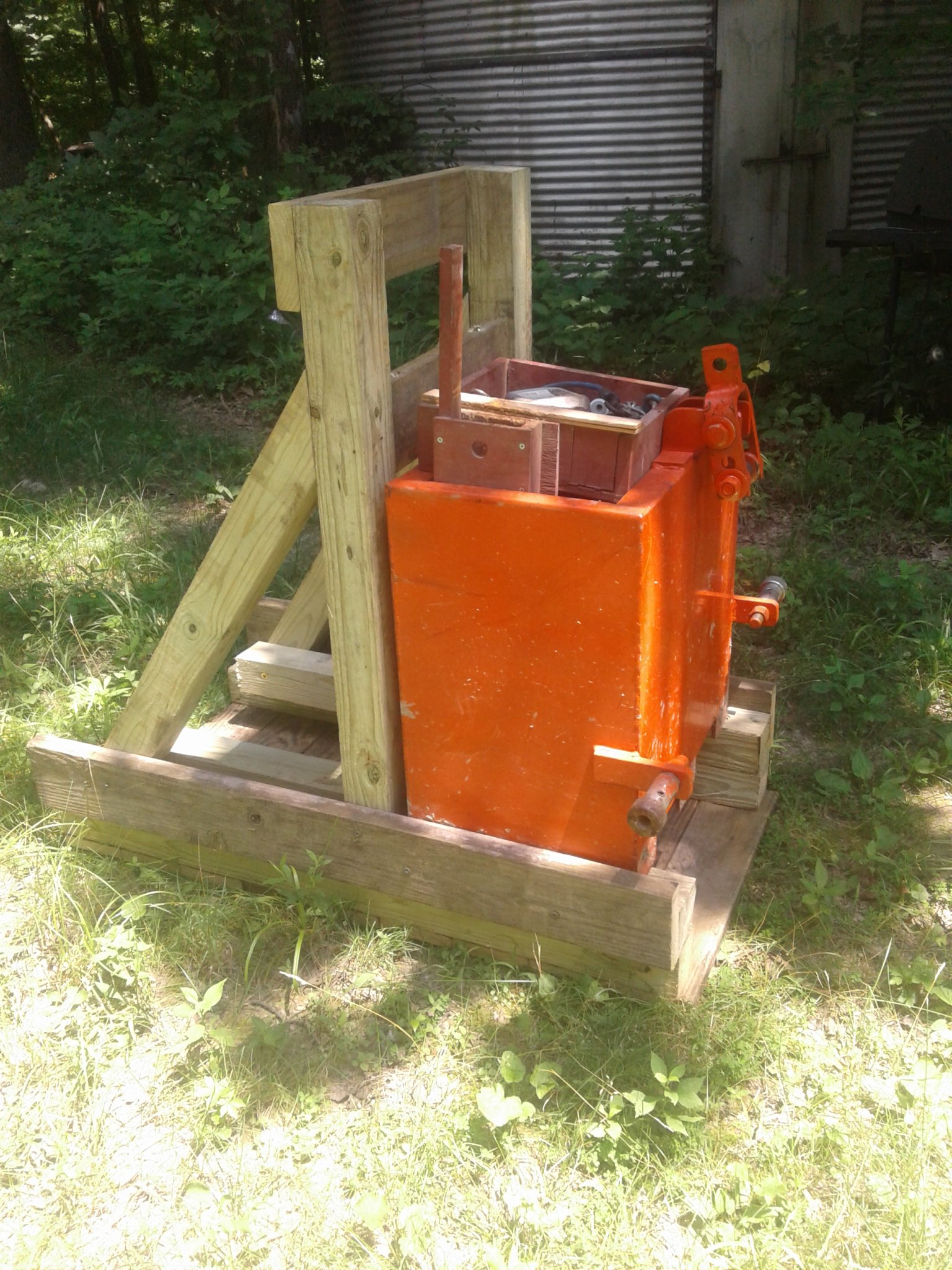

If you set your ballast box on wood or cement blocks, sooner or later you'll bump it a little too hard and knock it over. A wooden parking stand is a worthwhile accessory.

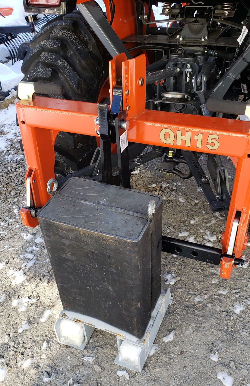

In case your considering a quick hitch, I found out the hard way that the Kubota ballast box does not fit on the Land Pride QH15 (Quick Hitch). I guess I should have searched the forums first, but you would think their sales pitch about matched implements.....

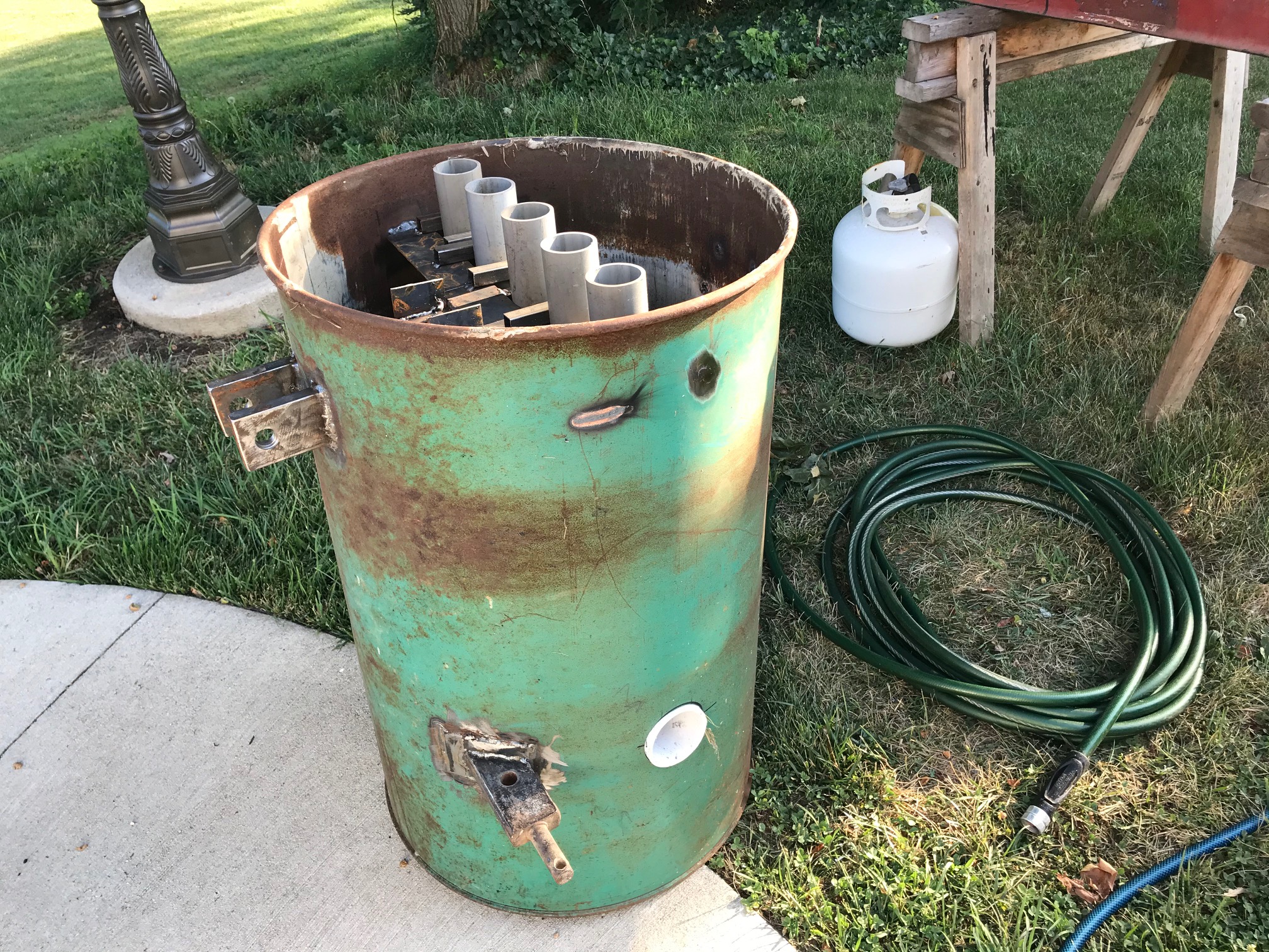

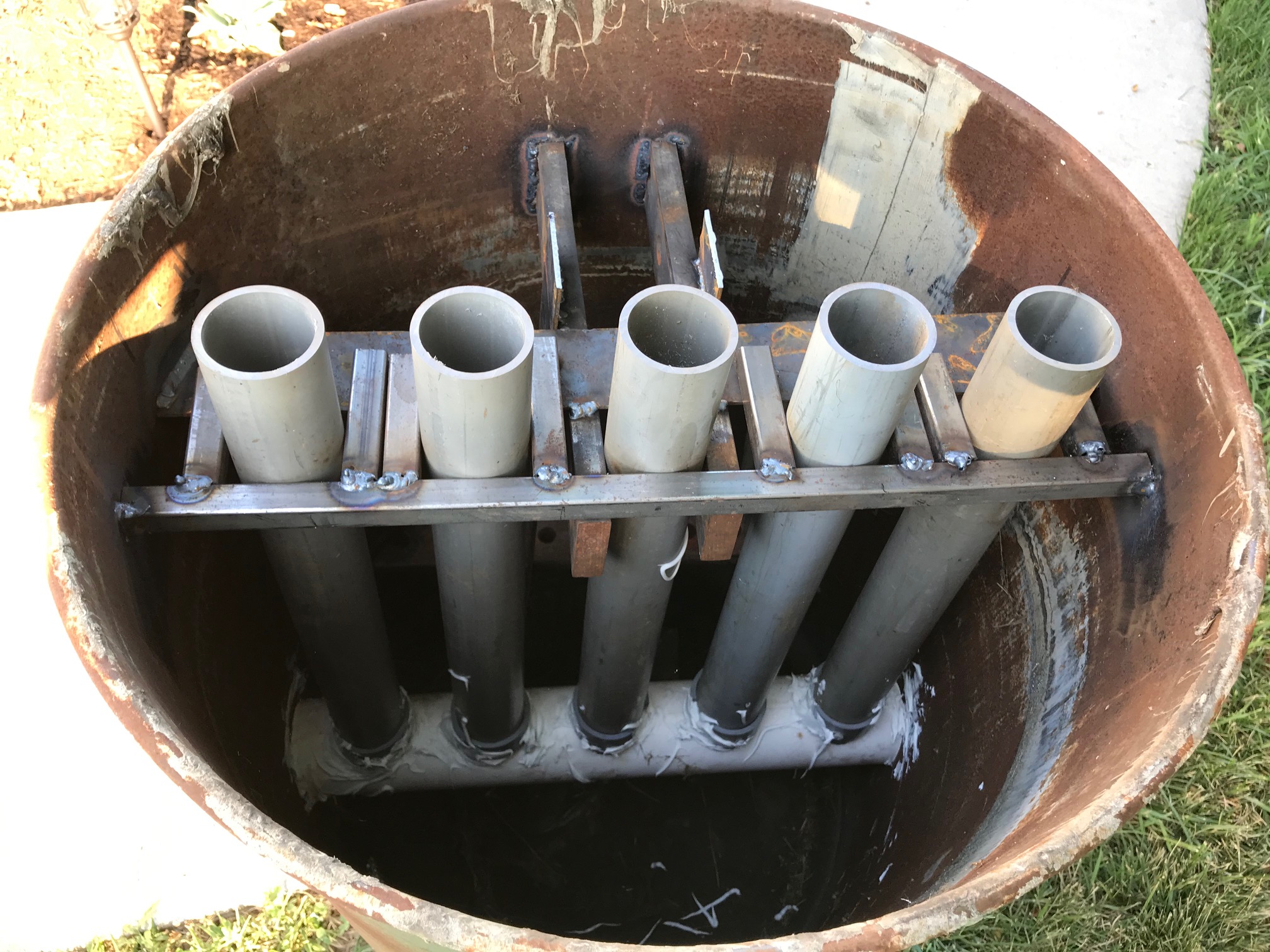

Tractor rears are filled. My counterweight is a drum with concrete fill. Milk crate bolted to the top. Vertical pipes with a large "header" across the bottom so the pipes won't accumulate junk or water. Drum, PVC, misc. steel and a few concrete anchors were from junk at work. Drawbar was from a pile at home. Concrete was donated from work (left over from pours). Milk crate was $6.99 at TSC. SMV sign was from a shelf in the garage and the reflective tape was left over from another project. Paint was left over from a mower deck refurb.
Not much out of pocket expense on this one.

The upright pipes ending in the PVC is a great idea.
