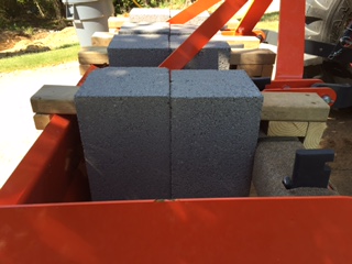

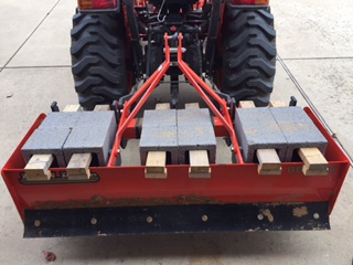

I have to admire Spectre381's ballast box, I want one!!! however for the little FEL work I do, I'll probably continue with my home made ballast which I add to my box blade.
It is comprised of a few feet of 2"x4", hollow concrete blocks. I'll attempt to put some pics along with this. I use this as ballast only when using FEL. I cannot use the box blade for a box blade as it's intended use as the blocks get pushed up by the dirt.
Pics will show how the 2"x4"s address the top offset of the BB frame and allow the blocks to simply hang down into the BB keeping the weight down as low as possible. Each set of two blocks and associated wood supports weigh 60 lbs. with the 12 blocks and wood supports, the total added weight is 360 lbs. add that to the BB weight of 370 lbs gives me a total of 740 lbs.
The cost of this was about $1.60 for each block and a few dollars for the lumber. around $30.00.
