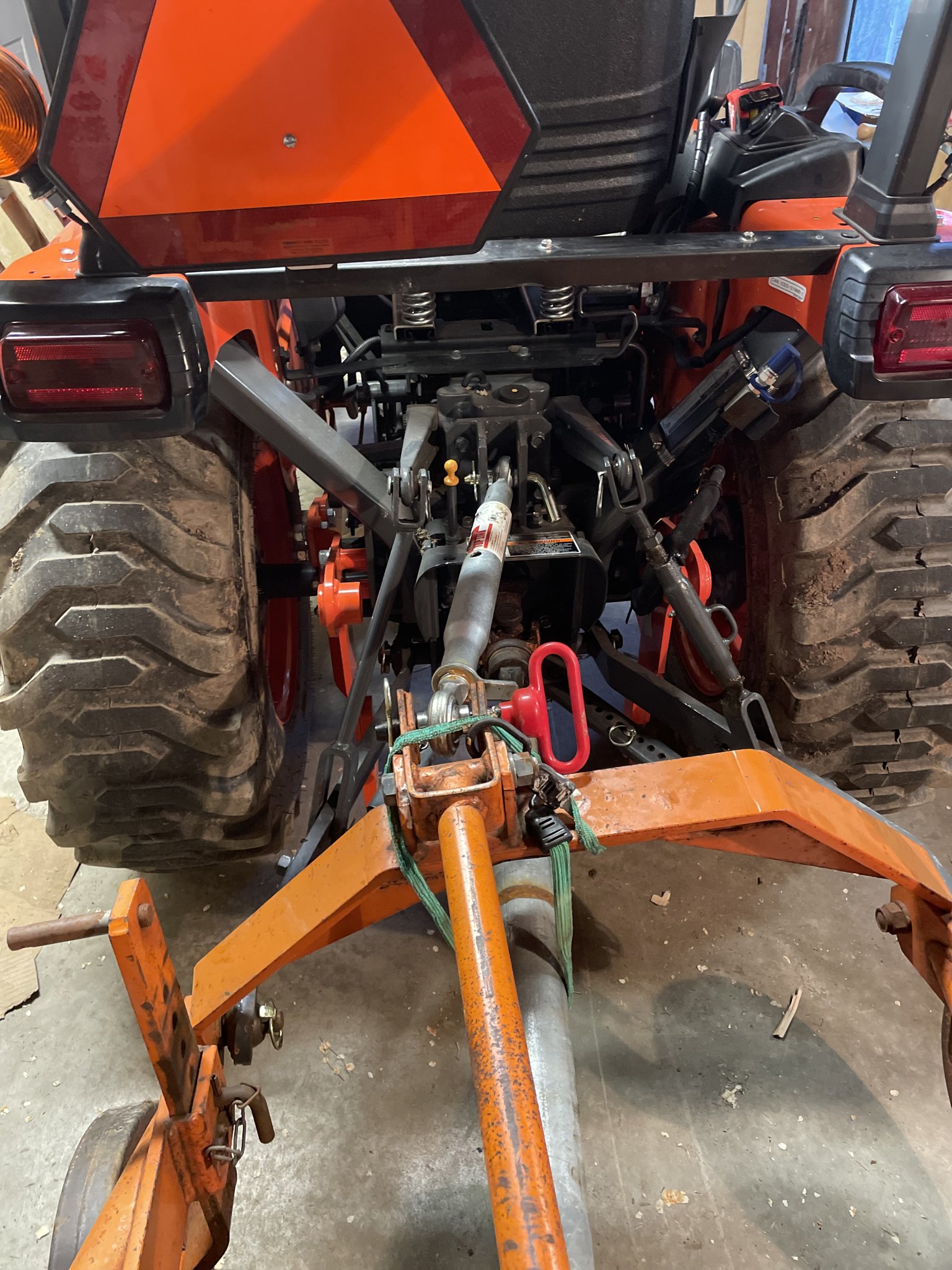

I brought it home and am afraid I can't use it. I hooked it up toothe 3 point and it is cray crooked. The top ling goes one way and the PTO shaft goes the other. They almos form a X I have tried every way to adjust it but am really concerned about the top link being some 4 inches off center. I'm scared it will hurt the tractor PTO and break or bid something. I think I'm going to go the disc/harrow route. Much quicker and less $$$. Not as nice but all the old timers around me and the Amish use these and ya couldn't find one that uses a tiller.

That really makes no sense. The implement should be directly behind the pto shaft and the upper top link is directly above the pto output shaft.
Will you post some pictures of the tiller on the tractor?

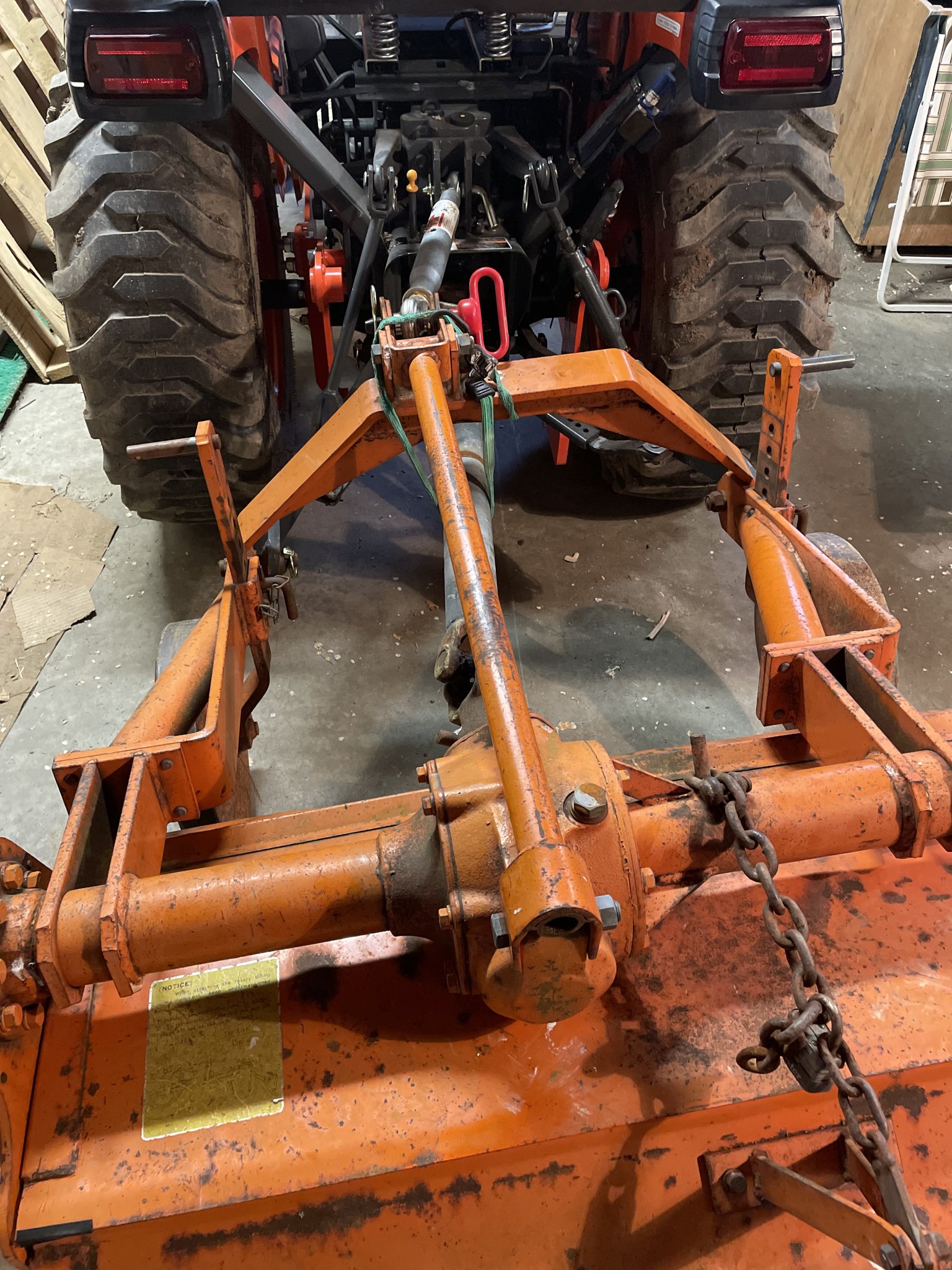

Here are the 2 pictures I had taken before I took it back. The unit is hooked up. As you can see the top link is way off center. It's my thinking that where it is welded tothe frame of the tiller that it should be in the center. The hook up standing behgind the tractor is way left. This throws the whole unit off. I stood behindit and with some effort moved the back of the tiller to the left but it would only go so far because the 2 arms of the 3 point would not let it go to far even though I oulled the pins out of the lower adjustment arms.
Am I missing something ?

wider angle, side view picture will help.
I'm thinking the top link may be too long ? Really hard to tell
Those front wheels confuse me too...

Those are the only 2 pictures I had I tried to shorten the top link and the only thing that did was lower and raise the unit. It was still twisted so to speak. The top link is far from the center of the tiller which throws the whole thing off

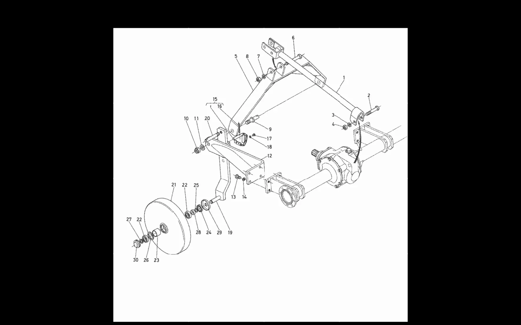

hmm.. I would think that the right lower link pin is mounted wrong. According to the drawing the left one is inside, so the right one should also be facing inside
you have
frame...pin---> space frame..pin--->
i think
frame...pin---> space <---pin...frame
is correct.
As you have it now, it will 'skew' or 'twist' the tiller relative to the tractor
My way, things should line up straight.
It might have been someone's attempt to 'offset' the tiller, to till the tire tread ?
A couple wrenches, 15 minutes will prove I'm right or wrong.....

It’s hard to say from the pics (for me), but it sort of looks like:
1. The 3pt on the implement side has an offset built in and it looks like tried to hook up centered on the tractor.
2. Sort of looks like your link arms are not level to each other, but tough to tell from the pic. Sort of looks like the RH link arm is adjusted shorter(height from turnbuckle) than the LHS.
as mounted it does look odd…not sure if any of the above is really correct or just how pic angle appears?
