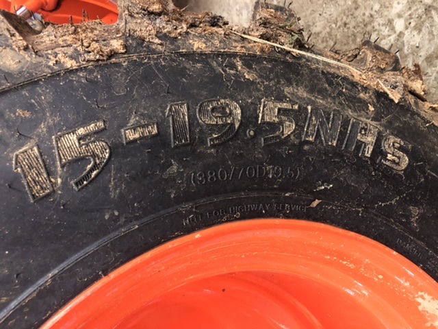

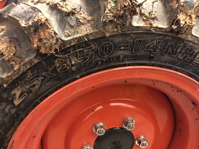

I have the larger R14's on my LX2610. Have about 10 hrs on machine so far. I like them, only problems they do tear up the grass a bit while turning in 4WD, but that's to be expected. I don't mow with the tractor, it was bought to work in the woods with loader and bush hog a field every once and awhile.
MOOTS
MX6000, BX1850
Jun 27, 2019
2,241
2,868
Canton, Georgia
Here are the sizes.
41D1E1EB-707B-455F-89D1-C618CF27C40E.jpeg Rear.
Front.

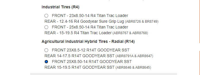

I did not know you could get that size on a LX2610. Even the Kubota build site only has the one size in the R14T tires(LX2610 & LX3310). Do you have the mid-mower deck and if so do they interfere with it. I measured and remeasured before ordering the rear wheel spacers as according to the website the spacers and mid-mower deck are not compatible.

I do not have a mid mount mower. I'm seeing the sizes available on Kubota site. Tires.png
Adding them automatically adds the steering stop kit too.

Okay figured it out, the larger size is only available on the LX2610SU on the Kubota website. That is good information to know when I have to replace tires.
Not on my end. I clicked 2610,4wd,midmount, rops. all tire choices came up.

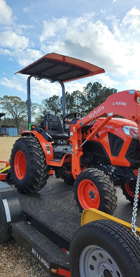

I just happened to think a friend in Mississippi sent me a photo of his new tractor last week. I went back and looked at it. Yup it has the R14's. 142215 Jesse Kubota.jpeg
