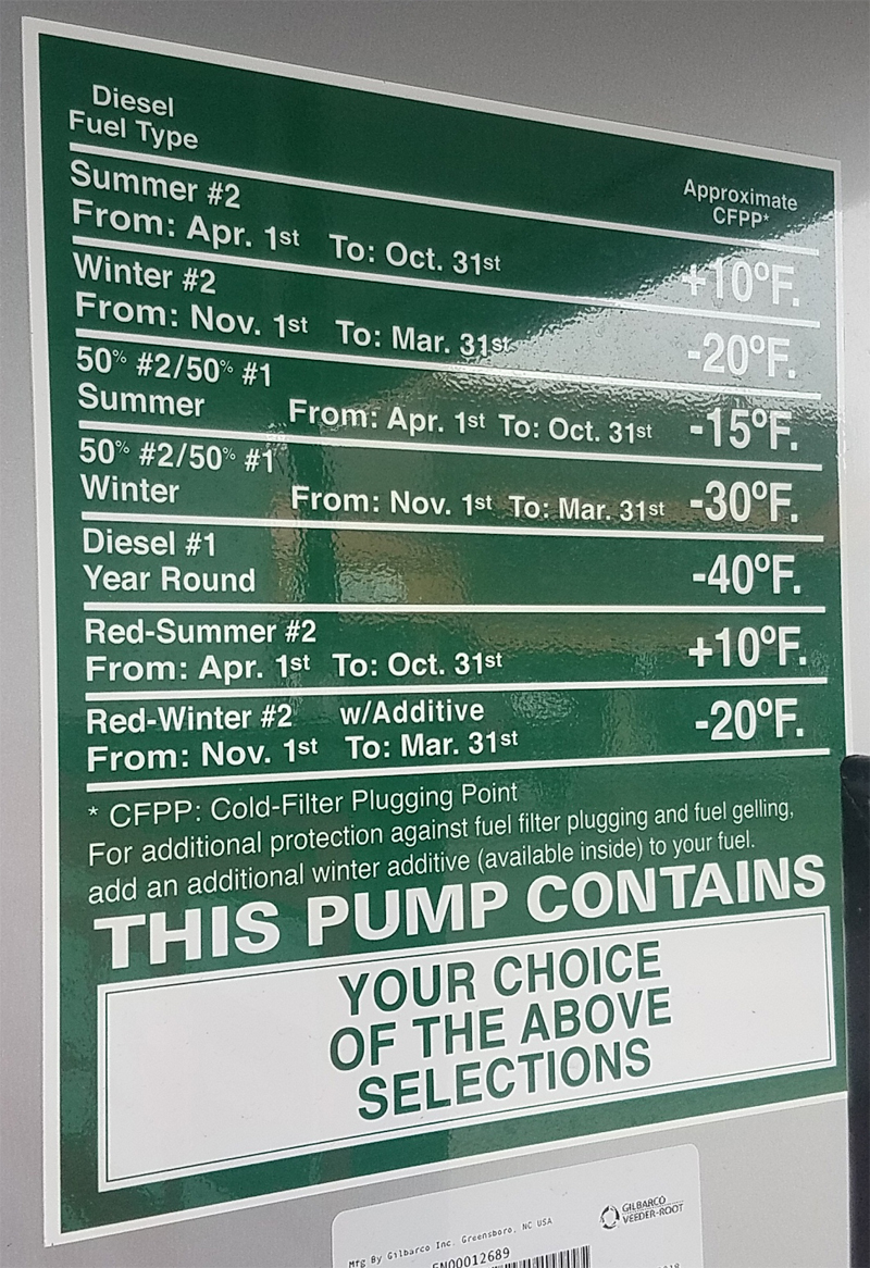

Here's a description of the diesel up here and when it's available.
8,356
11,758
So, #1 and #2, a blend, and you have have it with red dye or not.
No "premium".
#1 to -40F is our "premium". What's the CFPP for the "premium" you have?
I'm not the one who mentioned "premium" diesel fuel. I'm the one who is trying to find out what this mystery substance is, and what it actually does.
I note that the sign shown there does not use the word, "premium". It's just #1 and #2, with or without red dye. Nothing new or special about that. Standard stuff for decades.

I have no dog in this race. I don't buy #1 ever! :ROFLMAO: I buy red for the tractors and generator and #2 for the truck.

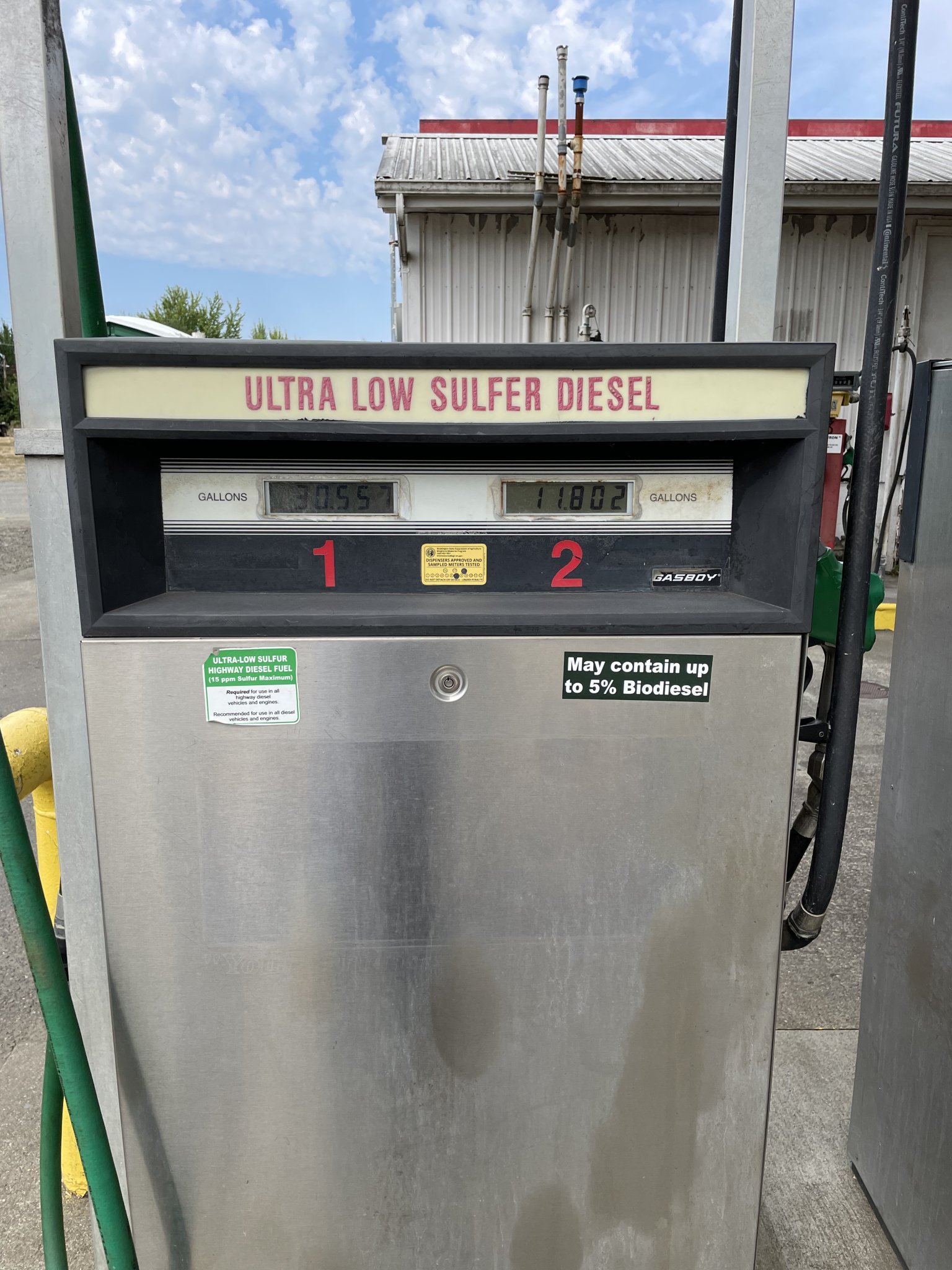

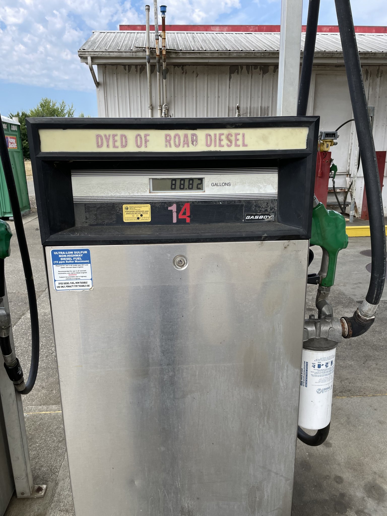

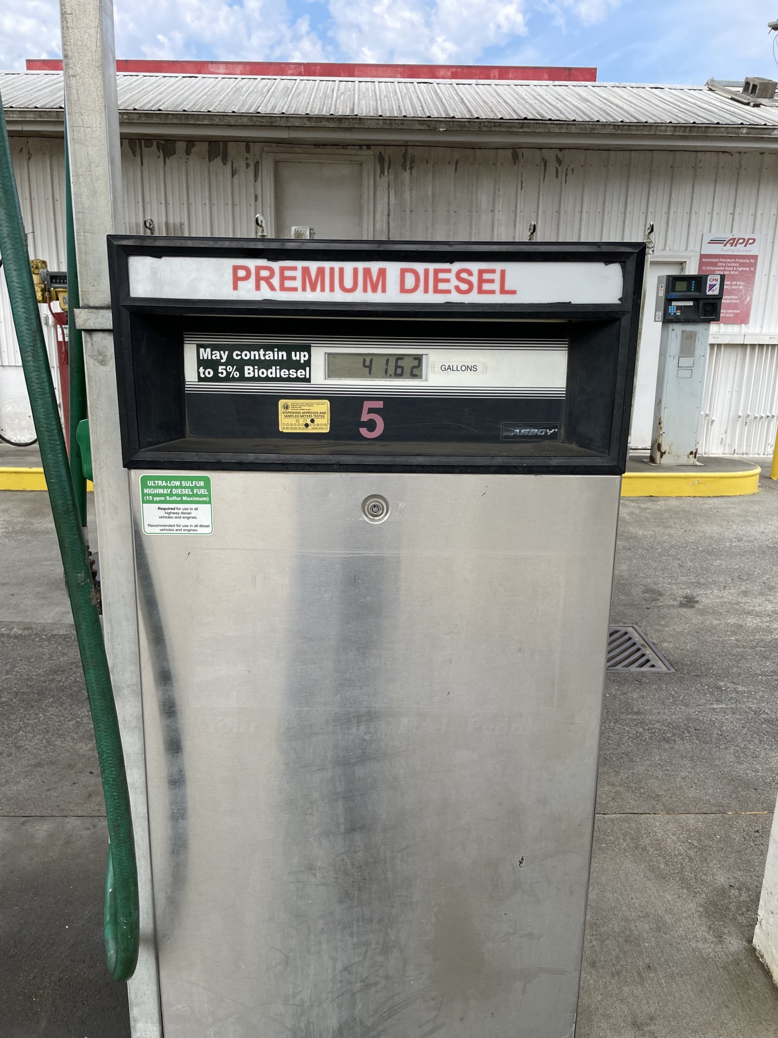

These pictures are from one of our local fuel stations and illustrate the three types of diesel fuel they sell.
Ironically, there is no detailed information posted as to the difference in quality or price (aside from one being labeled red-dye, off road).
