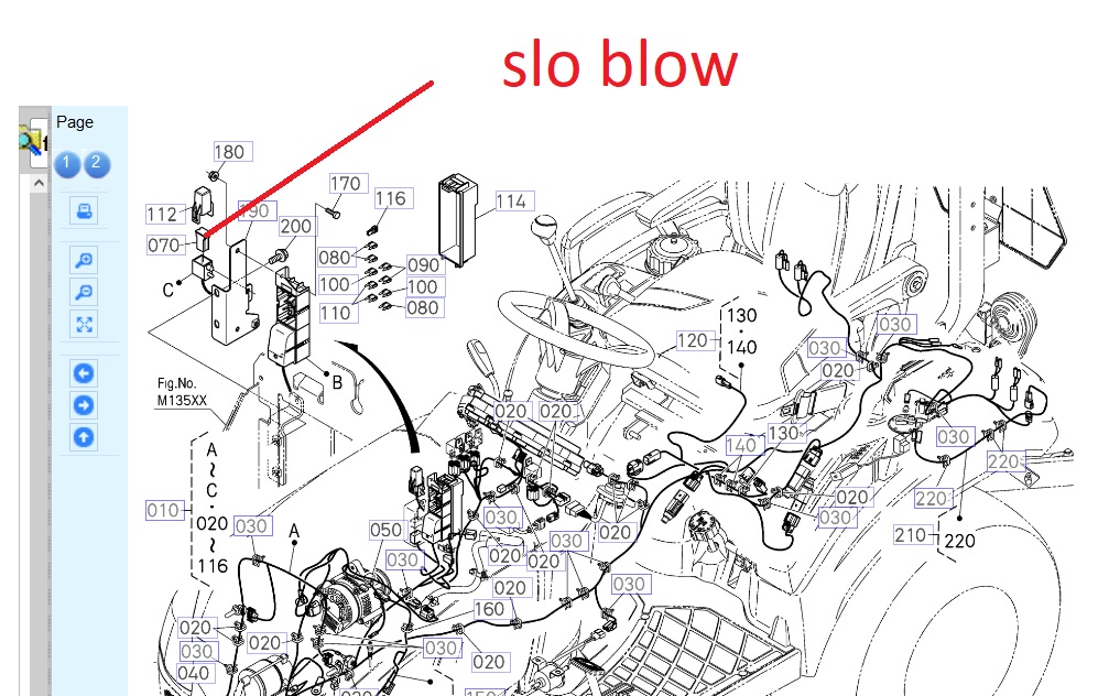

I got into a hurry and accidentally connected the battery backwards on my BX2680. Now nothing happens when I turn the key, no guages, no power to the gloplugs, etc. Can anybody help me as to what components I have damaged? My son told me there is a fusable link in the battery cable that protects the tractor from such a mishap.

I am wanting to make certain your problem is related to a reverse connection.
Here are two parts illustrations to help you track down this fuse which will be red in color.
This is what the fuse will look like but it will be red in color
