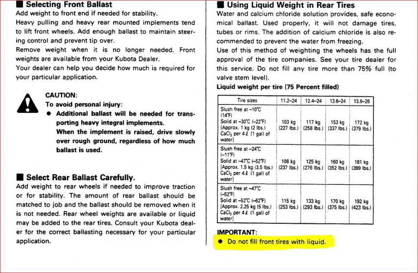

The manual states not to use liquid in the front tires, it doesn't say not to ballast just says not with liquid.
I think it has far more to do with control than a weight issue, as they sell front weights that far exceed what weight you could put in the tires.
My front tires on the L3450 are ballasted with Foam, I like the feel and the control that the heavier tires gives, it has full hydostatic steering with no mechanical linkage so it has no feedback on rough ground.
My B7100 had front liquid ballast in them, on that one I really didn't notice a traction difference when I put new tires on it and didn't ballast them, but I did notice a steering difference (better non-ballasted), that has the stock mechanical "steering by arm strong" in it.
