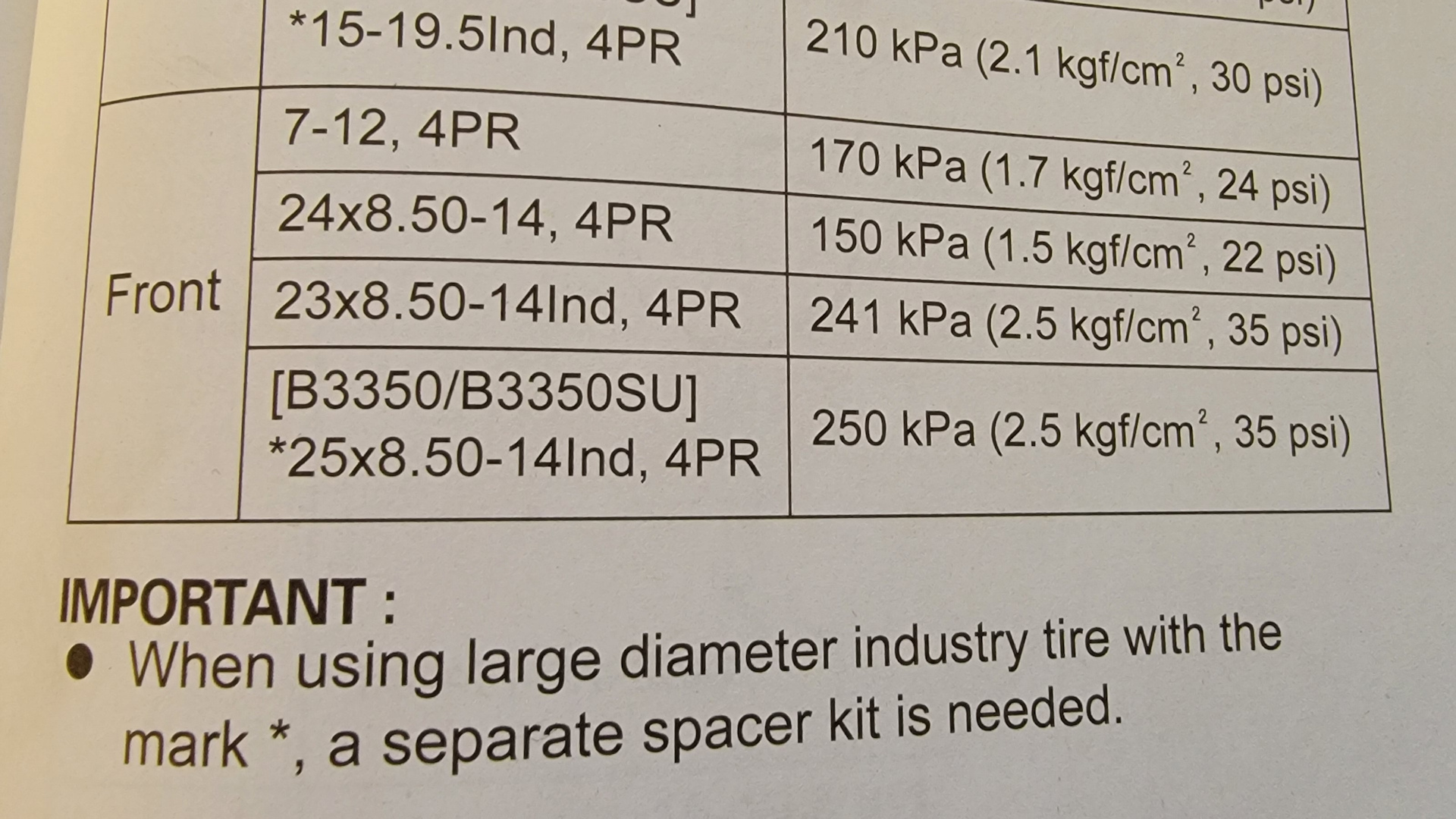

Not in a million years would I ever consider adding spacers to a pivoting front (to avoid wearing something prematurely) but I do suppose once it’s actually ‘at the stop’ (now pretending to be non-pivoting), I surmise wider would be better. But on a hillside about to tip, I’m probably rearranging the deck chairs on the Titanic at that point, worrying about it.
In my case they sell bigger tires and wheels for my model. Obviously the assembly was manufactured to handle more than how it was delivered.

If the manual says "no front spacers" then they mean "no front spacers". The problem with front spacers is if doing so voids your warranty and I believe they could figure out the cause of the failure.
What manual are you talking about?
This is the only reference to front spacers in my manual (adding them).

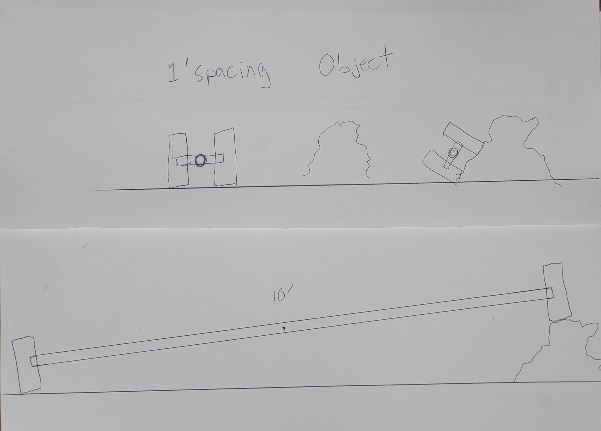

I give up too. You are right this is getting funny, but not for the reason you think.
Does traction add to stability?
Does friction add to stability?
Does weight add to stability?
Does angle effect stability?
Is your only reference to stability tipping the tractor completely over? It doesn't matter if that is all you go by, wider is still more stable but there is a lot more to it than just that.
Like I said above it is a math answer. Not a "what I think", I don't have a choice in it.
Hand scale only but it is close.
One the axle is sitting at a 50+deg incline, the other is barely over 15deg.
This is an extreme example to show it visually however the math will prove it out for any width increase/decrease you use. Gravity is an equal constant regardless of angle.
I think you are just getting hung up on the pivot and the stops. Adding width will add to stability in every scenario I can think of regardless of the pivot and the stops.

Funny or Fun? You guys remind me of myself and some buddies drinking beverages on the dock arguing about, well nothing, but doing it successfully for hours. At some point we'd switch sides and and try to prove the opposite point. Good times ;)

I will attempt this one more time.
Front, rear, doesn't matter. One does not dictate the other.
Add to just the front, it will be more stable.
Add just to the rear, it will be more stable.
Add to the front and rear, it will be more stable.
The OP can do what he wants.
This rabbit hole started when someone said adding width to the front has no effect on stability. I was just saying that was wrong.
Did my picture help at all?
I agree this discussion has gone on long enough.
Thinking about it, I think we are on the same page, except that you feel the front axle center pivot can be ignored in the analysis, and I believe that the front axle only has an effect (other than its weight affecting COG) when an axle stop is reached.
Also agree that we can all do whatever we want.
Appreciate you taking the time to post the drawings. I agree with your drawings, common sense really. But in both cases the front axle would only raise the front of the tractor, and not add to stability if a axle stop were not reached.

Sorry for the delayed and long response but here goes my last thoughts (?) :) I've enjoyed the discussion and always open to change my mind when wrong and also to learn from other's opinion.
Of course, I absolutely agree that it’s more practical to first add width to the rear axle if at all possible. But the OP first asked if both front and rear tires needed to be in line with each other. He also simply asked for the pros and cons of spacers in both locations. Hence the disagreement over the blanket statement offered that adding spacers on the front pivoting axle had no affect on stability.
I think your interpretation of stability for you is much narrower that NHS’s, mine, and possibly others. I view stability as a variable that can range from completely stable (a tractor at rest on level ground), very stable (safe operating practices under the given conditions whether on level or inclined ground), to extremely unstable (unsafe operation that can easily lead to a rollover or accident, whether on level or inclined ground). It really wouldn’t have to end in a rollover to be considered unstable. (Which seems to be our main point of contention.) Example: Isn’t it considered unstable if the ride would become so bumpy that the operator loses control and strikes an object causing damage and injuries to the tractor, himself, and/or others? And the range from very stable to extremely unstable can be wide to very narrow depending on each tractor’s configuration, operating speed, skill of the operator, common sense, and more.
In a way, you even agree with us in some of your earlier statements. Think of it this way and using just a bare tractor as an example (no loader, no attachments):
A tractor with a very solid narrow front fixed axle hitting a small object under one front wheel will tilt the whole tractor to an extreme angle if the speed was excessive enough where both wheels on that side would leave the ground before rocking back and forth between opposite tires front to back. There is momentum at play here because of the unsafe speed.
Now, the same tractor with a much wider front hits the same small object at speed but because the angle of tilt is much less (as in NHS’s drawing). Less tilt at the same speed equals greater stability and a less chance of rollover.
Now take the same tractor with a narrow pivoting front axle and hit that same small object and the tractor may hit the pivot stop (or not) but any tilt wouldn’t be quite as extreme as with the solid axle. Maybe not much less but still it would be less. (Geometry is the more technical math description for the reason). Now with a wide front pivoting axle chances are much greater that it would not hit the pivot stop at all, the rear wheel is still on the ground till it strikes the same smaller rock. Only one rear wheel off the ground now and less momentum built up that could lead to a roll over. Thus, more stability.
Another way to look at it: Think of the pivoting front axle as a kind of shock absorber. If front and back wheels are in line it might be only the back wheel striking the same small obstacle that will cause the tractor to tilt. If two equally small objects spaced in line at the exact wheelbase (front to rear) were struck at the same time then again, possibly only the rear tire would cause the tractor to tilt. If the wheels were not in line and only the front wheel hits the small object, then without the front axle hitting the pivot stop, the tractor wouldn’t tilt at all. The pivoting front axle therefore does improve stability and the wider the stance the better. Again, speed, momentum, safe operating under the conditions, etc. all contribute as much to the stability. And the pivoting front axle acting as a kind of a shock absorber can help to keep your tractor from tilting whether it hits the stop or not. Thus, it’s more stable. And consider small rocks on one side with a rut on the other. Double trouble for a fixed axle. Not so much for a pivoting axle depending on the sizes. But still......less.
You stated earlier above that with the pivoting axle hitting a smaller object you might not feel it at all unless the axle hits the stop. With a fixed axle you would. That goes along with what we are saying. Wider is better in all cases until practicality and those other costs dictate otherwise. But just as the range of stability can be very narrow, so can the range of practicality over the width of the front pivoting axle. But the blanket statement that adding to the width doesn’t matter on that axle is technically not correct in and of itself. IMHO, of course.
If a person were operating on only flat, level ground or on completely smooth inclined ground you may not agree. If you add rocks, bumps, pitted cow pasture, badger holes, hidden cut off stumps, or any unseen objects to that same terrain I think that person would agree that a wider front, pivoting axle smoothens the ride which helps to maintain control by adding to the stability. And if you’re cruising home in road gear at the end of the day on a smooth country road and didn’t notice that gopher mound or small rock……it would help convince you even more. Daylight between your pants and the tractor seat was fun when I was young and fearless. Now it can be quite scary. But less daylight between is certainly better, no matter how small the difference.
Just another thought: If a pivoting front axle doesn’t aid in stability until it reaches its stops: Then what is the function? Wouldn’t a tractor’s 3 basic goals be power, traction and stability? I’ll have to think more on that one.
If the responses had been something like, “For most practical reasons, it’s much better to add rear spacers first before considering the front spacers”, we likely wouldn’t have had this interesting discussion. But this has been a good, civil and fun discussion. Even just for safety’s sake, it will give people pause to consider all the reasons and what ifs. I’ve appreciated the discussion and respect everyone’s views. Thanks to all!

Sorry for the delayed and long response but here goes my last thoughts (?) :) I've enjoyed the discussion and always open to change my when wrong and also to learn from other's opinion.
I guess having tipped my tractor on the side once, I may be overly sensitive. In my mind stability equals ability to keep the tractor upright when things go bad.
I wish we all could sit down around a table and discuss this, as it does interest me also. And doing so face to face is SO MUCH better than using the written word, and easier too! In my case, I never meant to say that spacers on the front can never help. Simply that they only will help after a front axle stop is reached, while rear spacers help all the time.
That is a great point about what the purpose of a front axle with a center pivot really is! I have never thought about it, just took it as the way things are. Almost sounds like a question for another thread...I may actually ask that question and see what responses come. Never thought to ask it myself.
What I tried to say earlier, was that if a pivoting front axle rises over something on one side, the front of the tractor will lift up, but the tractor generally will not tilt. Something will certainly be felt when the front goes up...
Just for the record, I said that width on the front only comes into play when an axle stop is reached. I never meant to imply that width played no part in stability after an axle stop is reached. My bad if I was not clear in what I wrote...
