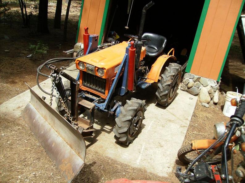

Also a picture of a someone else's 6100 tractor with hydraulic ram. My dream is to attempt something like this in order to attach a front bucket for the boys. Does anyone have any idea of costs involved with adding hydraulics for a future FEL? I have a wire feed welder and grinder etc.

Those pics sure do bring back alot of memories. Those little tractors like that have a special place in my heart. My B 7100 really opened my eyes about what a small compact tractor can accomplish. I noticed the mufflers on both the tractors in you pics have been turned up. I did the same to mine. That lay down pipe would make you look like a stack of smoked ribs after a long day. What's the reason for the front tires being reversed on the 6200? Is that a custom spit cup mounted on the tranny hump or what? Just had to pick at you a little. I truely understand about work in progress. I wish my 7100 would have been as nice as either one of those. When i said rough, I mean it was rough. Maybe your 6200 is just tired after all that sitting it did. Keep stretching it's legs and it will break loose.
