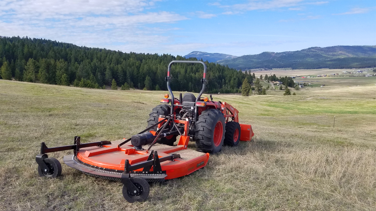

My rotary cutter has one wheel straight off the center in the back. Has Land Pride changed their design ?? Or thats a different type then mine ?
I apologize for missing this post. It's an RCR1884 that comes standard with one rear wheel (you can see the mounting location) but two rear wheels and chain guards are options that the dealer already had installed.

I'd like to make a comment or two about using top-n-tilt and a quick hitch with the cutter, and this is coming from someone with limited experience using t-n-t or a rotary cutter. The cutter is big, long and heavy and having a hydraulic cylinder for the top link is a real benefit in that I can raise the cutter much higher than I could with a fixed top link. If as stated in the operator's manual the quick hitch is adjusted such that the upper 3-point clevis pin is directly above the lower 3-point hitch pins then there's not enough lift to get the tail wheels more than a couple of inches off the ground. This makes it hard if not impossible to back up in some situations.
Having a hydraulic cylinder on one of the lift arm links is not as good in that the cutter goes out of level in relation to the tractor as the cylinder "leaks" so that's something I need to keep an eye on. A standard lift arm link set right (level) won't move which would be one less thing to worry about when running the cutter. If I can figure out how to disconnect the lift arm hydraulics at the rear remote I might be better off switching to the standard lift arm when using the rotary cutter. I'm not familiar with the style of fittings used on the rear remotes so will have to look into that.
On a side note, I bought a couple of cheap magnetic levels. One sits on the ROPS and one on the Quick Hitch and I can see if the hitch is level with the tractor regardless of the surface I'm on. I might come up with a more secure mounting option but am trying them out for now to see if they should be permanently installed.

Your TnT should not affect the mower. Set it level and mow. The top link should be adjust to allow the rear of the mower to float. You do not need to raise the mower to back up.
With a 3 point mower and with one as large as the one you have you need to watch for dips such as crossing a ditch. The 3 point can make your tractor act as if it is a solid frame 25+ ft long tractor. If you look in the owners manual it will give you good info about crossing dips and swales.
I run a New Holland TL80A with a Rhino TW96 offset mower. It is a 2 point attachment mower. The wheels never come off the ground.

I ran into the situation yesterday when heading downhill and cutting off a critter mound and wanting to back up to take another cut. I didn't seem able to back up unless I raised the back of the mower off the ground. I ran into a similar situation when getting to the end of a "row" when turning around and trying to back up a short but steep slope.
My point about t-n-t is that the cylinders change length during use. Oil gets past the seals so I need to check that the setup hasn't changed significantly over a few hours. Like I said, I'm new to this so have some things to learn.

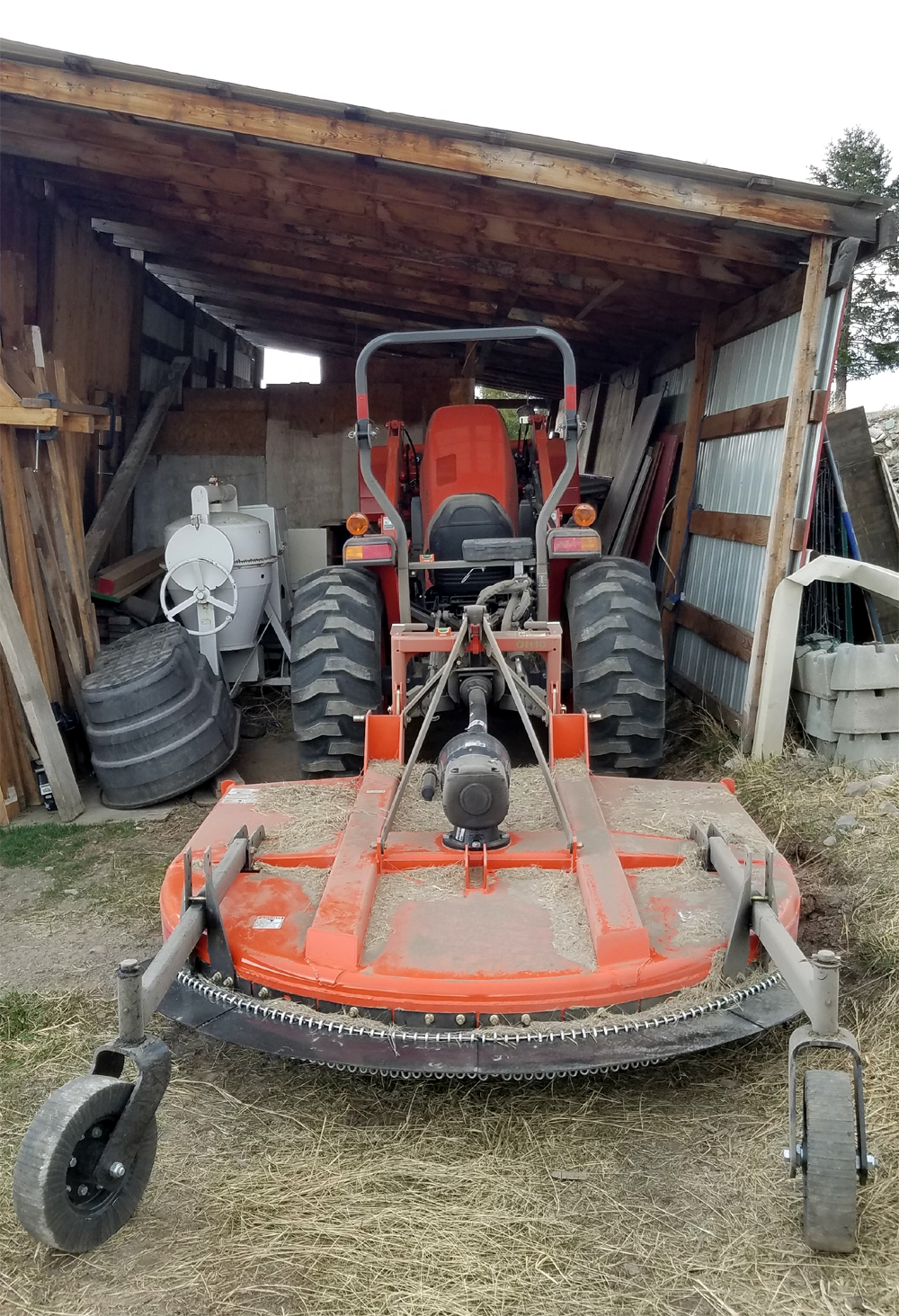

Now you’re going to have remember to clean that screen every time you start and stop the tractor through out the day. I use a blue cut to fit plasticky AC filter in front of my screen since we have a spear grass that gets caught in the screen and I have to pick them out one by one. Helps to just shake it out a few times and then replace it.
Use a leaf blower to get all that grass off the mower and tractor frame or it will mat up and get wet and start rusting spots.

I've never owned a leaf blower ... yet another thing I'll need to buy. Currently I'm using a compressor and nozzle to blow the crap off the tractor and cutter but it's slow. That's a good tip re using an A/C filter screen. I've noticed that it's best to turn the front wheels to the left or right in order to get clearance to remove the screen without bending it.
I lowered the deck one "notch" yesterday and ran up and down the field a few times to test and it's cutting great. Not fun though when you hear the blades whack a stone or stones that are inside a mound of dirt. This tractor & cutter combination really is a game changer for me. It's a great feeling knowing that I can take care of the field now and for years to come.

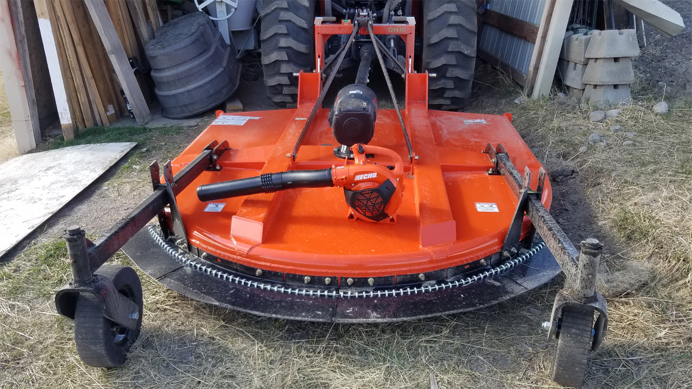

@Russel King, I bought an ECHO leaf blower today from Home Depot for $150. It's the PB-2520 model and supposedly made in Japan just like my BX and MX and is almost the same shade of orange! I won't be using it for anything but blowing crap off the tractors so didn't want to spend $$$ on a high end model. Already used it to clean off the cutter which sat out in the rain last night with grass/dust all over it.

I also have an echo blower and love that thing. I only use the premixed gas in a can since it is non ethanol and just plain easier than mixing it up yourself.
I don’t even look at the price per gallon and live in ignorant bliss with easy to start two stroke engines.
