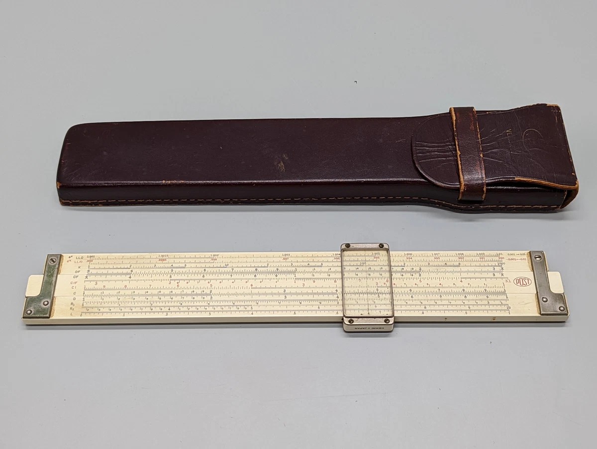

"Pen and paper"
That evokes memories of college physics. Formal exams were "blue book" events were your answers were recorded in little blue booklets with ruled pages.
My class was AP and given in the freshmen year as opposed to the nornal sophmore year. As a consequence most of us were takeing the prerequisite calculus courses conqurrenyly. As you might guess the class as a whole struggled with exams. The lone exception was Mr Denardo, a student from CA who was there on a full athletic schokarship (Fullback on the football team). He took exams using a ballpoint pen and finished with perfect scores in half the alloted time.
The professer assigned alphabetic grades based on a curve and by the third or fourth time the curve presentation was always prefaced by the words "first we throw out Mr Denardo" 🙃
PS> We were allowed to use a calvulator
