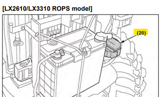

Check this if ROPS model :

Sounds like there is no power to the key switch and noted above are the probable reasons:
post #3 is (probably) pointing to a main fuse block
Battery cables need attention
Battery may be bad. (Eliminate the tractor battery from circuit and then attach truck battery to the tractor. Keep the tractor positive cable away from the metal parts of the tractor of course)
