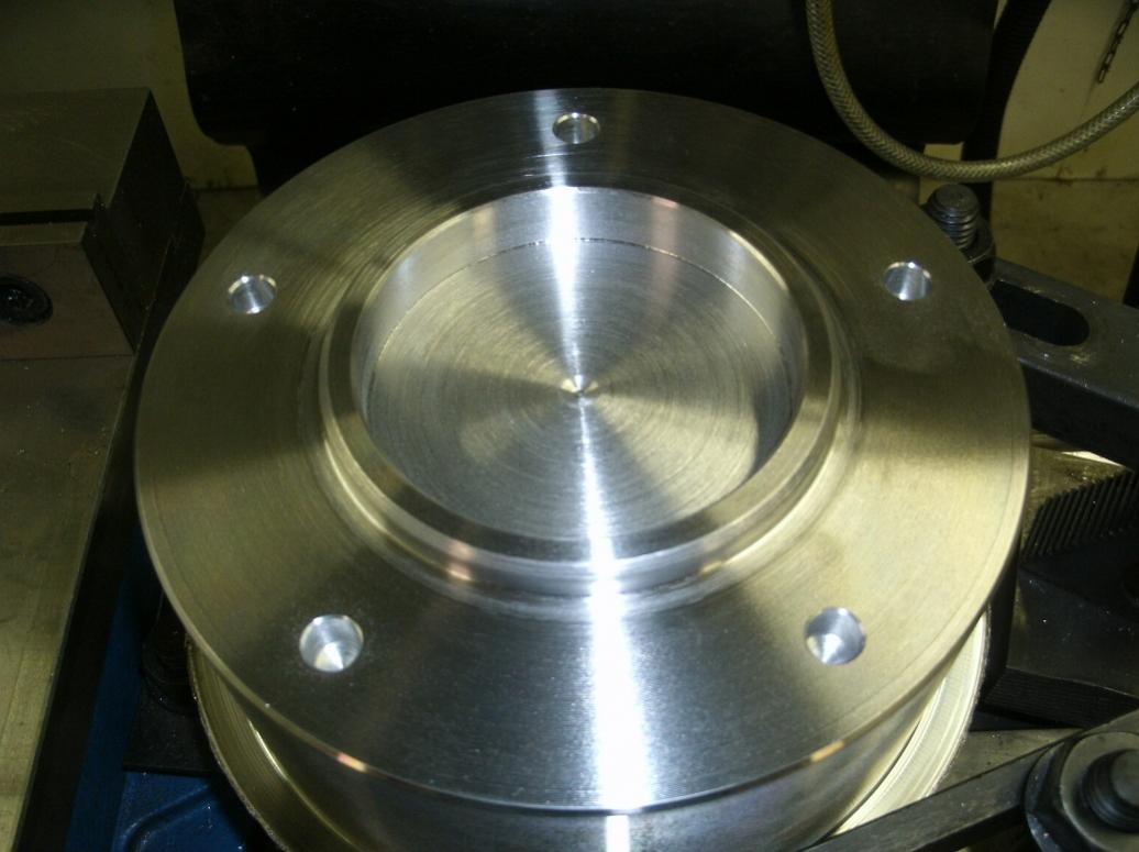

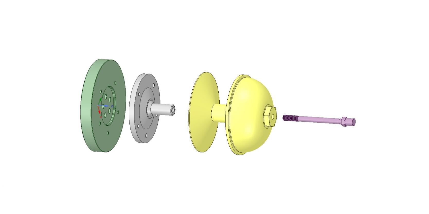

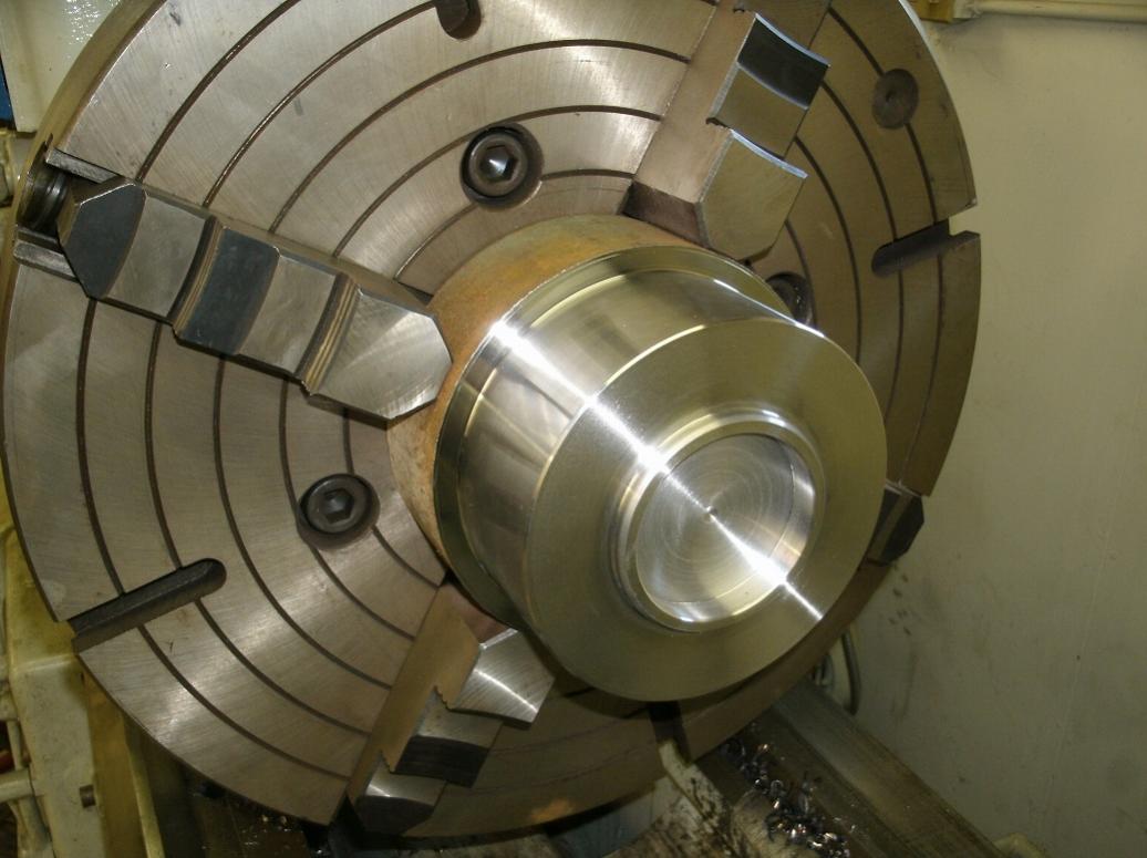

coachgeo put out a call for help on fitting a Kubota diesel into a motorcycle. He was stuck at the stub shaft needed to drive his clutch (torque converter). Since this is right up my alley, I volunteered to help him out. Through some back and forth, we established the parameters he and his partner, Curtis, wanted to see for the stub shaft. They wanted to have an outside bearing to absorb some of the side torque incorporating this in with the stub shaft. They sent me the flywheel and the clutch and the following is what we settled on and what I'm currently machining.
The key word on this project is concentricity. My plan starts with machining the back side of the stub shaft, where it mates up to the flywheel. From here, I will machine a replica of the crankshaft end and mount the flywheel and sub shaft to this to insure all is concentric. I'll explain the procedure with pictures as it unfolds.

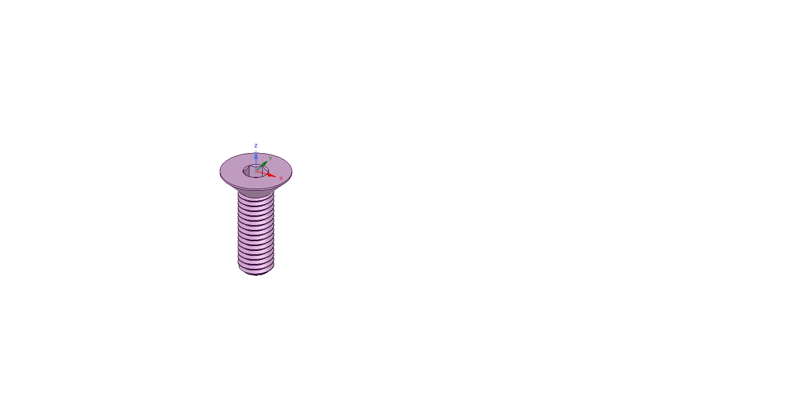

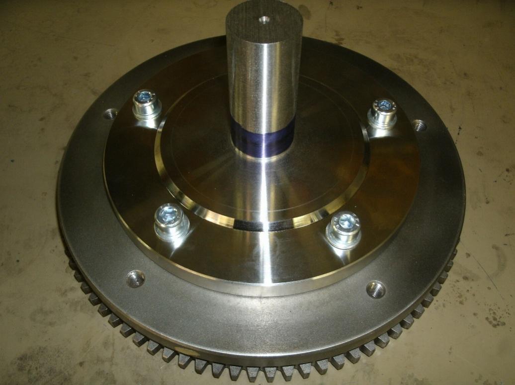

Turning the front side of the stub shaft in the lathe. Basically roughing it down so I can fit it on the flywheel for final machining. The blue on the shaft is for marking the bolt head height, which has to be taken into account because the back of the clutch must not hit these. The only M8 bolts I had were these socket heads, which are taller than a cap screw would be.
I'm wondering if a tapered bolt like the one in the last picture would work? This would allow the clutch to be a bit further inward, which is what the coach would prefer. Of coarse, it would have to get coach's approval, but does anybody have any experience if this is a good way to go?
36,725
11,448
Yes a taper head bolt would work perfect and would cut the clearance down to nothing. ;)
I would just use loc-tite on the bolts.
