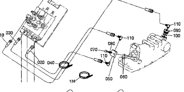

Can anyone tell me where I should tie into my hydraulics to run a front loader. I have a L2350 4WD and purchased a used loader and now I'm trying to make connections. My tractor has no accessory block but it does have power steering so I was thinking that maybe an access point? The loader is from another brand but did come with the controls which has 4 hydraulic lines.Any info would be great

If you go to the L2350DT Parts book page 100 is my book. You will see the block you need to add . Part # 32400-99810 It goes right under the seat were the pressure line comes from the hydraulic pump.You will remove the round cover and install the block. You might check with the company that made your loader as they may make a block. The last one I got from Bush Hog was way less the kubota charges for there block. Hope this help.

You are replying to a 5 year old thread. The block is a simple diverter that diverts the 3pt oil flow out to the implement valve and provides a return port for the flow to continue on to the 3pt. As long as the implement valve returns the diverted oil the 3pt works fine.

On that model, if you can't get someone to make you the block, it's easy to break the feed line and put 2 fittings on the ends to supply the loader valve.
Here is a block for sale, it isn't cheap!
