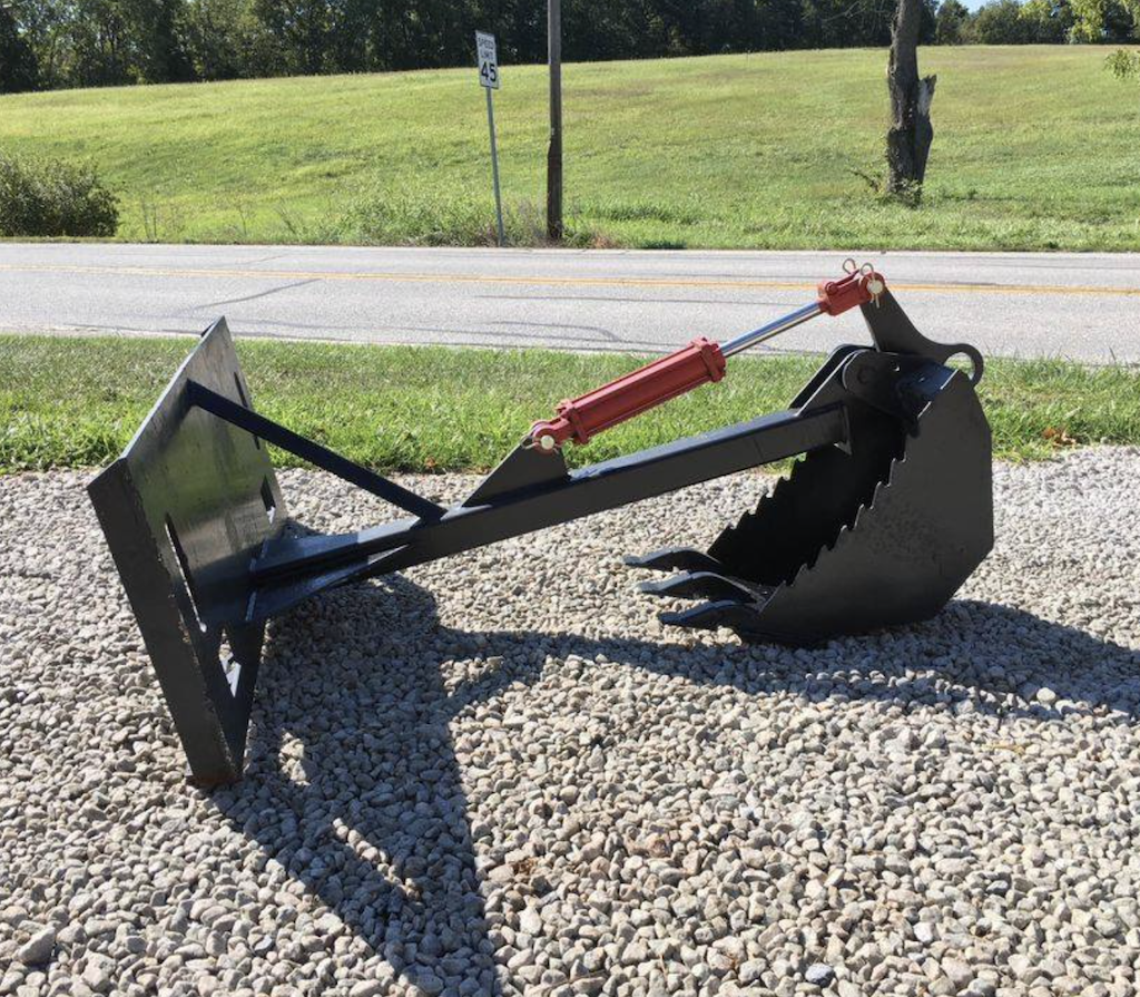

I bought one of these little guys to use to uncover my septic tank lid every couple years to get it pumped out, I also buried a dog we had to put down and planted a couple shrubs and trees with it. It works great for light duty use. It's been sitting since I bought my JD 510 backhoe but was a handy attachment much better than a shovel and digging iron or post hole digger.

Ed, good to see someone with a hands on experience report in. There's about 20 post of why not's. It all depends on the use, frequency and operator skills as to what to use for any specific project. It may be a glorified shovel, but it gets the job done that you needed done. That makes it a useful tool.
I have a 40 HP Ditch Witch with a hoe on one end and digging chain on the other and a 6 way backfill blade. I usually don't comment on threads about hoes because I just don't care what folks want to argue about how good/bad they are.

I hear you and feel the same way for the most part. I picked that quick attach hoe up used for 400 bucks and used it on my B & MX without and problems but that said I wasn't trying to dig out stumps either. :)

A towable digger makes a lot more sense than a fronthoe on a tractor loader, in most situations i can imagine.
I think a stump bucket makes more sense than a fronthoe on a tractor loader in a lot of cases too.
A skid steer is really what makes a fronthoe a workable idea if other better options are not in the budget for said skid steer operator/employer. The maneuverability and visibility difference on a tractor loader would take it from 'just ok' to 'terrible' most of the time. But, terrible from the operator's seat of a big cool machine is a different kind of terrible from digging anything by hand!!
The one thing about a fronthoe that makes them not a 'definite no' from me is that light duty ones are actually pretty cheap. They are very simple things, as edritchey's pic illustrates well. If you can get a cheap one and already have the remote to run the bucket cylinder, you will probably like it over not having it at all. It's more a question of, if something better is in the budget should you just do that instead, and do you have the caution and mechanical empathy to avoid damaging your loader with it?
