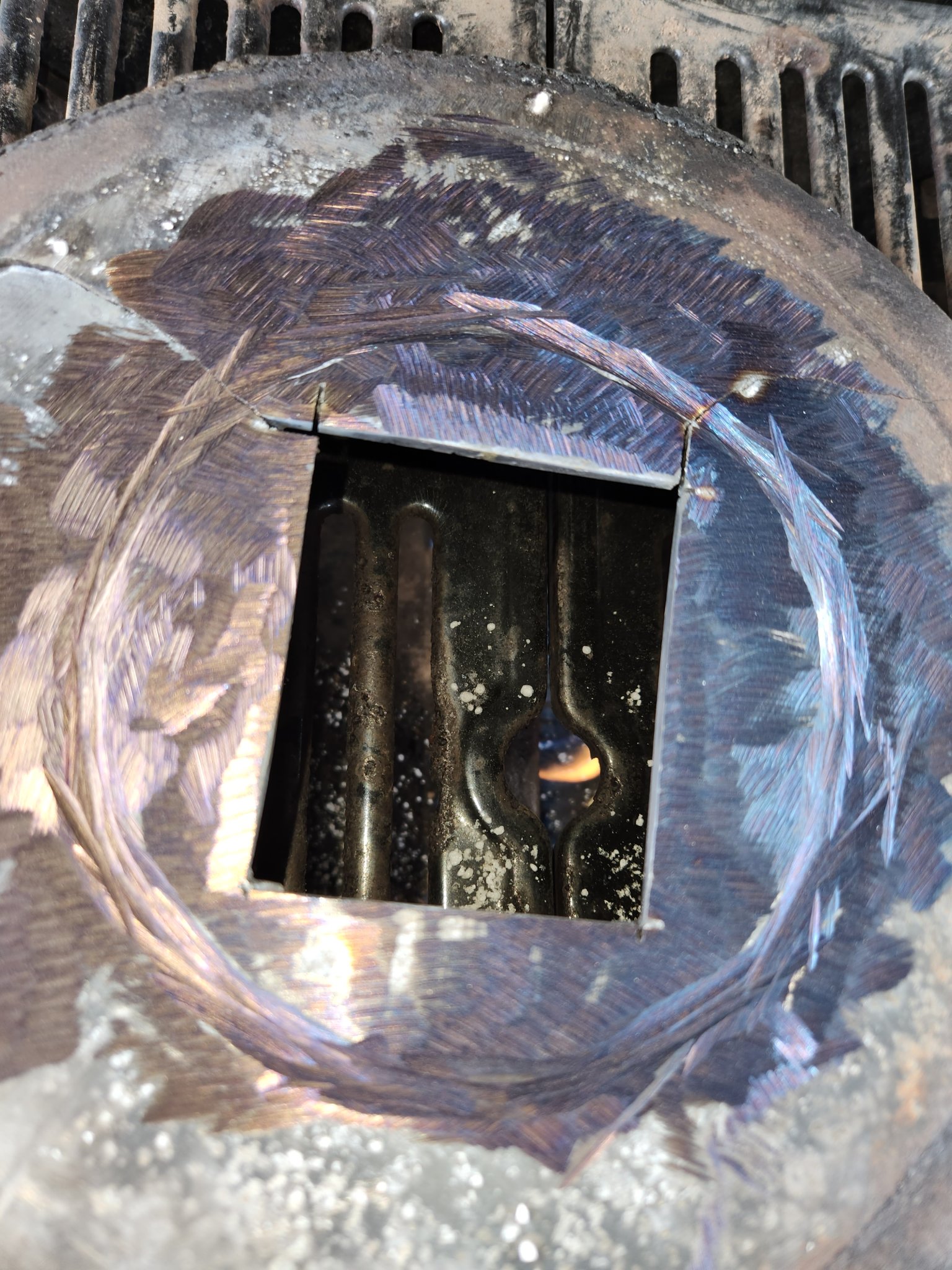

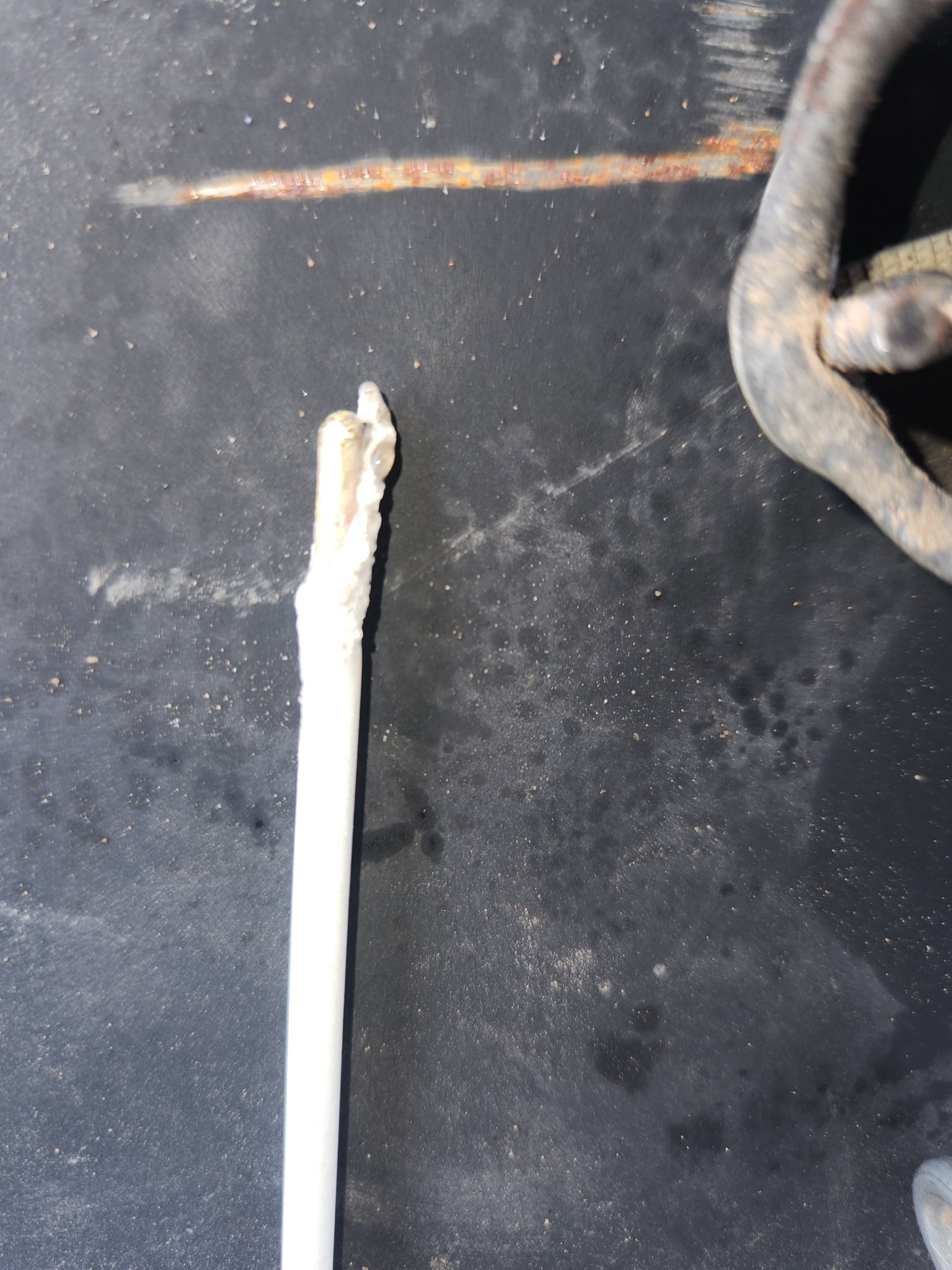

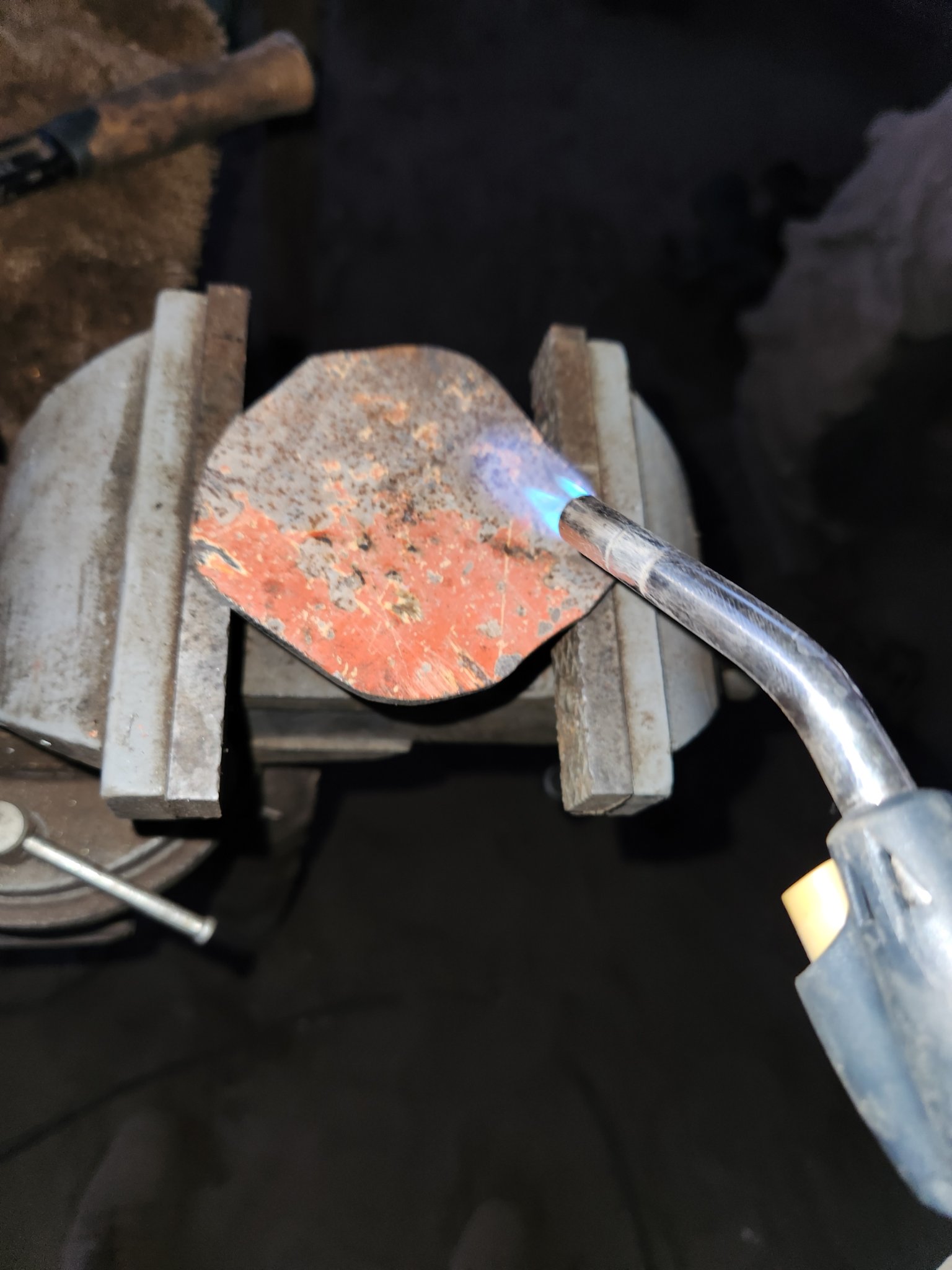

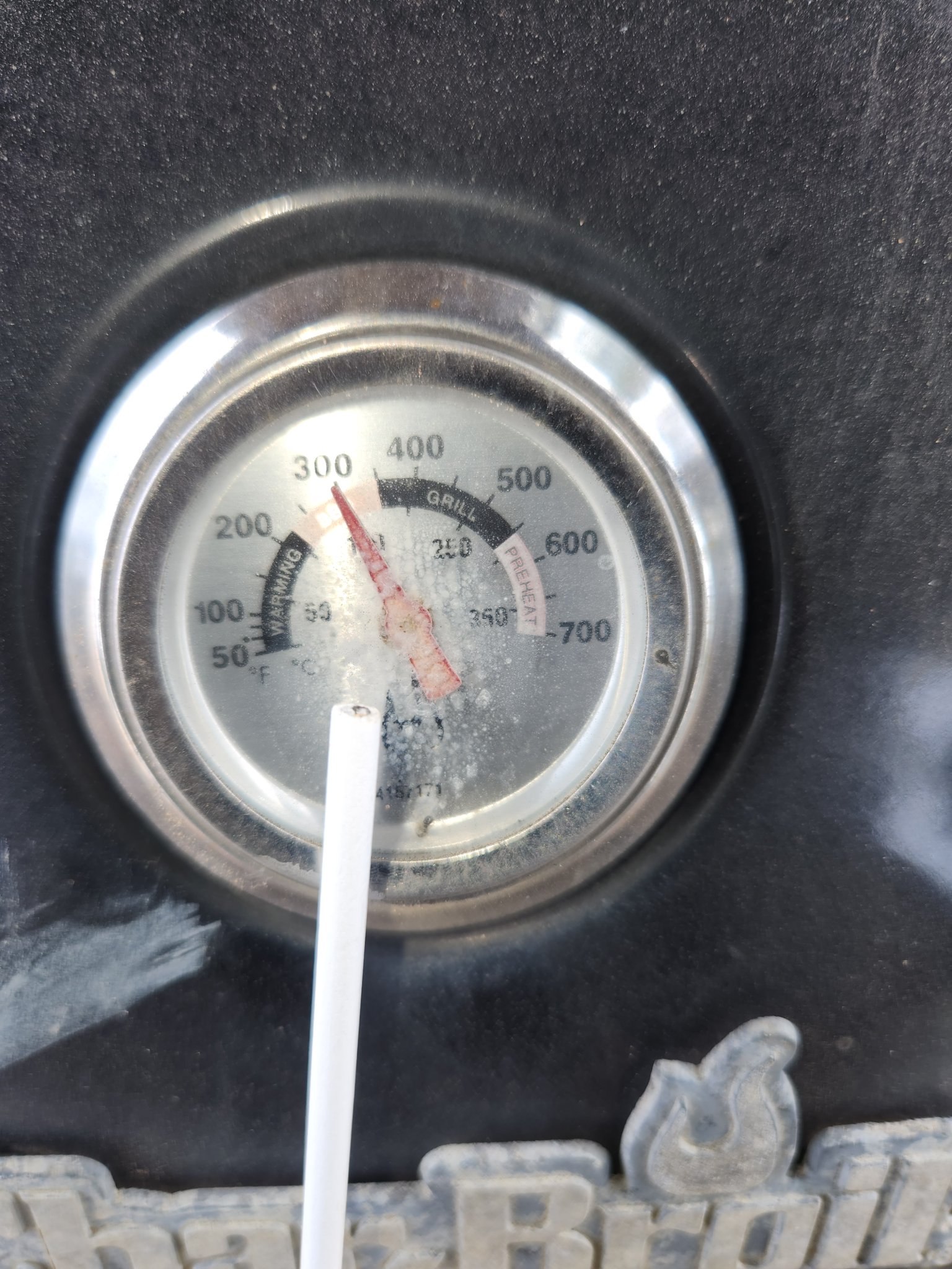

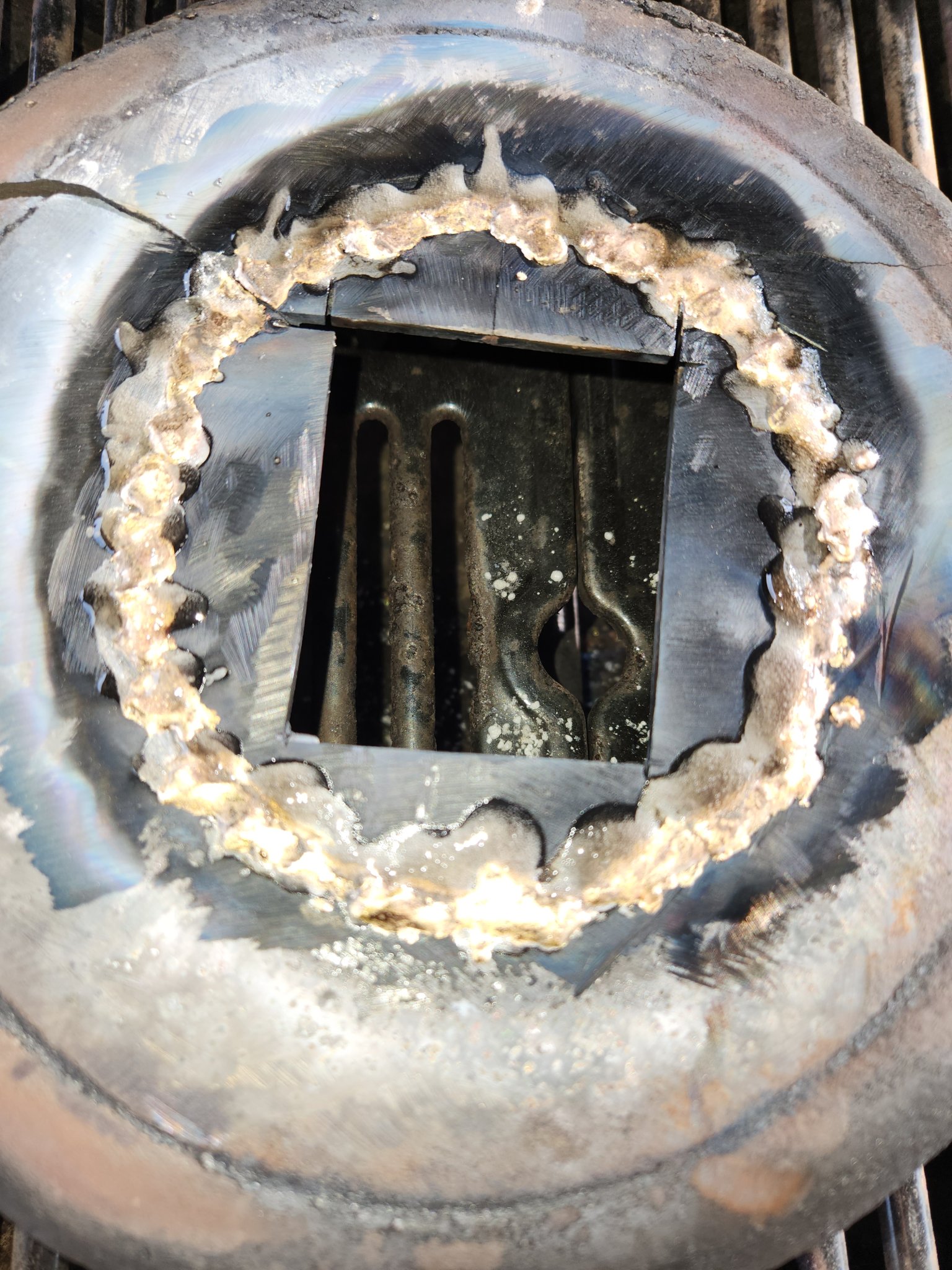

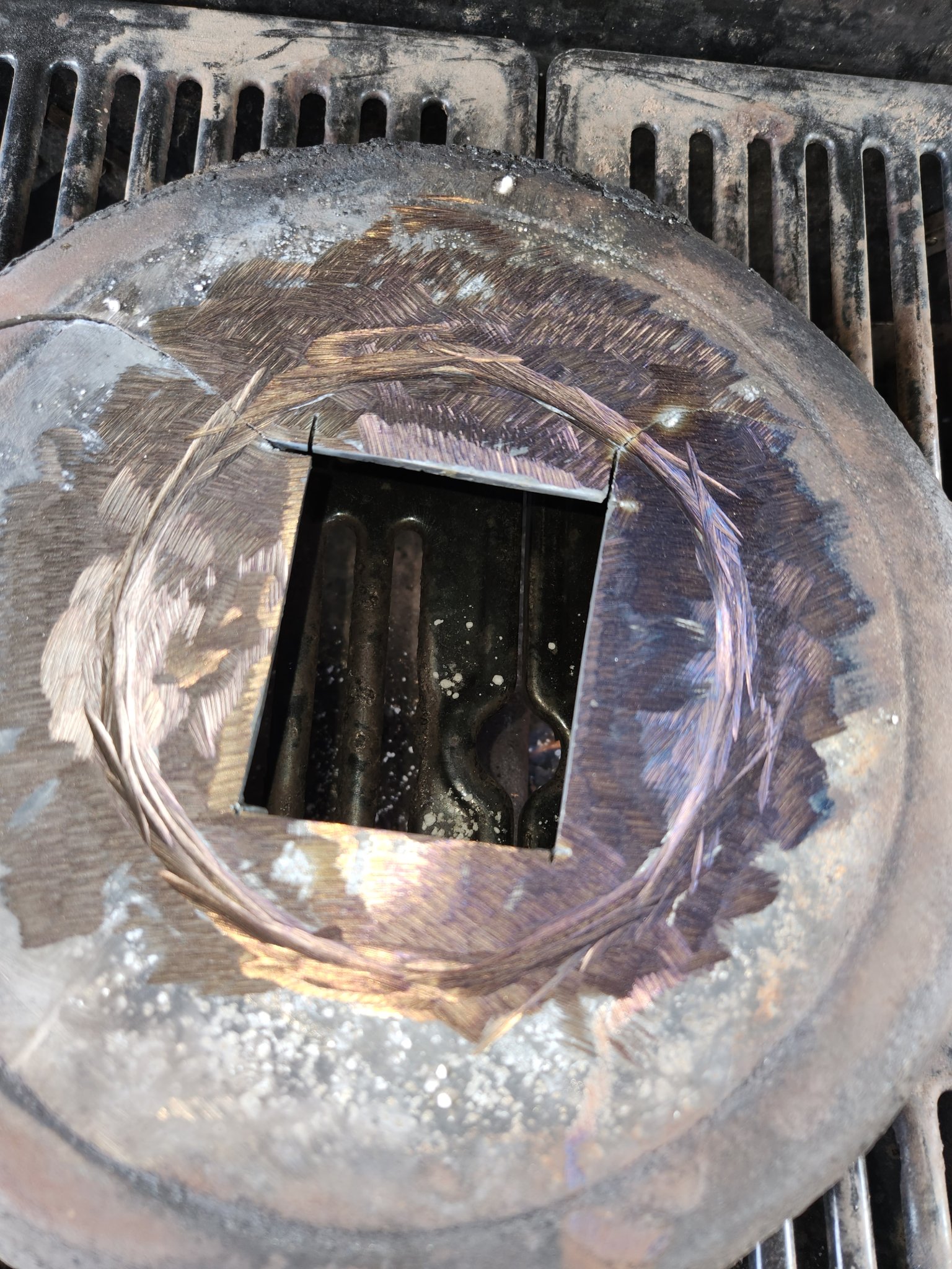

I mightve achieved the goal...
Heated cast iron, picture of thermometer is of the flux coated bronze being used
Notice how blue I got the cast iron in the BBQ grill
Last picture: melted bronze into the groove of the cast iron
Exactly what I did different: flame about 4 times stronger (whoever said that you are smart)
Left hand holding bronze was pushing down on area where we wanted it, soon as it melted, pull out and move to the next area to do another mini puddle
Now: in the oven on low heat, let it cool down and I post for yall hammer test in 15-30 minutes...
Sledgehammer will be used: for fun, while we wait for it to cool, say whether you think it will hold or not hold

Good, now go buy JBWeld epoxy and fix the block cause there is no way you'll be able to braze the patch in and NOT destroy the block. Given the equipment you have and your level of practical knowledge, you will not succeed. Not trying to be mean or cruel, just a 'reality check'.
You need a LOT of serious heat ,in a CONTROLLED environment to braze the block.
View attachment 136114 View attachment 136115
Congratulations!
A lovely bubble gun mess!

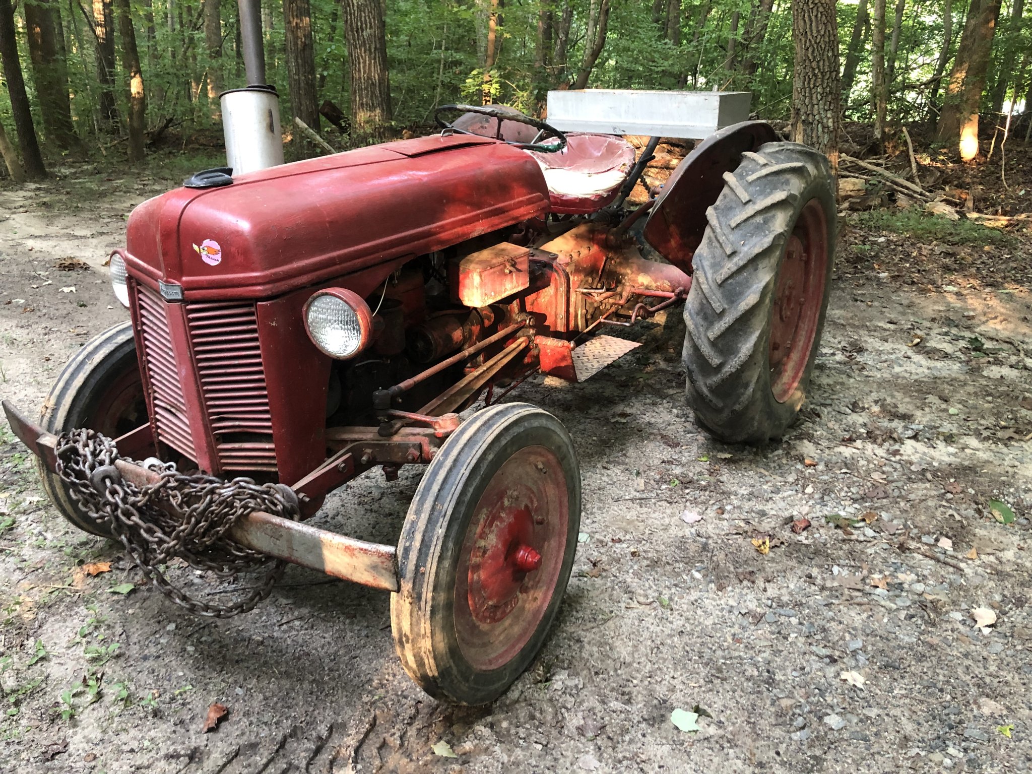

Not sure this is worth posting, but…

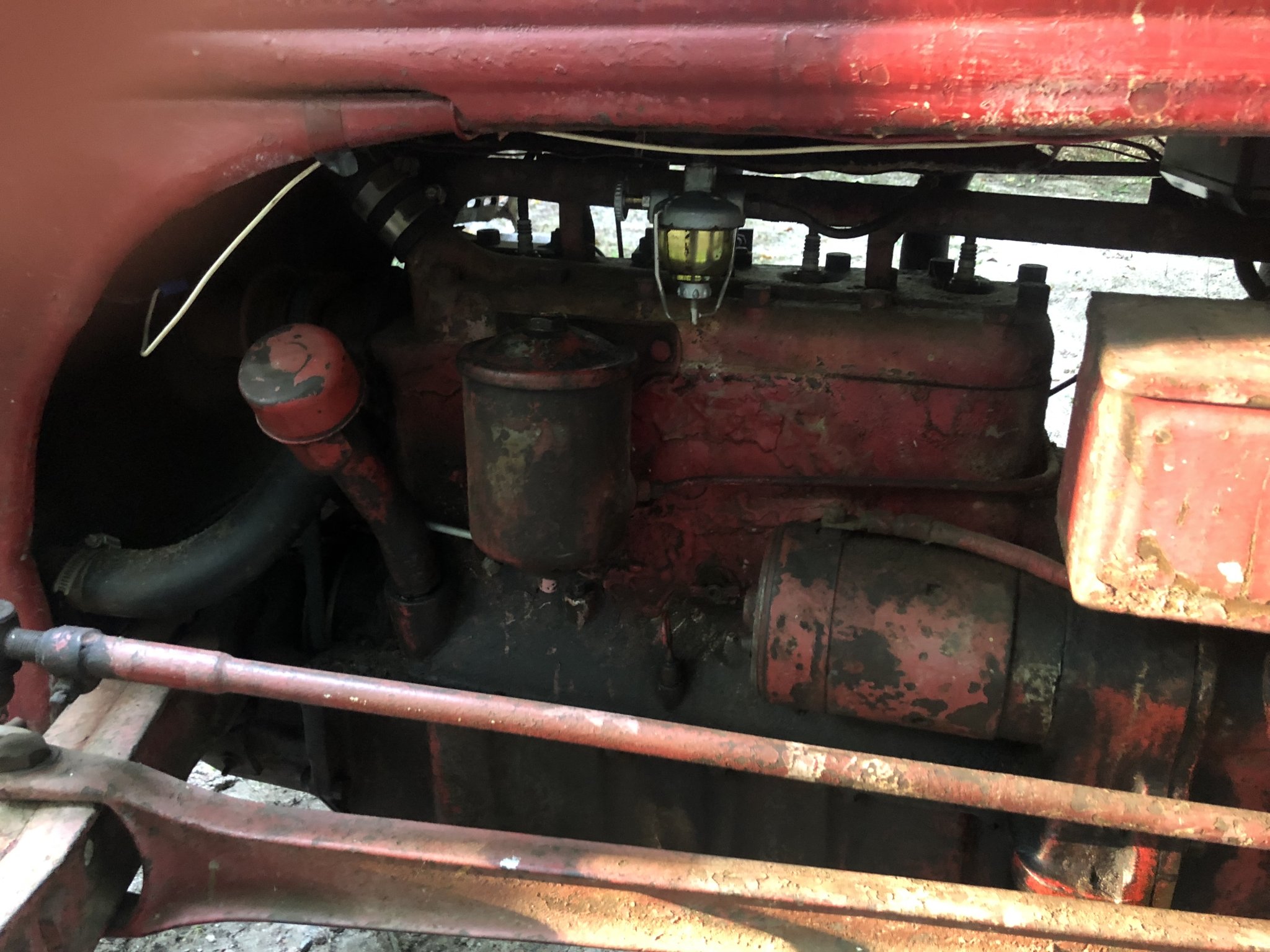

Somewhat before I was born, I think mid-1960’s, my father bought this Ford that had a long crack and chunk missing from the left side of the block. He rebuilt the engine and glued a piece of steel in the hole with some sort of two part epoxy. In the late 1970’s it started to weep coolant. I was tasked with removing the coolant, wire brushing as needed, and prepping to re-coat with JB Weld. The point was to make it functional and if it looked good or looked like crap was irrelevant. IMG_9640.jpeg
If you zoom in on the below pic, you can see the left side of the block under the filter bowl looks kind of melted. That’s a large quantity of epoxy. The hole was big and the crack was bigger so it took a lot of epoxy. Doesn’t look good, but as of November 2022 when we gave it to a fellow who had a use for it, it hadn’t leaked again and it ran just fine. IMG_9651.jpeg
First attempt at repair with epoxy lasted about 15 years +/-. Follow up with JB Weld lasted about 45 years +/- and still counting so far as I know.
No telling how many hours my father put on that thing with the epoxy repaired block. I’m confident I put well over 1000 hours on it myself, many of them would be considered abuse by many here as it was used as a skidder quite a bit. Yes, we got rid of it. Didn’t think I would ever part with it but after my father passed I couldn’t stand looking at it every time I went to the shed. Why isn’t relevant. Next to last time I drove it was on this trailer under its own power. Last time I drove it was off the trailer at its new home. It was running as good as ever and not leaking.
Point being, those who suggest epoxying a patch aren’t suggesting some half-a$$ repair that won’t last. Just something to consider. If it doesn’t work you’re out the cost of some JB Weld so it’s pretty low risk.
Braze it. Weld it. Do whatever you want. Hope it works out for you whatever you do.
Edit: BTW, for anyone actually looking at the photos, I’m aware the hood says Ferguson. It’s off a 35 (I think). Expertly fitted with a sledge hammer. It’s a junkyard hodge podge of a machine. Mostly a 9N, though.

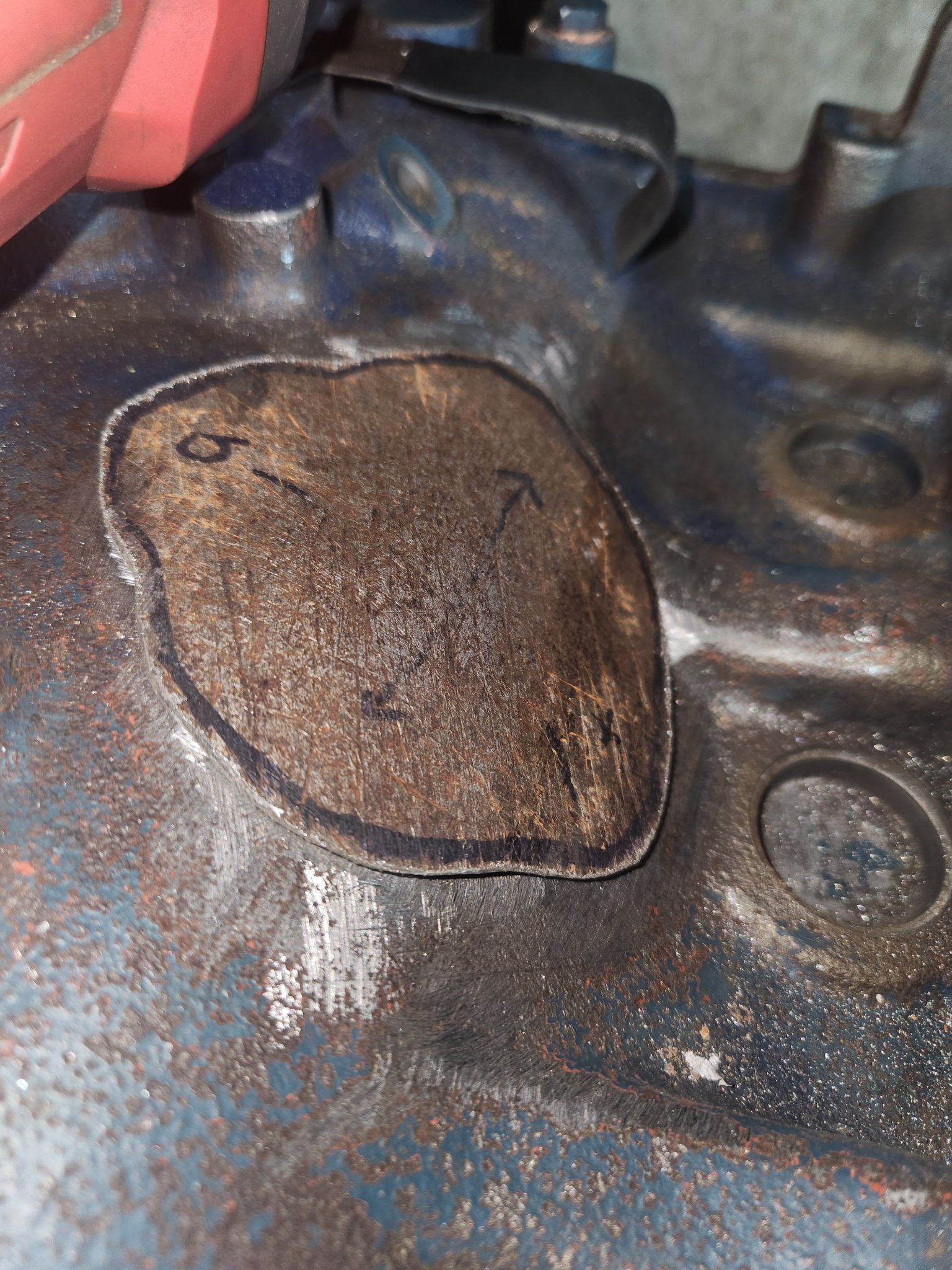

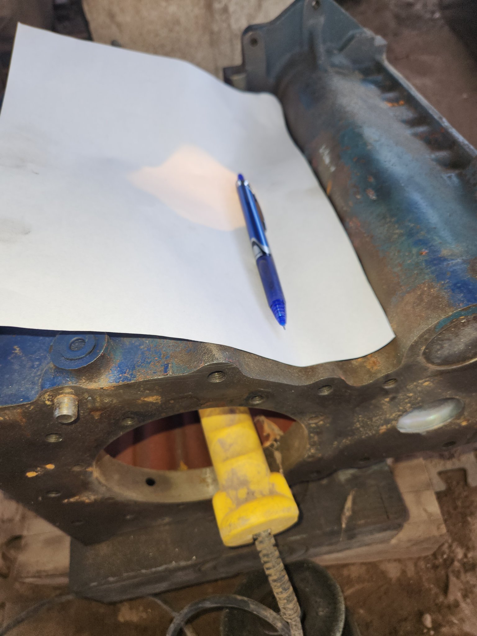

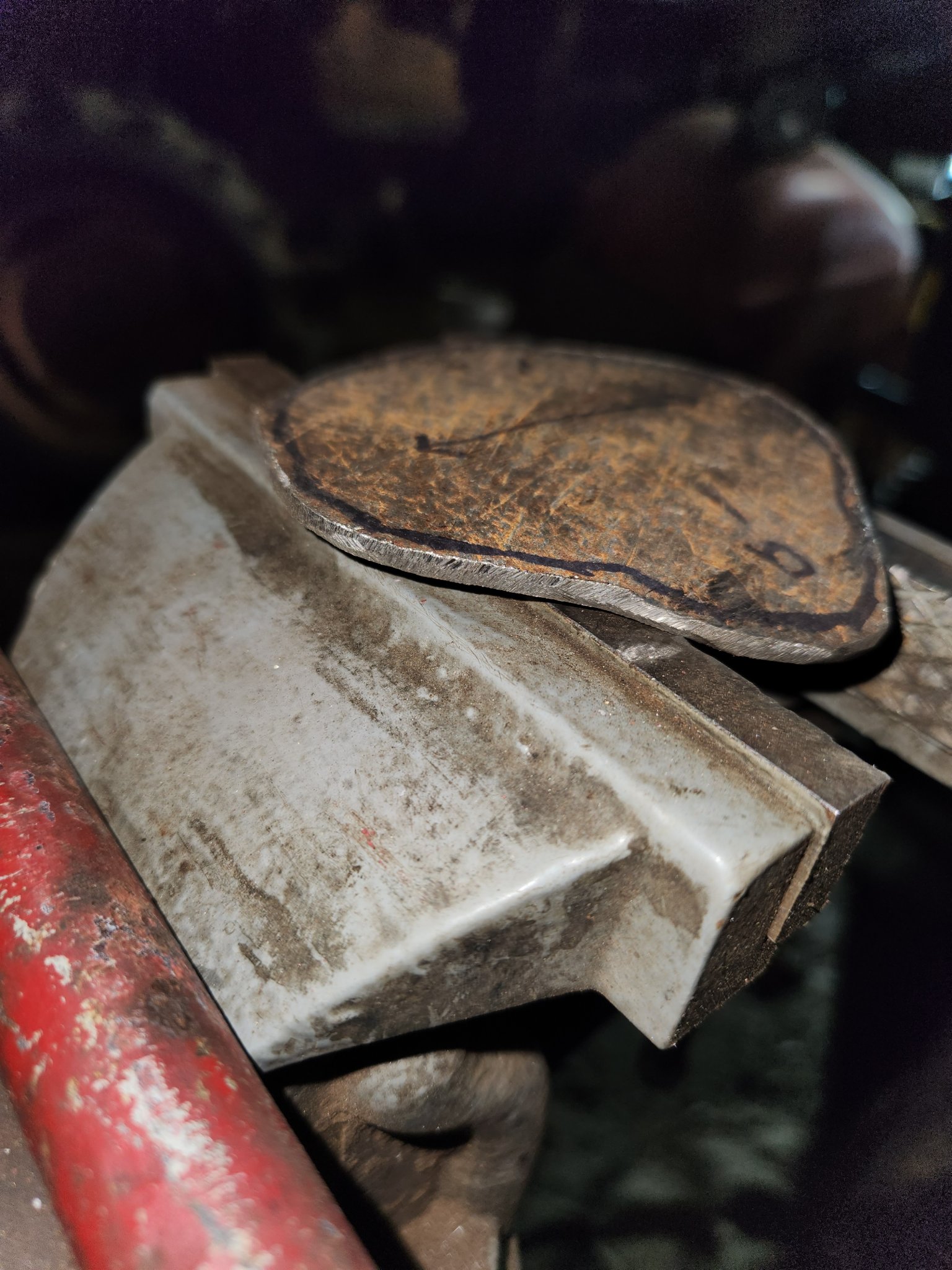

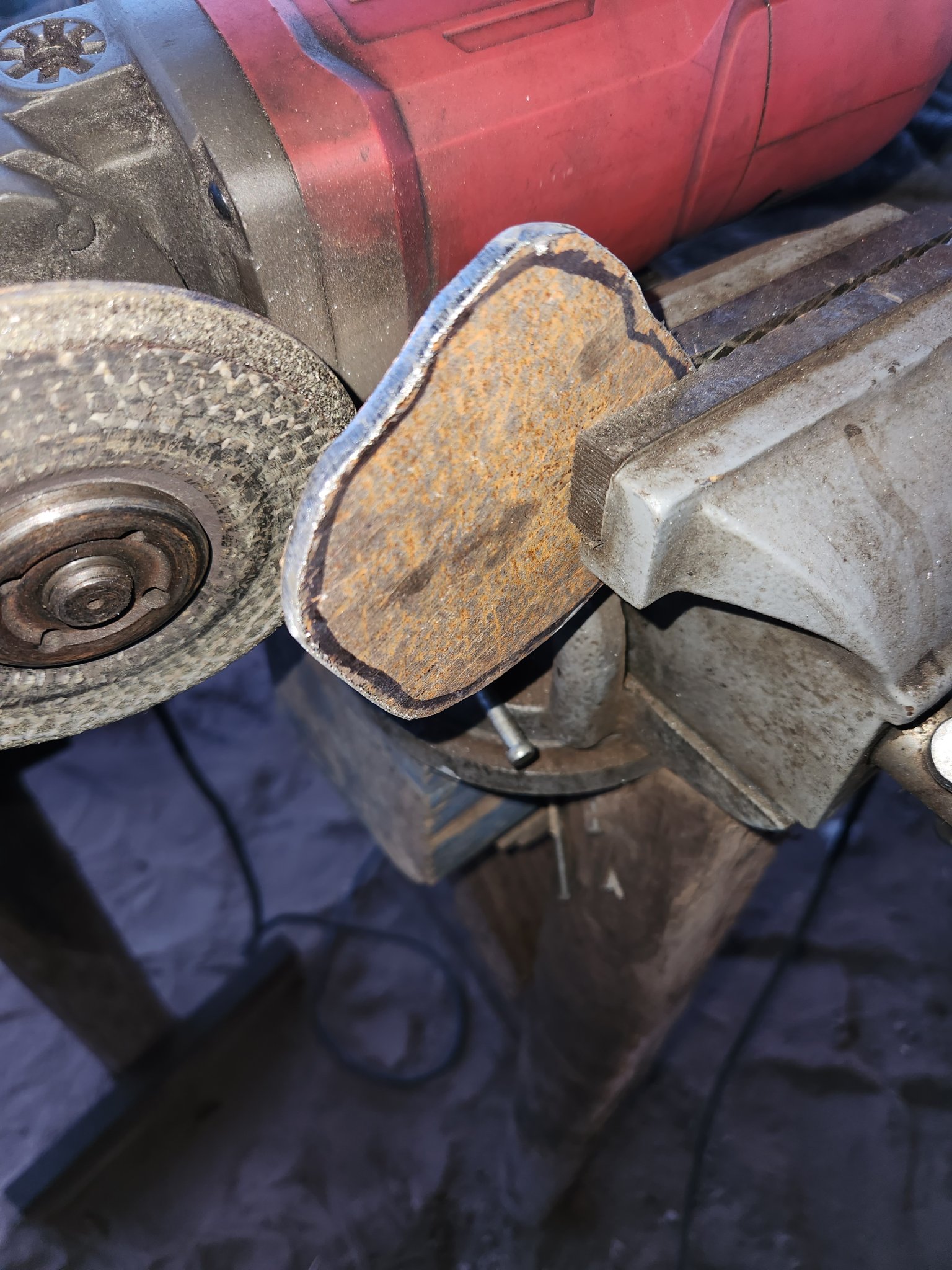

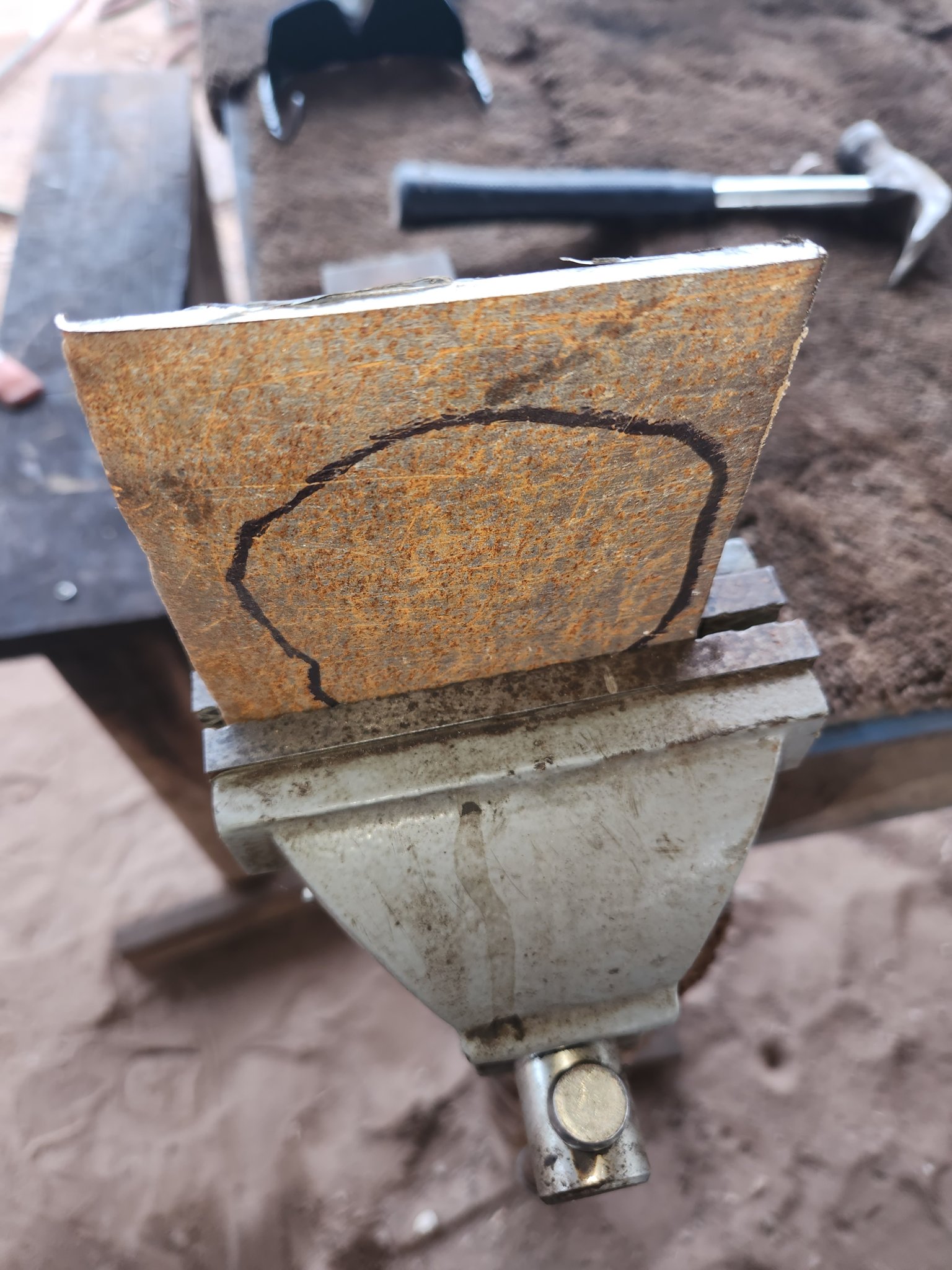

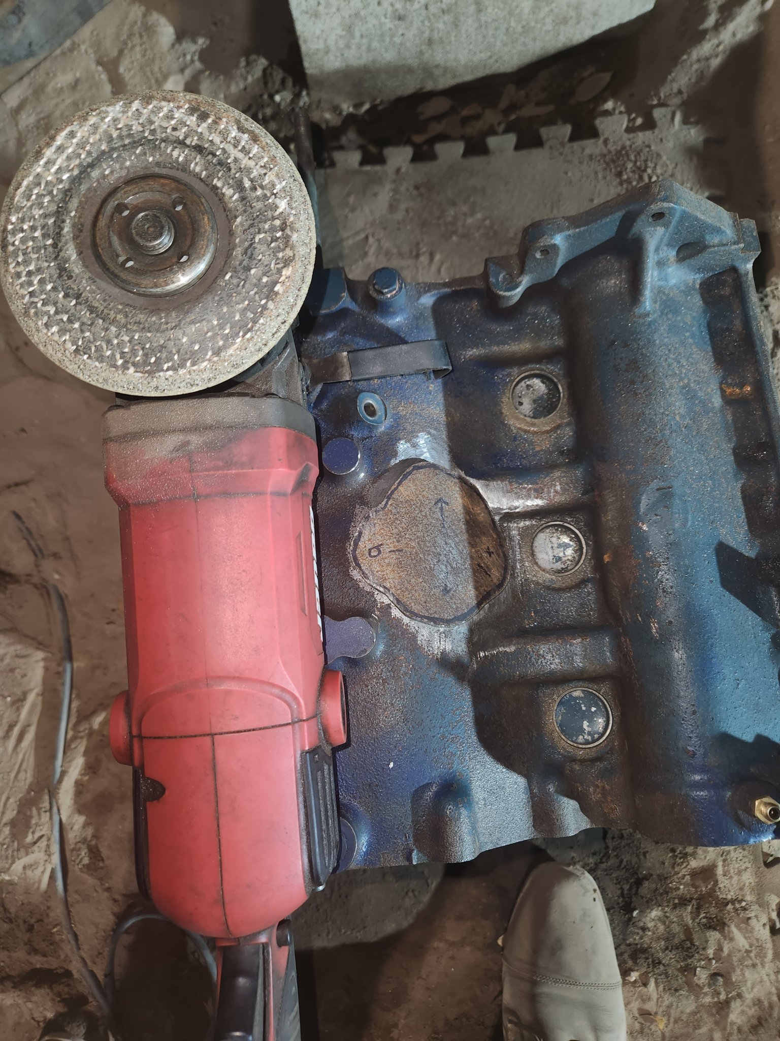

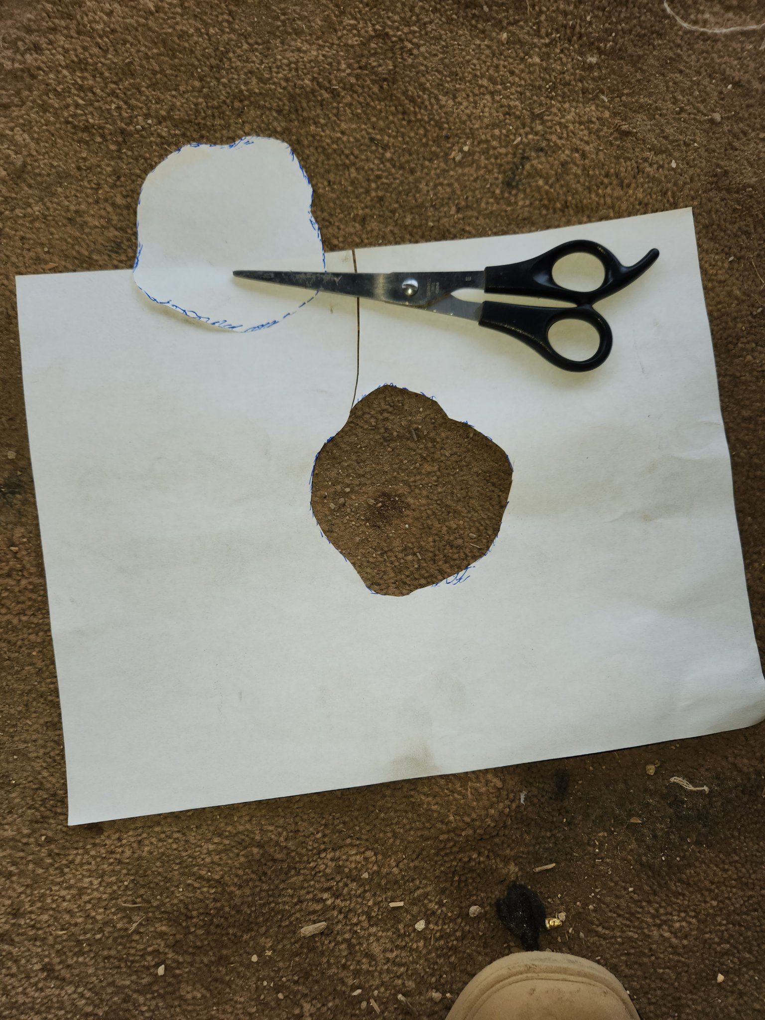

I can't upload the weld test video, my internet weak, I'll upload tomorrow

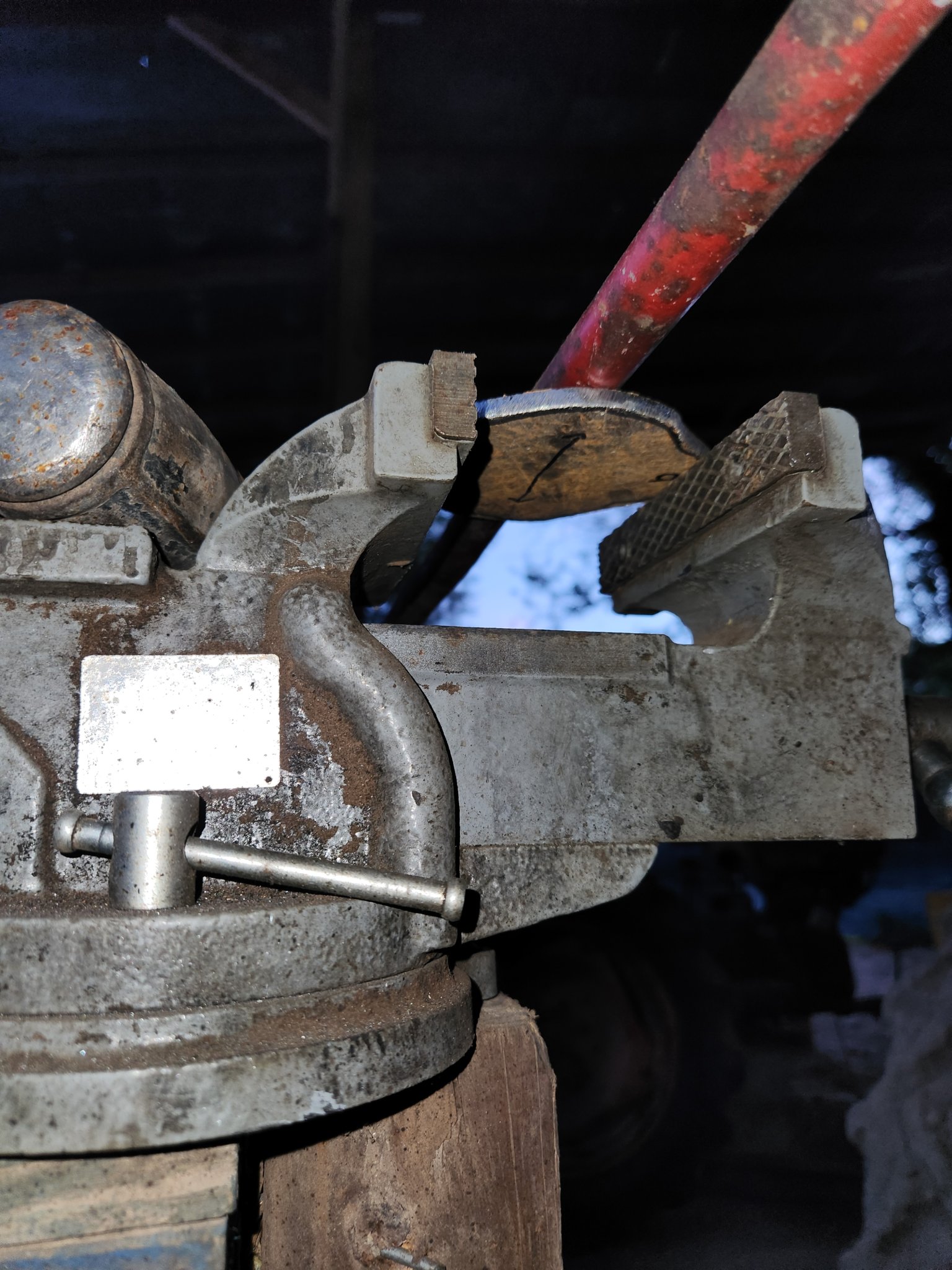

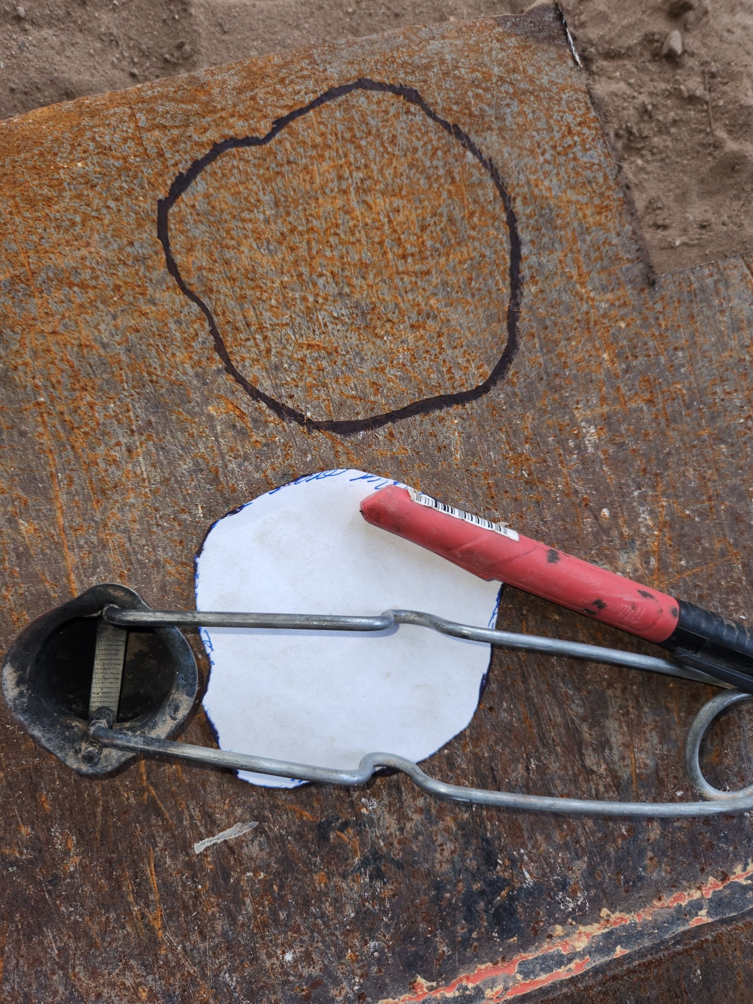

Almost got a patch ready for engine block
20240827_190622.jpg 20240827_191306.jpg 20240827_191537.jpg 20240827_192515.jpg 20240827_195955.jpg 20240827_200905.jpg 20240827_201159.jpg 20240827_202551.jpg 20240827_210827.jpg 20240827_212235.jpg
Hit engine hole with abrasives including files of different shapes
Put a light in engine block, piece of paper on top, traced it
Cut it out, put it on broken loader, traced it, cut out the square
Put square on vice then hit it with cutting wheel and grinding wheel getting closer to desired shape
Put flat patch along engine block, labeled top and bottom and a line for where it bends
Took patch to vice, put rod above it, hit rod with sledgehammer, bending patch along the line yall see
Got it close to shape of block, then sitting next to block and grinding wheel, putting patch on block and seeing where to grind it
Sit down, patiently grinding away, grind bottom of patch and block tapered so they fit snug

I'm rooting for you Joe!
That fitting job of the patch looks great. Better then some of the trained fitters I've seen.
At this point or after grinding the bevel I'd take it to someone that knows how to braze and let them do the dirty work...
...or you've been fooling us all along and playing a huge joke and have actually figured it out over the past 50 years like everyone else is suggesting. 😂
Or another option is grind the patch 1/4" to 1/2" smaller all around and epoxy 'sandwich' it in if you can access the backside to smooth it in.
View attachment 136138 View attachment 136139 View attachment 136140 View attachment 136141 View attachment 136142 View attachment 136143 View attachment 136144 View attachment 136145 View attachment 136146 View attachment 136147
That's a fine looking patch! Make sure you don't have any slots or sharp corners like you did on the skillet. As you've learned, that's where cracks originate, whether you braze or epoxy.

skillet was already broken....stress crack from square cut
There was zero chance that I was going get that weld without completely shattering the entire skillet, including the area where cast iron was not cracked, bottom of the skillet
Where is this suggestion that others are making that I have lots of experience welding?
Please elaborate on exactly what you mean, with full sentences and zero assumptions
Anyone else find this statement interesting? There is big meaning behind this statement, with tons of assumptions
Implicitly he/she is saying way more than what is actually articulated

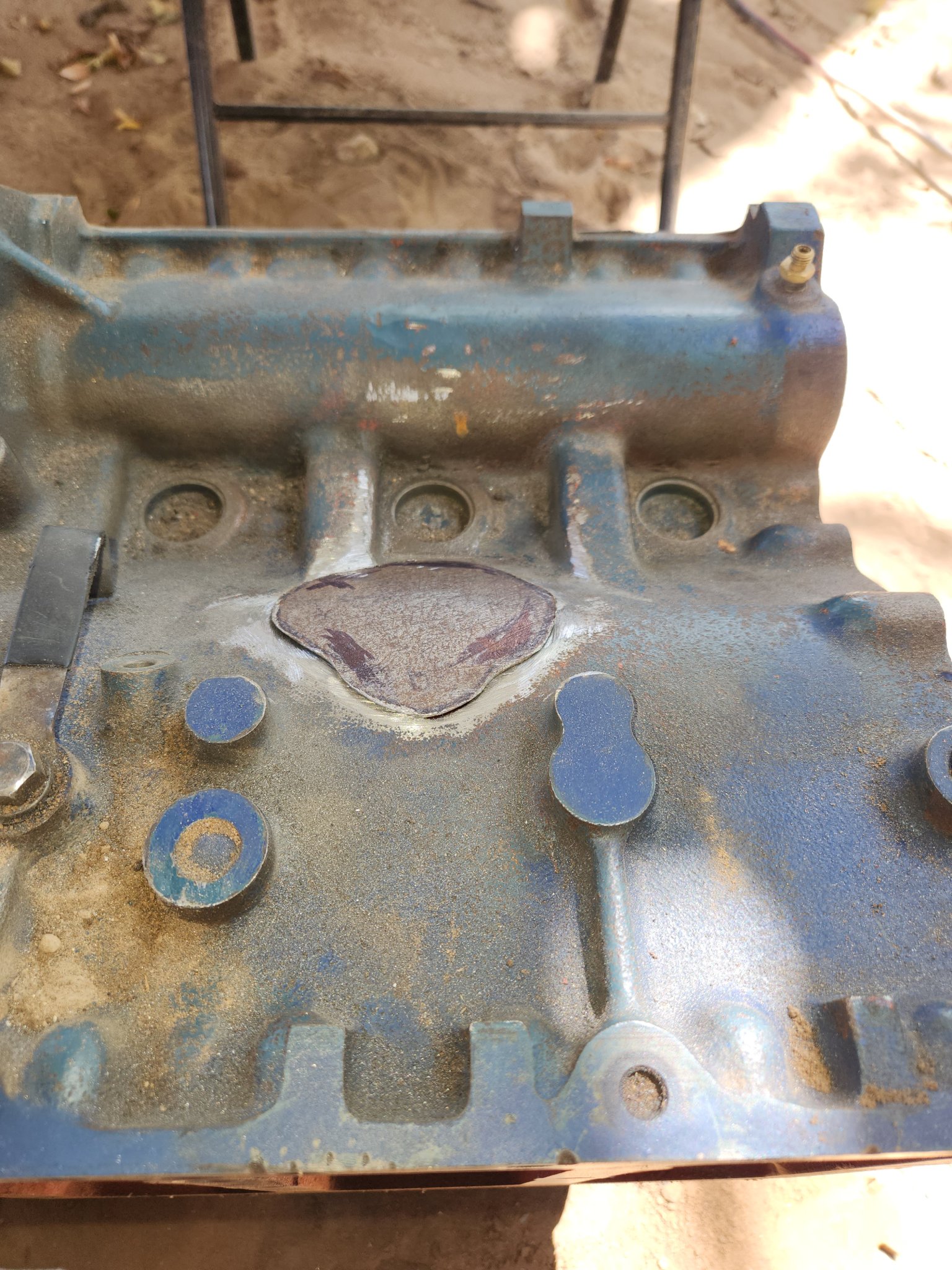

That sandwich your talking about is what is happening - As I taper the bottom of the patch and the block, they are slowing becoming more flush with each other
Moving forward: Hit the block and the patch with grinding wheel accommodating the shape of the patch into the shape of the hole in the engine
Spent 4 or 5 hours last night sitting next to the block: put the patch on the hole, used a light to see where there wasnt a gap, that is a high spot, mark it with sharpie, hit it with the grinder exactly where you want it to drop, I did this task until I couldn't see straight from fatigue
the goal: carve into the patch in this custom and tedious fashion, sinking the patch into the block to give it a more flush look and better seat for better reliability and stronger hold
I do have some cheap Walmart epoxy, or I might invest in 3M high quality epoxy,
Regardless, I cannot invest more in this project until I have more money
Patch almost flush with block

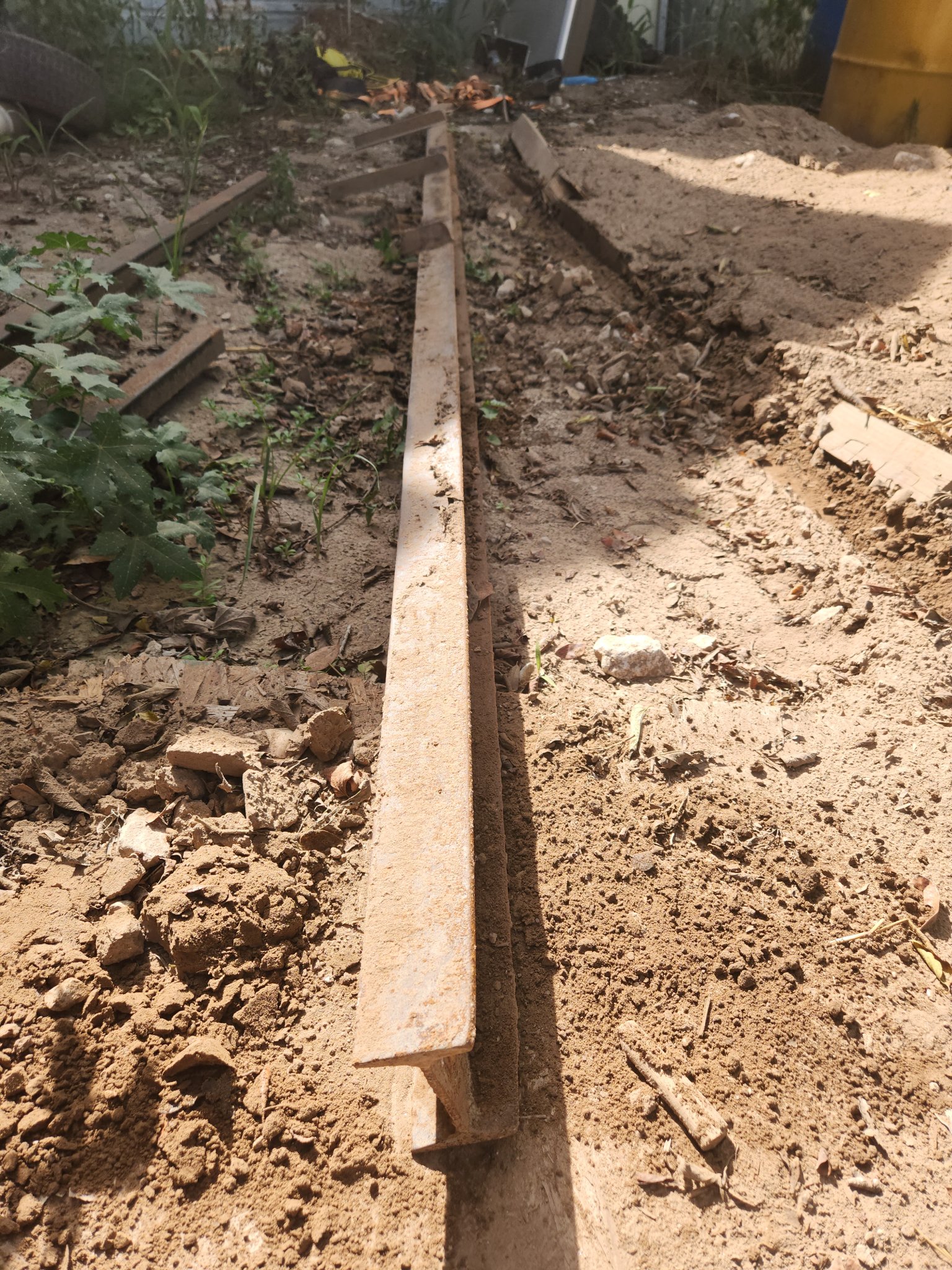

Bucket of bx1500
While waiting on financing the rest of engine build, it would be nice to build up this bucket with solid steel and maybe give it teeth to cut the earth
10 foot I beam: use this to make robust loader
Square tubing 1 inch, I do also have 2 inch square tubing
Goal: finangle a bucket back together with teeth and real strength using the I beam and other metal shown
Goal: make it sharp and durable loader using scrap metal
