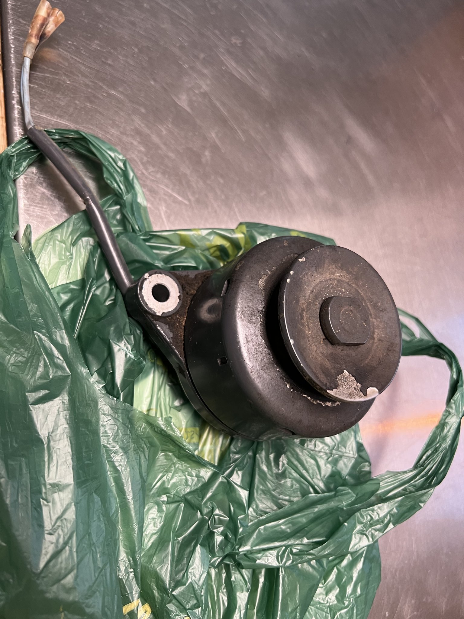

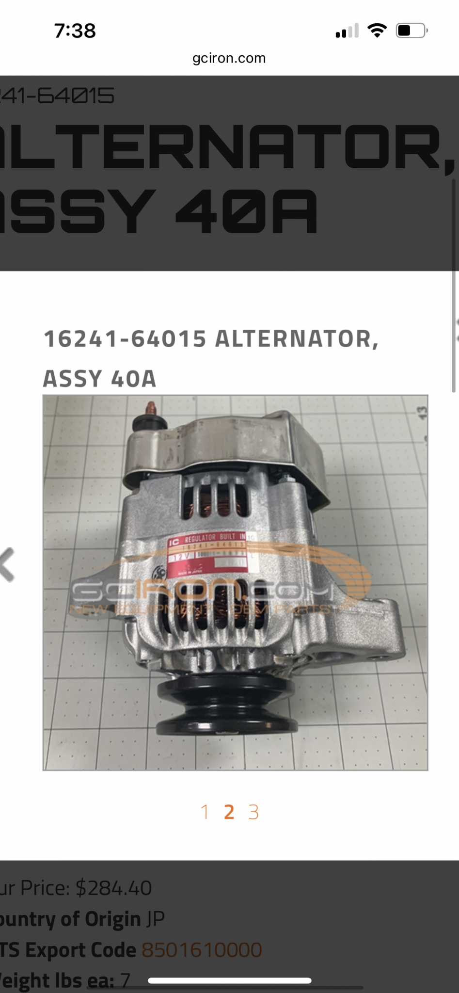

funny you should say that. When I went to put the new belt on I found that the alternator is seized up. So now I’m trying to find a new alternator. When I go on messicks and look Up the alternator part number and find a picture of it it looks completely different than my alternator. What’s up with that?
This is the alternator I just took off.
and this is what comes up when you search the part number from messicks.

You have a dynamo, there was probably an alternator option for more power.
The dynamo puts out unregulated AC, similar to a riding lawn mower. It's much simpler than the $200+ price would indicate, no brushes even. You can easily replace the three bearings. They're about $20 each from Messick's, but you should be able to get them from a supply house cheaper and quicker.

You have a dynamo.
They are EASILY rebuildable. The bearings often seize and that really is the only thing that "ever" fails in them.
17mm nut on back, take it off, tap the shaft out and then pull it apart. IIRC, 6203 radial ball bearings. 2 I think.
