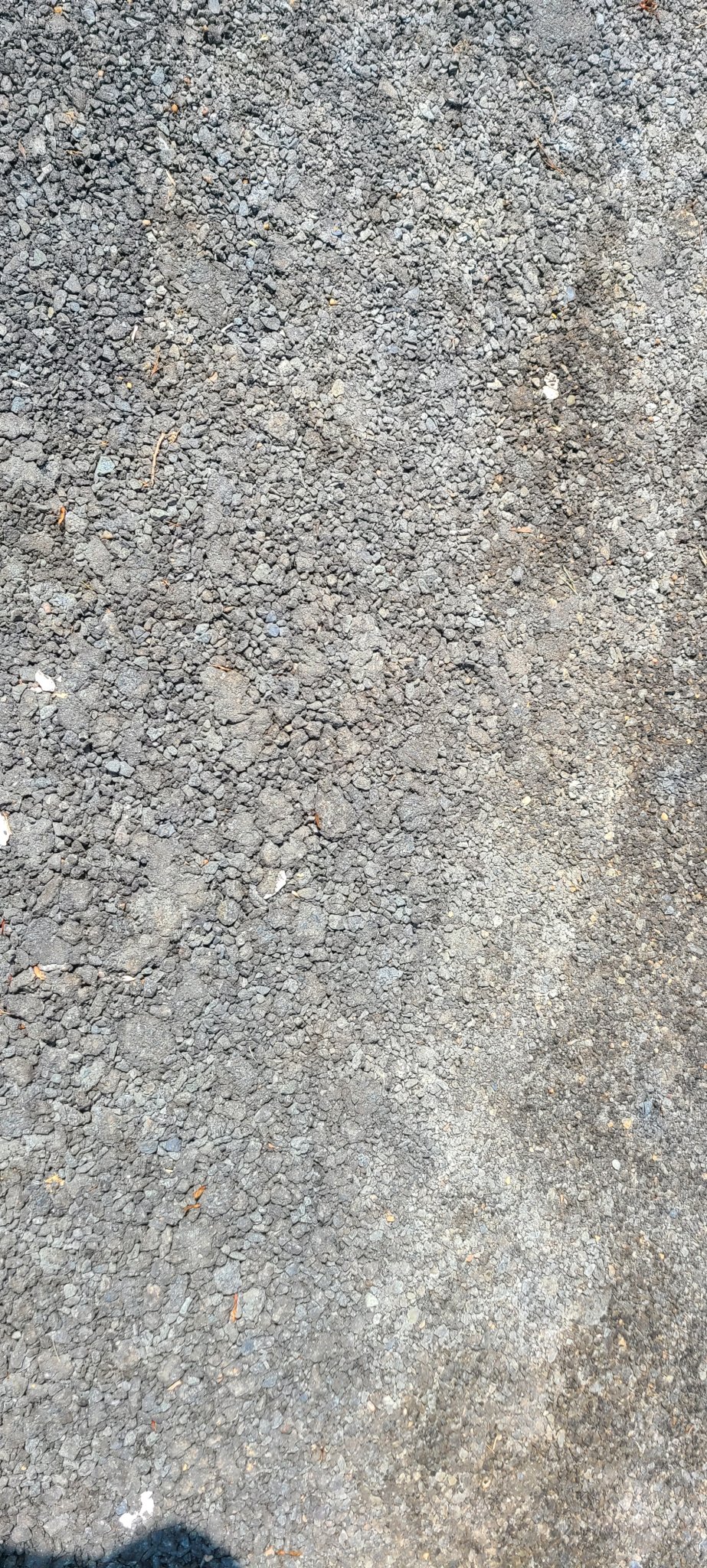

One year later....
Under the RV
Where it's driven on occasionally
No complaints. Holding up great! Great white Northern winters may take a heavier toll on areas not continually compacted. Here in the mid Atlantic, it's just as dense as the day I rolled it.
BX23-S,57 A-C D-14,
13,899
6,329
I must have bought 'low tar' RAP....yours seems to have much more 'binder/tar/gooey black' than than mine.
Also the 'bad' area for me was up against the southern side of the shop, so super HOT, no wind.

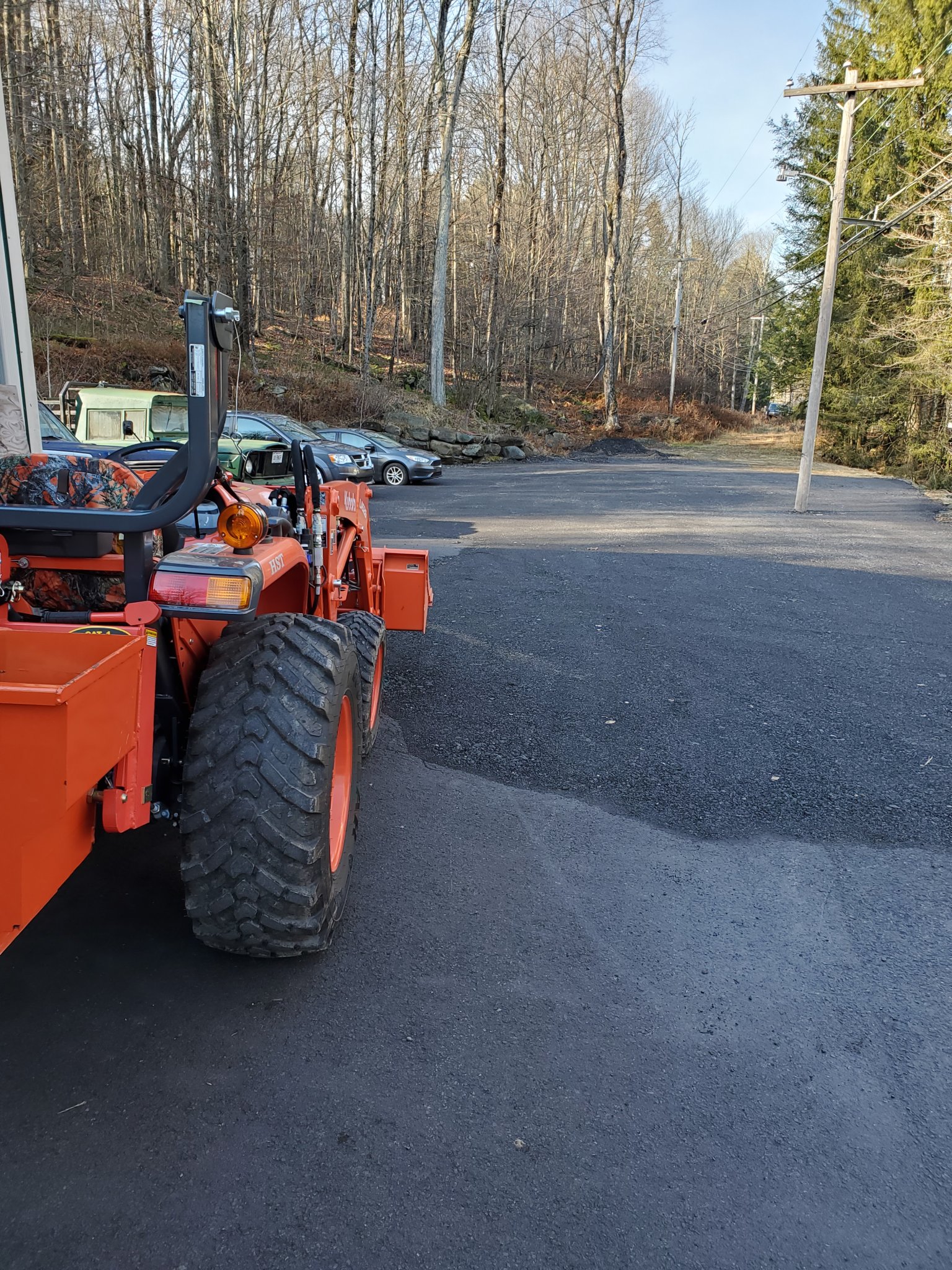

I did my parking lot with "Millings" as they call them in this neck of the woods. Rolled + pack it after spreading them and they are holding up great. The next best thing to Asphalt and Free. The best pat is that it doesn't take on water link modified. No mud holes and nearly no puddling.
