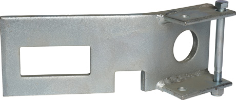

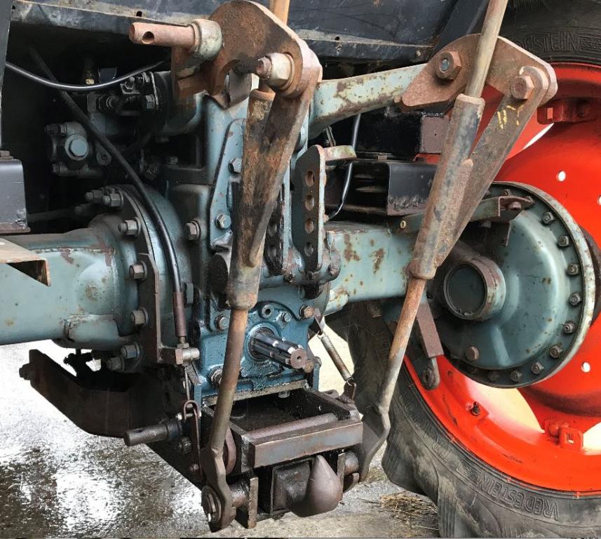

Do you guys never use a pick up hitch? stability of drawbar, convenience of 3 point. Pin type hitch can be replaced by a normal clevis type drawbar
