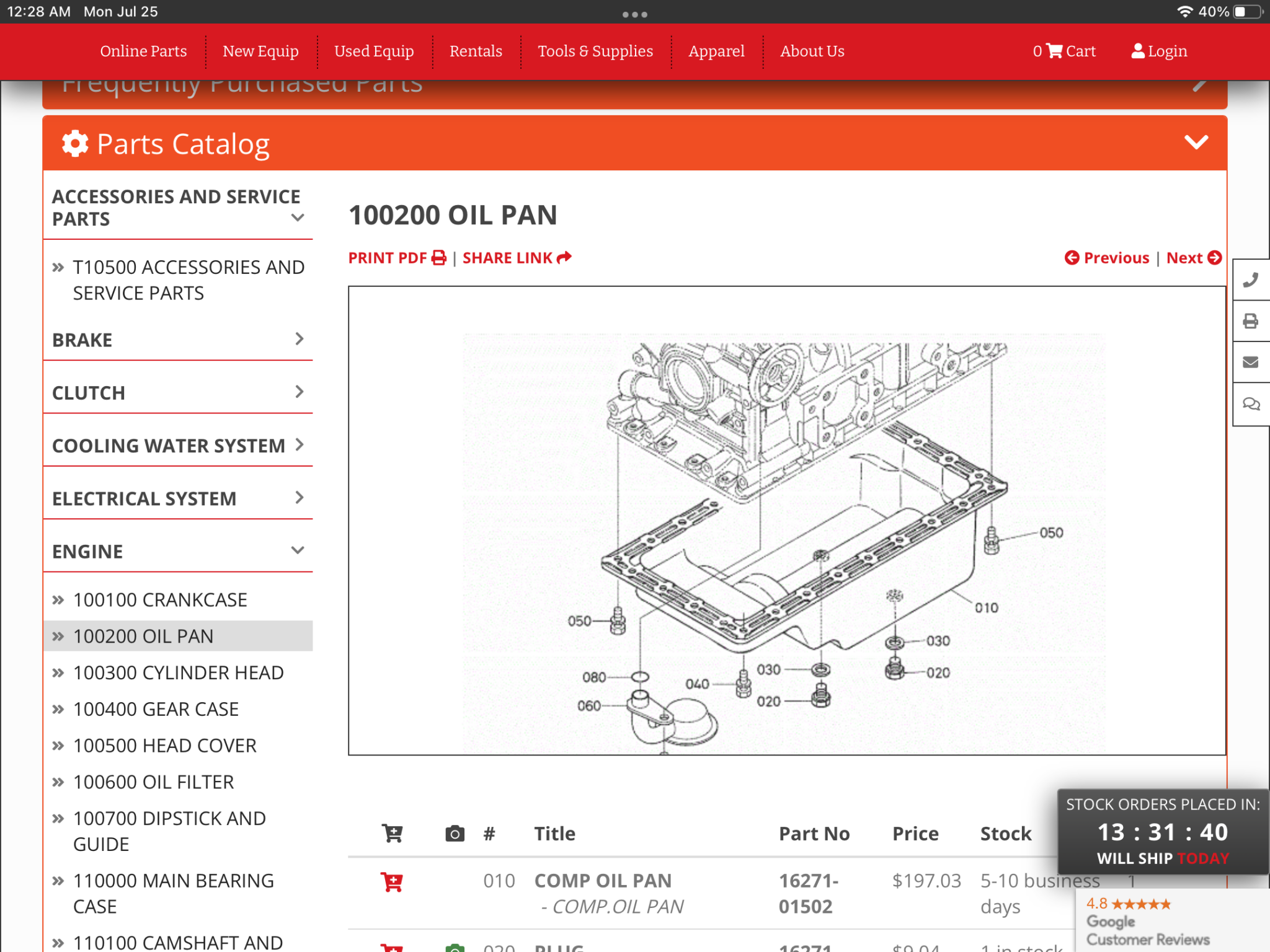

Is it possible to drop the oil pan on a B2920 without splitting the tractor and pulling the engine out?
While I was finishing up an oil change using a fluid extractor, the extractor tube got stuck and broke off when I tugged on it. About a foot of tubing is now somewhere in the oil pan. I removed the dipstick tube, inserted an endoscope, but couldn't see any signs of the piece of tubing.
How likely is it that a piece of plastic tubing laying in the oil pan will cause a problem?

I don't know about taking the pan off, but the tube should come out one way or another. I've dropped lifter shims and had the occasional drain plug magnet come off in assorted vehicles and don't worry about them. They are at the bottom of the pan and the oil pick up has a screen. The tube sounds long enough and light enough to swim around while the engine is running.

Is there any hope of going down the oil fill tube?
If you mean the dipstick tube bore, then no, I couldn't even see the tubing with an endoscope, much less grab it and pull it out. If you're talking about the two big bores on the top of the engine where you pour in new oil, then also no hope there. That leaves the two drain holes on the bottom of the oil pan. No hope there either unless I had some kind of surgical laparoscopic tools that would allow me to see the stuck tubing, cut it into pieces, and pull out the pieces. Like taking out a gallbladder. I haven't tried removing the oil pressure sender, but I doubt there's any hope there either. Thanks anyway.

According to the parts diagram, there is an oil fill plug on the right side of the gear case. It's a slim chance, but might be worth trying.

PoTreeBoy just reminded me of something- taking the dipstick tube off. I don't know about that engine, but a lot of them have a press-fit tube. Then there is some sort of fastener half way up or at the top to keep it from popping off. It is a common place for oil leaks on VW and Ford.
Anyway, maybe take a look and see how and if you can take the dipstick tube off. Might get lucky and have a little nub sticking out.
On a tractor with a split oil pan which requires removal of 2 drain plugs to remove all of the oil? 24FD1B73-D84C-43E3-8295-0B81DC07246B.png

On a tractor with a split oil pan which requires removal of 2 drain plugs to remove all of the oil? View attachment 84161
Yes, on a B2920 you need to remove both drain plugs to do a complete oil drain. Pretty easy to do. A gadget like a oil sucking tool when it won’t do a thorough job of getting all the oil out.

If it were me at this point, I would remove the drain plugs (and oil naturally) and use the endoscope to see if I could see the tubing of concern. If I saw it, I would try (if possible) to fish it out with a wire bent with a hook end. Probably easier said than done.
Who knows, you might get lucky.
If successful I would then return to traditional oil changes…in any case, once the issue is resolved I doubt I would use that oil change method again.
