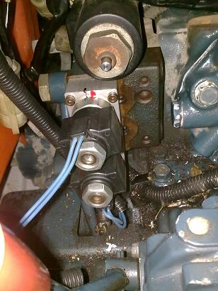

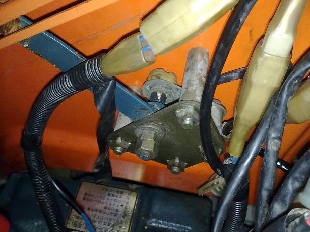

Thanks a lot for interesting. The model is Kubota B1-16DT BULLTRA, on frame I have number starts from B1600DT...., of course I have knob between legs and it's work but only then when engine is stop (I can control speed of drop) but if start engine arms alone goes up. I try to make photos of solenoid valve (controling lift).

I check resistance in first, it' look good (it is range beetwen 0 - 5 kOhm) at two potentiometer. I check all the electric components and they are rather good, but arms dont work. I havent any manual (with this electronic) and I dont know how check electric valves. Have you any idea where can I buy this valves? (they havent any mark or name).

befor you start to replace something, have you checked that the Selonoids (the coils of th hydraulic relay) get power?
