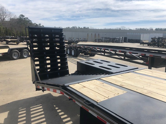

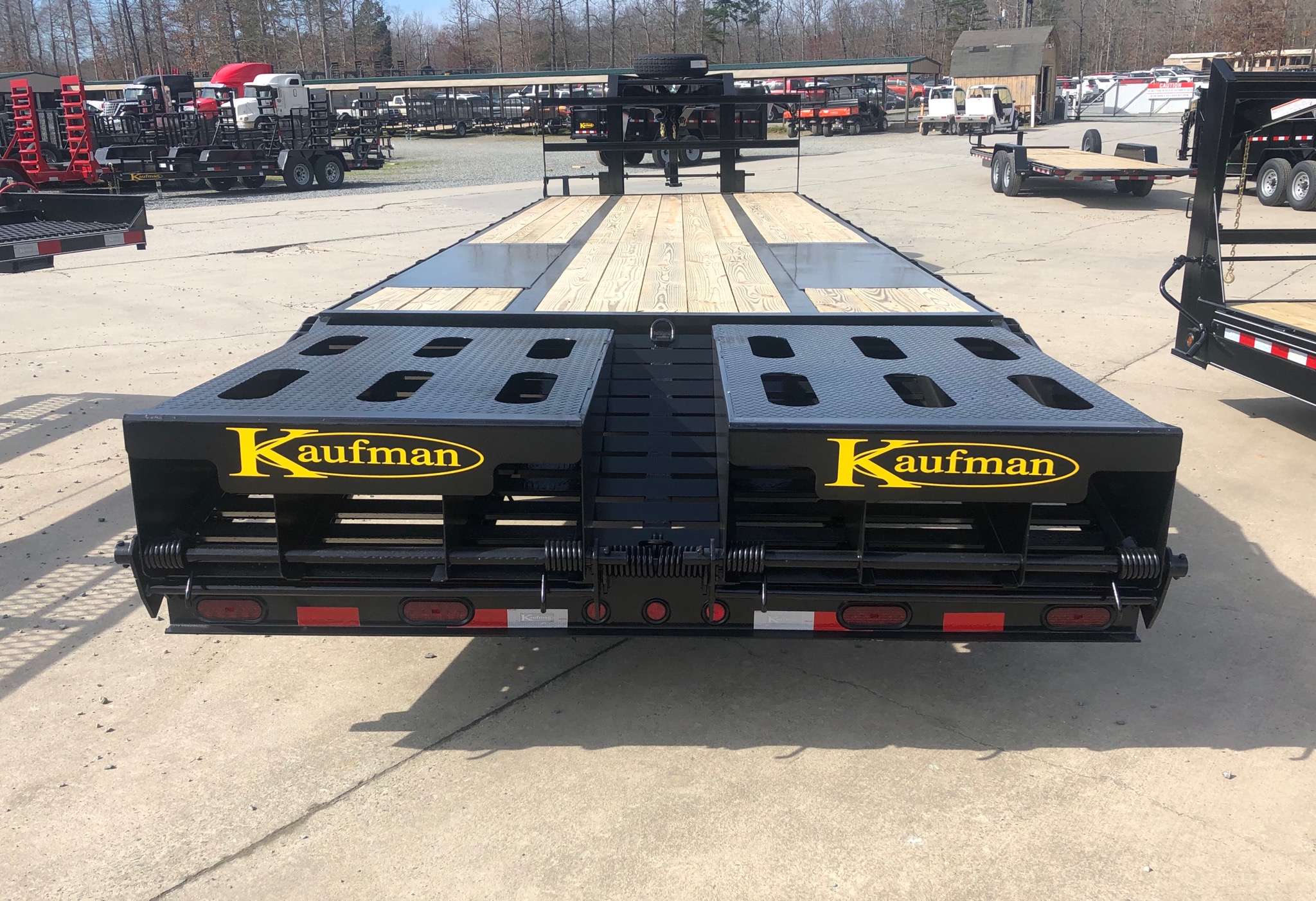

I really like the pierced design of this trailer where the cross members pass through the I-beams (12″ at 16 lb./ft) which is much stronger than the non-pierced design. Also, I hadn't realized that the Mega ramps can be locked in the vertical position in addition to laying flat to provide more room at the back of the trailer if needed. This would be a situation where the load is longer than 25ft and the ramps aren't able to lay flat.

The salesman at Kaufman sent me some photos of a 30ft gooseneck set up the same (or similar) as what I've ordered. Those Mega ramps are awesome!
