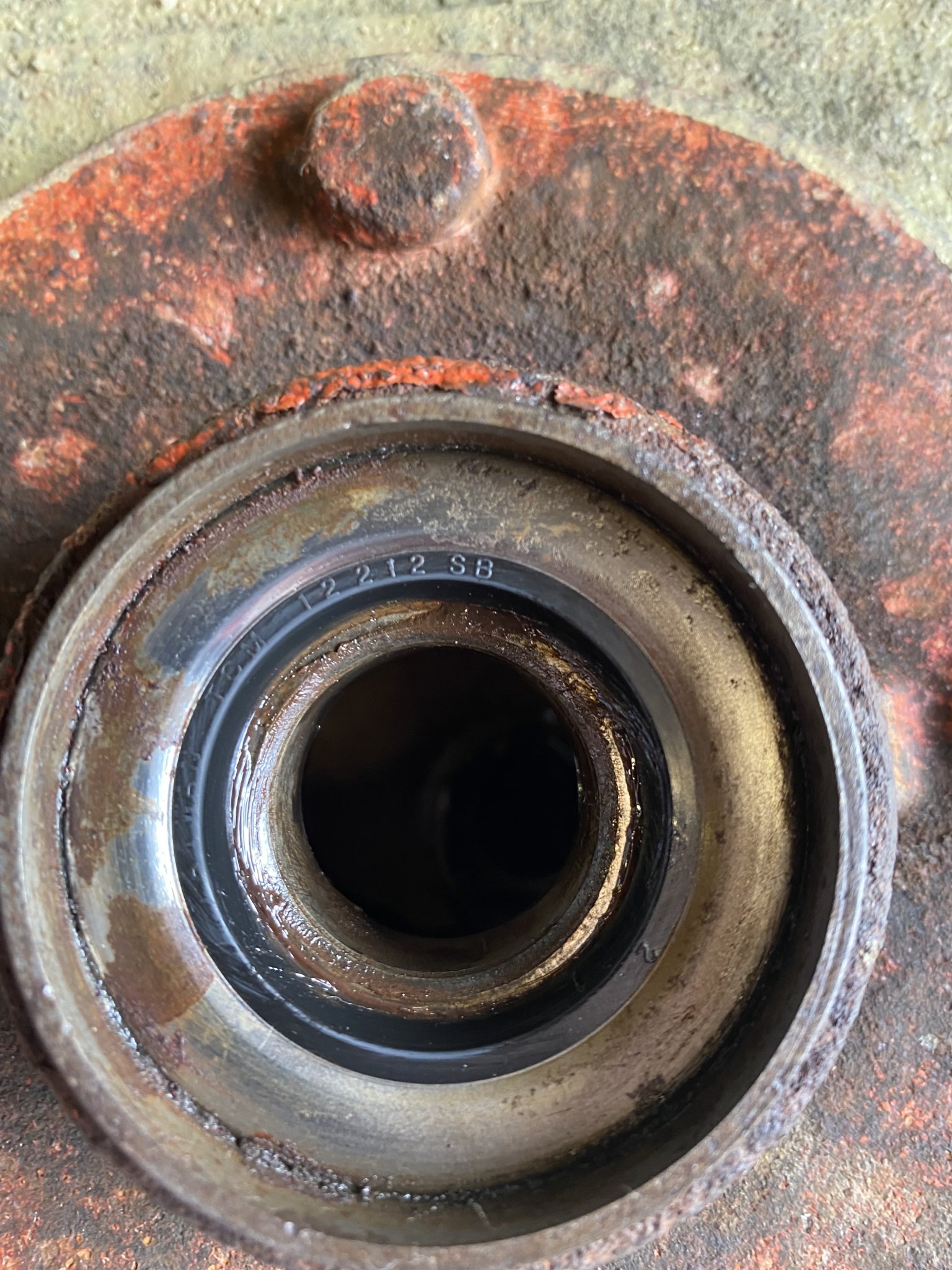

on a lot of the older kubota decks the lower seal was a completely different type of seal. I don't remember the dimensions or numbers but a lot of the lower ones were a grease seal that would deal with higher pressures from greasing the deck. Some also sealed on a spacer or "boss" as Kubota called it which was large dia than the shaft itself.
pull the spindle apart. To get the seals out without damage, sometimes you can knock the bearings out from the inside and it'll push the seal out with it. That assumes there is no snap ring retaining the bearing under the seal.

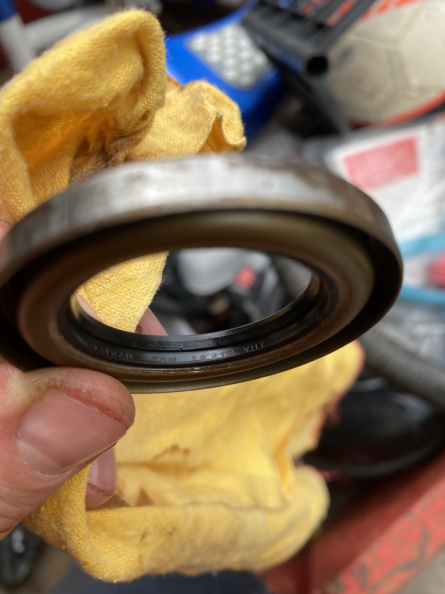

These pics showing the seal numbers might help someone.

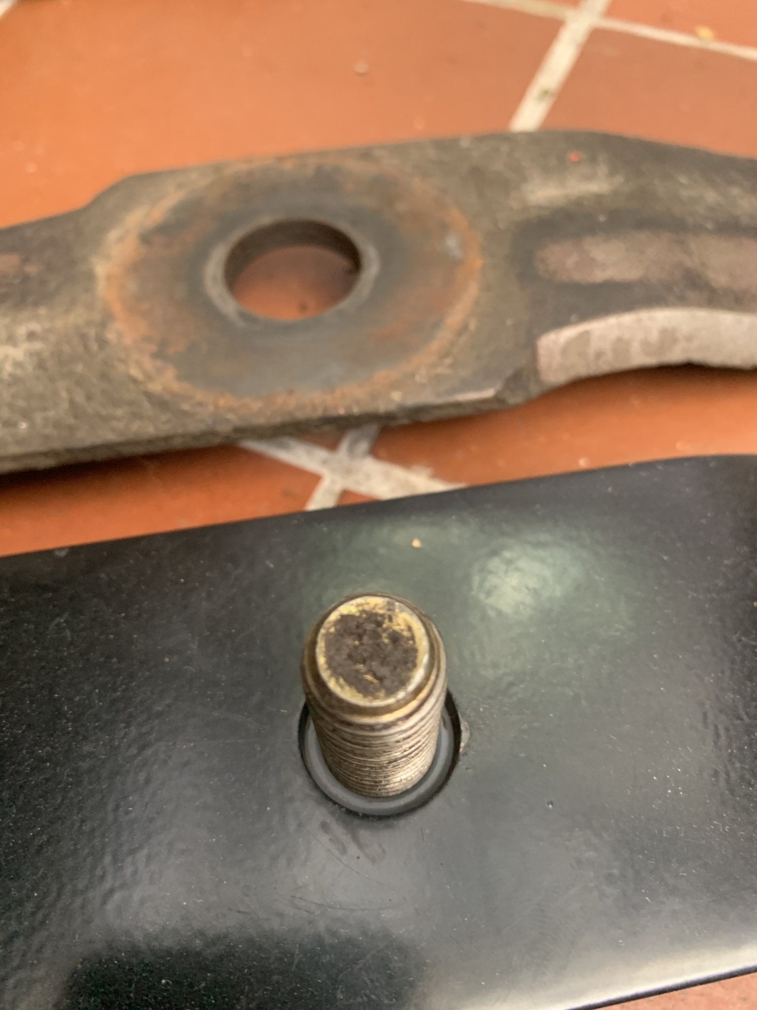

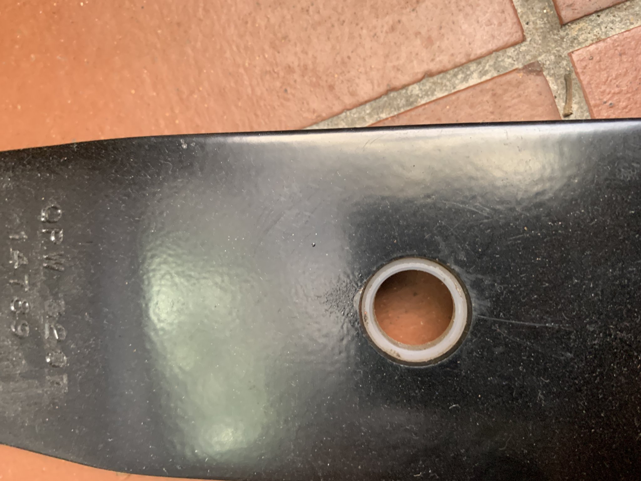

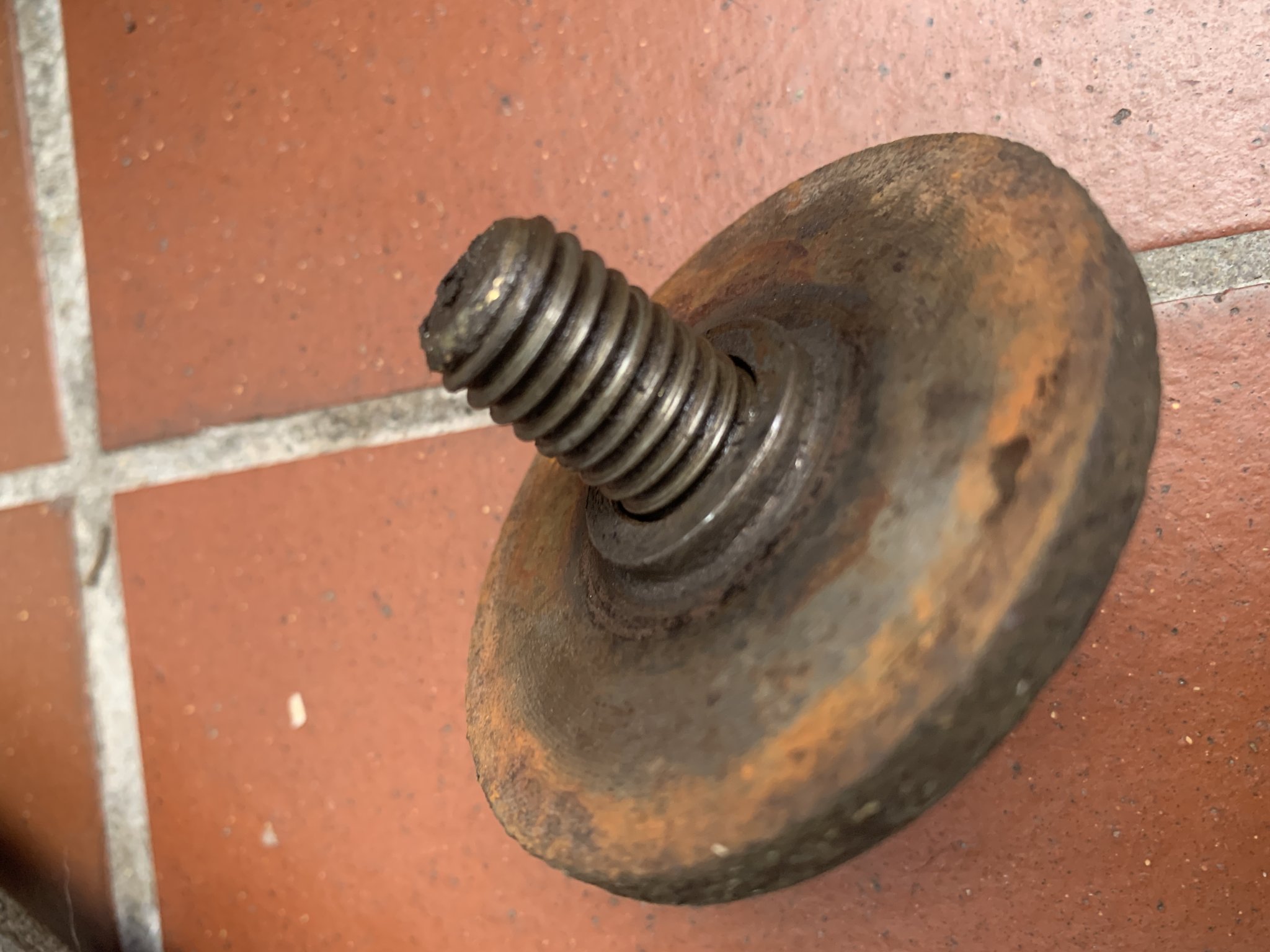

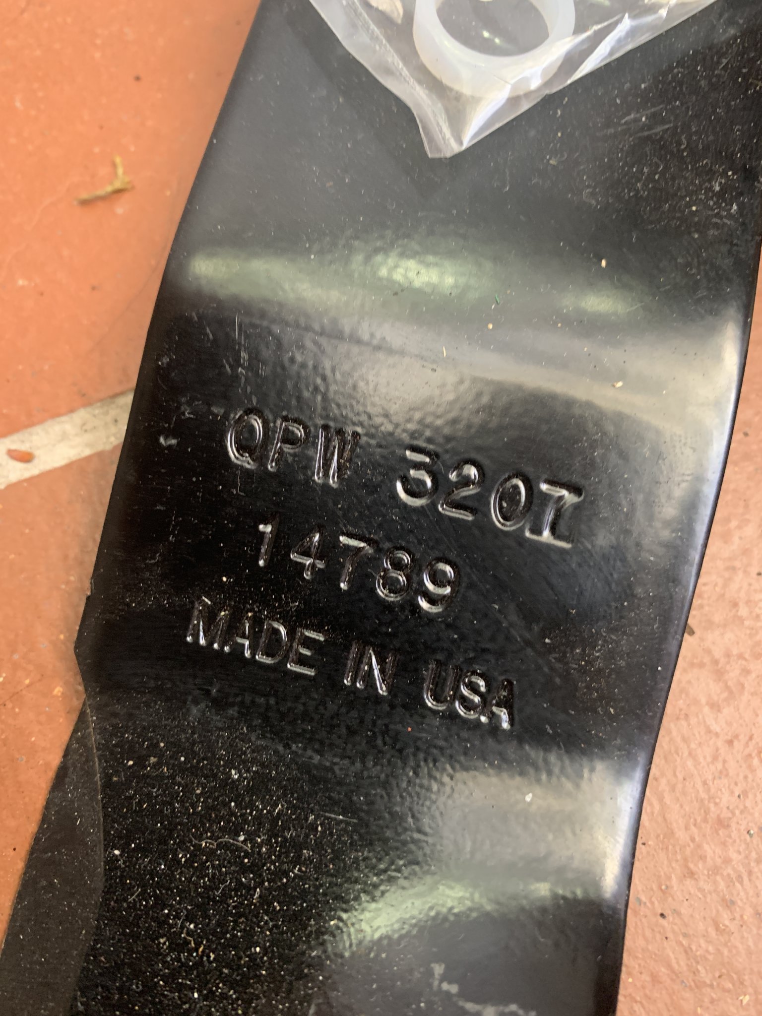

Regarding the blade solutions we discussed (as the blades on this deck seem to no longer be readily available and the hole size appears to be different to most other blades). This deck uses a 'top hat' style washer that locks the blade in place but I gave up trying to find any blades that had what seems to be a 24mm hole so here is my solution in case it is helpful to others...
Hopefully the photos are self explanatory but basically I turned the top hat washer upside down. Bought a new set of blades designed for a 48 inch kubota deck (standard blades not mulching in this instance) with a smaller 18mm hole but also sourced a nylon washer (ebay - see photo) which friction fitted perfectly to the blade bolt and sat perfectly in the blade hole to eliminate any side play. hope that makes sense with the pics.

As discussed and to hopefully help others… original blades 7/8” centre holes.
Rotary 14096 fit.
I think genuine kubota mulch blades K5211-97590 or K5211-92340 should fit too
