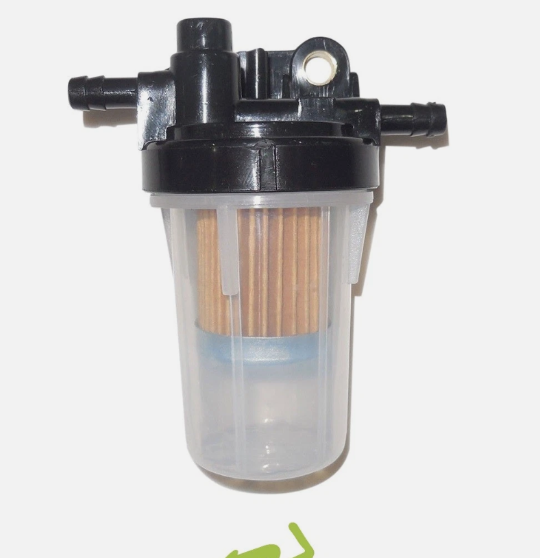

I just serviced my rtv900w. oil, filter, air filters, fuel filters. I also installed a fuel shutoff right before the fuel filter. when I first purchased the rtv in 2005 i replaced the standard fuel filter with (pic). Now when I go down hills, it stalls(sputters). runs fine level or up hill. idles fine. just going down hills.
Any Ideas?
Thanks.
jaxs
B1750HST
Jun 22, 2023
1,116
838
It seems you suspect something you did with fuel system is causing this so we will concentrate on that. That filter looks oversize for this application, you may need to take extra steps to get air out. Have you tried purging air from system after filter was changed? Inlet and outlet are marked on filter, are they reversed? Did installation instructions say which side is up and down? If not, try flipping filter temporarily. Unless filter is downstream from pump, you may have to add a low pressure pump between tank and filter to minimize effect of air bubbles. Speaking of bubbles, have you inspected fuel flow to make certain pump isn't introducing bubbles into fuel where they become trapped in filter? A pinhole on suction side could cause that.

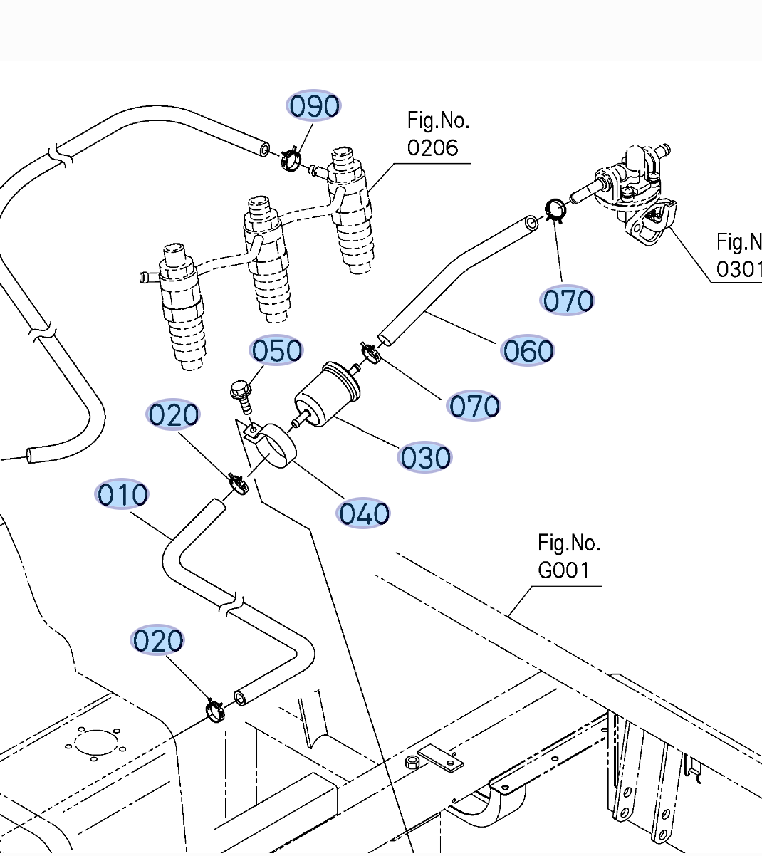

Check the fuel output from your mechanical fuel lift pump; that is probably what is giving you issues.
The fuel filter assembly you added is a kit for RTV900 from Kubota.
ttfo
B7100 HST, RTV 900
Oct 3, 2012
88
Custer, SD
if that was the case, wouldn't effect uphill and level? I backed down the hill and it worked ok. I then put it in neutral and coasted down the hill and it still stalled. or since when I am going down hill the fuel tank is below the filter. Is that is why it is called "lift "pump. I will check it out.

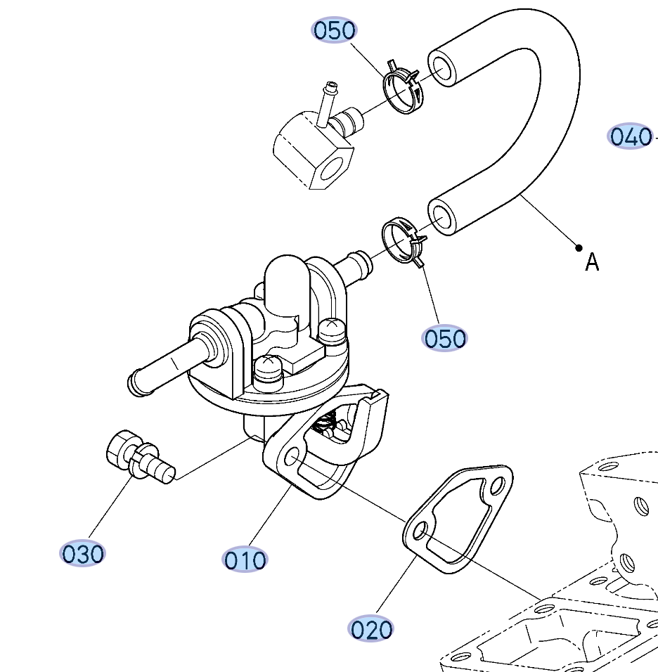

looking at the engine it appears there is no lift pump. It goes from tank, to filter, to fuel pump, to injectors.
Thanks
Bee-Positive
BX1880, Cab, FEL, Tooth Bar, MMM, QH, Ballast Box
Nov 16, 2022
1,255
1,135
Amsterdam, NY

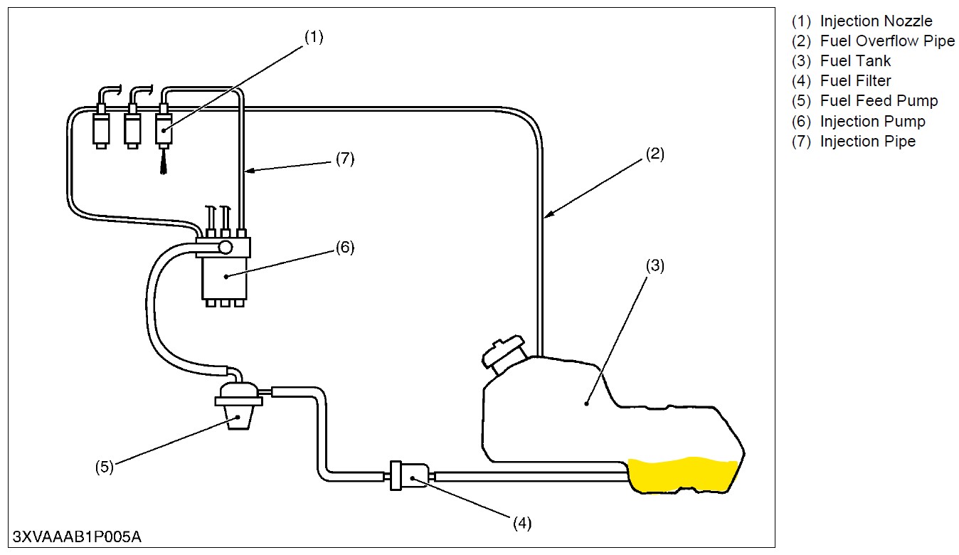

A lift pump (item #5 in the diagram I attached) is a low-pressure high-volume fuel supply pump that transfers fuel from the tank to the injection pump. The injection pump transfers high-pressure fuel to the injector nozzles which is atomized for combustion. Any fuel not used by the injectors (based on RPM) is returned to the fuel tank.
whitetiger
Nov 20, 2011
3,811
2,216
Kansas City, KS
The fuel comes from the tank, through the filter, to the mechanical fuel lift pump, to the injection pump, and then to the injectors.
If you look between the filter and the injection pump, you will see it.
ttfo
B7100 HST, RTV 900
Oct 3, 2012
88
Custer, SD
It is difficult to take a pic, but here is the diagrams from kubota. just the fuel pump
