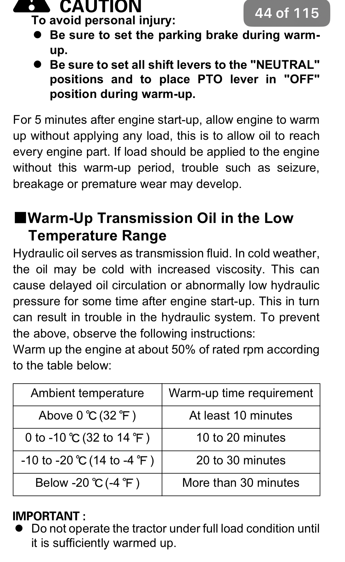

I left it at LOW idle for about 7-8 minutes before trying. Are you suggesting it should have been at high idle?
Somewhere I’ve seen recommended warm up times depending on temperature.
You might want to consult your Operators Manual.
At 12 degrees, I don’t think 7-8 minutes is adequate. Low idle is probably fine initially. Again, check your manual.
I would warm up my little BX longer than 8 minutes at 12 degrees and it probably has half the fluid capacity of your L.

How long did you let the thing warm up at high idle before moving?
This is a good question. I'm not able to get one of the rear remotes in "float" until the hydraulic oil is sufficiently warm.
After letting the tractor warm up for as long as necessary at 1,200rpm to 1,400 rpm, I raise and lower the loader a few times and do the same with the 3-point to get warmer oil circulating through the system. I do this before I try to move the tractor.
Low idle is not going to generate enough heat. It also is not good for cylinder walls.
I run my machine at 1100- 1200 for at least 15 minutes before I drive to my work area. In the case I'm moving snow (as recently) I'll go 20 min. I also have a sheet of Coroplast covering 1/2 the radiator/ trans cooler.

I've blocked off 50% of the rad 'screen' to help get engine temp up ( same trick truckers use....)
Agree need higher RPMs and longer before 'going to work'.
Very true, I agree. I like to start at low idle for a couple/few minutes, then up the throttle for a while to warm up when it’s real cold.
My tractor is stored in an attached garage. Gets cold out there, but typically stays above 32 degrees or so.
Don’t try to move it or operate hydraulics until it’s warmed up.
Coldest I’ve blown snow is -8 degrees F and it ran quite a while before I tried to do anything.
