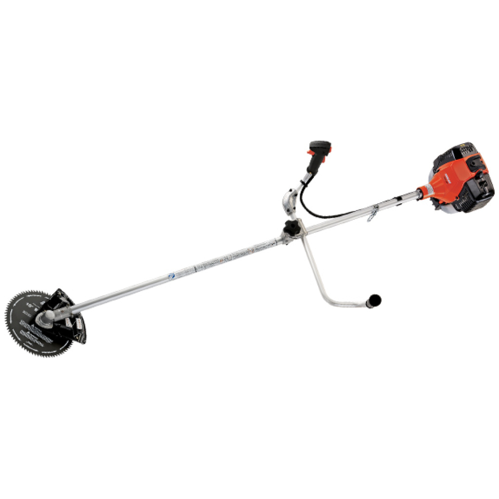

I've been running a dedicated Brush Cutter on my property for the last 10 years and it is easily some of the best money ever spent. IF you have a real need for a brush cutter...then get just that (not a string trimmer with a blade attached).
I went with the Echo SRM-410U. It is shaft driven (not a spring cable like trimmers use). I have used mine HARD for hundreds of hours and it has held up beautifully.
Small saplings 1"-2" I can just rev it up and tap them...and it slices right through them. For larger saplings (up to 4"-5") I will hook the blade around the backside and slowly pull it towards me (blades runs CCW).
You'll learn quickly not to engage anything from the side opposite of rotation, as kick back will make it clear to you.
You will want a cutter with 'bike handles'......nothing else.

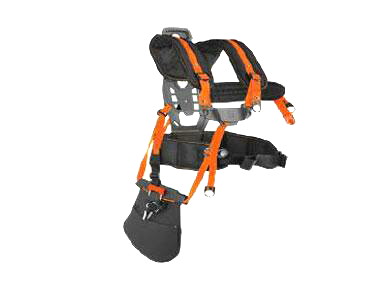

Another thing (MANDATORY) is a good harness. I use the Husqvarna version, but others are good as well. Do NOT cheap out here. If you don't use a good, comfortable, rugged harness.....you'll be putting that brush cutter down in the first few minutes. I can cut brush for about 90 minutes before taking a rest and believe me.... that's a lot of brush.

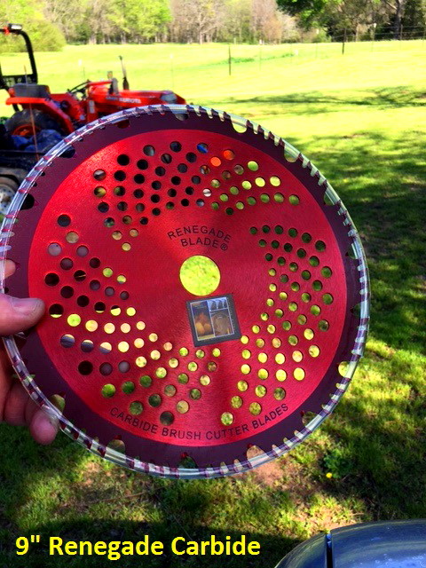

There are various types of blades available. Some with chainsaw blades (good for quickly cutting larger stuff, BUT needs frequent sharpening). My recommendation is a carbide tipped blade. They last quite awhile and don't dull quickly when you hit dirt.

Thank you very much.
This definitely gives me something to think about.
I think you make a valid point about "Shaft Vs. Cable" driven. I had not really considered that.
I also agree that a good harness is a "must have" .

I have Carbide tipped chains for my Echo Polesaw and a small CS-303T chainsaw. I'll use the carbide on the Polesaw when I know I'll be in dirty wood or cutting greenbrier, etc....
The 303T wears a carbide chain always.... as I use it to flush cut small stumps right even with the ground. Carbide doesn't really care if you hit some dirt. Lasts a LONG time. Doesn't cut quite as quick as normal chain...but fast enough.

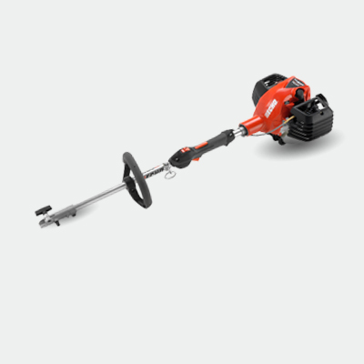

I have an Echo PAS system that I really like.
There is no looseness at the joint at all.
You MUST have the harness and the handle bar to use it as a brush cutter or you won’t be happy
you can buy a separate attachment and leave it set for brushcutter so you don’t spend time switching back and forth. I have to trim along a woven wire fence so go back and forth often.
There are also cases to keep the blades in to protect them and you from damage.
