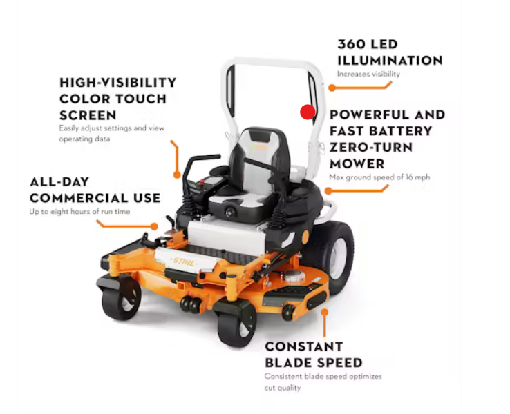

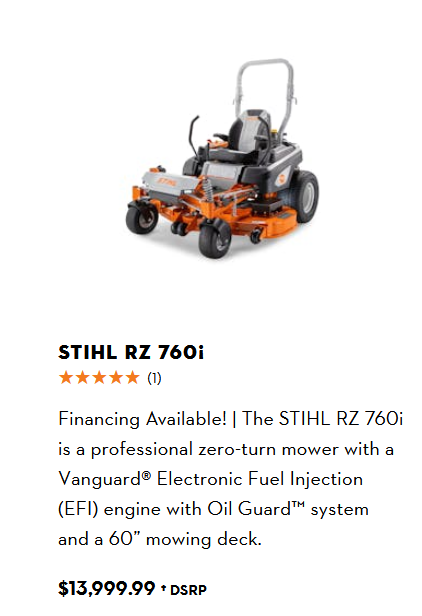

So I need a new zero turn lawn mower. Stopped my my local Stihl dealer and had a heart attack!
Which one would you choose?
26hp Kawasaki gas engine - $14,000
or the Same model but battery vs. gas
Stihl RZA 760 - $30,400
I guess the battery tractors are going to be more the 2X the price as well.

31 acres. How long does that take? How many times would the battery mower have to be charged? At how long per charge (overnight)?
Sounds like nearly a part time job mowing 31 acres with any kind of a finish mower. Maybe a couple mowers gets it done in a day? Or one mower on glass smooth turf with no obstructions running wide open for a day?
The EPA says a gallon of gas has about 34 kW-hrs of energy. Assume the gas mower burns about a gallon an hour and the entire 31 acres takes 8 hours to mow, that’s about 270 kW-hrs. Presuming an electric motor is twice as efficient as a gas engine, than you’d need about a 135 kW-hr battery to mow the whole 31 acres. The Stihl RZA-760 mower’s battery is rated at 24 kW-hr.
I think the electric mower just turned a one long day job into about 2 or 3 days of 4 to 6 sessions of mowing with 3 to 5 charge period wait times of about 8 hours each (120 volt charger). I think folks really would not like that expensive battery mower when it wears out before they do and they aren’t even a third of the way done.
Stihl claims it will run 8 hours and mow 21 acres. How? That’s 3 kW-hr/hr. Even if the electric motor was three times more efficient that a gas engine, that’s equivalent to a gas mower burning 1/4 gallon per hour, all the whole mowing 2.6 acres an hour. Not going to happen. Stihl suggests you’d get 2/3 done with you mowing. I think you’d be lucky to get a 1/4 of the way done prior to needing an 8 hour charge.
Buy the electric one if money is no object and taking two plus days with several breaks to do a formally one day job isn’t a concern. And you don’t like the people that have to do the mowing.

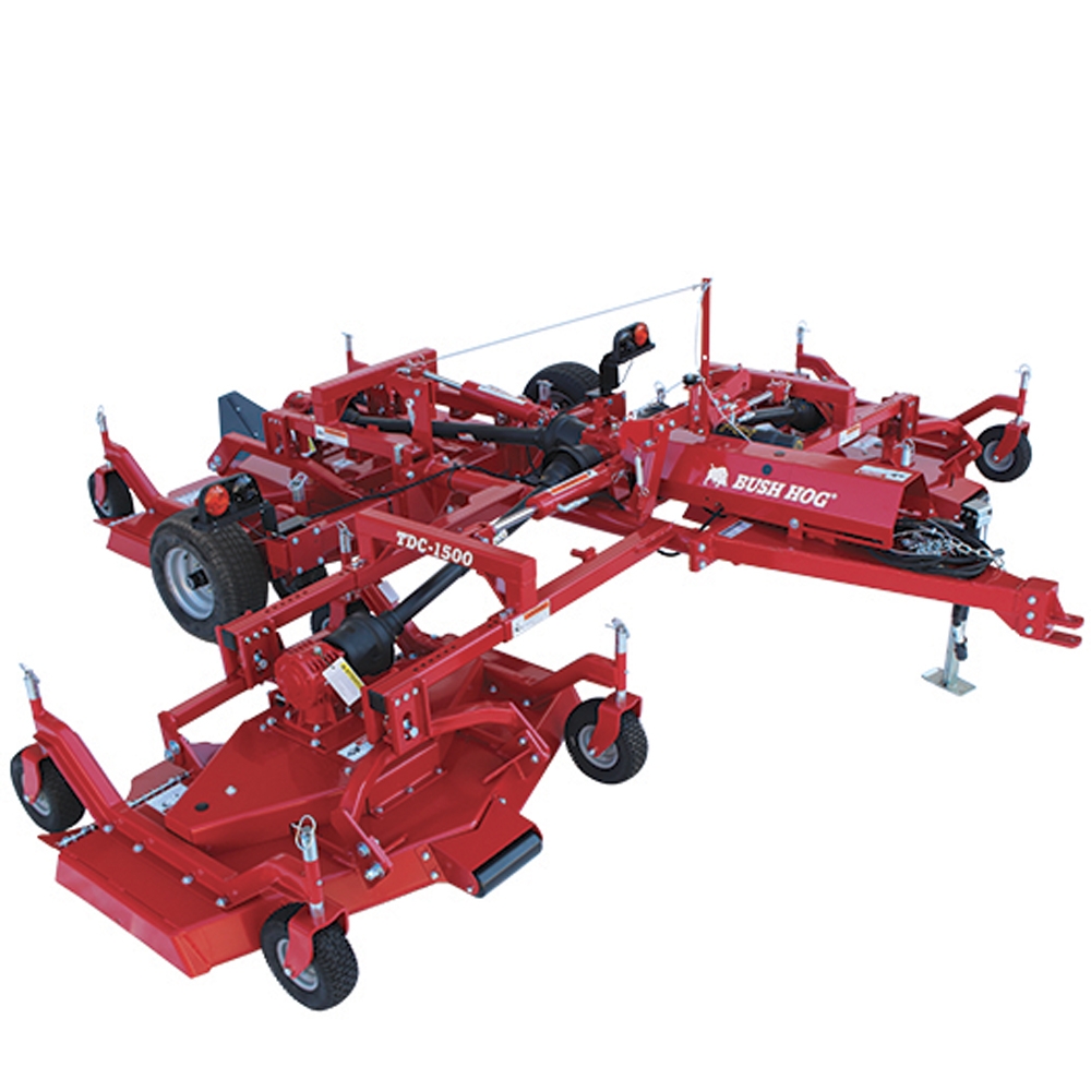

With 31 acres...... LX with and mid mower and a 3pt gang setup in the back.
That!
I only mow 3-1/2 acres and it takes a bit over an hour with a 7-1/2' RFM. 31 acres approaches a full work week at my speed. Don't believe the ZT acolytes when they claim they can do 31 acres in 6 hours:)
