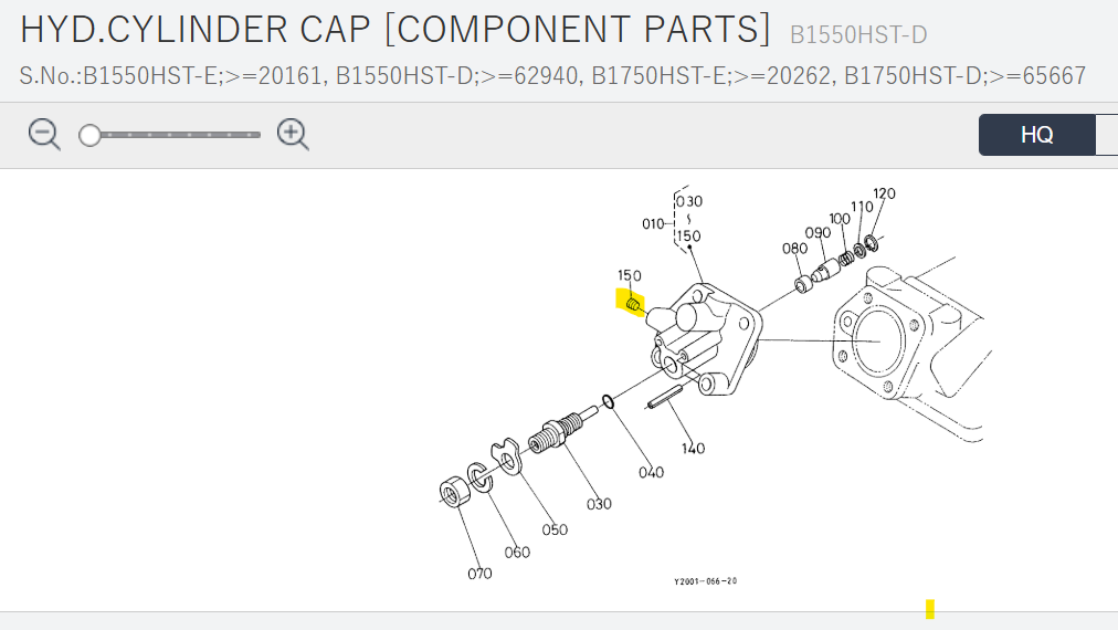

where are the pressure relief valves on a kabota b 1500
dleath2003
kabota b1550
Jun 16, 2020
12
Newfane NY
i took the pressure reading off the lever for the bucket. 3 point hitch and mower deck are on the same lever, and move very slow when warm
