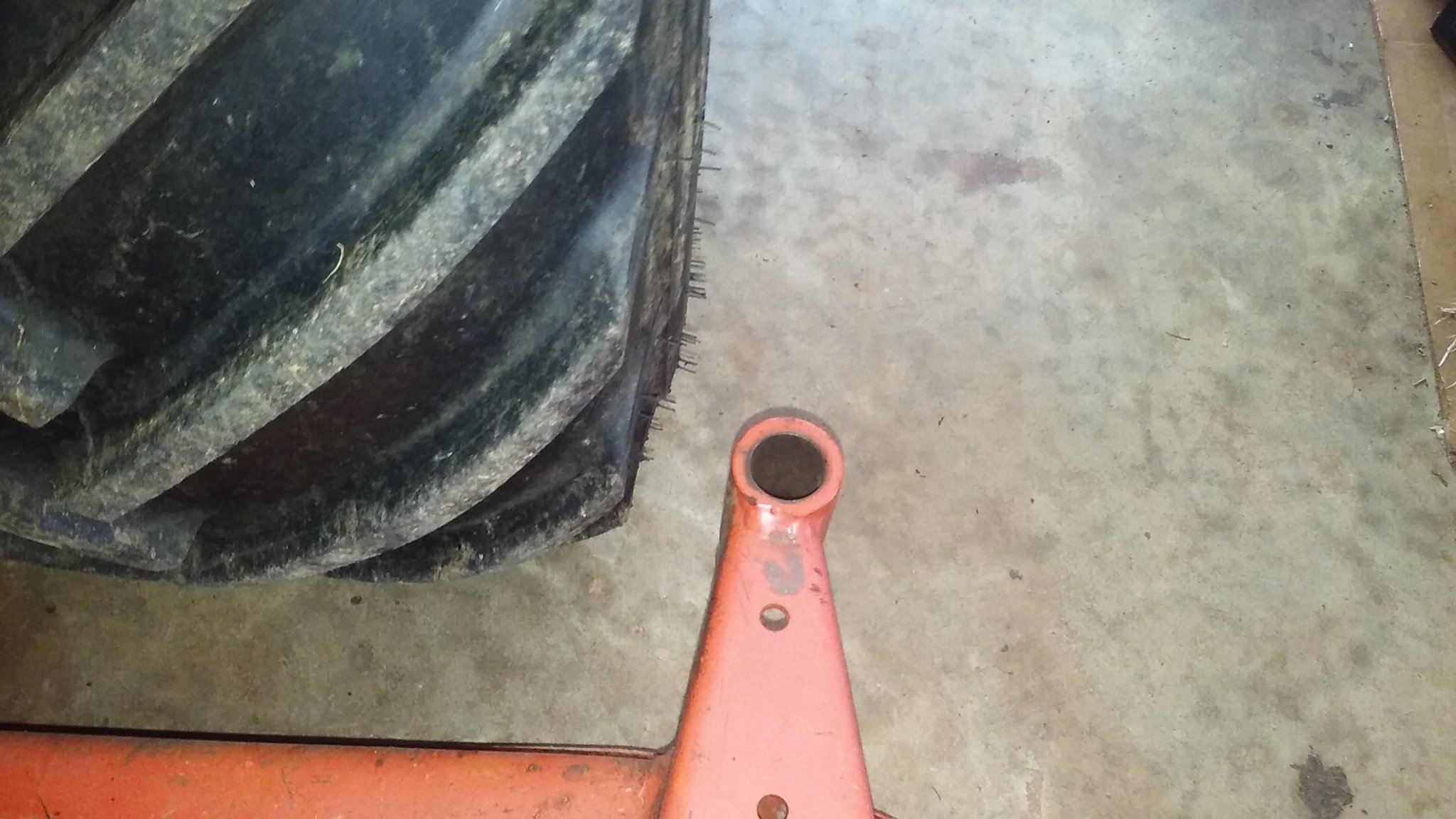

My explanations are not very good. So, here's what I mean by clearance. It is not between the tread of the wheel and the mower deck or front of the tire clearance...as in straight ahead of the tread to the mower. I'll call that position 0 degrees. It is the side clearance. The side of the tire will hit the spot where the wheel of the mower inserts...I'll call that 90 degrees.
If I could get the mower either pulled ahead or pulled more to the left, spacers were work easily. Here's a picture of the current clearance at the left tire (I think I said right earlier but it doesn't matter at this moment.)
Makes perfect sense !
ON some B7100's there was a problem with the wheel spinning around and hitting the tire - thus they had a place to allow it not to spin - rather it could only move forward and backwards.
Have you cut grass yet with your MMM?

Ok - and that is what I thought..... now the crazy part........
cut that holder off! Yes - I know it is there for anti-scalp but if you are satisfied without the wheel on it - remove the holder - it can always be welded back on later if need be.
If that was the case - I would get 2" spacers!!! I swear to you the difference is instant !
85Hokie, you're a genius! I never thought of cutting those off. I would really love the spacers, especially if I knew I could mow out by the road where the slope is troubling! I'm going to give this some thought.
Now...I don't have a grinder or a sawzall. I'll have to look to see how thick that metal is.
Thanks for the tip!
