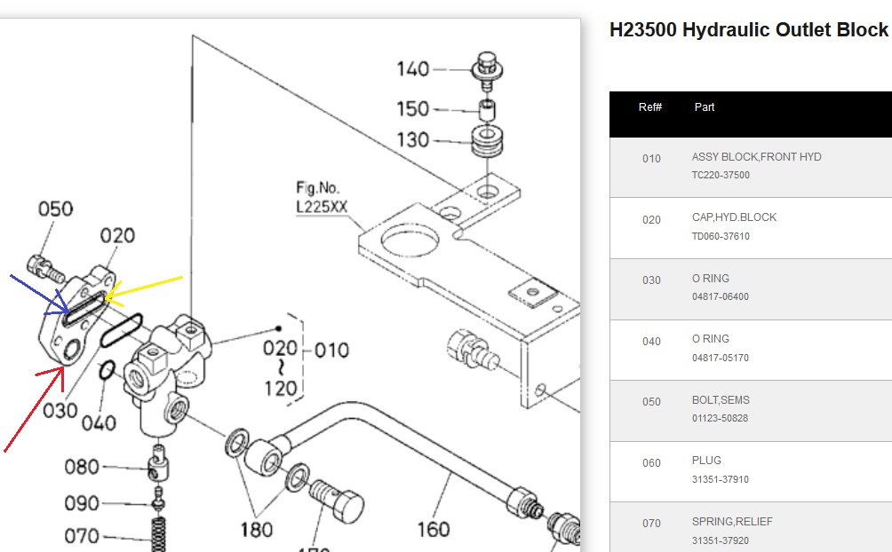

Yes, it's not bad... main thing is that your tractor bypasses the "outlet block"... It's just a "cover plate" (first diagram #020)... just a channel to pass the hydraulic fluid from the High Pressure out side (Blue line) to the high pressure return side (called "Power Beyond", Yellow line) which feeds hydraulic power to the 3 point hitch. The Red line points to the Low pressure "Return to Tank" line...

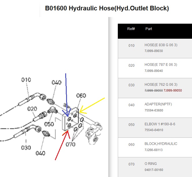

Second diagram; shows the new outlet block #060 where you can tap hose to connect your new spool/valve to...
You might check with a salesman at a Kubota dealer to see if there is a "Kit" for connecting up hydraulics. Kit should supply these parts (I don't know if they do have a kit, I just know that it's usually expensive buying each part; screws, "O" rings although you should be able to reuse the same screws.... You need to the outside parts but you could source them Surplus Center / Summit Hydraulics.

You need the OEM adapter plate for the hydraulic block (60 in the diagram) and the three orings (70). The rest is all standard hydraulic fittings and hose.
You also need a comtrol valve with power beyond port for your rear outlets. Connect valve to adapter plate per description in owners manual.
