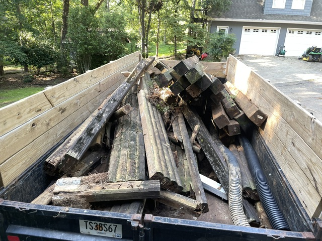

Doing some yard cleanup before a few retaining walls are built. No action shots, unfortunately.

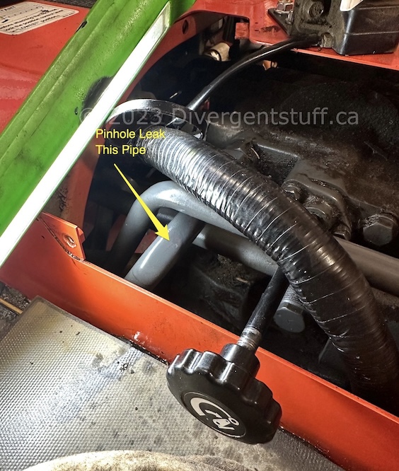

It started raining hydraulic oil from under my cab yesterday. Main hydraulic feed line from the pump failed with a hairline crack in the hardline at the bend located under the seat. Wish me luck trying to replace the line without removing the cab...

Is there a floor pan under the seat you can remove if needed ?
There's a small access panel for abnormally small child labourers to fit into, the rigid pipe runs under the floor to the pump at the motor. At least I can see most of the pipe run after pulling off the shields on the outside of the machine. Can't get my hands in the space available between the loader backhoe frame and cab...can look but not touch!

Do you have access to grind and weld the crack?

So much work for such a small item! Good luck with it

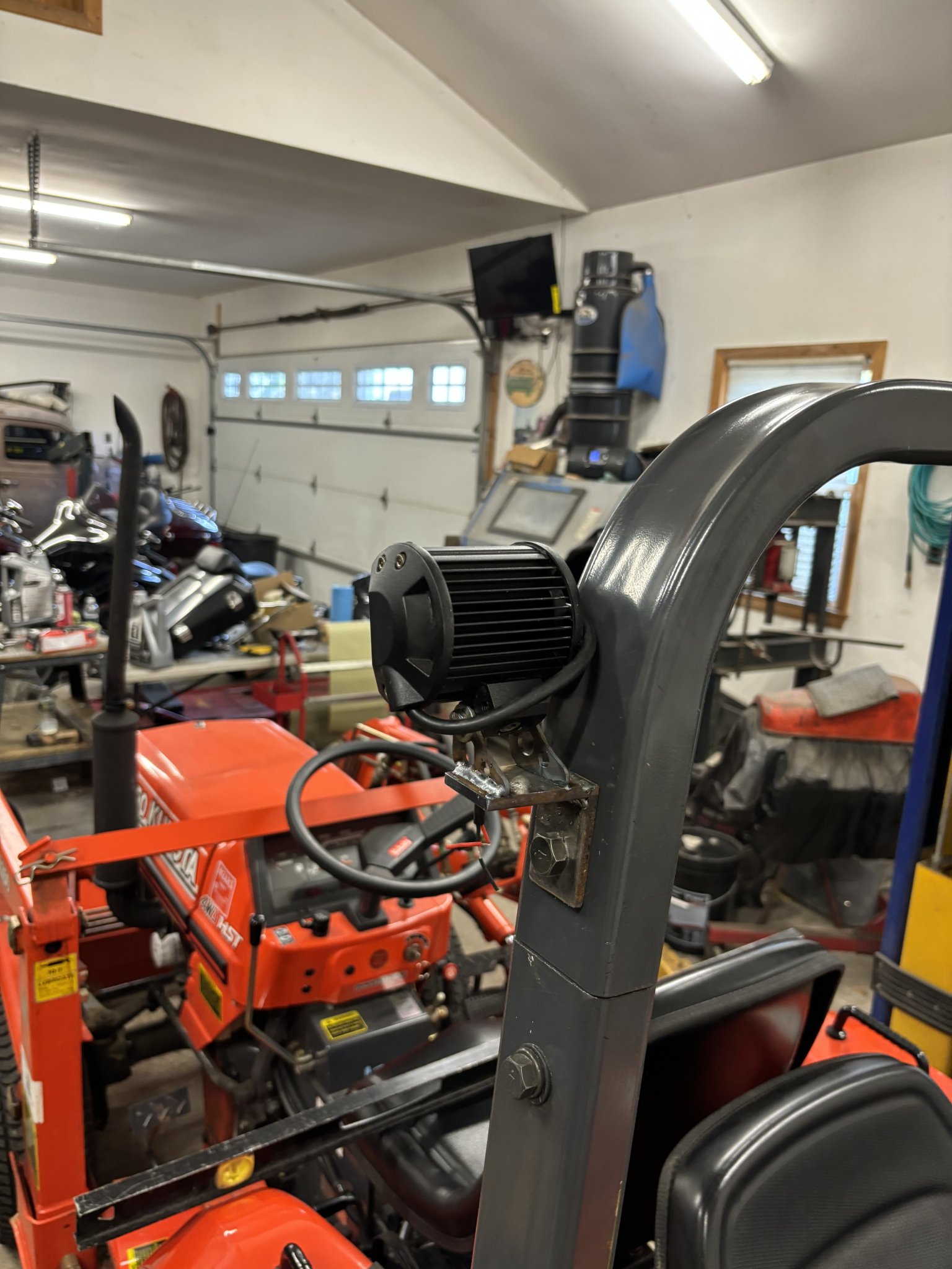

Made some brackets for ROP lights for snow removal today.
I could try and TIG weld in place. I think it would be better to bite the bullet and replace the primary high pressure line. It looks like it's failing on the weld seam. Like a bad zipper it's starting to unzip itself in the middle of the bend.

I'd replace the pipe. Welding thin stuff sucks, and if one area of the pipe is thin another area is likely thin. Sure, it could be just that one pin-hole, but you have to pull the line to weld it anyway because heating steel to 2,220°F with a layer of hydraulic oil inside it is (from personal experience) probably not the wisest thing to attempt. ;)
P.S. If you do choose to weld it in place, get it on video. 😂
