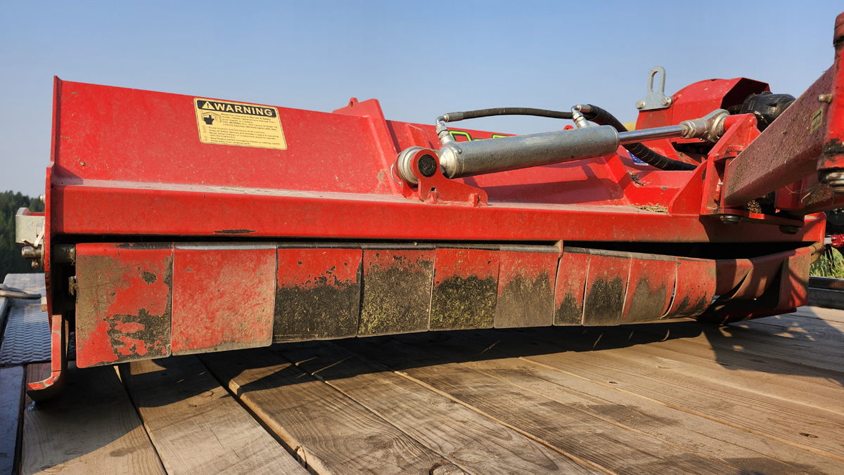

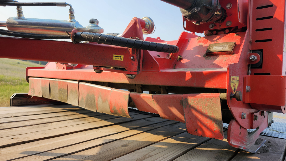

I'd consider using an angle iron with the flat side up against the flat metal above the existing flaps. Use a clip angle to attach to the ends that protrude out a bit. Then you could could bolt to the angle heavy flaps, like mud flaps used on trucks to the length needed.
The guards need to swing so I'm not quite following the "bolt to the angle heavy flaps". I was thinking of using some 1/2" schedule 40 pipe, cutting sections to match the width of each flap, welding the flap and pipe together and sliding each one over the 5/8" rod that I have. The rod would be attached in a similar way to the current rod but it'd be located above the opening so that it couldn't get hit by anything.

Here's a sketch to try to show what I was thinking. The angle just holds the mud flaps in place with a couple of bolts as needed for each rubber flap. The angle iron can be attached to the mower with a clip angle at each end. The mount for the flaps is then up out of the way and the flaps can be as long and as heavy as you choose.

I can see why Del Morino designed the guard the way they did. They're balancing cost with reasonable use and it's not their fault that an operator can drive over a log that's laying in the grass. The flaps have to swing in both directions through 180° or so and it would take a double hinged flap to achieve that with the bar sitting above the exit chute. But I'm up for a challenge and a double hinged flap is not hard to make. The rubber guard idea is ok but I'd rather keep the current design concept with metal flaps but upgrade it to be more robust.

So here's the damage to the guard support rail. The Del Morino has been and continues to be an amazing implement, but that guard arrangement could be better. If you go over something large and solid, like a 16" firewood log for example, the hammers aren't able to chew it up quick enough and they'll eject a large piece out the front which hits the guard support.
I plan on making a new rod and brackets such that the support is above the exit chute. I'll make up my own heavier flaps too. The cutting head rotates so I might make the rail as two pieces either side of the pivot. We'll see.

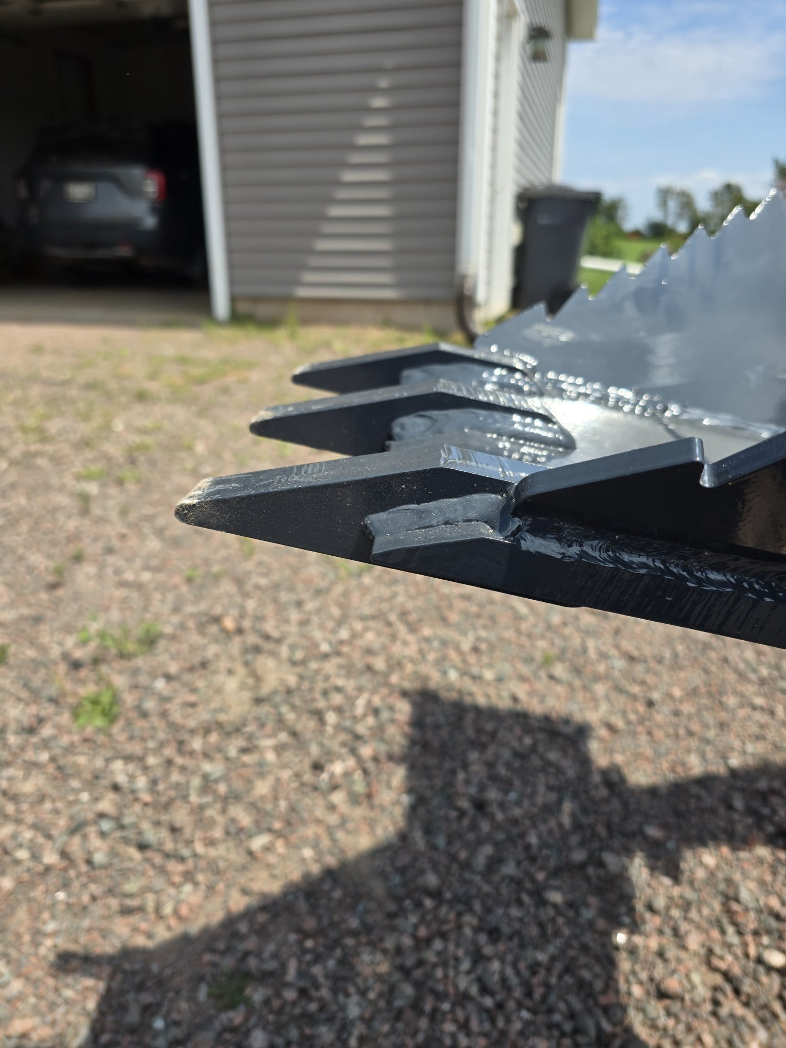

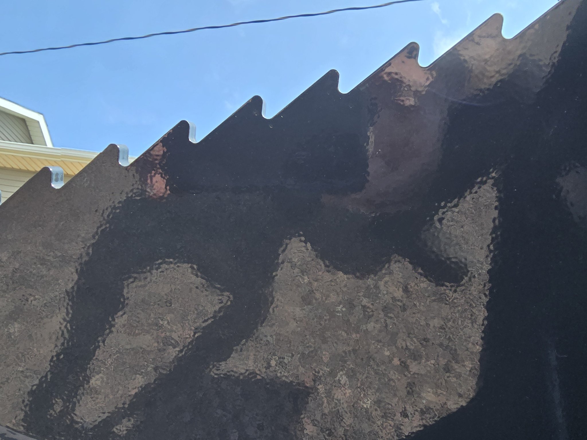

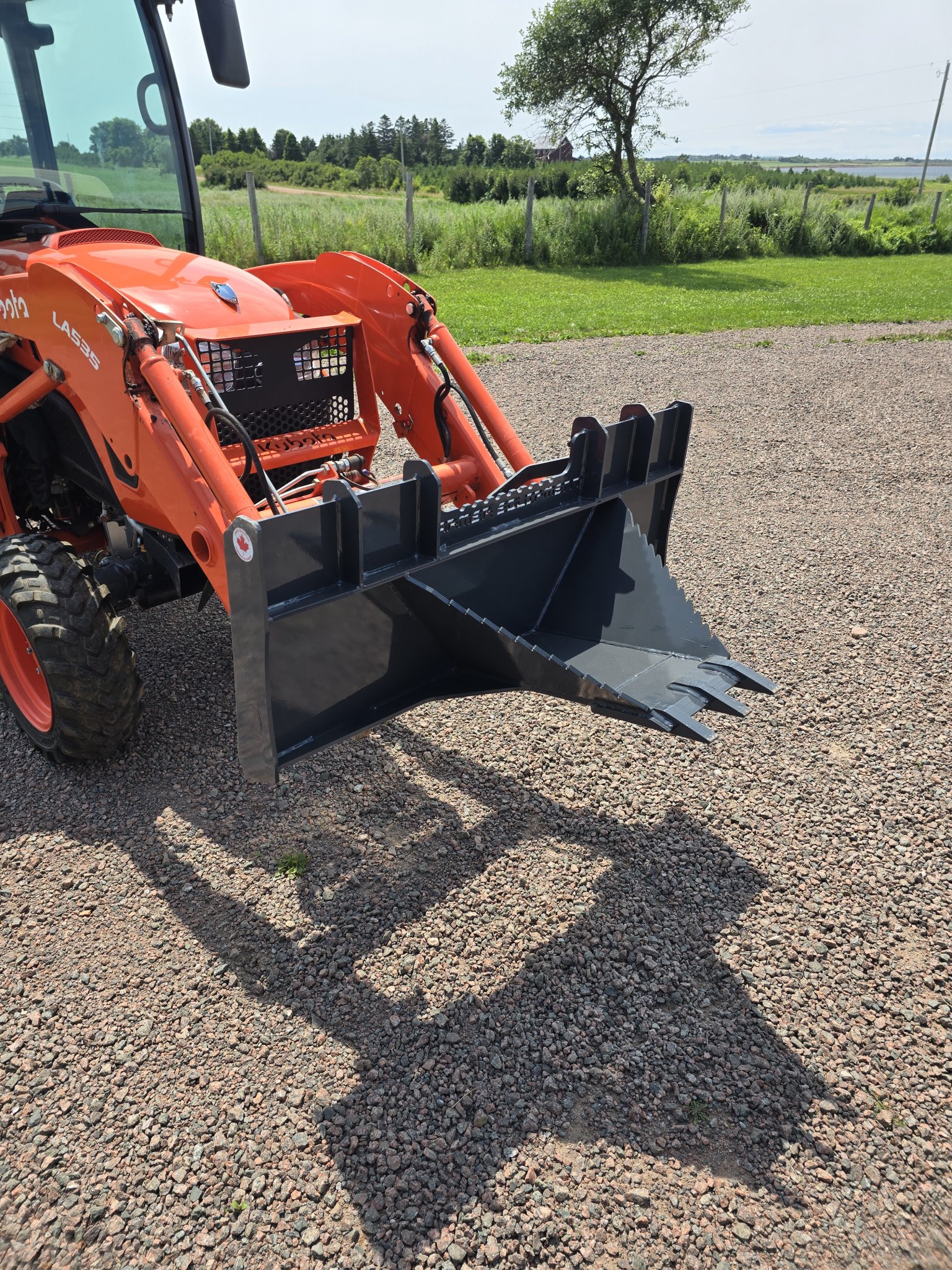

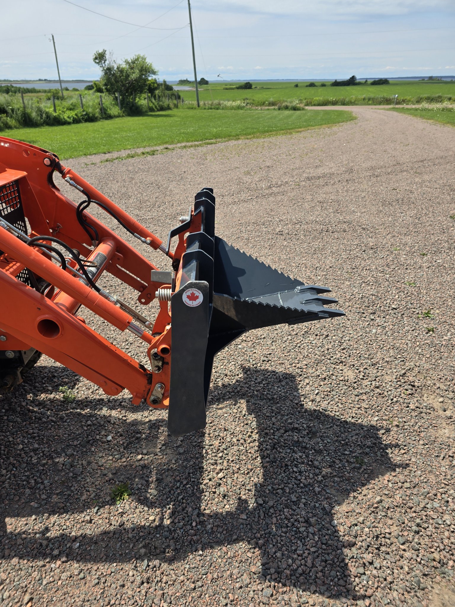

Picked up a small stump bucket from Farmer Equipment in Ontario, Canada. Looks like a well built piece.
  • FARMER EQUIPMENT EXCLUSIVE
  • rip through roots and remove stumps with serrated edges
  • dig out boulders
  • dig trenches
  • transplant trees and shrubs
  • Fits all Compact Tractors equipped with Skid Steer style Universal Quick Attach (SSQA)
  • Recommended for tractors up to 40 hp
  • Fabricated from 5/16" steel plate
  • 5/8" hardened front cutting edge
  • 3 teeth made from AR400 steel
  • Weighs 160 lbs
  • powder coat paint
  • MADE IN CANADA

Nice looking implement and it does appear to be well made, but a lot of stuff made in Canada is. I thought you were planting trees rather than digging them up. 😂
Both😉 I have around 40-45 trees around 5' tall that were on the former side of our property prior to purchasing the adjoining lot that we want to move. (Right behind the tractor in the pic below) I'm going to put them across the back property line since I opened it up last spring when I cut the deadwood out and need to go back for round 2. They should give us a decent view block. Once the spruce are moved we'll plant some larger hardwoods or fruit trees.
There are also some stumps to dig out on the property line and one on the edge of the new driveway so I'm looking forward to trying out a new implement.
