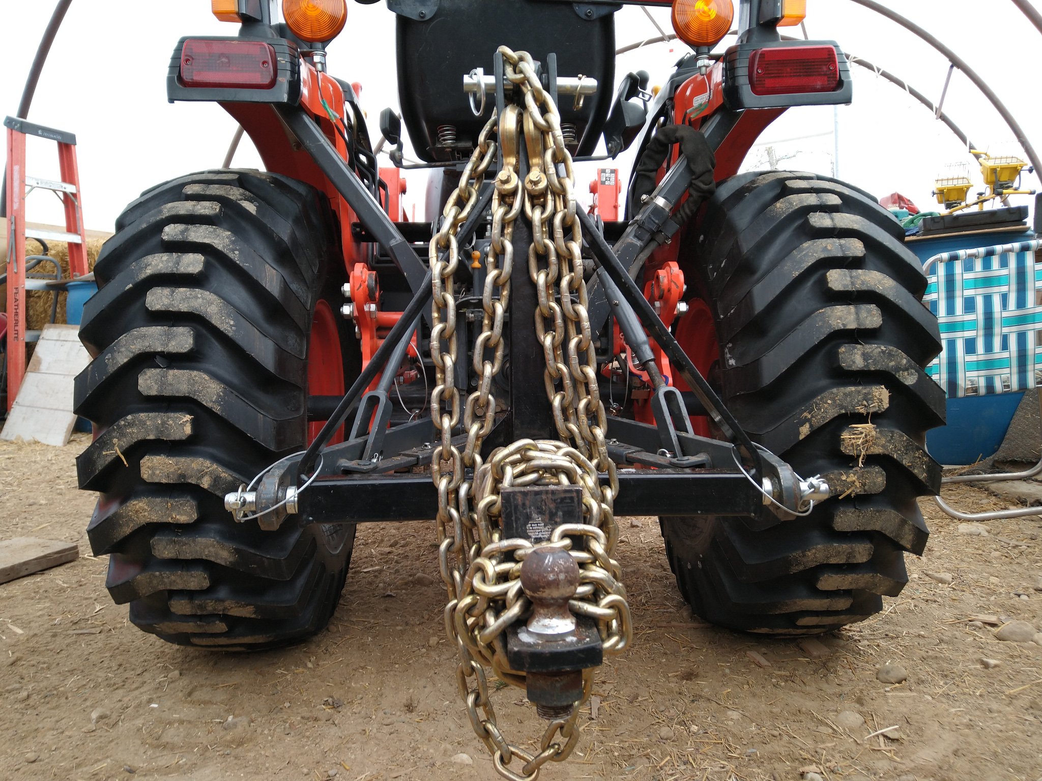

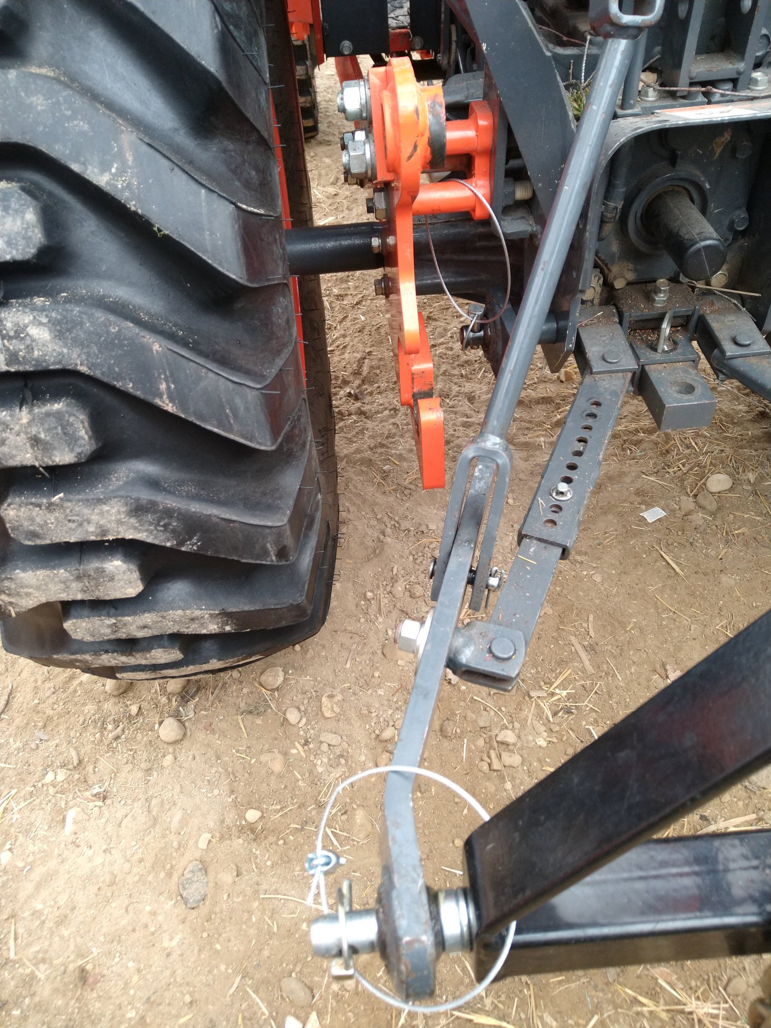

Bush ate another linch pin yesterday. I guess brush pushes the linch ring away and the pin pops out on the lower 3 point arm ends especially.
I can't believe I just went through a 15 piece assorted pin set already since December! Nowadays I'm checking them every few hours in the bush, and had to birrow a replacement from my box scraper yesterday.
I checked all the pins and clips again before heading out to cut firewood today, and it's gone again!
So just finished putting together a fix, hopefully. Used up an old aircraft cable kit I had sitting in the garage for years. I think I just ordered my last clip variety pack. They're all going to get this treatment now, on all my equipment LOL.

Can you rotate the implement pins so those holes are vertical that the lynch pins are in?

The 3-point lower lift arms pivot shaft pin holes at the tractor are vertical, the other end pins on the trailer hitch receiver has one nearly horizontal, and one about 45 degrees. I could try vertically aligning those two with spacer washers, but it doesn't seem to matter which way the pin holes face or what direction the pins are used, sticks find a way to pry them loose and off. And gone. It's not hard if you think about it. I can just push my finger tips up and against the pin ring and it pops into my hand.
It's plenty disconcerting to find a lower 3-point hitch arm without its pin after just working it quite heavily! What would happen if I caught a stump with my box blade while pulling in low gear under power and the lower arm came off at the tractor I would rather leave to the imagination, thank you. But can start with dangerous, and expensive, to have happen.
So that STILL leaves me with how to keep the pin clip rings from getting pried loose by wild shrubberies and bushes in the first place! It can be seen if you zoom in a bit that the new aircraft cable loops at the tractor pins are holding the pins up at the top end of their play, which may actually be an inadvertent "feature" of the wire's springiness that keeps the pin lifted and the lock loop up way more out of harm's way. And if something pushes up on it the ring is already tight to the pivot shaft. No dangling spring to get caught so easy? We'll see! At least they're not getting lost anymore.

They make heavy duty Lynch pins that are very hard to open. ...and if they snap back on your finger - you'll never forget that feeling :mad:🤬‼

If it's a repeating problem, replace the pin with a bolt. It will take a little longer to change attachments, but the brush won't steal your pins.

I lost a few of those over the years. I went to a quick hitch and have not had a problem since. The implements that needed pins still, I just welded the bushings on so there is no longer any pin needed.

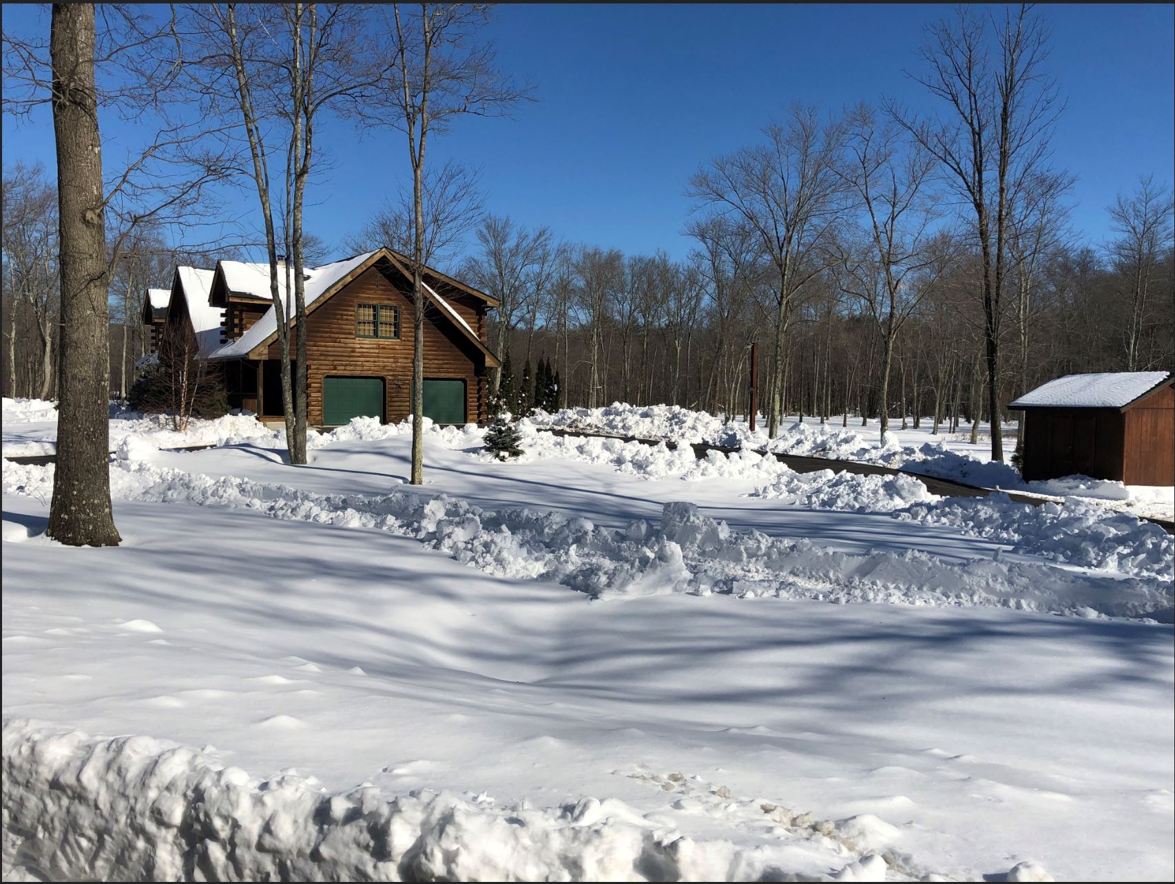

what a difference a day (or two) makes... wound up with about 20" here and the melt has already started. I had to plow some "yard" for the pup to make it thru to his "business area". Poor pup still has a bum foot and couldn't make it over the fresh snow piles to do his thing.
Bring on Spring!

I like those pins you have on your stabilizers. Beats the heck outta the ones that came with the tractor. Got a part number and vendor info?
