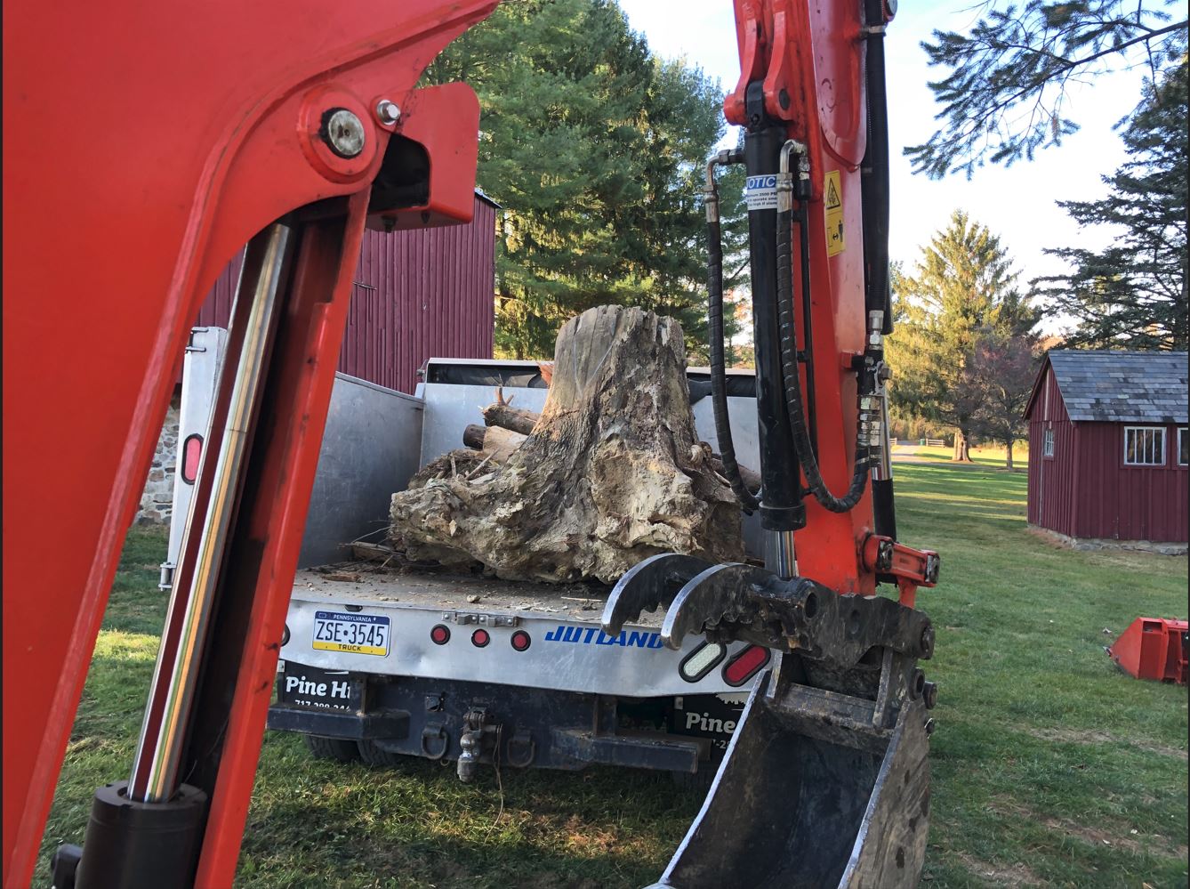

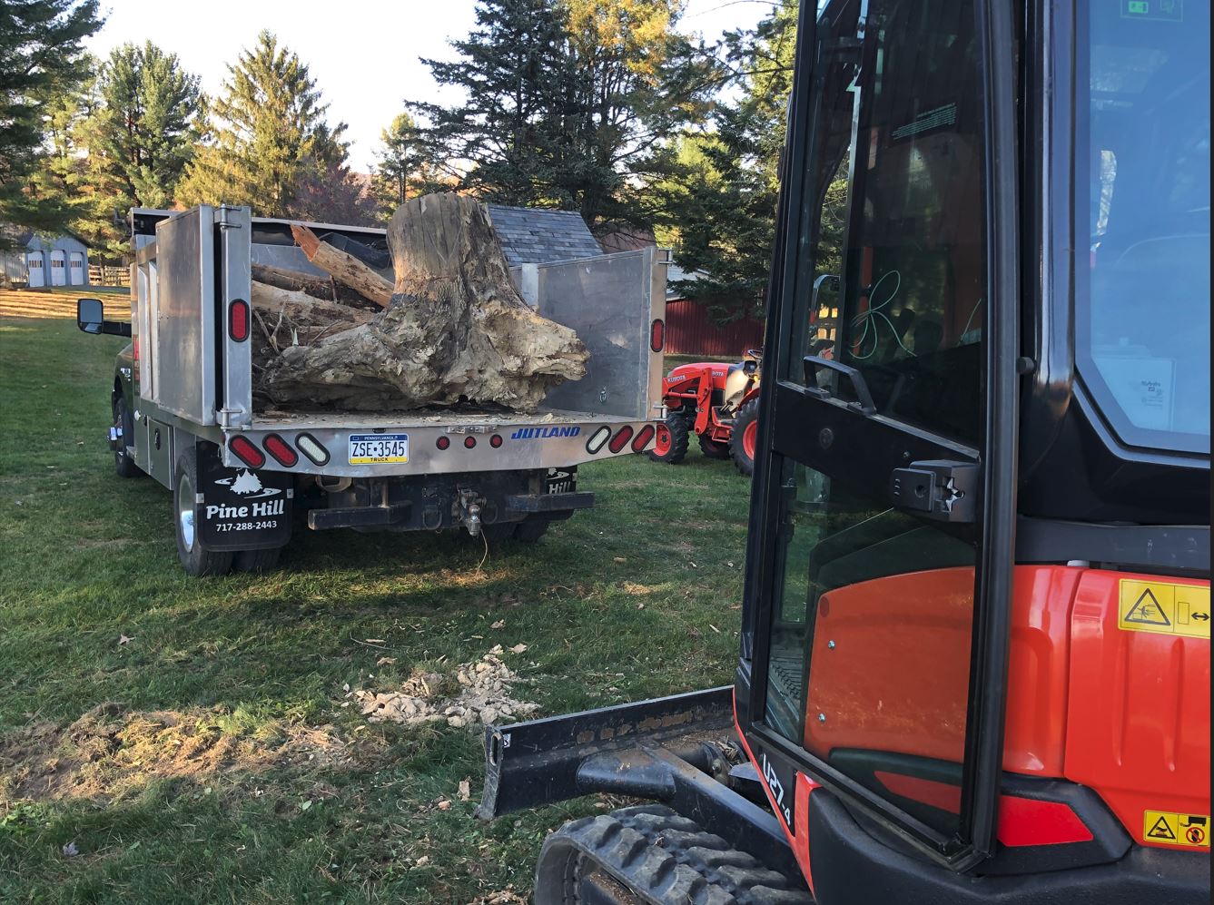

Wrapped it up on Day 3. Nothing noteworthy other than the last large stump. It was a bruiser.
Dat's a big ol' stump! I dug one out like that by hand in my mid 40's. Me and an F-150 got 'er dun!
I won't lie, though. A small tornado had blown it over May 1, 2005. I just finished the job. It took me nearly 6 months to clean up all the trees that little tornado put down, but it was all hand tools and pure labor back then. Wow, I just realized that photo is 19 years old last week. The pile of chips in the background was all done by hand with a little 3 inch Murray chipper/shredder (which I still have). Now, a nice shed, and an LX2610SU and a Woodland Mills WC-68 sit in that spot back there. I could probably clean up the same mess in a couple weekends with the equipment I have now.

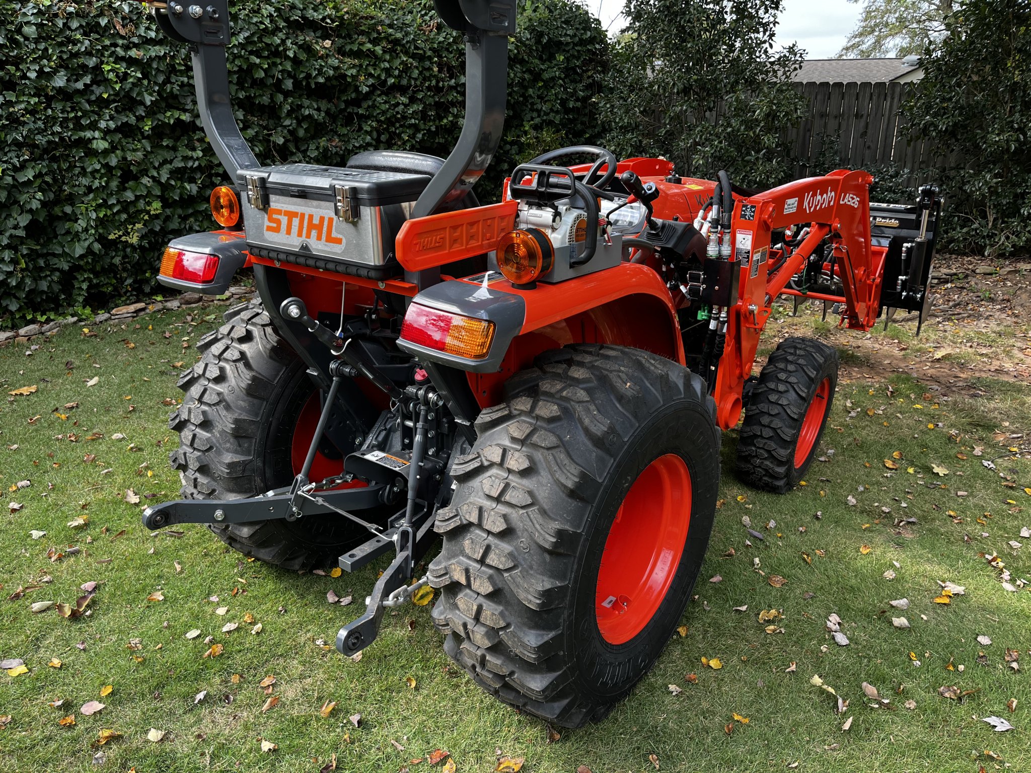

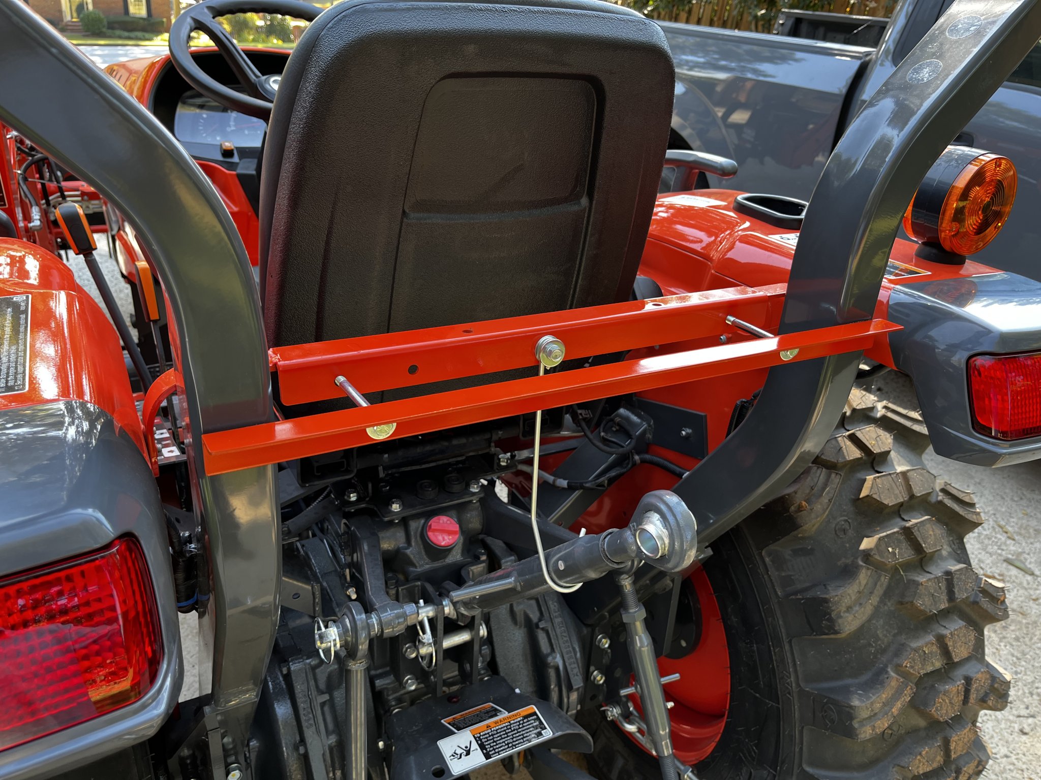

Added Some angle iron so I could mount a toolbox to the rear to replace that little pencil box from Kubota. Built a mount for my little Stihl 200T to sit on the fender. Clamped it thru cup holder hole so I didn’t have to drill the fender.
View attachment 140669 View attachment 140670
I like the place you found for your saw. I don't recall seeing one positioned like that before. Looks like the perfect spot on that tractor!!

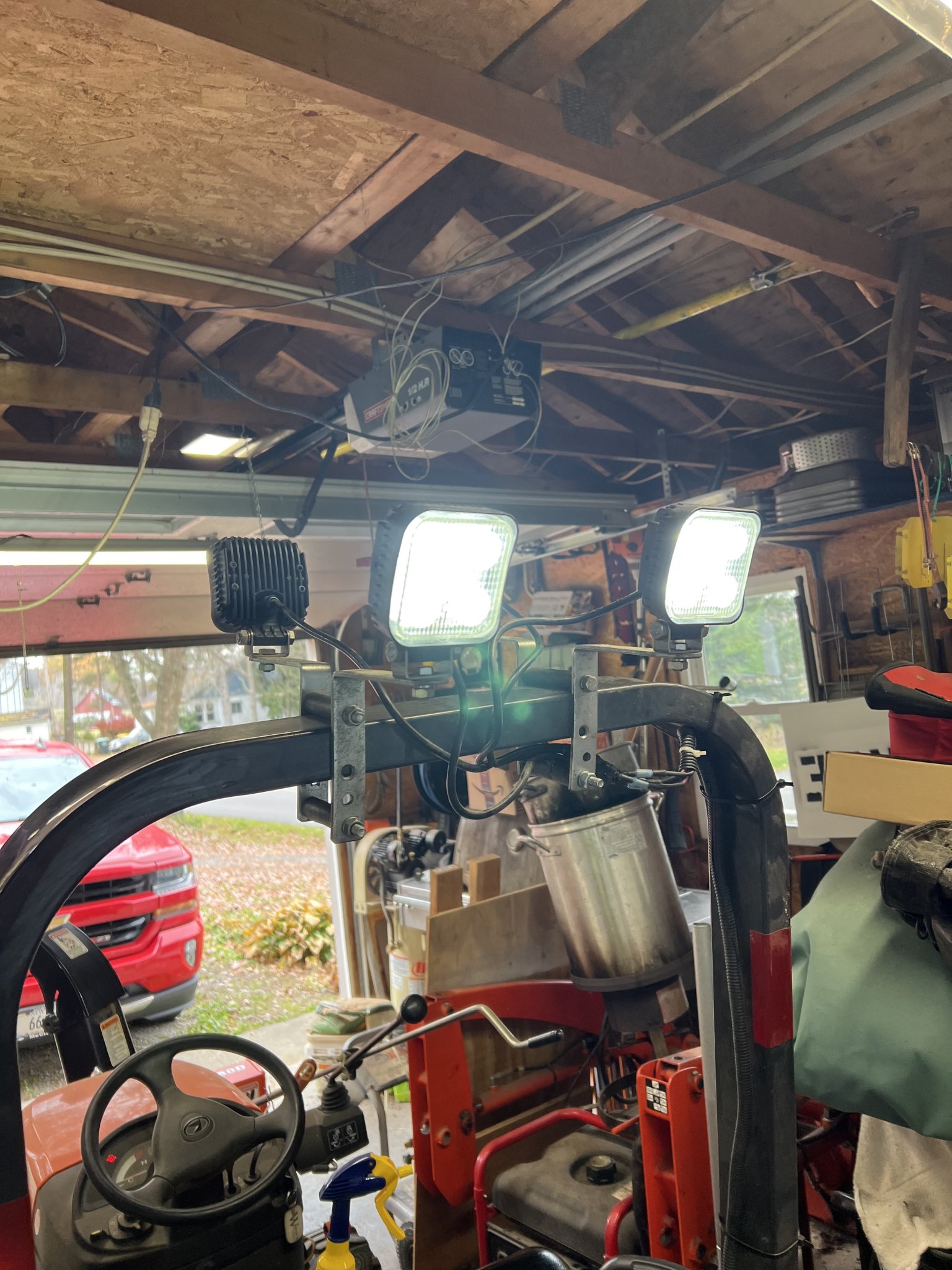

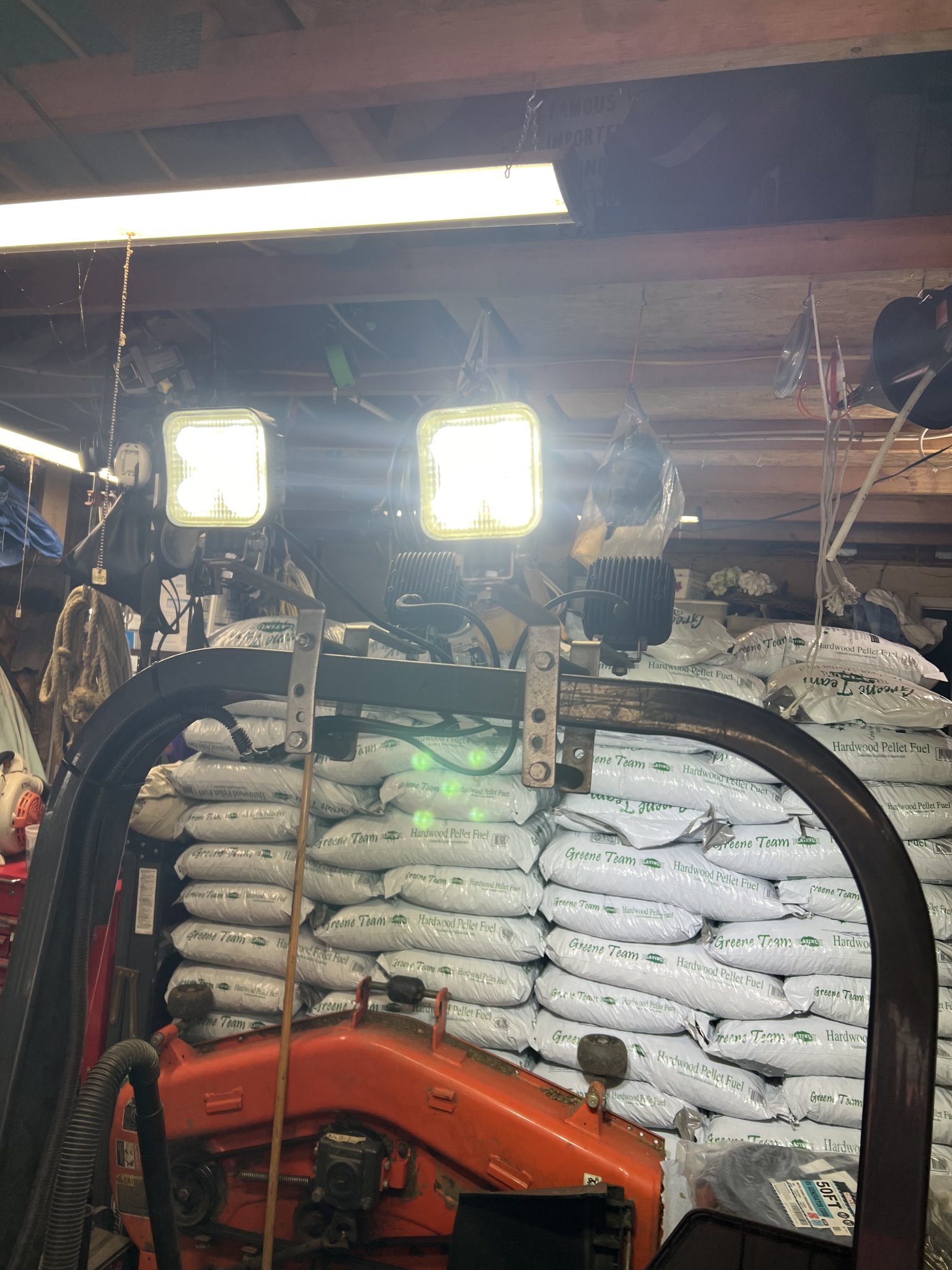

For years, I've thought I would "improve" my homebrew winter worklights on the BX2360.
The ROPS on a BX2360 is short….less than 6 feet, so there’s room on top that give good illumination and can still clear the overhead door easily.
I used the spare 10A Work Light circuit wiring that was taped up near the top link of the tractor when bought new.
Had a single Halogen light mounted differently, but it was a big draw on the tractor.
I got 4 LED's from TSC on an After Christmas Sale for $25 (I think they were 50% off).
Had 2-6" angle brackets.
Got a plastic electrical conduit fitting and used some other plumbing fitting. Maybe $5.
10A switch came from NAPA for $10.
Wire was expensive, as I got a couple spools. Maybe $40.
All in, maybe $80 or so, and I have wire to spare.
After looking at them on the tractor seat, decided they work just fine......someday maybe I’ll change the light fixtures for something “better….” Otherwise I’ll be satisfied.😉

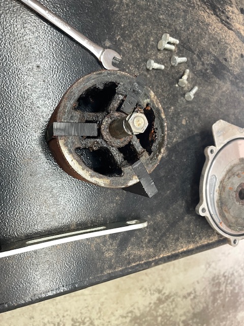

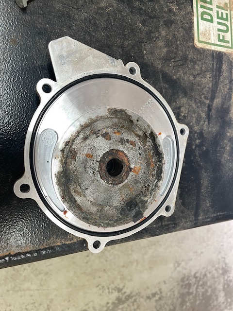

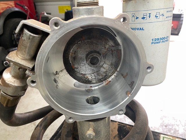

Not on it, but for it.
Got this rotary pump back working on a 50gal transfer tank. Carbon vanes were stuck almost solid. Once out a quick few swipes with a file on the rotor had them sliding in and out easily. Few minutes on the wire wheel and rotor was mostly rust/carbon/gunk free. Brass brush took care of the aluminum housing. No after pics, but it works now!

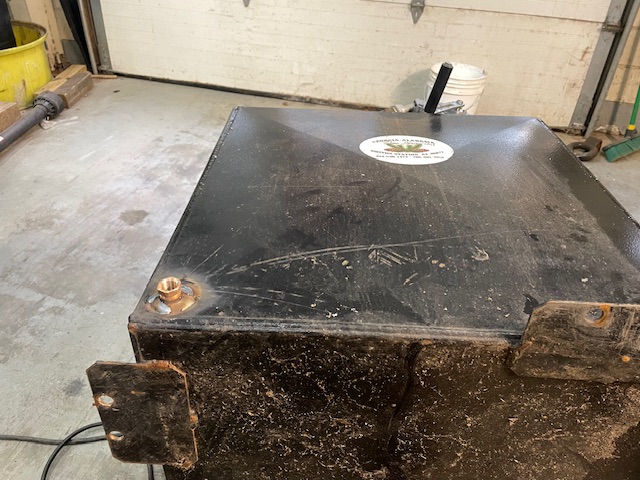

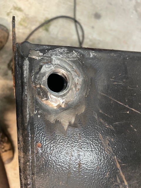

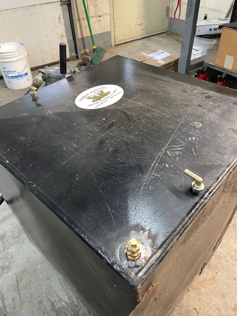

Doing some more work on this tank. Wanted a drain in it, it has set a while and has some crud in the bottom. Figured while I had the welder fired up, I’d do a simple fuel level sight gauge. Couple of bungs, elbows and tube and she’s done.
Was originally thinking same side as drain, but changed to the other side for no real reason.
Finished up. Now to leak test!

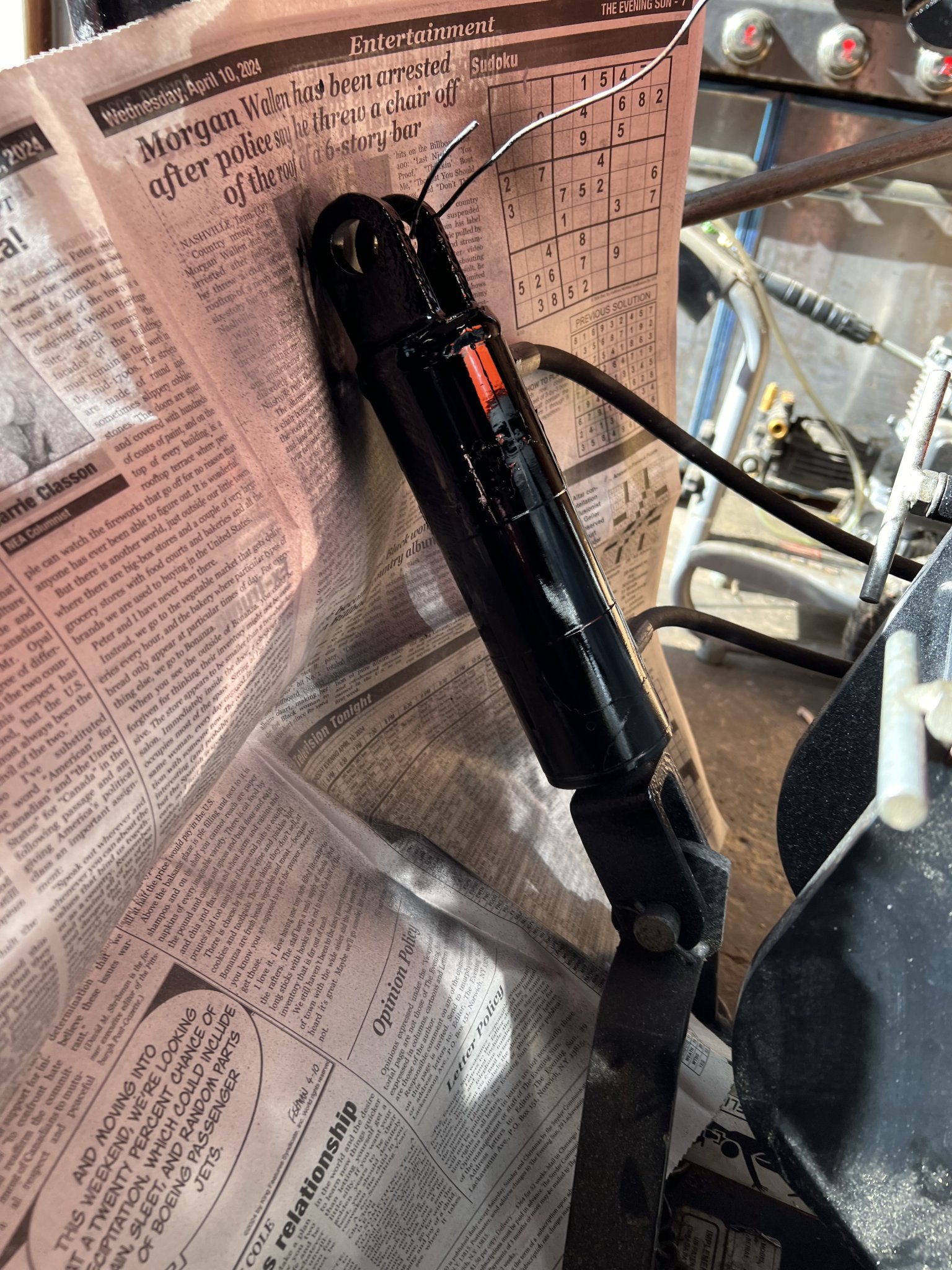

Powder coat on lift cylinder for snow blower cracked and was peeling off. Been 11 years, so not an immediate failure of the finish.
Like many guys here will say, sometimes powder coat is not a good finish.
Nothing fancy, just ground off powder coat with wire wheel, primed and painted. Other parts of the hitch are starting to peel as well. Just wanted to get some of the worst parts for now.

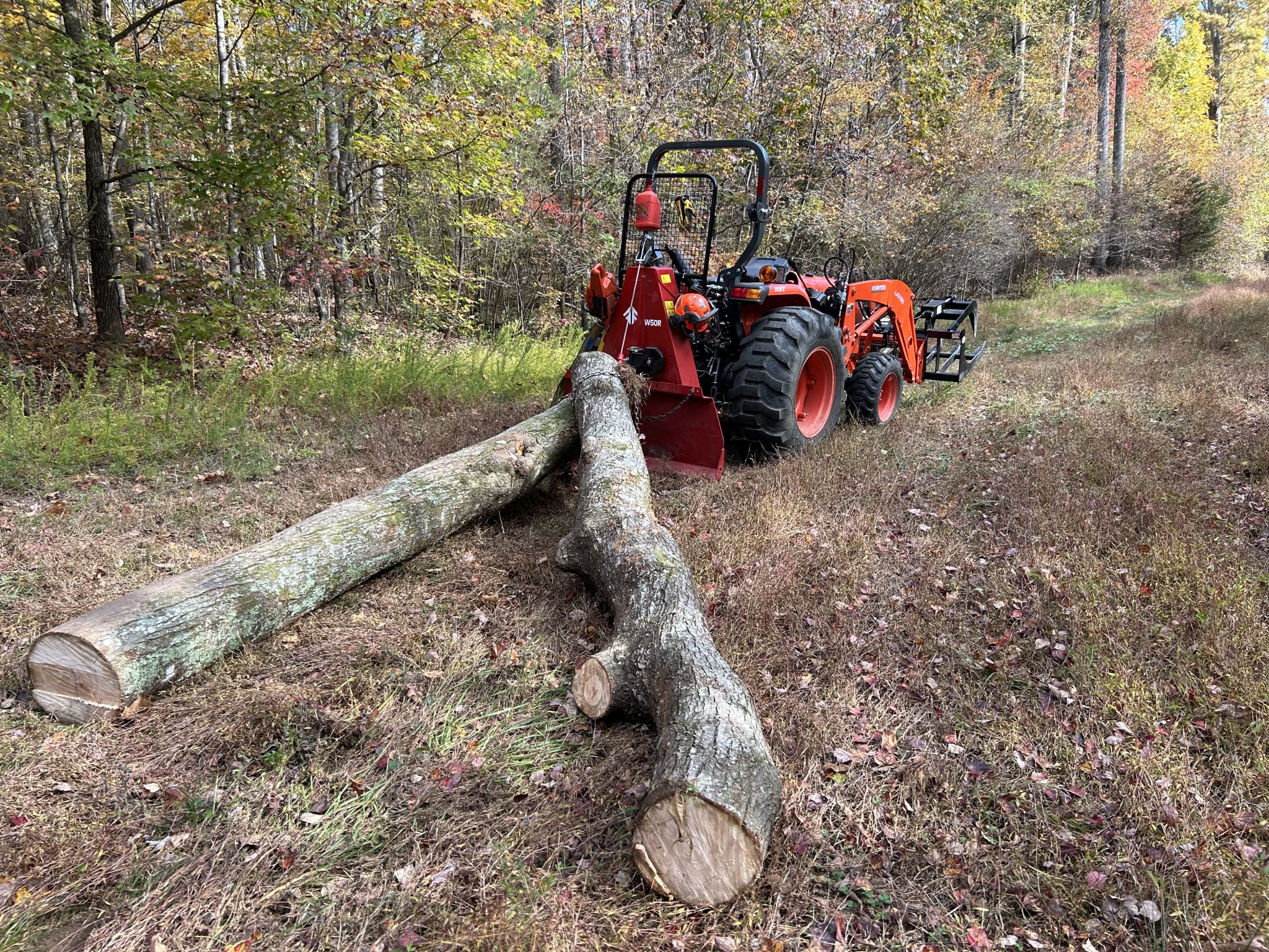

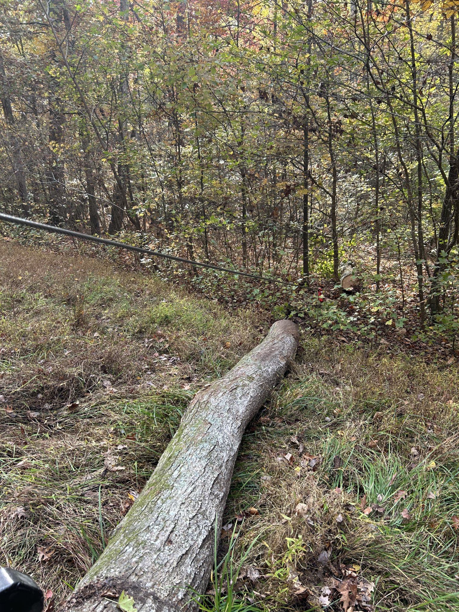

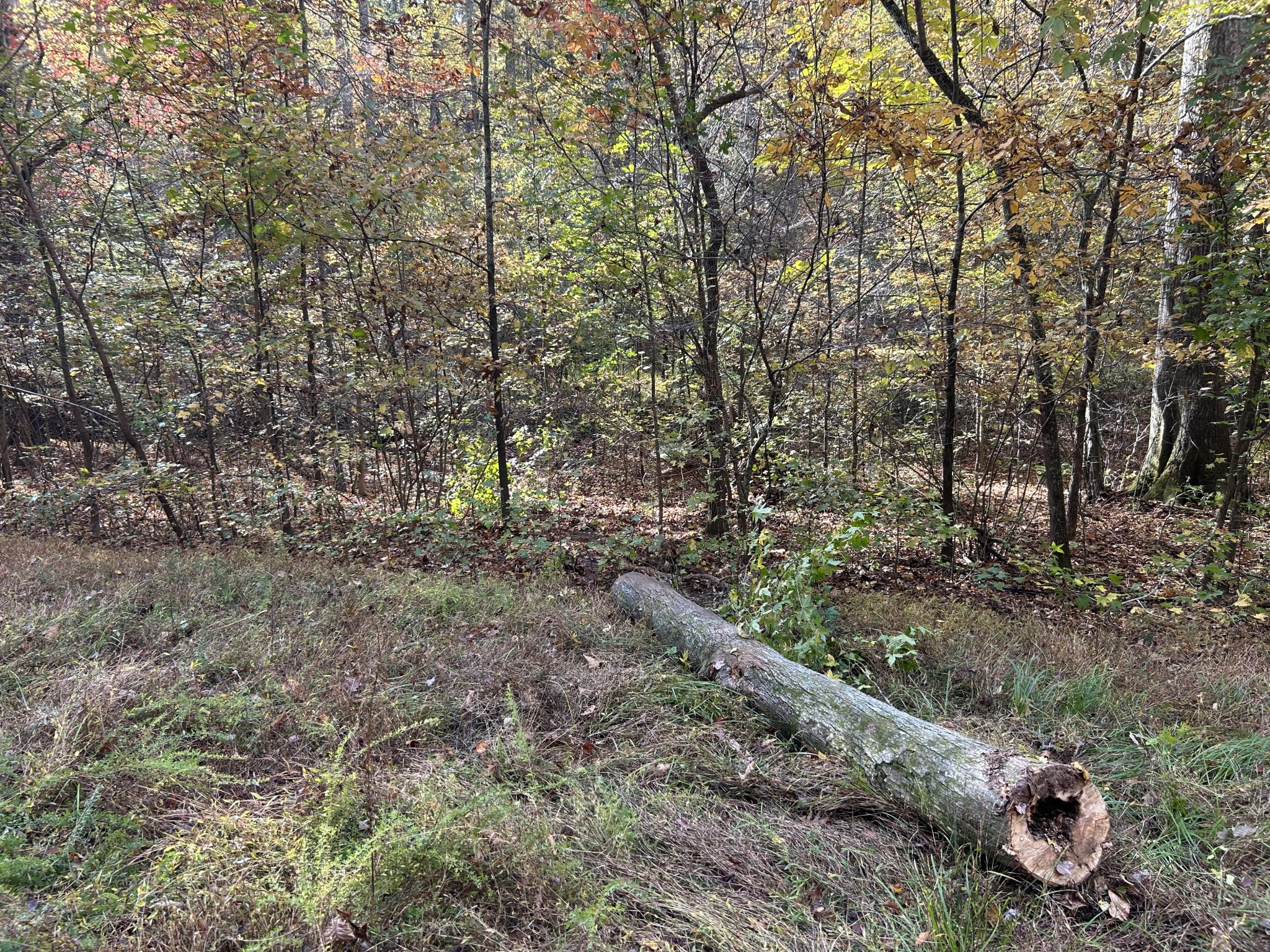

Pulled a bit of windfallen wood up to the wood lot today to get started on firewood for next year.
This small hickory fell several months ago. Pretty dry now but still solid aside from the little bit of rot toward the bottom that predated its fall. It was on a downhill slope just off the edge of the sewer line.
Cut a pair of 14’ logs off the bottom end and winched them out with the Farmi. One of the things I like about the winch is after pulling these logs out, there’s very little damage to the surrounding area.
Hitched them both up and hauled them home. Whole thing took a total of about an hour, mostly because I wasn’t in a hurry and it was a pretty good distance from home. Have a bit of maple to get up before firing up the wood splitter, but that’s for another day.

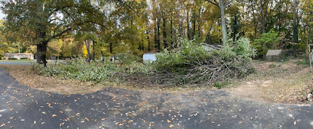

Clearing a 30x20yd patch of property in between mine and my neighbor's house to install a small pole building. A few trees were felled, and saved $2,000 by having them leave all the debris in place. Working on getting the pile broken up and moved. Lots of big trunk sections under that pile. Tons of thick Ivy was covering those trees which is making it a challenge, but getting it done!
