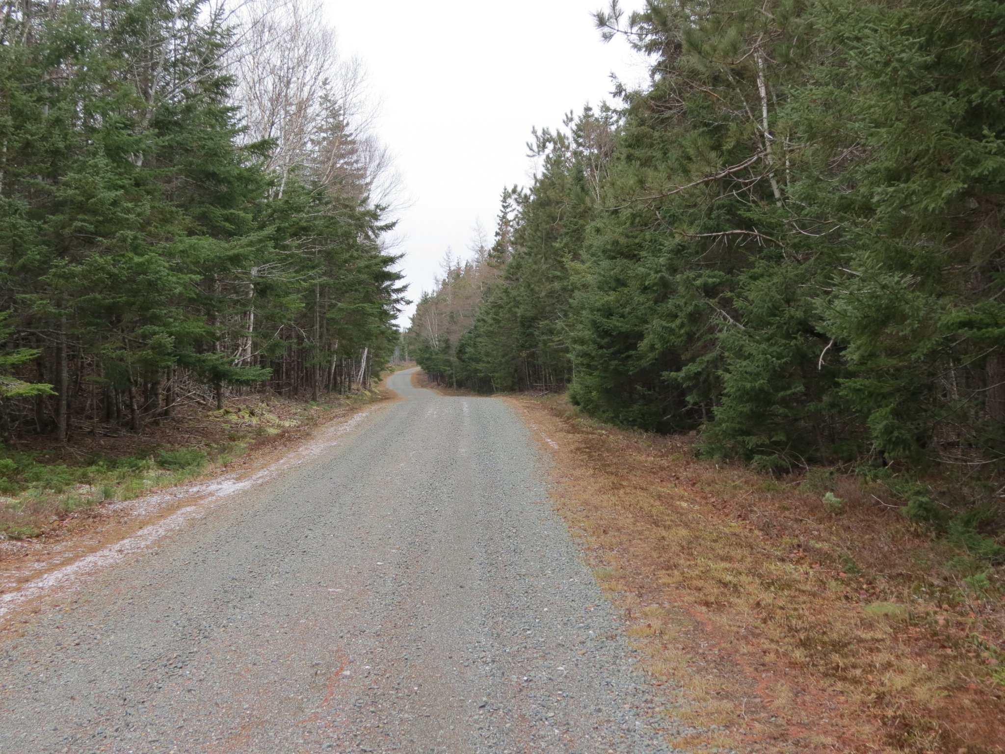

We took the dog (Moe) for a walk Saturday, beautiful day, been a great winter but then things changed. o_O:mad: Just after 12am that night wife wakes me up, no power. Woke up to a foot of wet snow or so So around 7am I get the tractor and head out, too many trees down so head back and throw 2 chainsaws in the bike, all good right, wrong. Tried to start the first saw and the cord breaks so on to the next one that ran but not good, just enough to clear the road ignorer to get the tractor through. Hop back in the tractor and get 3/4's of the way out and the tractor goes into regin. Not a problem as the rpm's were high for the blower and shortly after it throws the P2414 code. On the bright side I managed to finish clearing the road and both saws are fixed this morning now off to cut some more trees
