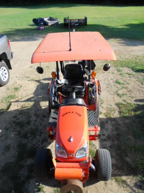

I want to make a canopy for my L3800 and like the way the Wells Ag FOPS rated canopies look. Can someone with one of those tell me the thickness of the sheet metal used on top? I heard it was 18 gauge, but that seems on the thin side to me. Thanks!

I cant help you but some place in here a guy made one from an old truck hood I think, and that's not really heavy stuff

I've seen that one, very clever!
The test for falling object protection is something along the lines of "drop a hundred pound weight on it from 30 feet up". By the time the weight hits it is going 30 mph, pretty good wallop! If I follow a design rated to withstand that test my canopy will have a better chance of keeping more than the sun off of me. That's why I'm specifically interested in the Wells Ag thickness.
