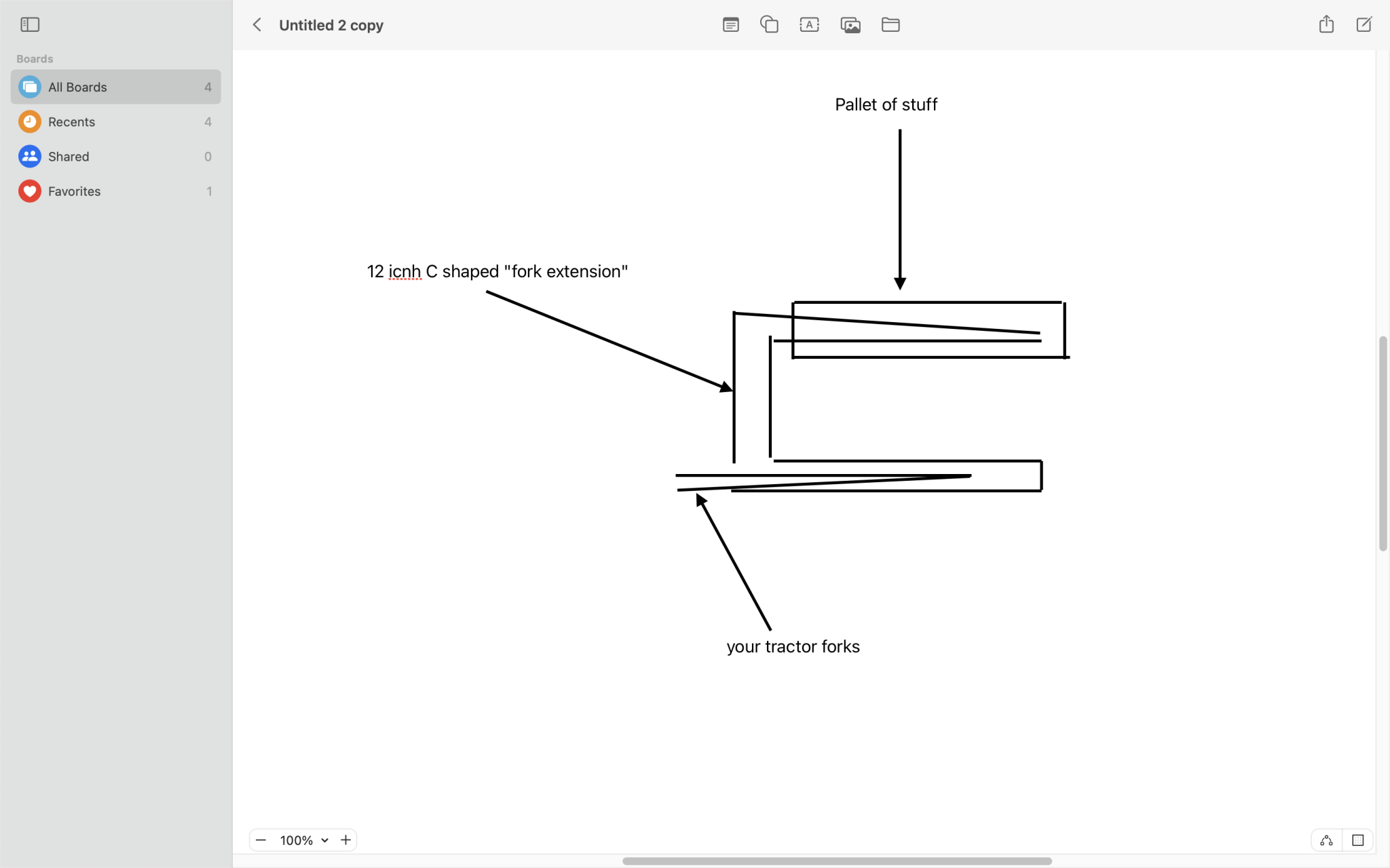

Instead of a box, how about a C shape.
Picture this (best I can do on an Apple....)
It would be a "work around" cause you would have to load it, then go around back and pick it up. It would however allow you to put it on your "shelf", if I'm picturing it correctly.

Still.....flipping the forks cost nothing and gains 16" of height.
That would work if you're moving pallets off a trailer or something, but you're not going to pick a pallet off the floor with that arrangement.
