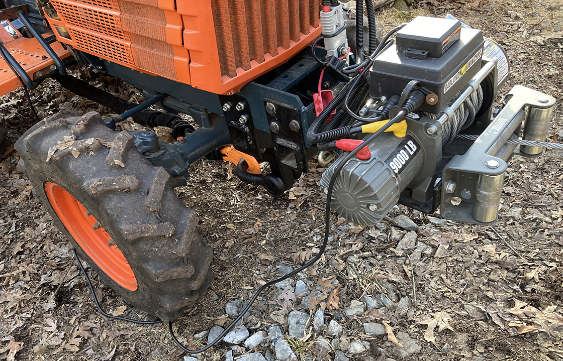

I would not tow anything from the front of any tractor. The rear is the recommended place (drawbar preferred) -- I also used this and they're easy to fabricate, but now rely more on wireless winches to move vehicles short distances -- the wireless on these winches (Smittybilt, Warn, etc) typically operate around 35'-50' so it gives you plenty of room to maneuver. Have also used pulley arrangements (as mechanical multipliers) to pull the really heavy stuff (e.g. stumps even my JD410E couldn't handle).

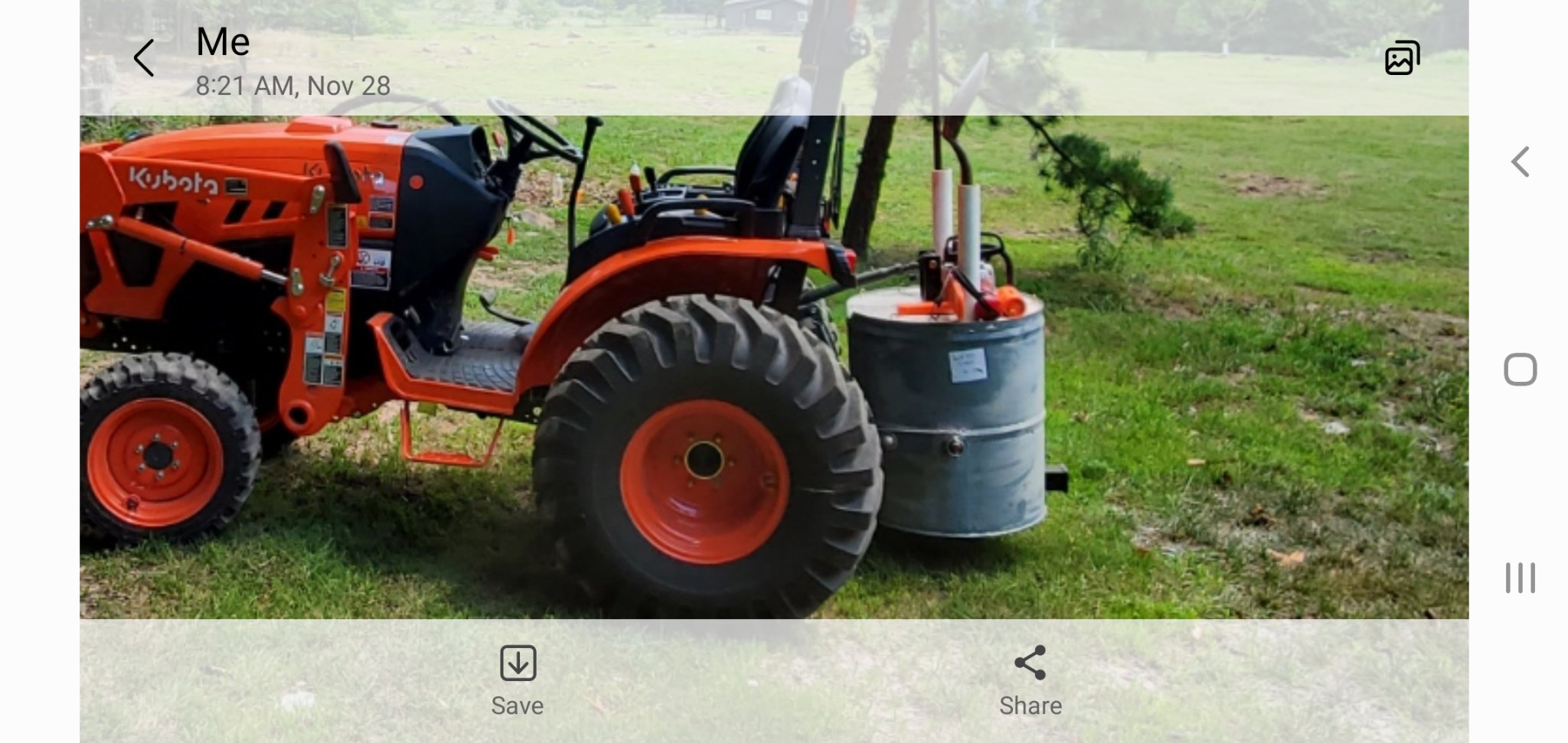

This might answer my question! It looks like this rig hooks up to your lower links so you're actually using the lower link arms to pull. I built a rear ballast using a cut down 55gal drum and added a 2" receiver tube near the bottom, welded and surrounded by concrete. Not worried about the integrity of the ballast barrel but wasn't sure it was OK to pull with the link arms. I'm pulling small locust trees out of the ground. Nasty suckers covered with huge thorns. Reciever tube/shackle/strap/tree. I tested it on a couple small ones, seemed fine.
To be safe, I might add a chain to the draw bar like Lil Foot did in the previous post and let it run under my barrel. This site is great, y'all have so much knowledge! If anyone thinks it's a bad idea to use my barrel to pull, I'd be happy to hear about it. Thanks all!

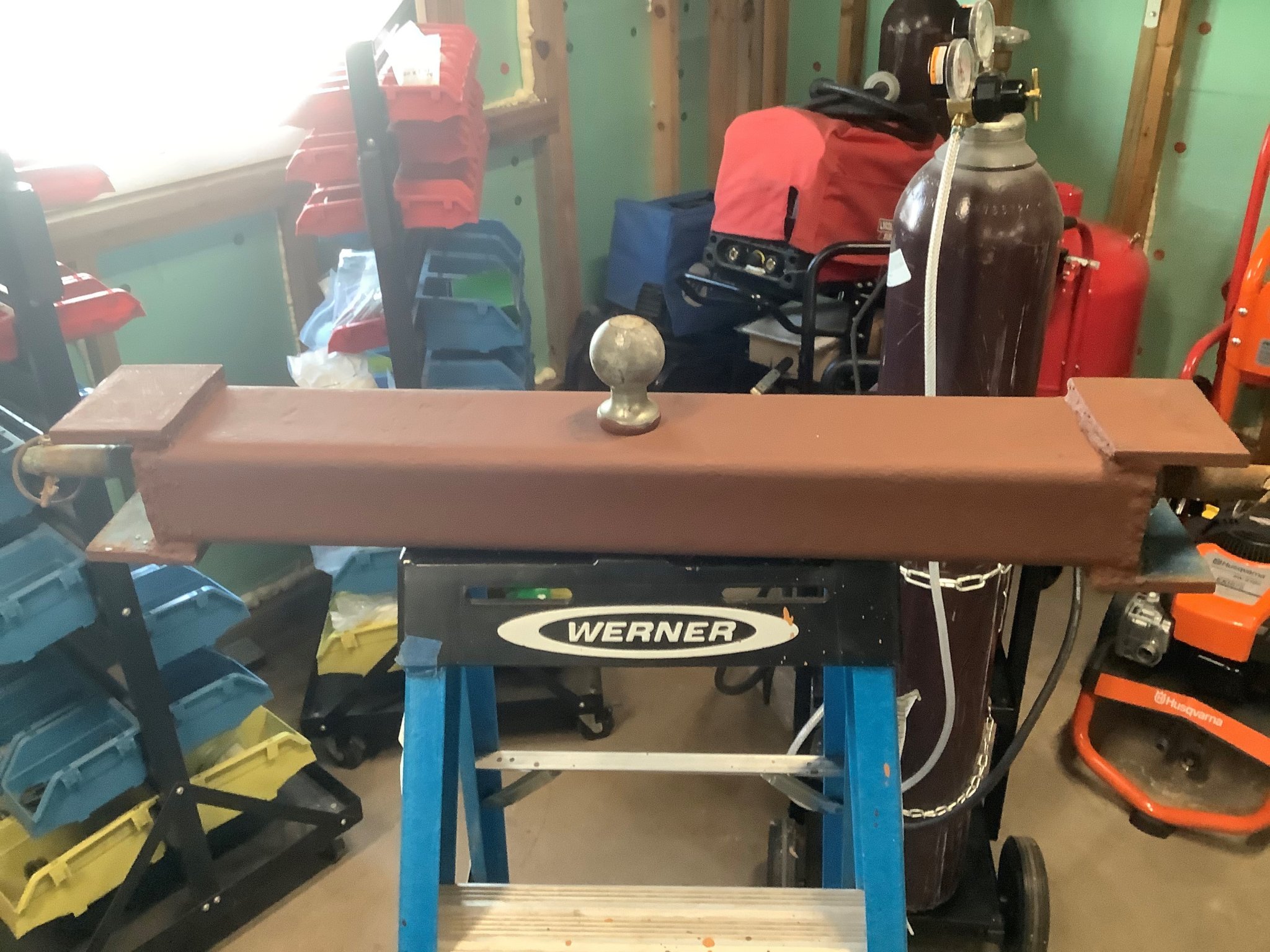

I agree and fabbed up some winch hitches that bolt right to the frame. The frames are quite beefy and stable.

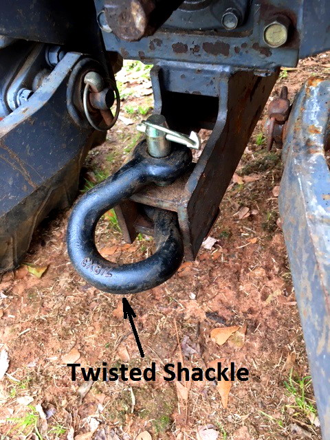

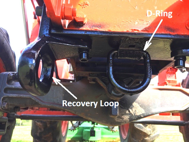

Keep a clevis attached also....but forego the draw-bar most of the time. (y)
Tow loops in the front (frame mounted) are handy for 'LIGHT' pulling in reverse or for an attachment for a 'come-along' for manual winching.
