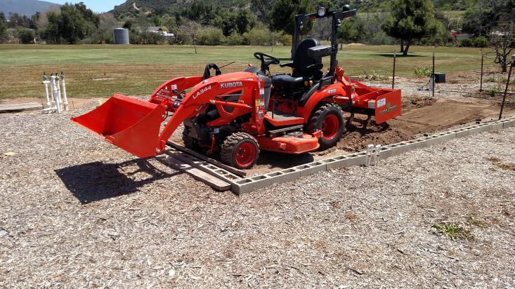

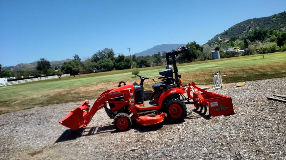

This is an update from my first post on 03-10-18. I have the mower deck along with box scraper, Front Loader all attached. Worked the garden today with all three on !!! At the advice of my wife, I read the manual, now problem is solved. The manual states to raise mower deck, turn height knob to TOP Position, then set rollers to lowest hole. I removed the rollers (I'm glad I did, bottom of deck did scrape). I sure hope this helps someone out there in the future. I have some Tractor Porn to show it works along, with what did you do with your Kubota today. Great Forum for us new people.

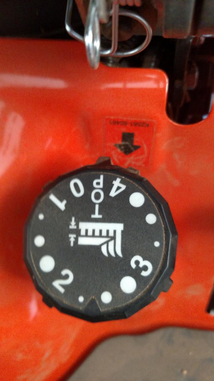

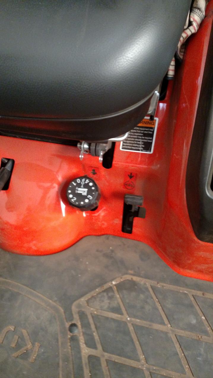

OK, I give up. Where is the height knob that I turn to "TOP"? I cannot get my mower to stay up when I use the box blade. When the blade goes down the mower deck goes down. I would be on the mower wheels to use the box blade. What am I missing?

Stand by, I took some pictures and will send them shortly.
