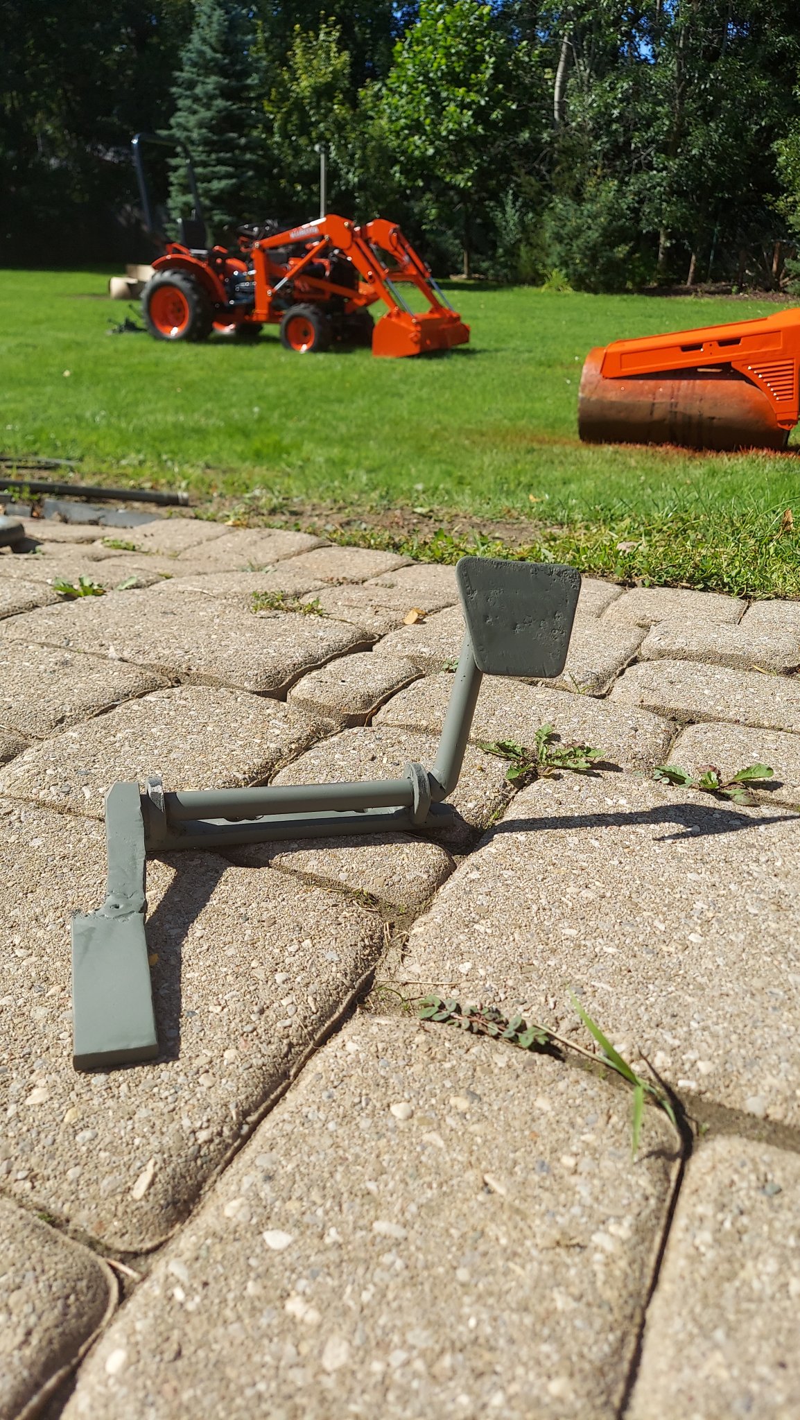

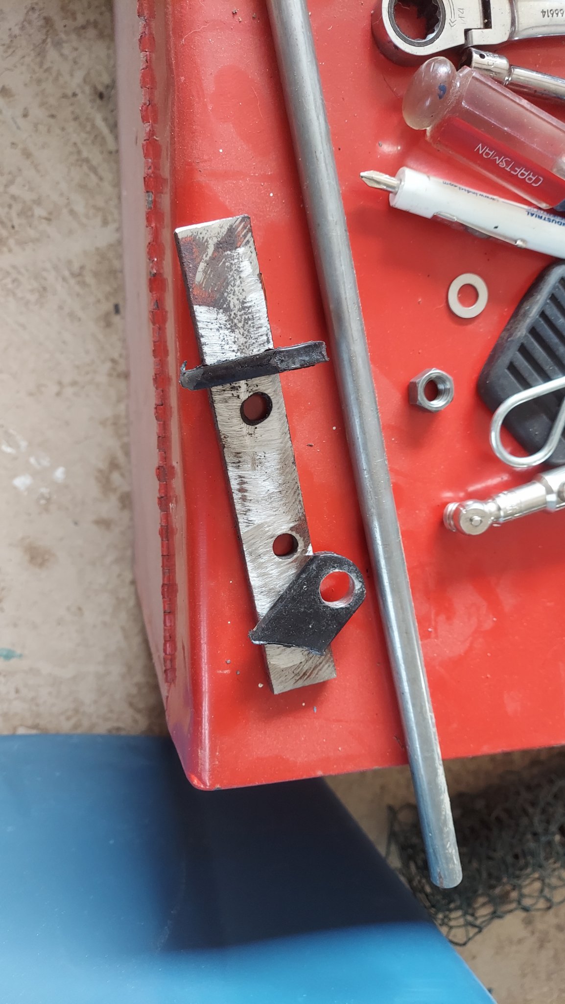

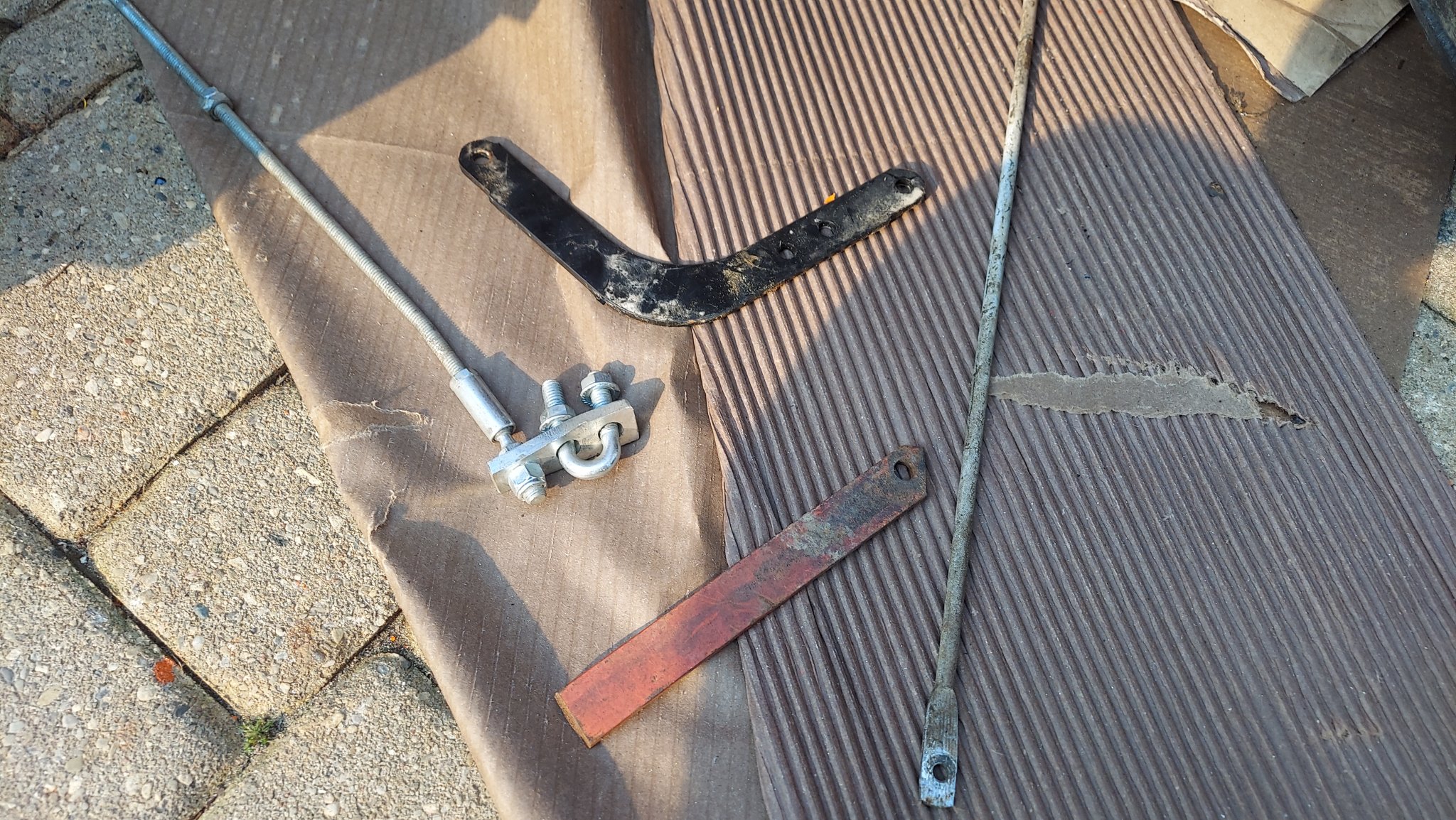

Attached are pictures of the original and the progression of the design. It works perfect. The final shows the painted version of the tractor, I wish I had taken a before picture as it was pretty rough shape.
Tnkubotaguy
Kubota 1700
Jun 27, 2021
24
Nashville
Attached are pictures of the original and the progression of the design. It works perfect. The final shows the painted version of the tractor, I wish I had taken a before picture as it was pretty rough shape. View attachment 64037 View attachment 64038 View attachment 64039 View attachment 64040 View attachment 64041 View attachment 64042
No holes were needed for this install as I used existing bolts in the foot rests. This only took a day to make. Paint used was Tractor Supply Orange Oil based with hardener followed by Tractor Supply Clear. The blue was acrylic enamel from Messicks. The gray rops was bobcat gray equipment enamel. I did not like the acrylic enamel orange from Messicks as it had no shine or body to the paint. I hope it's good for another 40 years!

That is a pretty cool solution! Great thinking outside the box...well executed as well. (y)

Thanks, what us Tennessean's lack in dental hygiene we make up for in ingenuity! All those parts were just layin' around as we don't throw out nuthin'. The side by side Rev and Fwd is definite upgrade!
