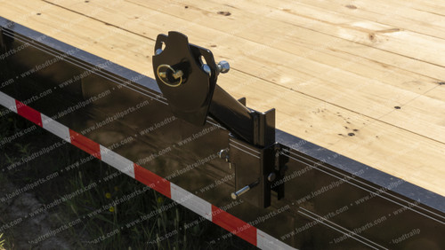

something like this ??
while $90 isn't toooo bad, seems easy to 'clone'.
looks like you press in 'studs' to put the spare on but I'd need a crane to lift an empty 9 bolt rim onto it, let alone a rim with rubber !
biggest concern for me would be to keep it SOLID as ANY movement isn't a good thing...
Studying the reviews of versions like that. Agree, needs to to solidly mounted. Problem increasing with bigger and heavier tires. Don’t want much space between tire and trailer to increase overall width. Also shorter lever arm.

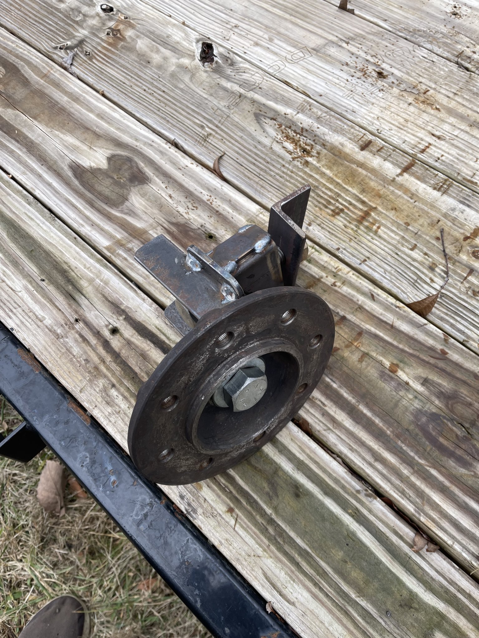

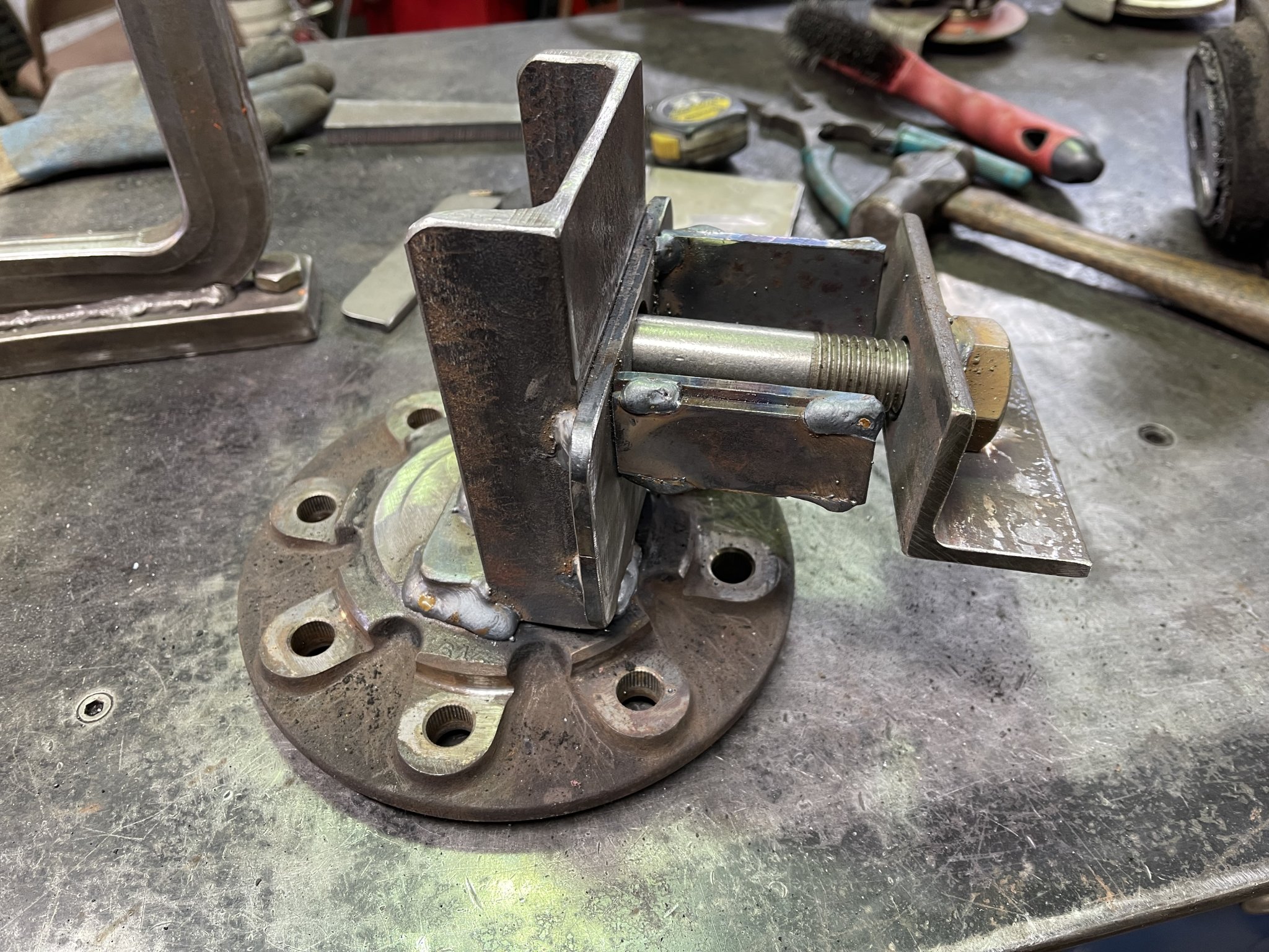

Good project to use little drops from the saws and plasma cutter. Welded together enough for test fit.
Not cleaned up yet. This will hold the spare within the fender width, close to the trailer frame.
One 7/8” bolt to attach. Rock solid. Overlaps the top of frame rail 2”. Shimmed up the stake pocket to level out.
Nuts are welded. One wrench or socket.
The wheel hub was an old part from Dodge truck repair. Cut the bearing off. That part is ductile cast steel? Easy to bandsaw cut. Worried how strong the welds might be so also bolted with 1” bolt too.
Over 20 parts so far.
Ah ... I was wondering what that bolt was doing through the center of the hub given that everything is welded.

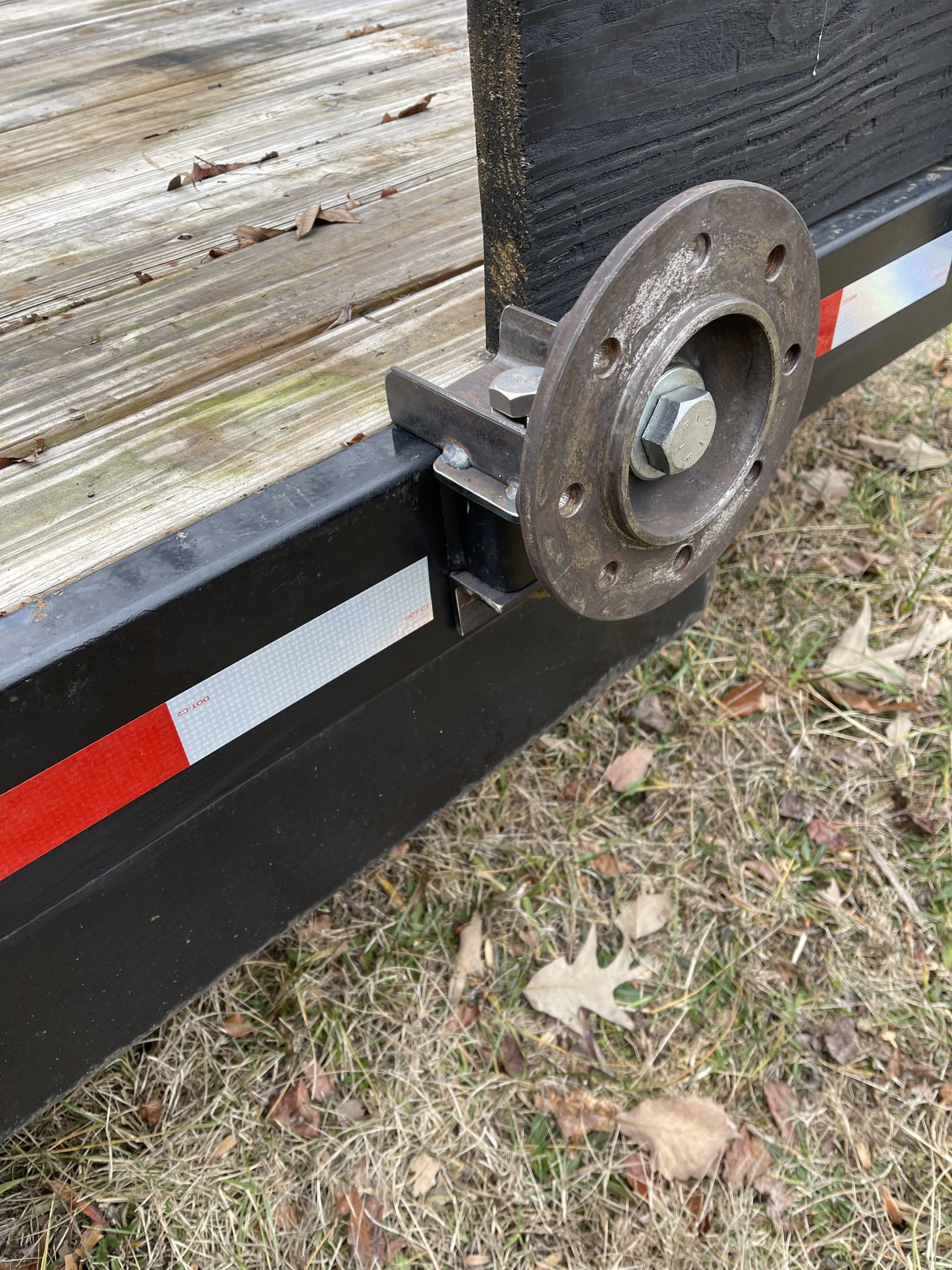

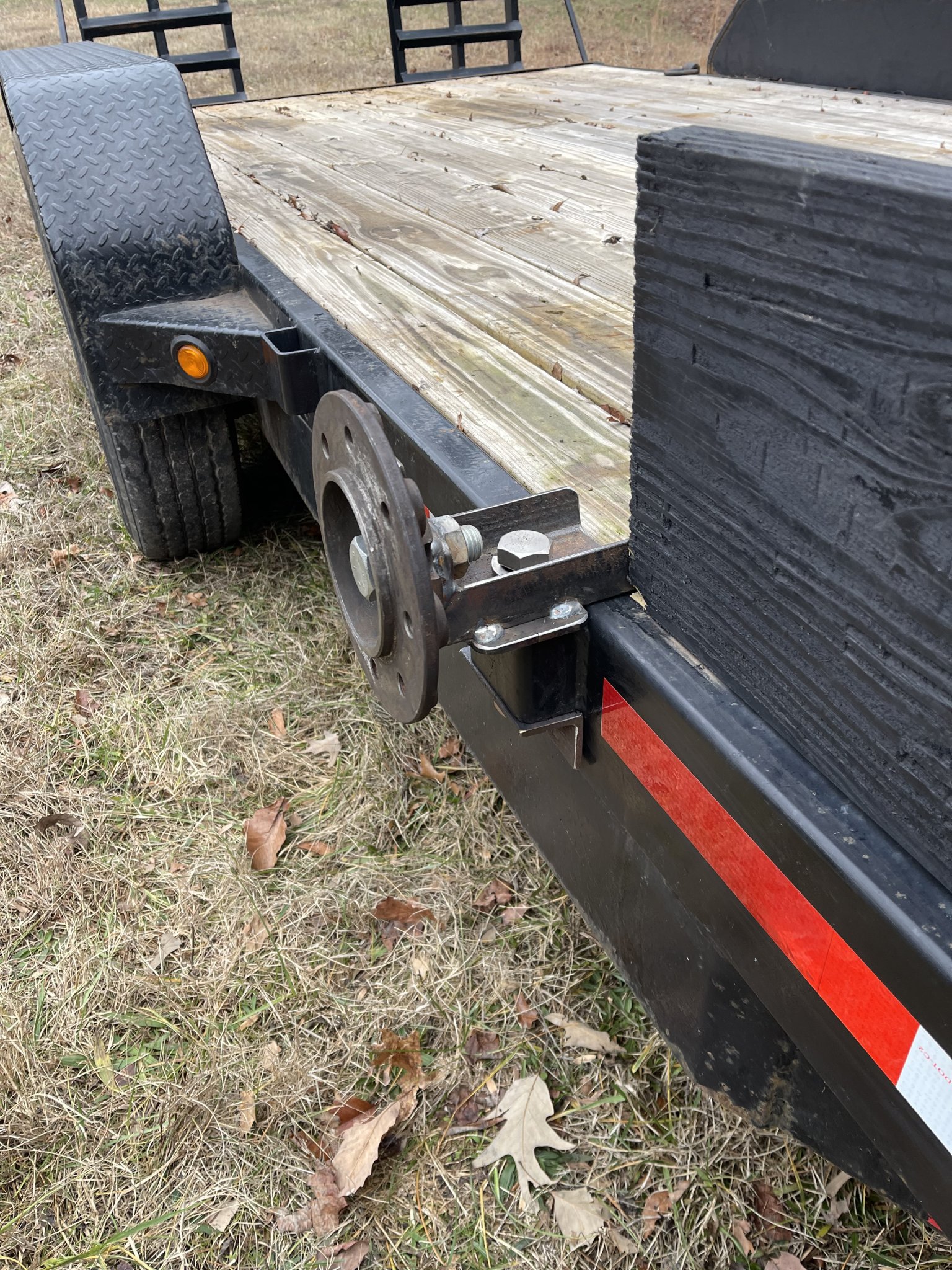

Finally installed. Holds strong and tight. Close to bed rail so does not go beyond fenders. One 7/8” bolt to install or remove. Drilled a wheel stud for a padlock.
