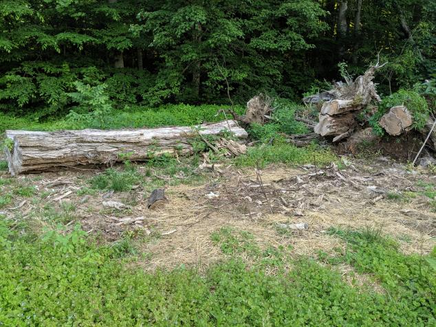

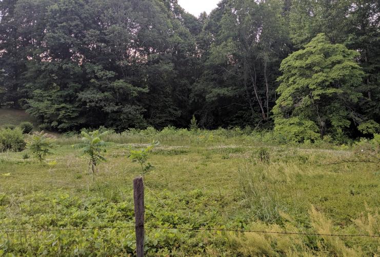

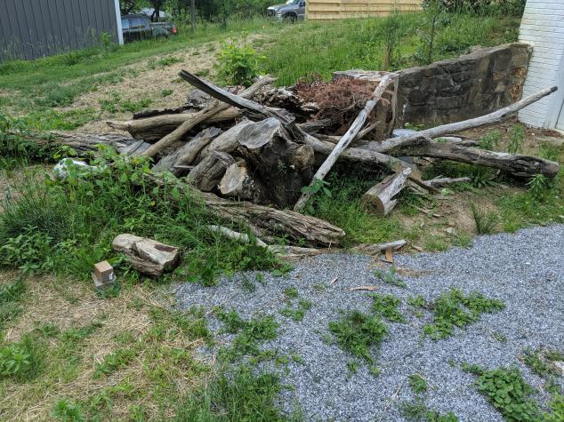

I've read so many posts so I'm going to try to make this one short and simple:
Looking to buy tractor... not sure what size would be best
Uses:
Pulling 1/2 - 2 ton trucks around shop (I own a light duty truck shop)
Loading and unloading pallets from truck (engines, transmissions, etc.)
Finish mowing (now ~1 acre, eventually ~1.5 acres)
Cutting a road and grading for new small home construction
(looking to start building a small cabin on vacant lot next year)
Moving logs (firewood and small millwork)
Moving large rocks for landscaping
Turning unused/neglected lot into manicured lawn
Spreading gravel, mulch, topsoil, etc.
Loading and unloading building materials
I need to dig some trenches for running different utilities and also for drainage repair but I think I can bunch all of that work up for a weekend excavator rental. then just use the tractor/box blade to smooth dirt after
I'm trying to keep total cost with implements around 20k +/- 3k, I know there is a few thousand $ swing in price depending on where you go so I'm trying to make it easy to make suggestions.
Thanks in advance for your guys help
