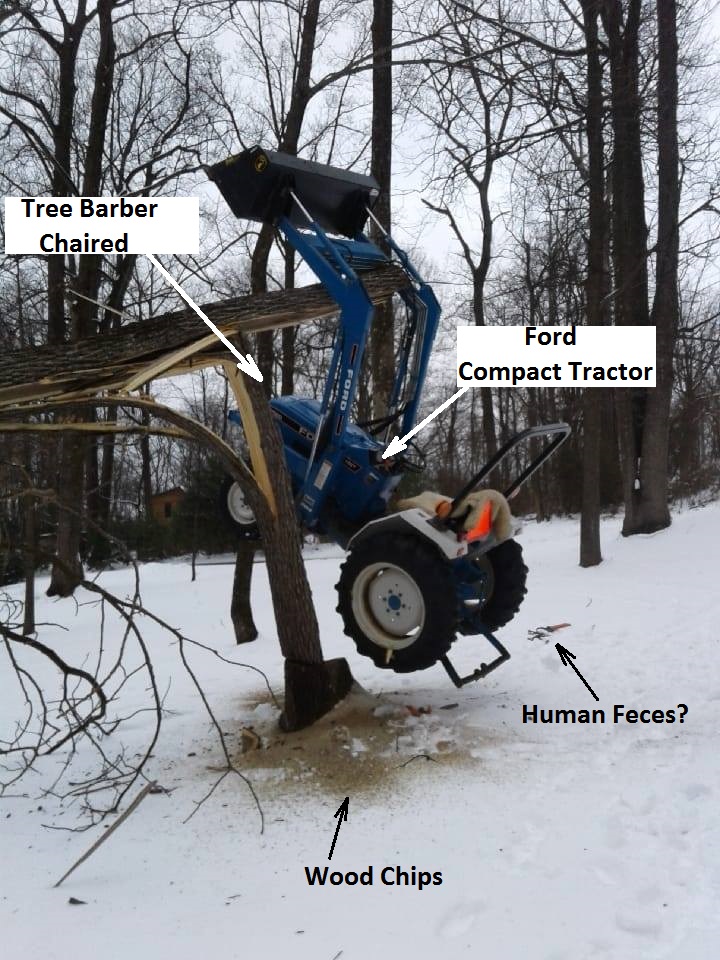

Don't try to push trees over....like this person did!
That’s a telling photo to be sure. I hope they got lucky and walked away after realizing how much worse that could have gone. Looks like the tractor may be salvageable too, that’s a bonus.
I’ve seen folks push smaller trees (say 6 inch or so) over with CUTs, I always thought it was a great way to screw up a FEL and bucket. I never envisioned this type of a result and I’ll bet the fellow on that tractor hadn’t either.
Yes. Person responsible may have gotten away with it few times before.
Hard to say what happened exactly. I don't know if the person attempting to fell the tree was just lazy....or something about the tree got them 'spooked'.
The tree looks to have been a 'leaner' to start with and possibly 'limb heavy' on the downhill side as well. The safest way to fell that tree would have been to make an Open Face (face cut) or a Humboldt.
Then 'plunge cut/bore cut' to establish a 'hinge' and lastly cut to the rear leaving a small 'trigger' to release the tree.
It appears in the photo....that the person cutting tree cut a small 'sliver' of face cut and then just cut in about 1/2 the diameter of the tree for a Back Cut.
Probably heard the tree make a little 'pop' at that point and got spooked. Likely thought the tractor would be the best way to start the tree falling. Bad choice....somewhere along the line.
Whatever the case, smart money says a change of underwear was required afterward.
