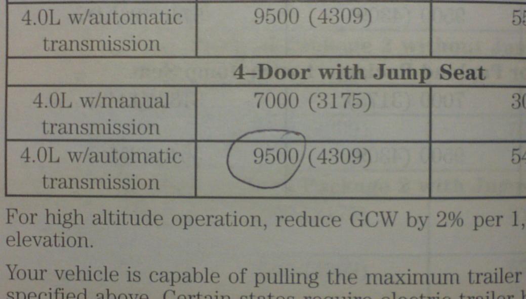

Alright, here is the evidence. As you can see, I am with in the guide lines of the Ranger owners manual. I have a 4.0, 4 door, 4x4, with the jump seats. I have no problem with towing my B3200tlb with the Ranger. I don't get in a rush on take off. I average about 14mpg and travel at about 60mph. Stopping is no problem. Trailer has brakes on both axles.
Sure I would prefer an F350, but this works for me.;)

You're misinterpreting what the book is telling you GCWR is Gross COMBINED Weight Rating. Like I said before that means the total weight of the truck plus the total weight of a trailer plus the total weight of cargo.

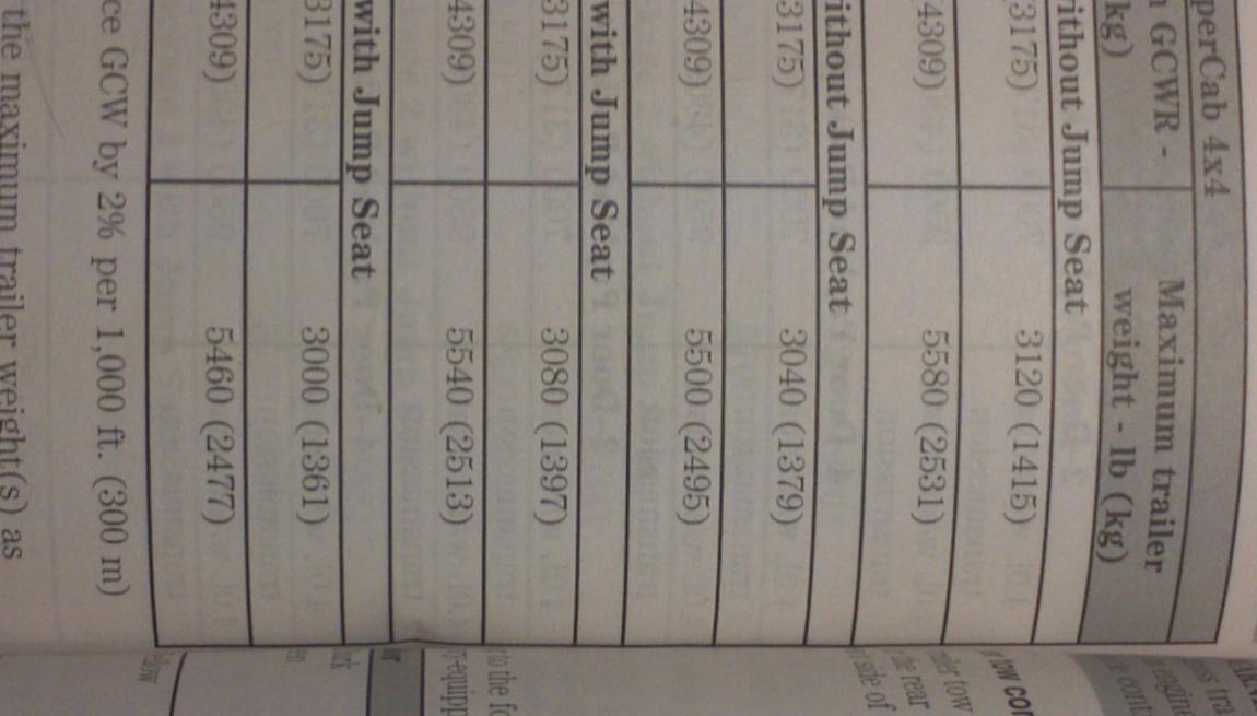

Eric look at the last picture. The top of the page list the total weight of the trailer. Look down the column, and you will see a weight of 5490. The trailer with the 3200 weighs close to that amountt.

As a CDL driver, the Ranger is within the legal limits of GVWR (Gross Vehicle Weight Rating) and suggested* GCWR (Gross Vehicle Combined Rating) Certainly he is not suggesting that the Ranger was capable of 9500lbs by itself, but that the ranger and trailer/load COMBINATION rating was 9500lbs
So, no over loading at all if he is at 9250 lbs COMBINED as the unit is rated at 9500 COMBINED. PROVIDED that the hitch weight does not put the rear axle over its GAWR (Gross Axle Weight Rating)
