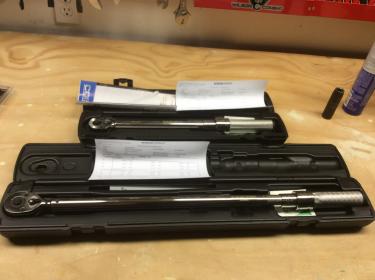

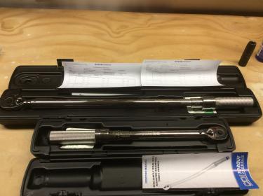

Go on Garage Journal website, great site for tool info...there are several threads that have great info about torque wrench’s ...
I like these CDIs that I got after reading the threads and the pros and cons...and cost issues...

CDI produces Snap-on torque wrenches,at least in 3/8" size ,because I have one of each and both were inspected by the same guy and inspection cards are identical other than lack of Snap-on on card of CDI wrench.Just some info.
