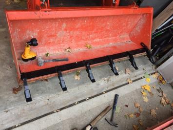

Here is the tooth bar.
The toothbar will not slide on and the backbone is way off from being flush with the bucket.
There is a 3/4 of an inch gap in the back. Where the front is cocked down.

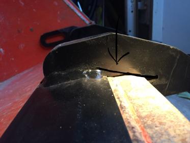

Here is the reason I believe it is not fitting.

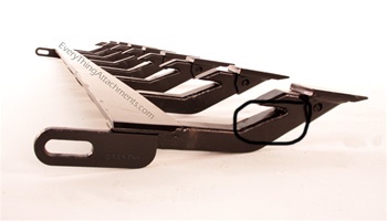

Here is the picture I took off the website page I purchased it from.
You can clearly see where the issue is. One shank is straight where it lines up with the top of the cutting edge and one is not.

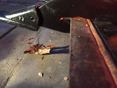

Here you can see the poor fit where the tooth bar will not slide all the way on.
I checked it out and it looks like I would have to remove a lot of material to get the tooth bar to slide on all the way and the backbone to sit flush with the bucket.

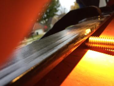

I clamped the tooth bar to the bucket with the backbone level and it appears the issue is from poor manufacturing.
The notches in the shack for the cutting edge to recess into are terrible.
They are nowhere close to being straight.
If you put a straight edge on the bottom of the cutting edge the cuts are not straight. Almost like they were cut by hand.
Looks like I will need to straighten the cuts on the bottom of the shank and remove some of that dip I pictured to go over the weld.
Also on a side note, looks like I bent the lip on my bucket trying to pound this piece of junk on my bucket.

After checking both tooth bars side by side we came to the conclusion that it will not fit because of the dip down right were the weld is and poor quality cuts on the shanks where the cutting edge slides into.
